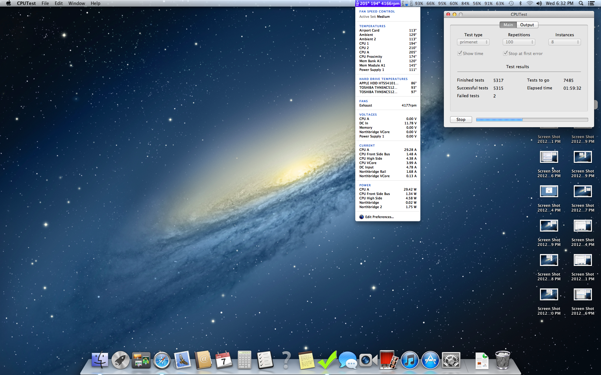

I think you are blind. The CPU where i was referring to showed errors in CPUTest when the CPU was on high temperatures. And you are right, not at 103C but at 99c-99c. Proof below.

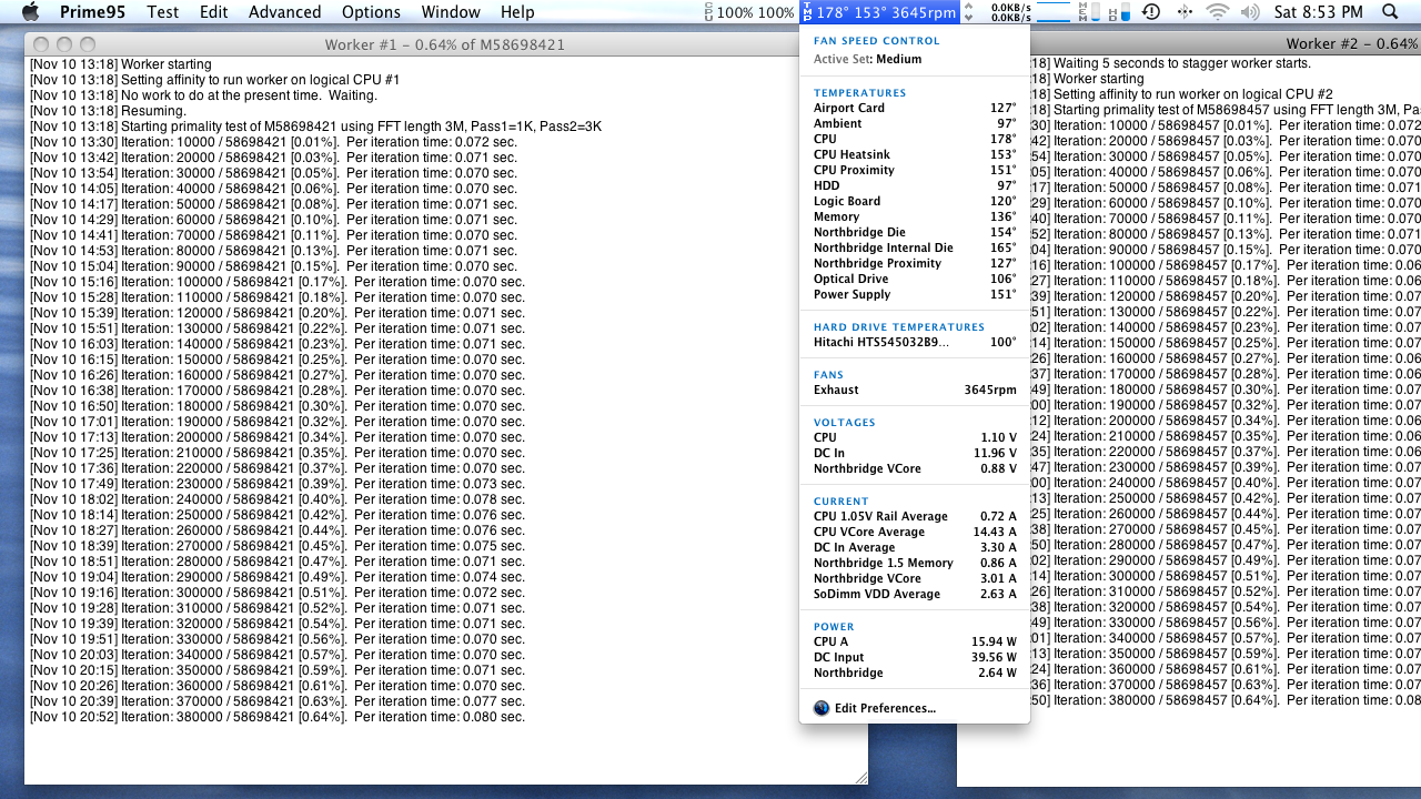

You used the text-based prime95 Max osx version?
You said in another thread that it had a possible fail in prime95 test.
Why possible? A error is a error.
Which program you were using to test your ram with and how much passes and how much time did it take?

you are correct it is an error I listed as possible because i could not burn the cd for memtest86 +. I was only able to run a 1 hour apple test and a 15 pass rember test. So i knew i could not be certain if the cpu or ram was bad. Since then I put in 3 sets of 1600 ram 2 oem sets of 2x 2gb sticks of ram and the after market set of 2x 4gb sticks of ram.
all failed the aftermarket ram failed on 3 of 8 cores in under 15 minutes with cooling in place ie under 180f . the two different sets of oem mac mini ram failed on 4 of 8 cores in under 10 minutes at temps under 180f.

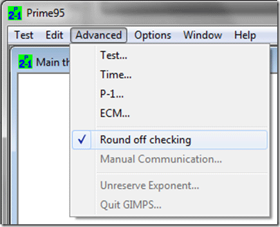

I don't see errors in your printscreen on prime95. (I don't know if the osx version is the same as windows, but below here i quote some website)
Before You Start with prime95, Enable Round Off Checking
However, before you do anything with Prime95, you should enable Advanced -> Round Off Checking (which is shown in the picture below). This makes Prime95 check for errors after each round, so you’ll be notified if there’s an error.

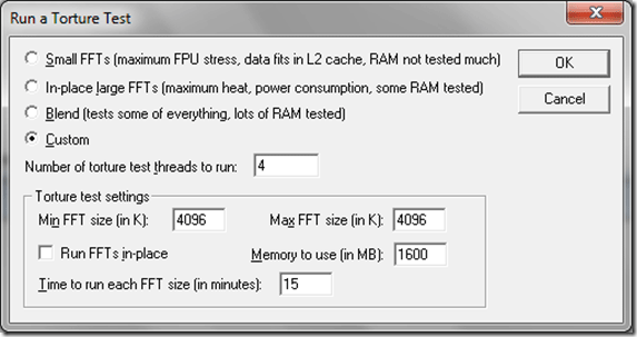

Once you do that, you can get to the torture test screen that you see below by going to Options -> Torture Test.
The Small FFT test is for testing the processor only, but I’d recommend just using Intel Burn Test for that, and the Blend test will test some of everything (cpu, ram, and chipset).
However, the Custom test will let you manually enter whatever settings you want. If you know what you’re doing, the custom test can help you to zero in on a specific part of the system, so you’ll be able to fail faster if there’s a problem with the component you’re currently overclocking.
If you’re wanting to test fewer than all of your cores (or threads), just change the Number of torture test threads to run box (shown in the middle of the picture above).
Quickly Testing the Overall System
The custom torture test settings (that you see in the picture above) work really well for quickly testing how the overall system is working by sending large amounts of data between the cpu and ram.
The blend test usually works really well for thoroughly testing the overall system.
I’d also recommend customizing this test to use 90% of your unused memory. You can do this by first clicking blend and then clicking custom (which will let you modify the normal blend settings). You can see the amount of memory used in activity monitor.
In this case 4358 MB is available, so we’d want to run the custom blend test with 4358 * 0.90 = 3922 MB of ram.
The amount of time you should actually run this test differs depending on who you ask. Some recommend a few hours is enough, and others say 24 hours is required to ensure stability under heavy loads (like 24/7 folding). However, most of the stable overclocking clubs require 12 hours to prove stability, so that seems like a happy median. I personally just run it overnight for about 8 hours, but run it for as long as you need to feel stable.
The source for the quotes above: http://www.masterslair.com/ram-cpu-stress-testing-software-tools-prime95-intel-burn-test/
