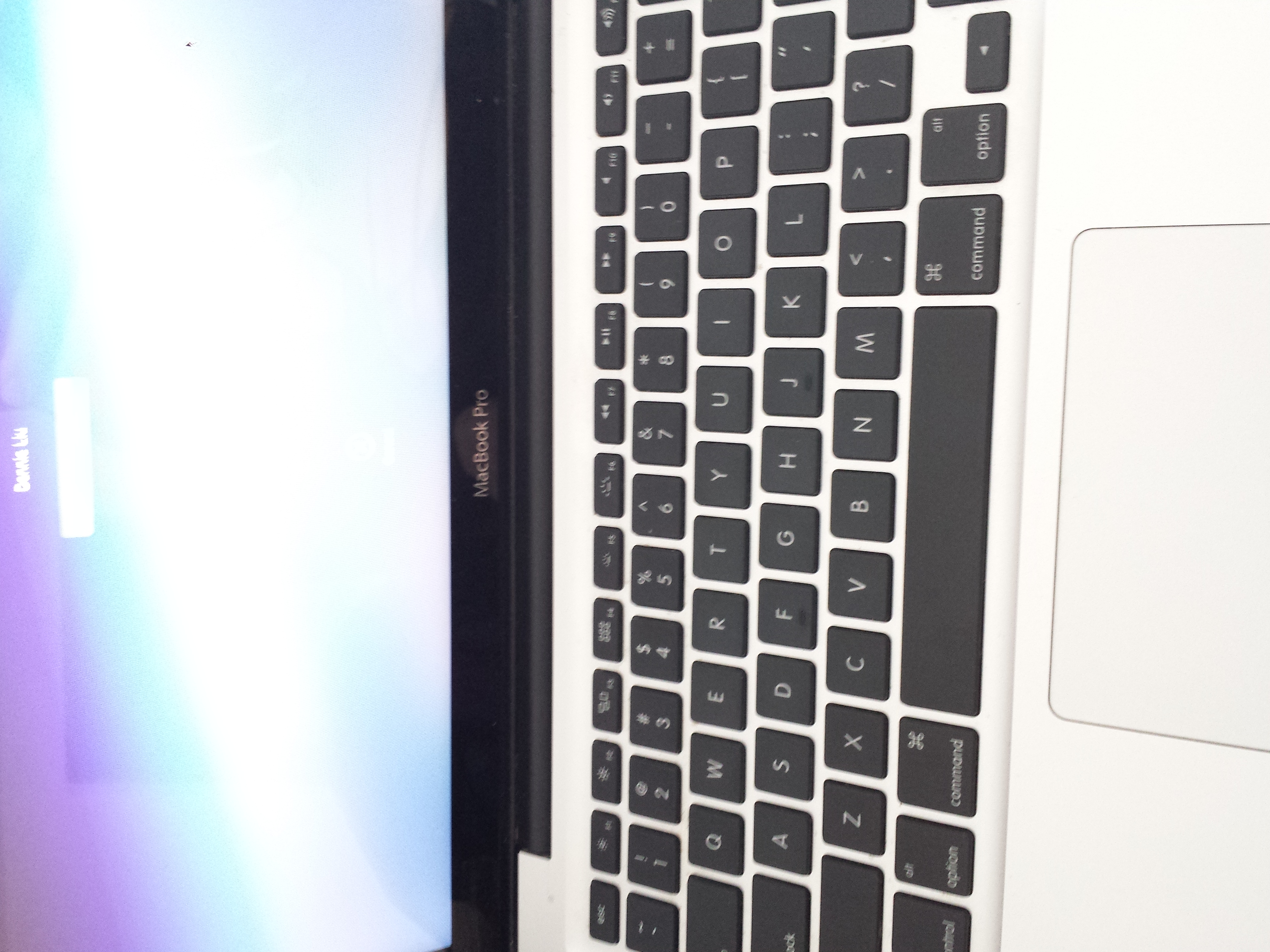

Guys I'm in trouble , my macbook get the white screen , only the led lcd on, the more the image does not appear, dismounted and saw a problem next to the LCD connector on the motherboard. My macbook a1278 I7 and realized the problems that had occurred. Anyone with any solution to my problem . I am Brazilian computer technician , but never went behind to solve this problem
Thank You
Thank You
Yeah. Looks like you shorted out the 3.3V that feeds the LCD screen. The ferrite bead (filter) has been vaporized. You will need to replace it with some creative soldering.

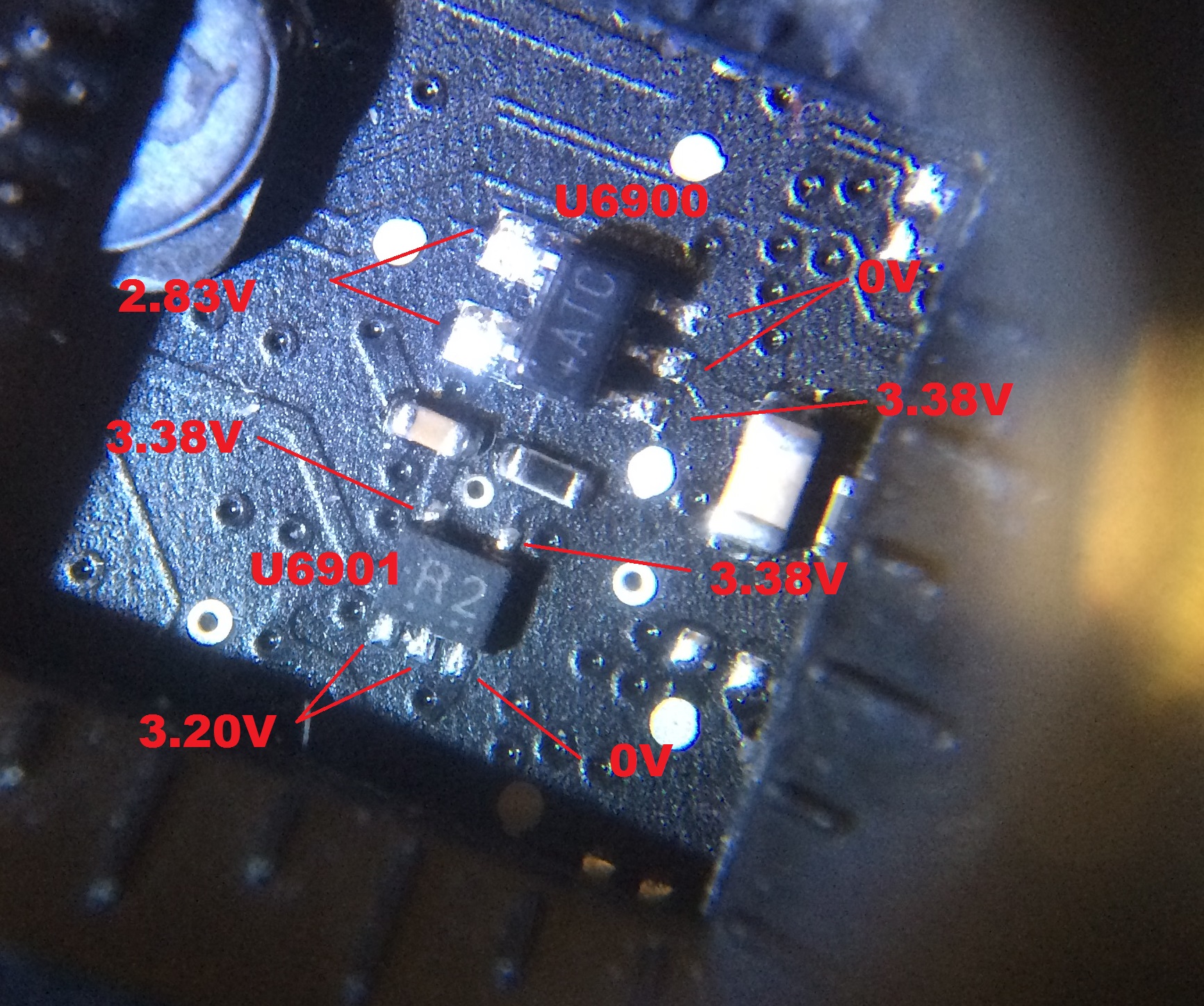

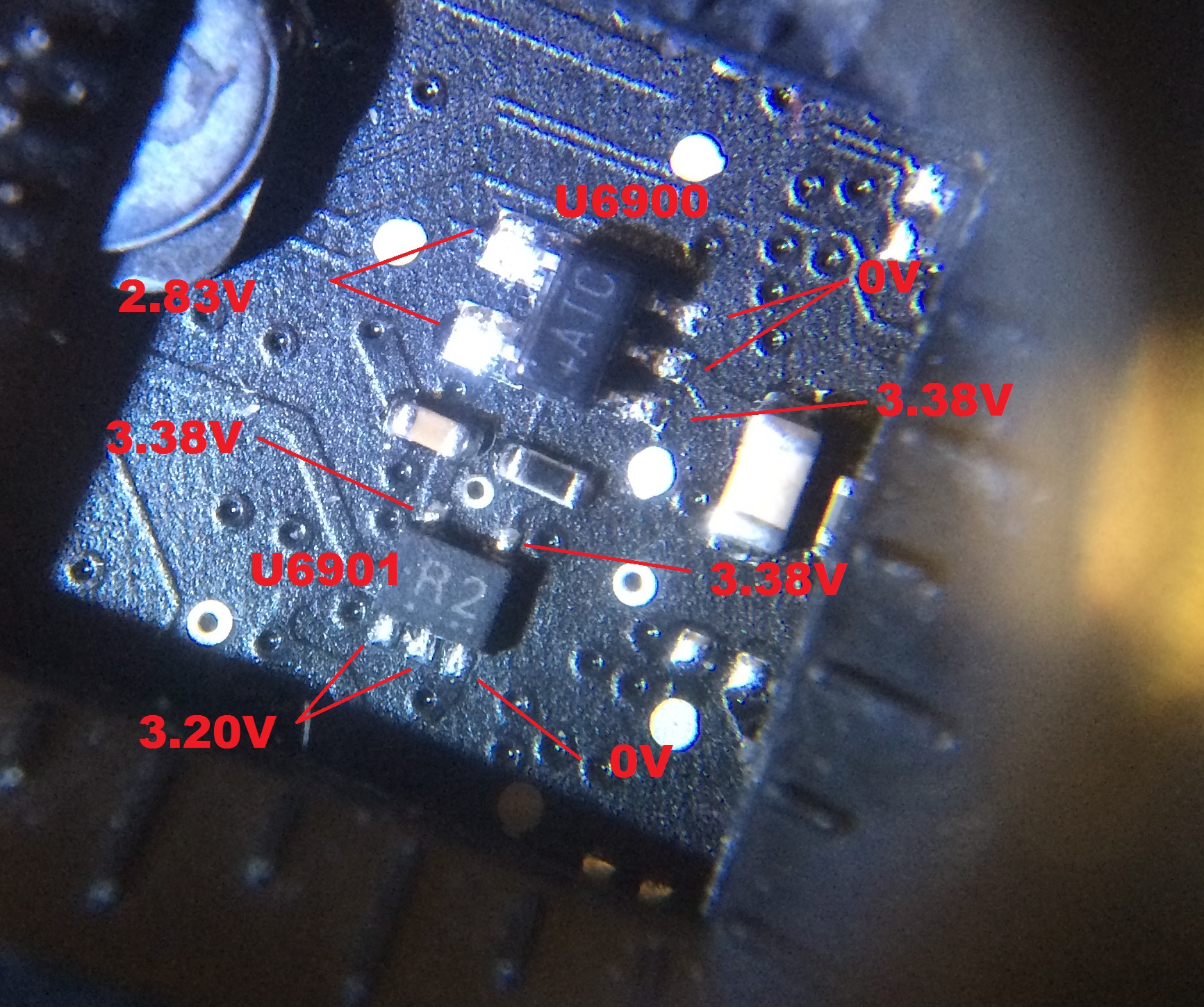

I have a 15" MBP A1286 mid 2010 i5 2.4GHz that died suddenly while on battery. After that the laptop doesn't boot or charge battery. Magsafe has only green led on. SMC reset does nothing and LB part number is 820-8250-A.
G3Hot measured 3.38V with and without battery. U7000 pin14 showing 3,20V with Magsafe. Magsafe board seems to be OK. Haven't tested with known good battery as I don't have spare.
I also measured U7000 pins 21 and 24 with battery and magsafe connected.
pin 21 LGATE shows 0.56V
pin 24 UGATE shows 13.35V
Battery connector pins 1-3 fluctuate between 4V-8V, pins 4 and 6 between 3.14V-3.38V, pin 5 0.01-0.03V
Any thoughts of this?

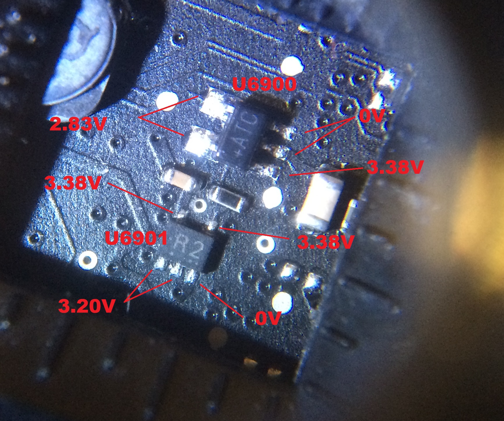

ps. also attached picture showing U6900 and U6901 voltages while battery and magsafe connected.
Starting point is to try with a good battery. You could spend a lot of time troubleshooting the ISL6259 (U7000) circuit when a battery replacement is all that is required.
A quick check is to unplug the battery and plug in the magsafe. Then measure what you are getting out of the ISL6259. Easiest place to check is on the white fuse near the device. It should be about 12.5V. If not, then there is something wrong with the charge circuit.
Measured the white fuse and it shows 12.53V but when I measured it again, it shows 12.53V but then drops to about 2.5V and back to 12.53V.
And sometimes Magsafe connector light doesn't light up at all and then the white fuse is measured steady 12.53V.
Should stay solid at 12.5V. If it is dropping off then there is something in the charge circuit that is detecting a fault and "hiccuping".
With power off test the resistances of the surrounding circuitry. Particularly sense resistors. Also, measure the resistance between each pin and ground of the ISL6259 charger. The typical measurements can be found somewhere in the thread.

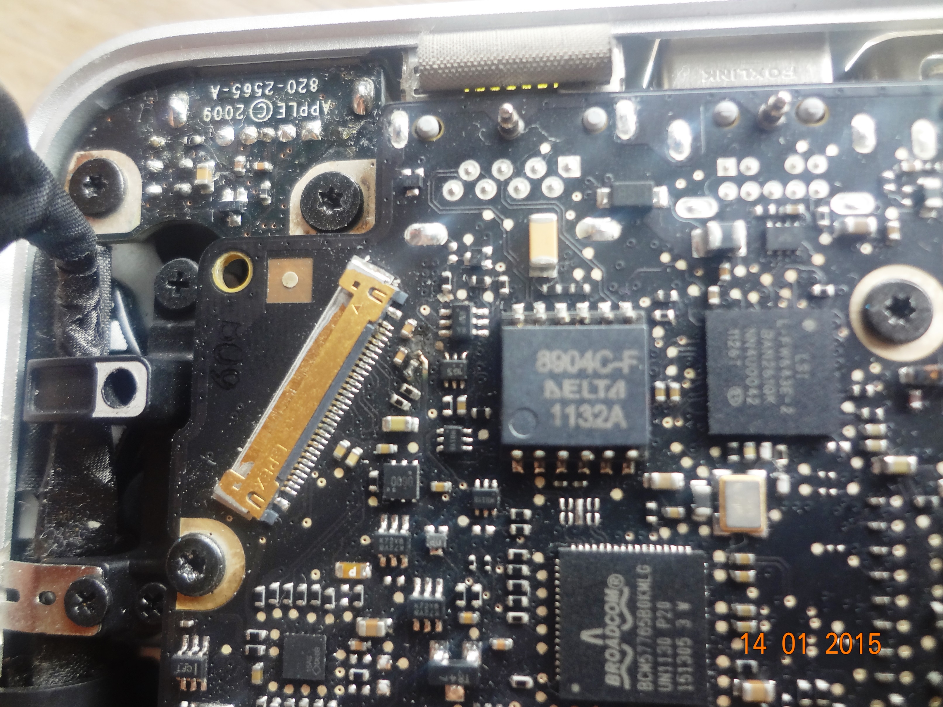

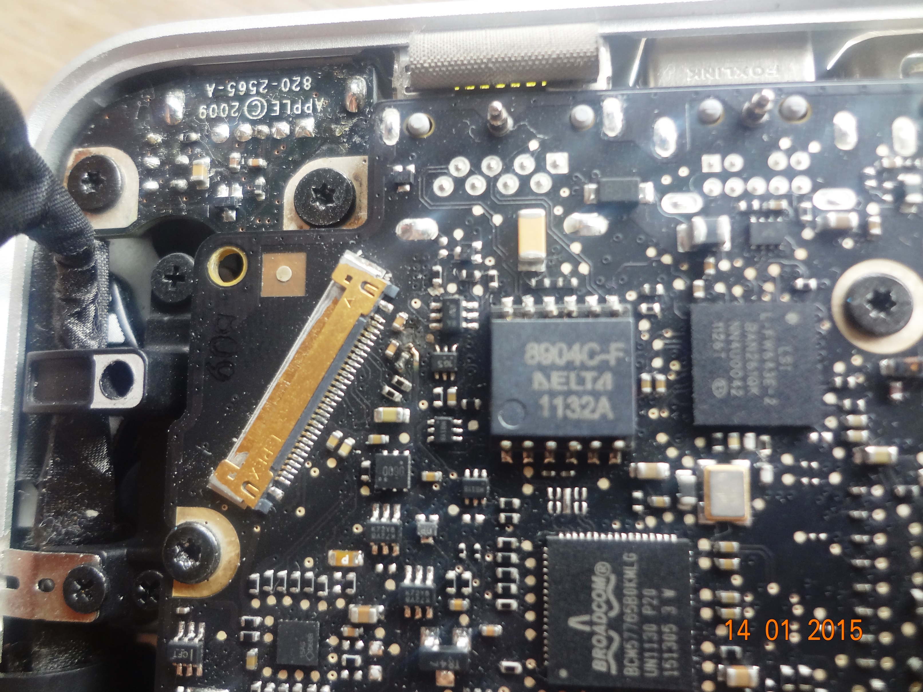

Hey guys I had problems with my A1278 logic board and I now have good news. I was lucky enough as I noticed the inductor in the one wire circuit fell off.
After asking for help and getting an inductor from Dadioh I managed to solder it on and guess what, green charging light is on!
So now I've got myself the same MacBook pro back and I just want to say thank you to everyone that still contribute to this topic. You are all very kind!
Cheers!

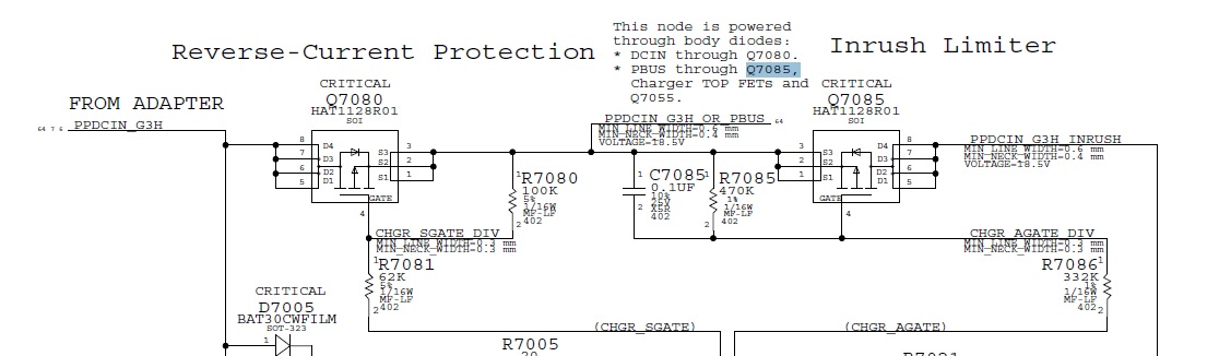

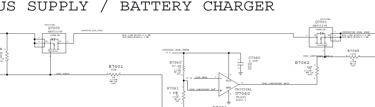

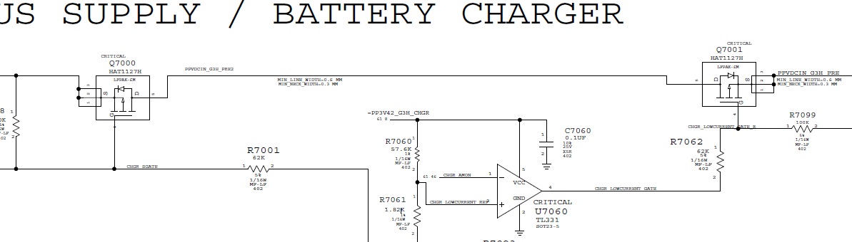

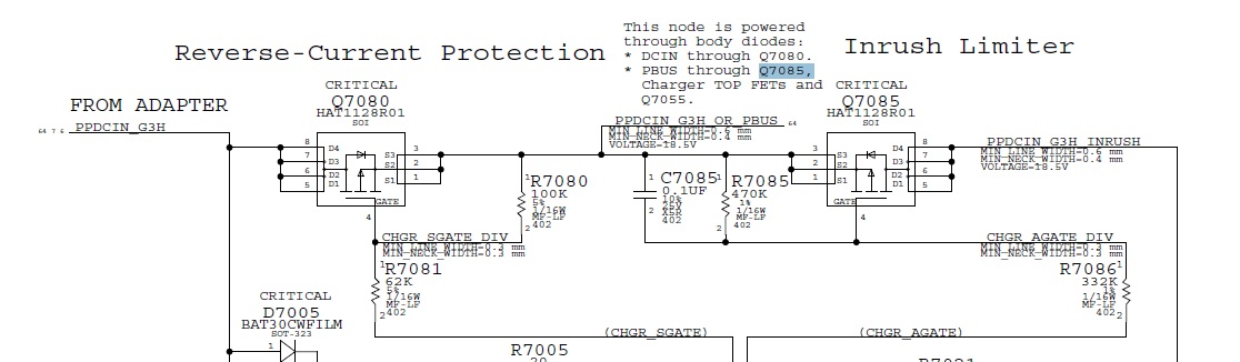

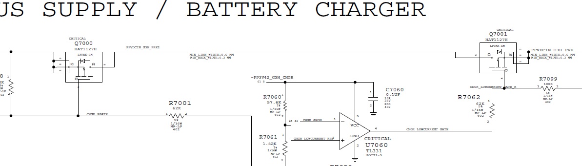

Started measuring from Magsafe connector and found out that Q7085 has interesting fluctuating voltages. Before Q7085 is Q7080 that has steady voltages 16.50V on PINS 5-8, 16.05V on PINS 1-3 and 15.85V on PIN 4 but Q7085 has 16.05V on PINS 1-3 and then PIN 4 fluctuating between 4V to 15.30V and PINS 5-8 fluctuating between 4V to 16.00V.
Does this mean that Q7085 is bad? Can you or someone measure voltages from known good board? I believe these are marked Q7000 and Q7001 on 13" MBP.

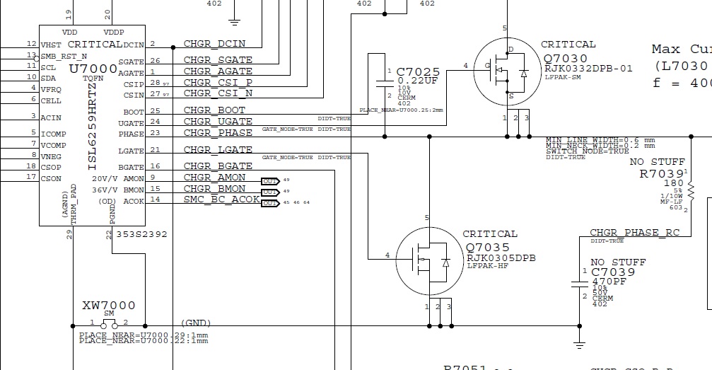

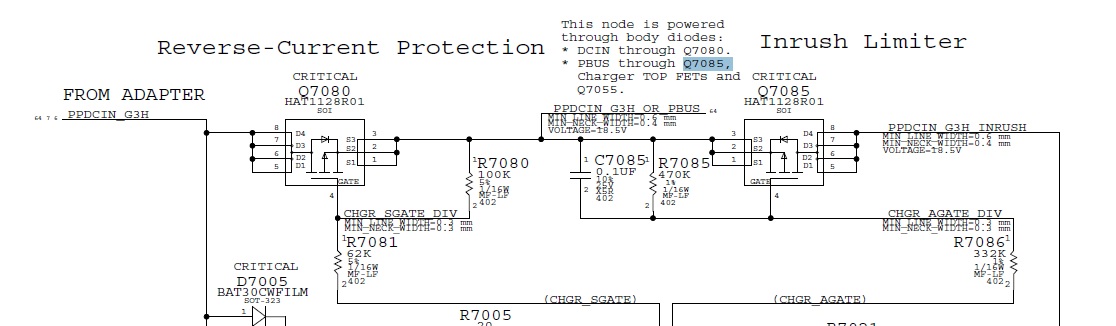

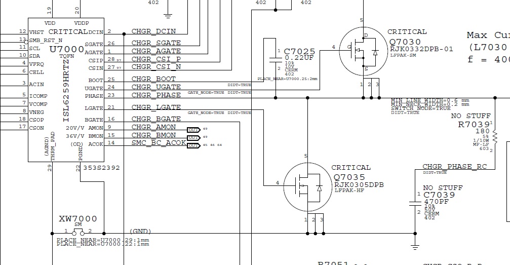

I think you mean Q7030 and Q7035 on 13" i5 and i7
I don't have the schematics and .brd for that particular model but of what you are saying you have to check the connection between pin16 of U7000 and pin4 on Q7055 for short than check the current control U7000 CHGR_CSI_P pin28 to R7020 pin1 = 10 ohm , U7000 CHGR_CSI_N pin27 to R7020 pin2 = 10ohm.
on 13" MBP. Very often happens to be burned via on those connections.
Also check them for short to ground especially pin16 on U7000 (CHGR_BGATE), C7026 go bad sometimes.
But most of the time lead to burnout U7000. I cant help further without schematics and board view for your specific model.
But in any case I wish you luck.

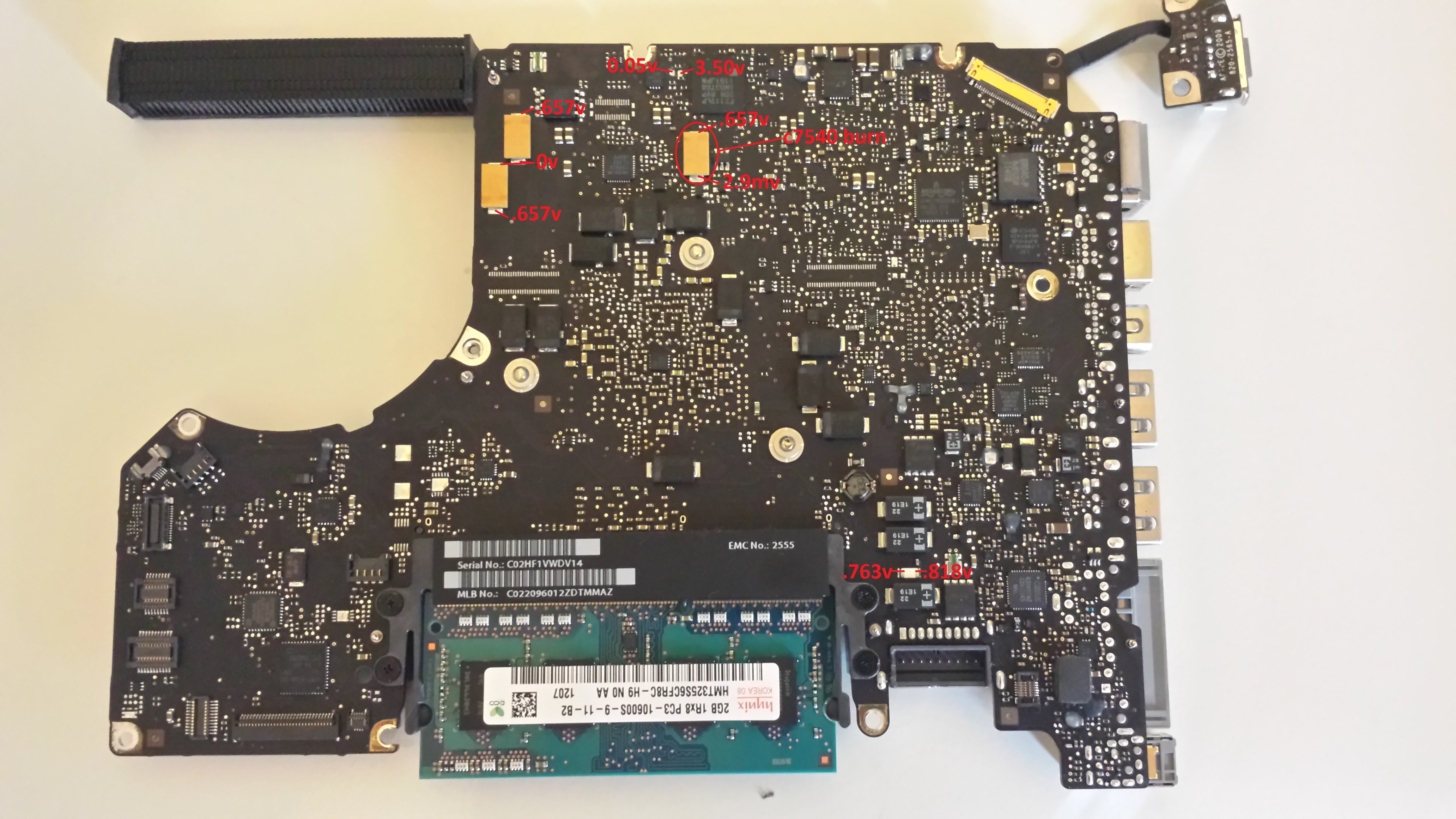

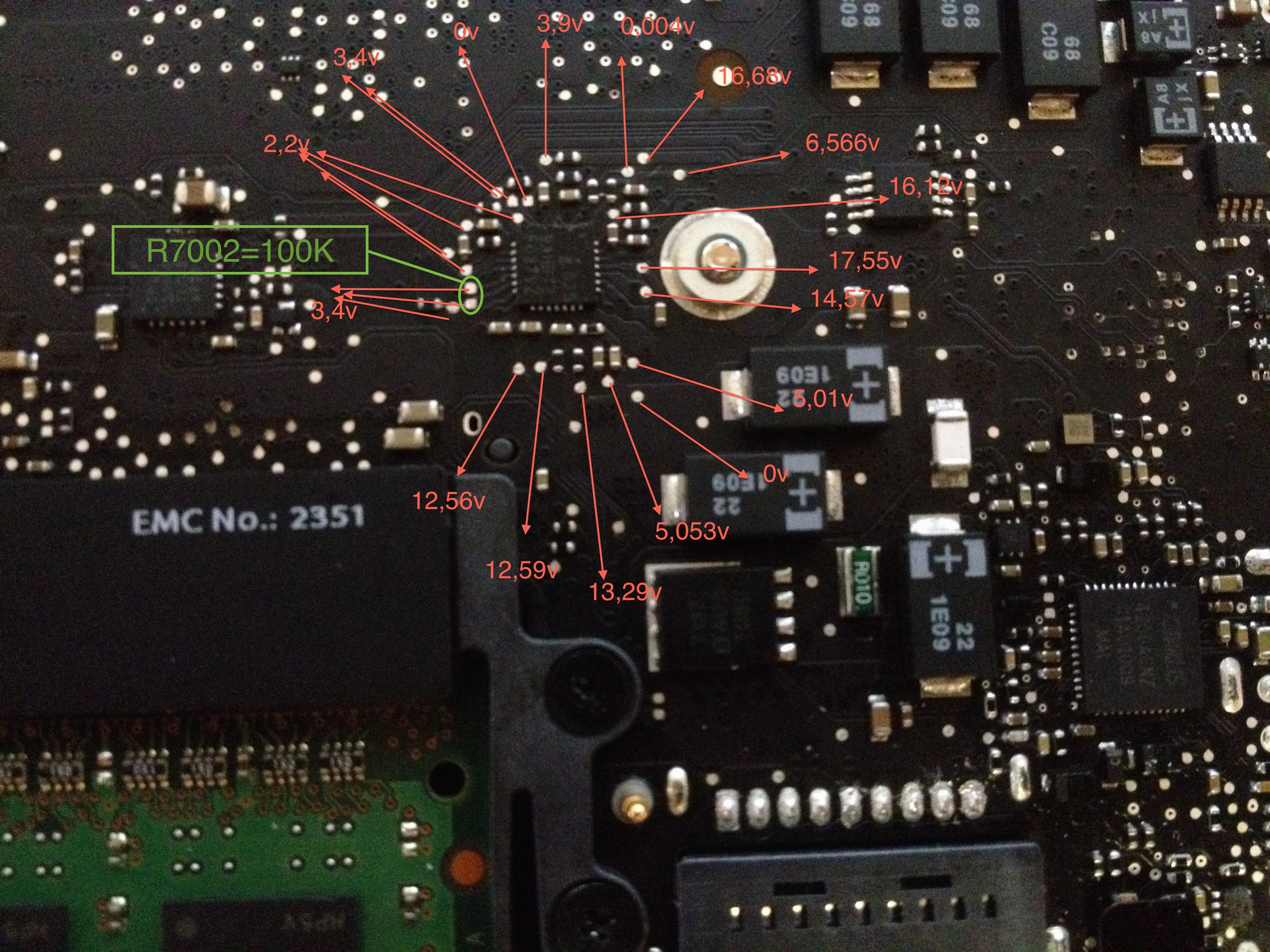

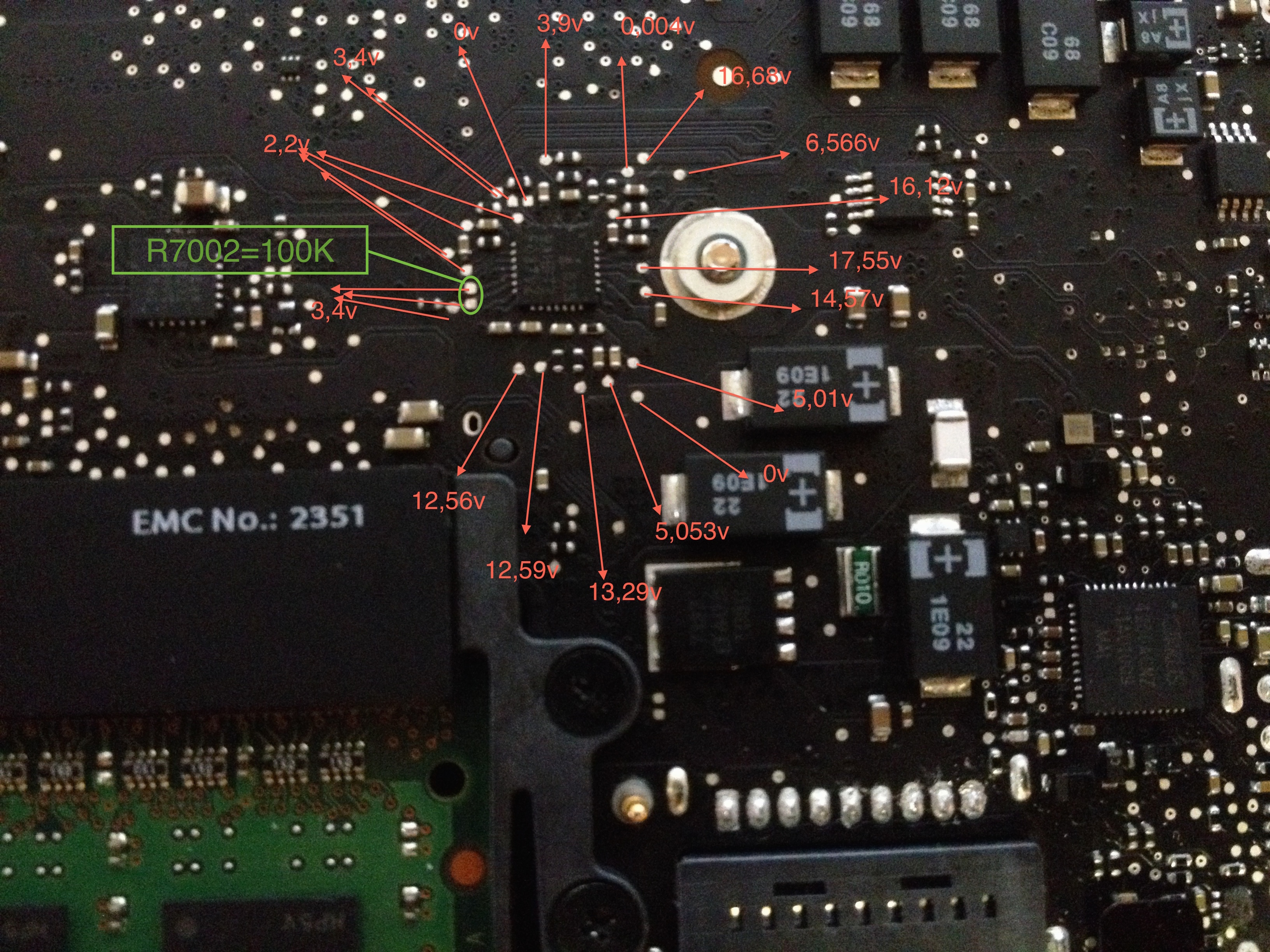

Here is some voltages around charger chip. Magsafe on and battery connected.
edit. and for additional info for everybody who wants to help: mid2010 mbp, doesn't charge, detects battery and tells cycles etc. works alone with battery, works with battery and magsafe, doesn't work with magsafe only (except smc bypass mode)
Before trying anything you can consider putting back R7002 (it is missing on your picture)
On some boards (820-2879-B) it is missing from factory also try measuring from U7000 both paths to R7020 and both paths to R7050 thru R7051, R7052 and R7021 R7022. It is definitely something around U7000.

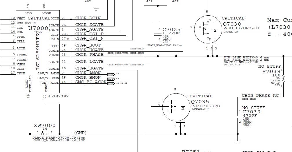

No, I mean on 15" Q7080 and Q7085 are the same as Q7000 and Q7001 on 13" and MBP15 Q7030 is Q7020 on MBP13, MBP15 Q7035 is Q7021 on MBP13. At least in the shematics that I have, pics attached.
But measured short between pin16 U7000 and pin4 Q7055 and pin16 U7000 not short on ground.

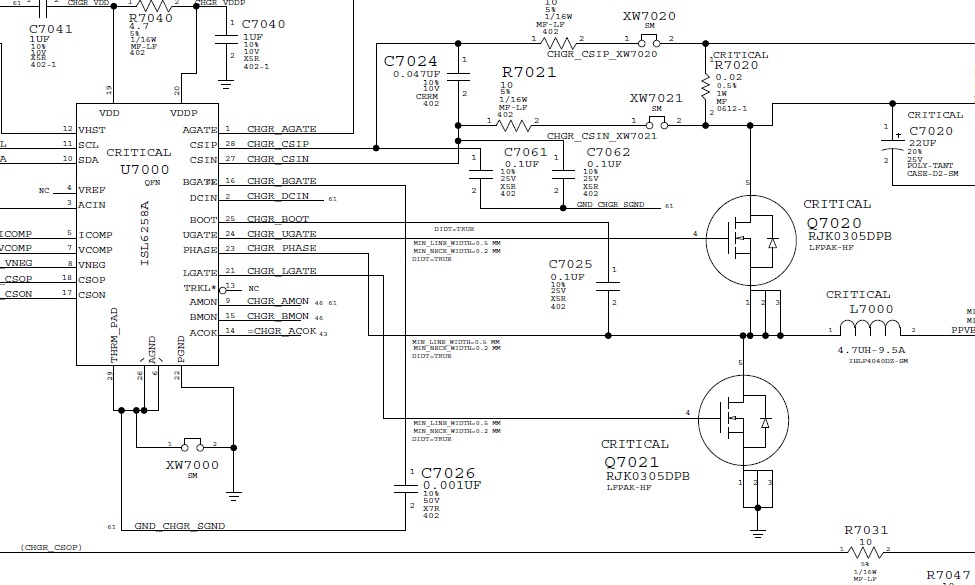

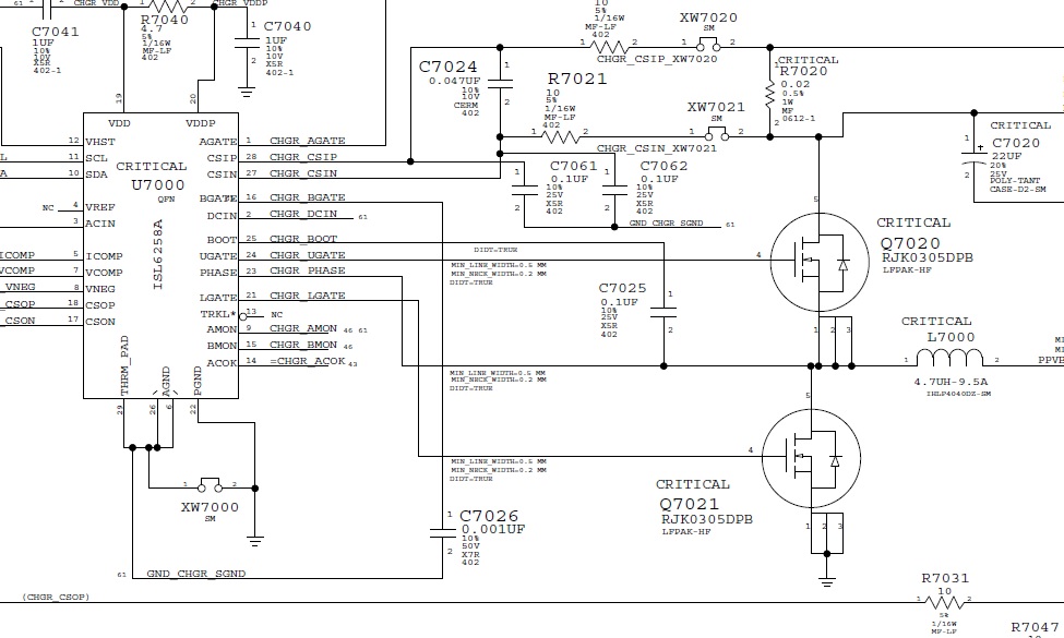

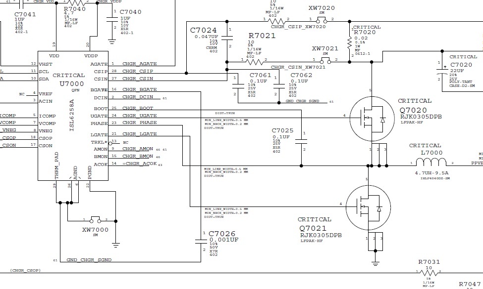

Do you have a solid connection between pin2 on R7020 and pin2 on R7021
also pin1 on R7020 and the other 10ohm resistor that i can't see... check the values of those two also.
I think U7000 shut down power supply because it thinks that machine consumes to much current.
Solid connection between pin2 R7020 and pin2 R7021
Solid connection between pin1 R7020 and pin1 R7022
R7021 measures 10.5ohm and R7022 10.3ohm
U7000 CHGR_CSI_P pin28 to R7020 pin1 10.6ohm
U7000 CHGR_CSI_N pin27 to R7020 pin2 10.5ohm

Hello all, what a great thread this is, I've been scavenging from it trying to figure out my problem with no luck. Here is my situation.
Early 2011 MBP. MB: 820-2915-B
The Magsafe light is dim green and that is all, no power, nothing.
I am getting good voltages from DC-in board. So after some reading I jumped to checking U7000.
U7000 Pin 3 reads 0V which is the reading I'm getting from R7011.
R7010 I am getting 16.5V on one side and 0V on the other. I read I'm supposed to be getting about 4V out of here?
Does anyone have any suggestions? Thanks!!
I am working also on a 1278 MBP board ... and this one have problem
to charge the battery and working with both magsafe and battery together.
It works on battery, it works on magsafe but it freezes if I attach both.
But very strage thing is that if I put a bit of Isopropilic alcohol on
u7000 (alias isl6259) it works for a couple of minutes and charges
the battery. When the alcohol dries it fall back to the previous status.
Can someone explain me why?
