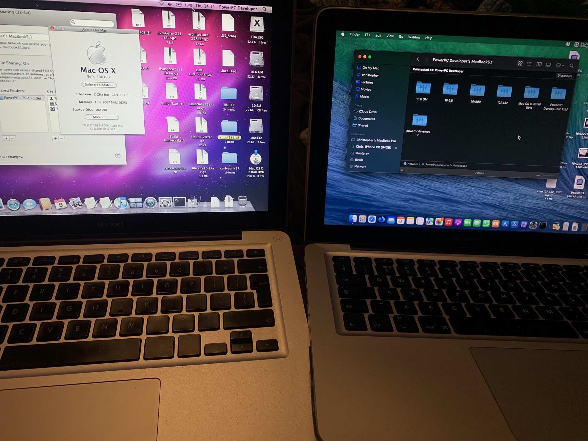

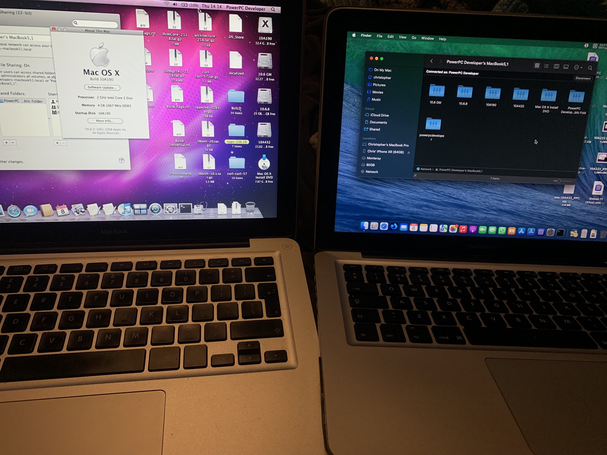

File Sharing works as expected on 10A190 running on my intel MacBook test machine - this is either because of the updated binaries (particularly CUPS which you should update first) or it just isn’t broken on intel. I will test on one of the PowerPC machines later.

File Sharing works as expected on 10A190 running on my intel MacBook test machine - this is either because of the updated binaries (particularly CUPS which you should update first) or it just isn’t broken on intel. I will test on one of the PowerPC machines later.View attachment 2404014
I did not tweak anything in the 10a190 on i386, and I did not see the machine on a local network, as far as I recall. Won’t bet money on that now, need to check.

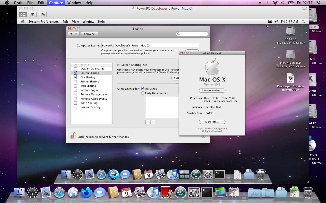

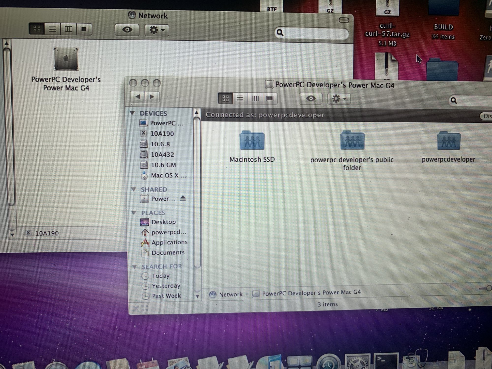

Hi all! I'm half-way through upgrading the Quicksilver; currently sporting Dual 1.33ghz 7455 with 2mb L3 cache, a Belkin PCI USB 2.0 card, a 120GB OCZ Agility 3 SSD connected via a PATA to SATA bridge adapter, 2 x SATA HDDs for storage connected to a Highpoint PCI SATA Card, 1.5GB SDRAM, DVDRW...and a Geforce2...until the 7800GS is Flashed properly for the second G5 PowerMac at which point i can move over the X800XT.
Suffice it to say that this has taken me a bit more than few hours today, particularly with fresh software installs, so i've not had much time to delve into the File Sharing issues.
That being said, as this system will be another SL_PPC test system (to add to the 2 x iBooks, 2 x Powerbooks, PowerMac G4 Digital Audio, 1 x AGP PMG5, 1 x PCIe G5 and intel MacBook systems i currently use for this project) I have imaged over a fresh 10A190 and applied ONLY the CUPS fix i suggested above. The system is detected now and Screen Sharing works correctly, as well as software update, the Firewall preference pane etc.

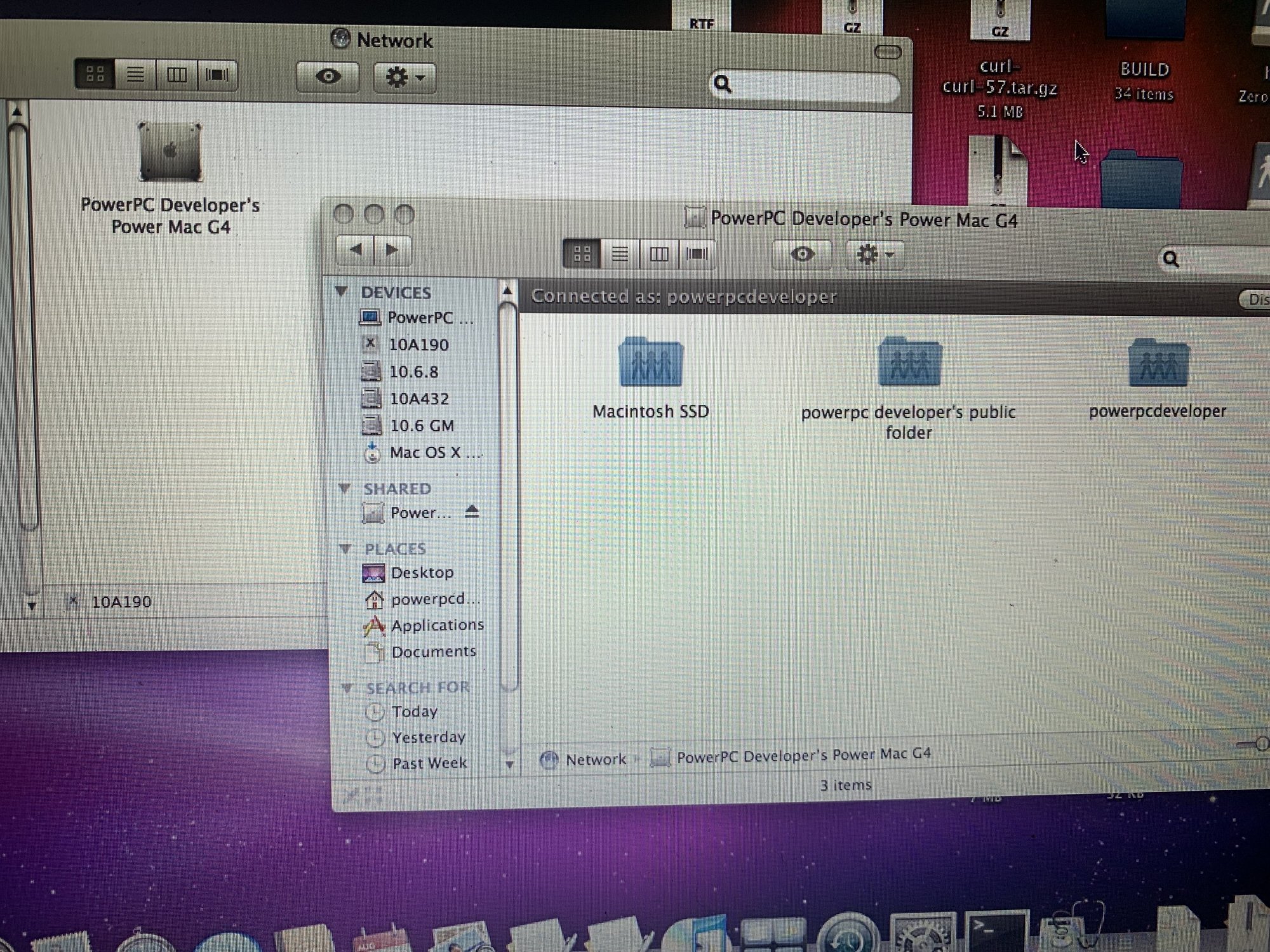

File Sharing looks like it requires some more tinkering...when i get a chance i'll see if the results differ on the more modified of my systems.
EDIT:
Thought i’d try one last thing before going to bed. Unchecked afp and selected only smb file sharing and low and behold…
SMB File Sharing fully working on 10A190 replacing only the CUPS binaries detailed earlier in the thread and linked in the wikipost.

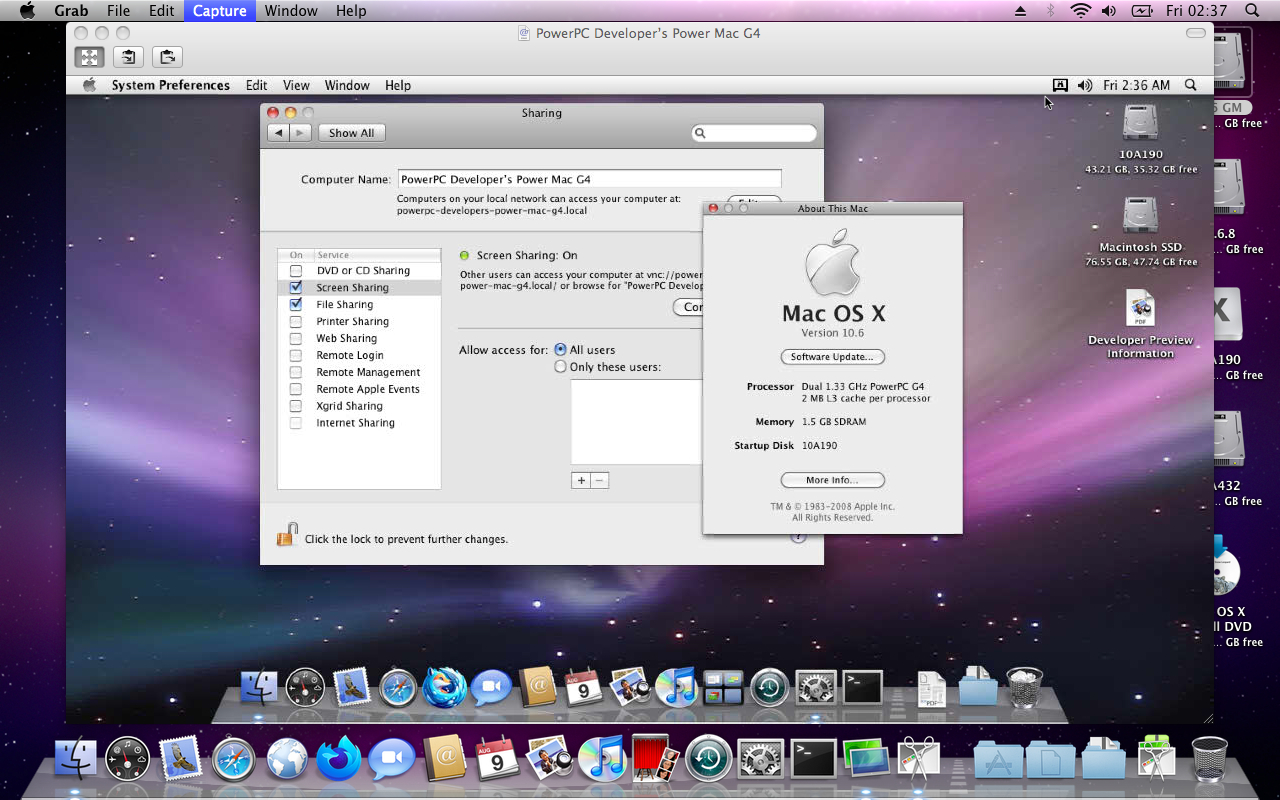

EDIT:

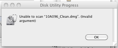

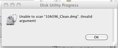

Ok, how is 10a96 supposed to be cloned? (Same Disk Utility has no issues with cloning 10a190 dmg.)
May be a corrupt .dmg @barracuda156. Try downloading again. It should restore in Disk Utility but if it doesn’t try CCC or SuperDuper.

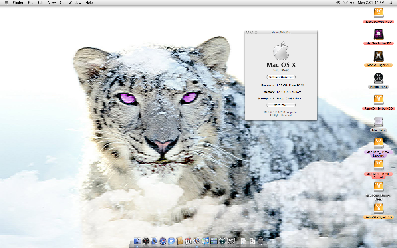

I just got my iMac G4 20 inch 1.25GHz back up and running (had a bad PSU). 10A190 has a kernel panic at boot, but 10A96 is working. I've tried searching and reading through this stream, but didn't see if anyone specifically mention if they got full graphics acceleration working in the AGP Nvidia 5200 Ultra that's inside this computer.
I'm going to try to copy over some kext from my 10.5.8 drive, but have a feeling that won't be good enough, and I've only seem the PCI 5200 mentioned as working.
I anyone has any insight on getting this to work will full acceleration, and/or getting 10A190 to boot on this model, I'd appreciate it.
Thanks!
