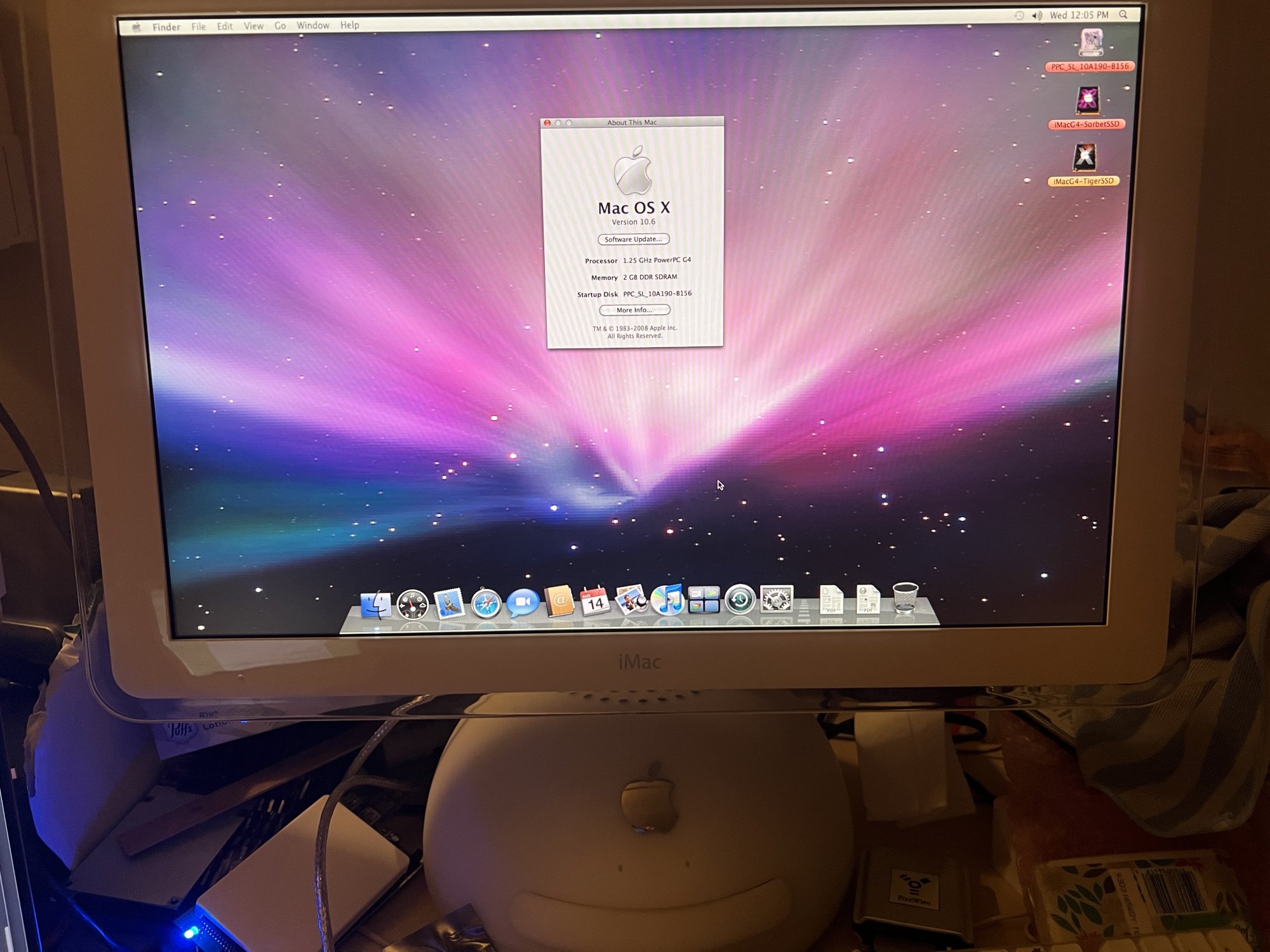

Thanks, I'm downloading this now to test.
To answer your other question, I don't have anything unusual connected, It's just an iMac G4, with only the USB keyboard and mouse. However, I am booting an external FireWire drive, as I don't have enough space on the internal to keep Snow Leopard on it. I may eventually upgrade the drive, but its a pain to replace it inside the iMac.

Ok, thanks for confirming. It may have been a bad copy or corrupted DMG. I'll trash the one I have and redownload for my personal archive.
I'm currently 2 mins ways from restoring the version you uploaded. I'll boot it up when it's done and see what happens.
Do you have anything specific you want me to test to look out for?

Works!

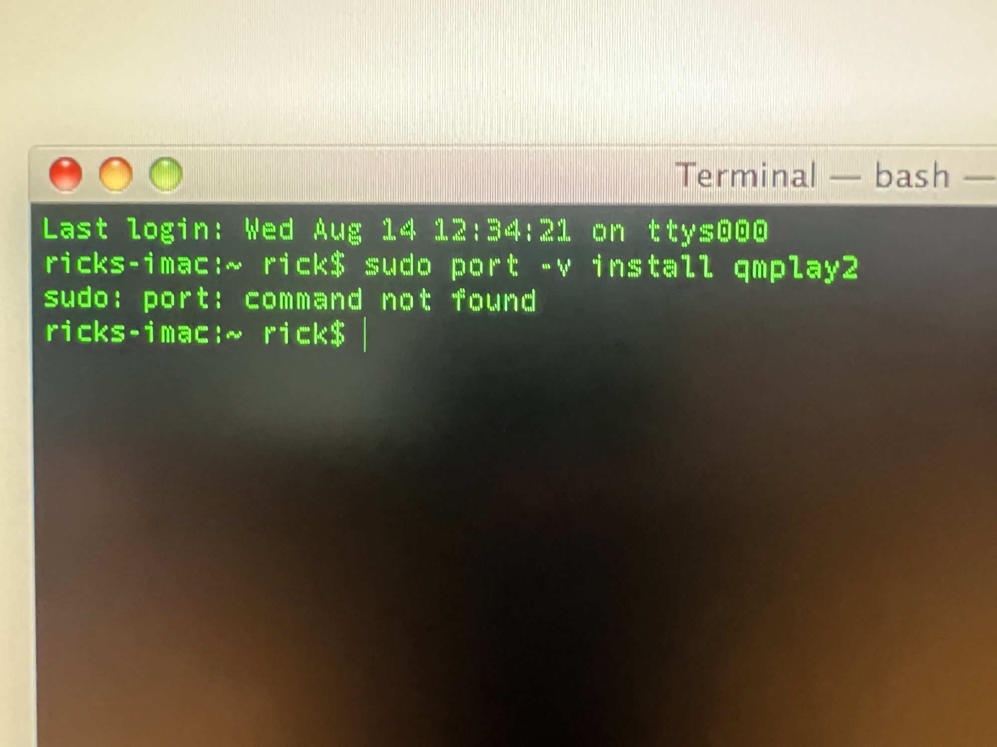

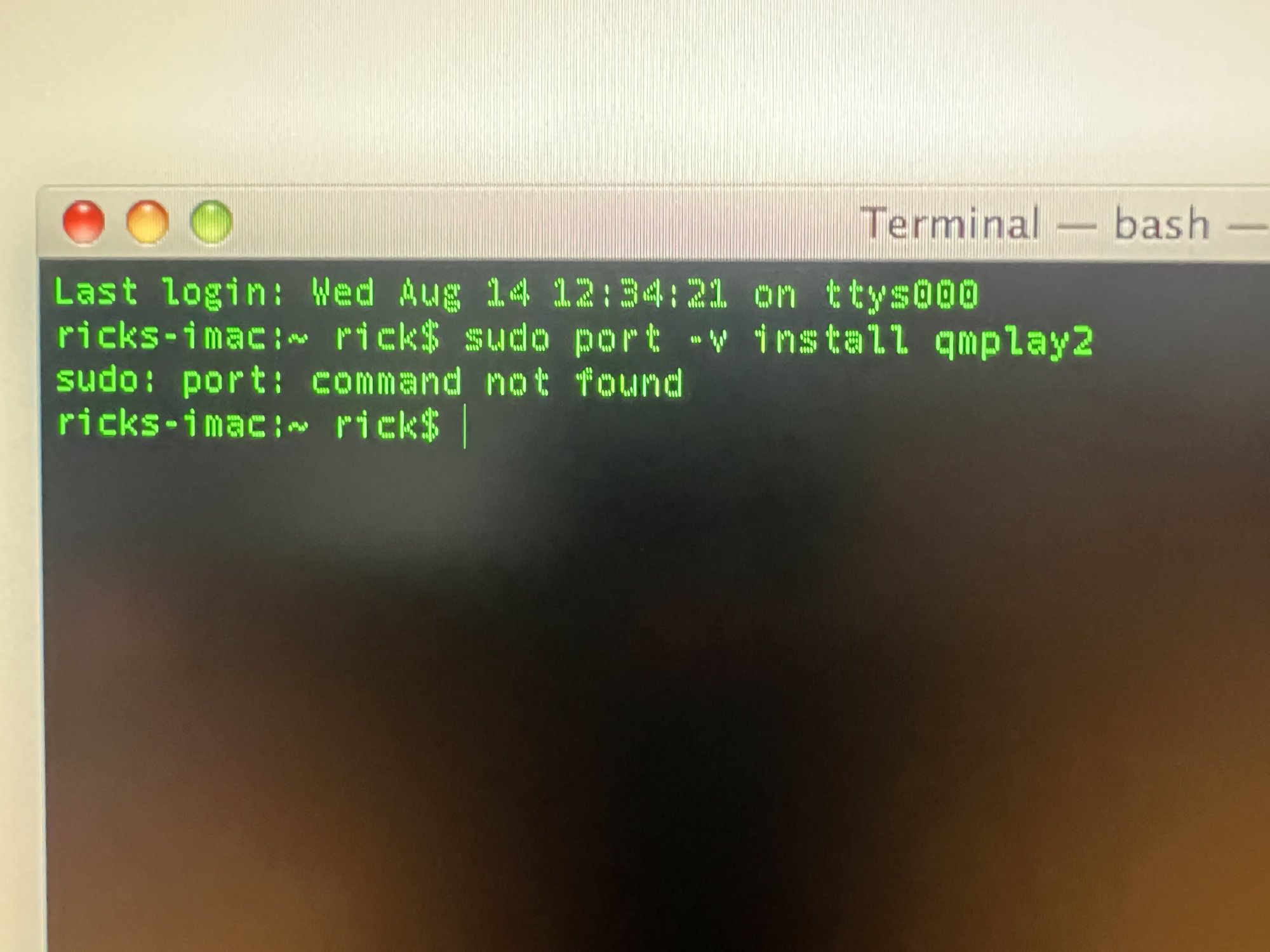

It says that port is now a command (screenshot attached she can verify I typed it properly). Let me know what I need to do to get port installed.
export PATH=/opt/local/bin:/opt/local/sbin:/usr/bin:/usr/sbin:/bin:/sbin
MacPorts guide has it (MacPorts and the shell section), but I guess I need to explicitly describe that here.
(Add it to your shell config file in your Home folder, then no need to do this every time by hand.)

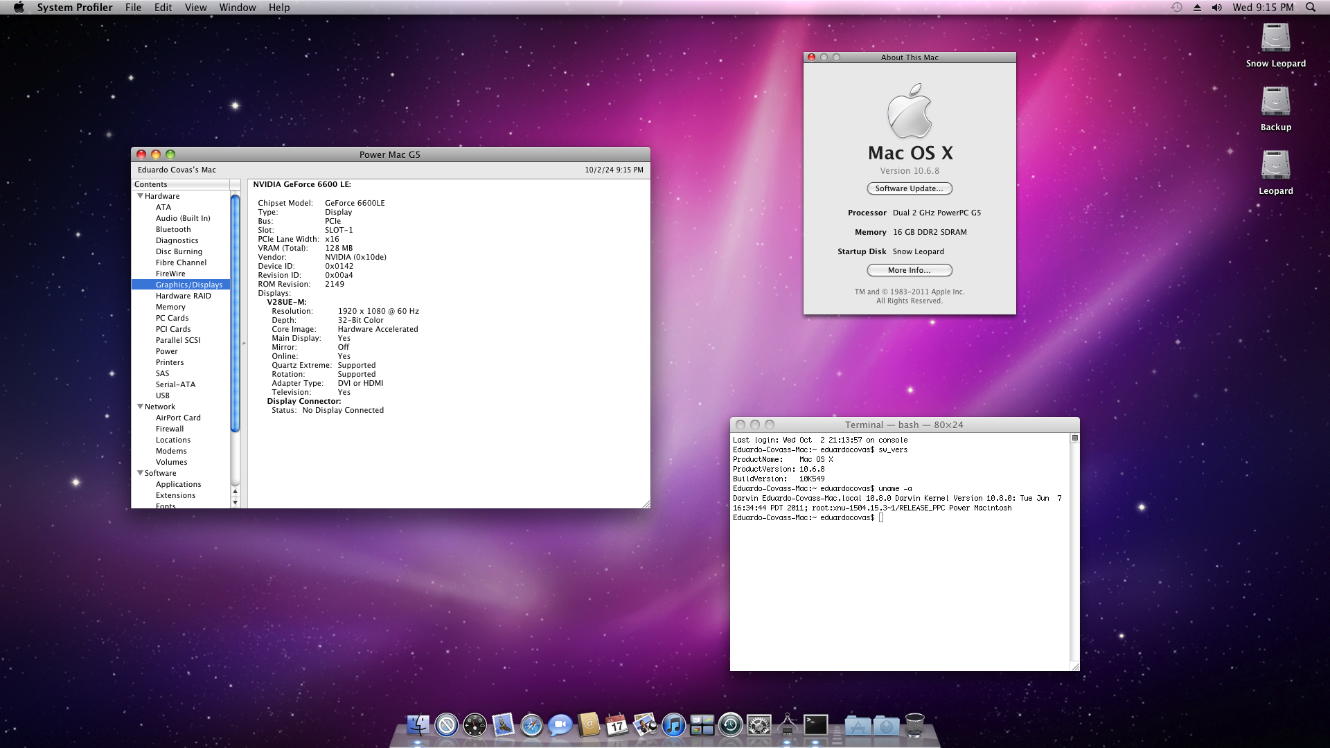

Looking forward to getting to grips with this! I devised a way of installing the bare minimum essentials from a script running in the installer/recovey method for 10.7 osx86, found all that stuff too so i could have had an I7 with osx 10.7 still, but sadly i must have binned the laptop due to hw issues i could have fixed, now...
i ran a bit short on space copying stuff to USB from the PowerBook, and i didn't check the osx partition's i had, i just remembered i needed some old stuff and decided ' im going to have to get to grips with GRUB and booting from OF to USB anyway and include my yaboot conf and all to boot MorphOS anyway, i might as well grab some base files ' while doing a different project and slowly brainstorming. ' found this script i think 'i ran once' inst.osx.sh but i cant find it now even though i was sure i included that somehwere. I had it open in an editor and quickly went over it. Basically all thag was needed was to delete or move etc/rc.cdrom.sh or what it was after installing the base system. From in that manner. I'm thinking it can be done via the Darling project now.

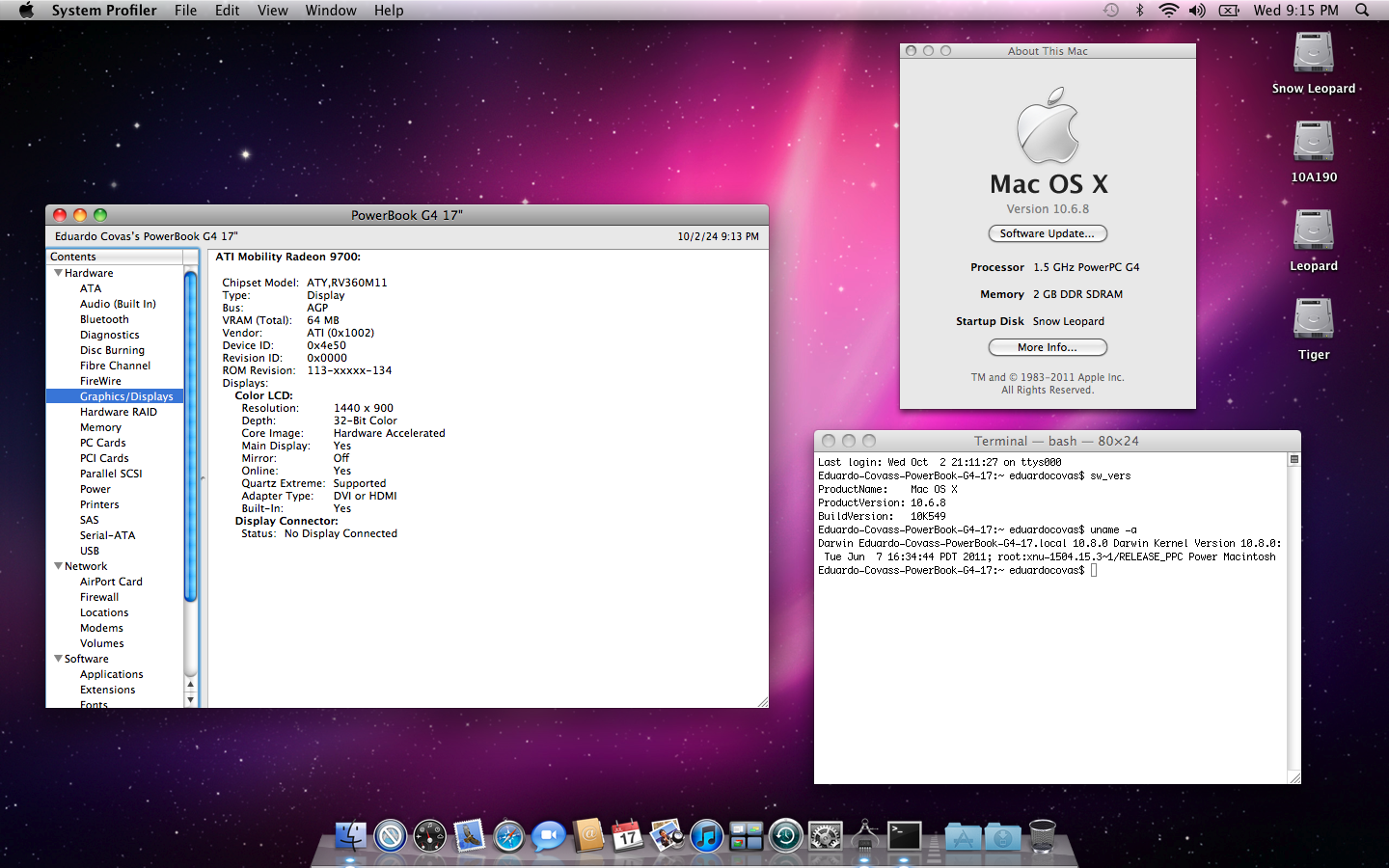

I've decided to share what I have because I won't be working on this anymore. Maybe someone would want to fix the problems that are still around and I was unable to fix. It has been tested on more than 20 different machines and it booted on most of them.
Known issues:
Bluetooth won’t find devices
Ethernet/Wifi doesn’t work (Self-assigned IP)
Finder CoverFlow frozen/glitchy
Spotlight indexing doesn’t work
Display losing signal after booting on some machines (PMG5 only?) needs to boot through the boot picker to work
Quick Look partially broken
Sleep doesn’t work
Probably much more I can't remember.

I’ve been tinkering with the image provided above since last night and managed to make a little progress on the networking issue. I haven’t identified the root cause of the current behavior yet but I did manage to get a working network interface.
Dealing specifically with the airport interface (en1) if I join my home network (WPA2 encryption) and then configure the connection manually (specifying IP address, netmask, router, and DNS) I can ping public IP addresses and establish SSH connections.
DNS resolution is not working. It is possible to pull up webpages in a browser if they are default content for a specific IP address. Load balanced sites (like Google) are a no go at the moment. Putting one of the Google IP addresses in the URL bar forces a redirect to the F5 and you end up with a non-resolving “http://google.com” that never returns content.
I have not yet tried setting up a hosts file (kinda late for me now) to see if local domain resolution works but will give it a go tomorrow if no one else does before I get to it.
I wanted to post this before I get any further along in case someone else can use the info as a springboard for faster progress than I am able to make.
