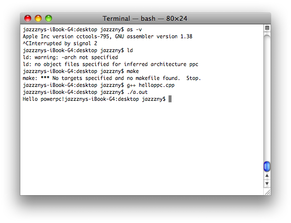

I have compiled a few of the most important projects that are required for a working compiler toolchain, which now means that Xcode 3.2.6 can be used properly (builds and links binaries, binaries work):
The following projects are mandatory for a working Xcode:
- ld64
- gcc (stock gcc is incomplete for ppc)
- cctools for the as tool
- gnumake
I have attached the binaries, and they need to be put in the proper locations after installing Xcode 3.2.6.
If you will build other ones, please upload. There are more binaries which lack ppc slices in 3.2.6, and that shows up. (Pulling over from 10a190 works, but is suboptimal, understandably.)

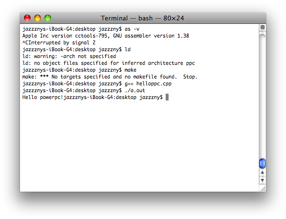

- ld64
- gnumake
