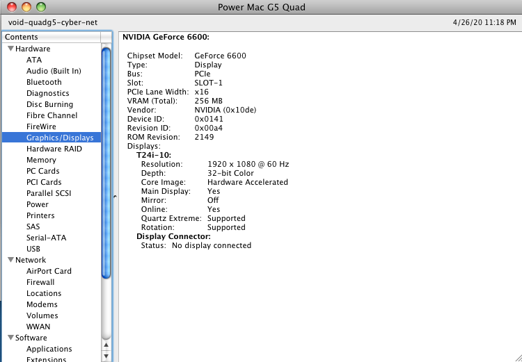

@Lars you can add Geforces in G5s as working
Best regards,
voidRunner
Fully accelerated with OpenGL? Which GeForce do you have in there? (The FX5200 in my iMac G5 currently cannot be "convinced" to do OpenGL).
Reactions: Amethyst1

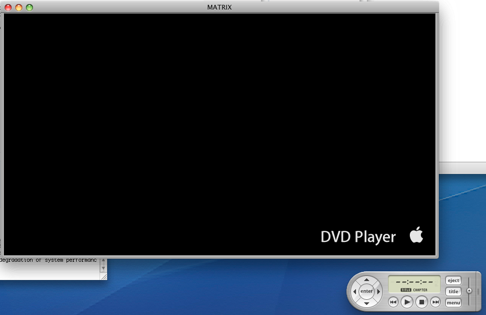

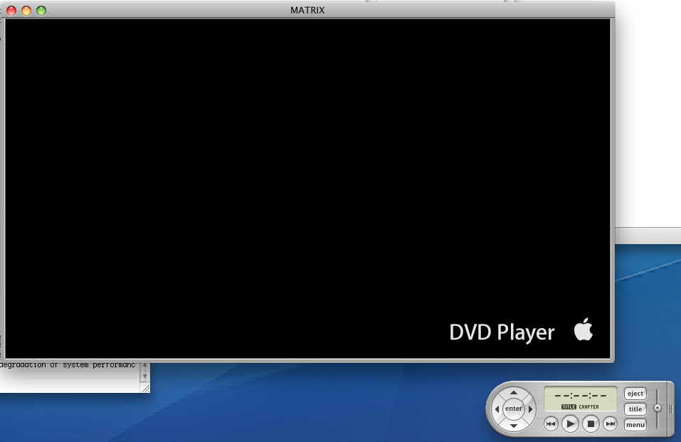

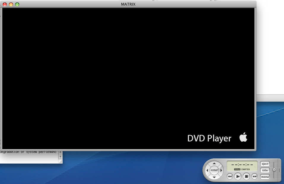

Hi Lars,
In System Profile my Geforce is recongnized like this ( see below ) so
I think it's fully supported.
I've also tried DVD Player which looks completely borked. But I've
copied the version from Tiger 10.4.11 along with the DVD Playack System Framework
and it works great no weird display.
You can also make it look almost like Leopard's so it can be a good replacement while
we find a "working" version. What do you thnk?
One think I've noticed is that images don't "stretch" so well they all show pixelated.
Any ideas?
I've also noticed that in System Preferences two of them do not open:
Displays
Printers
Everything else in there seems ok.
Best regards,
voidRunner

Hi Lars,
I ran Xbench Opengl test and it ran withou problems.
Should I run something else?
Best regards,
voidRunner

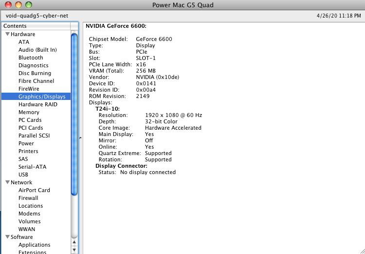

Hi Lars,
Any ideas?
Displays
Printers
Best regards,
voidRunner
