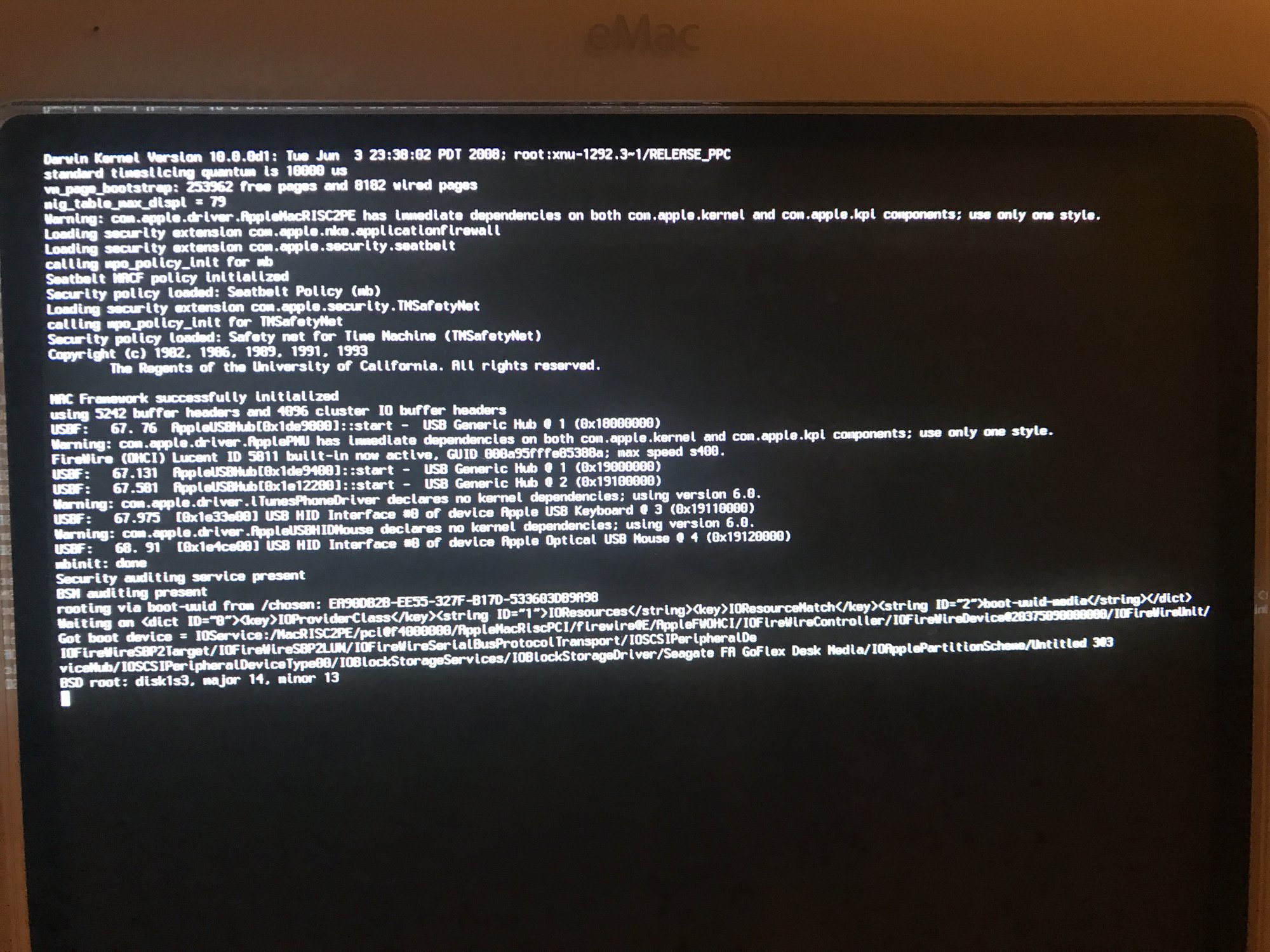

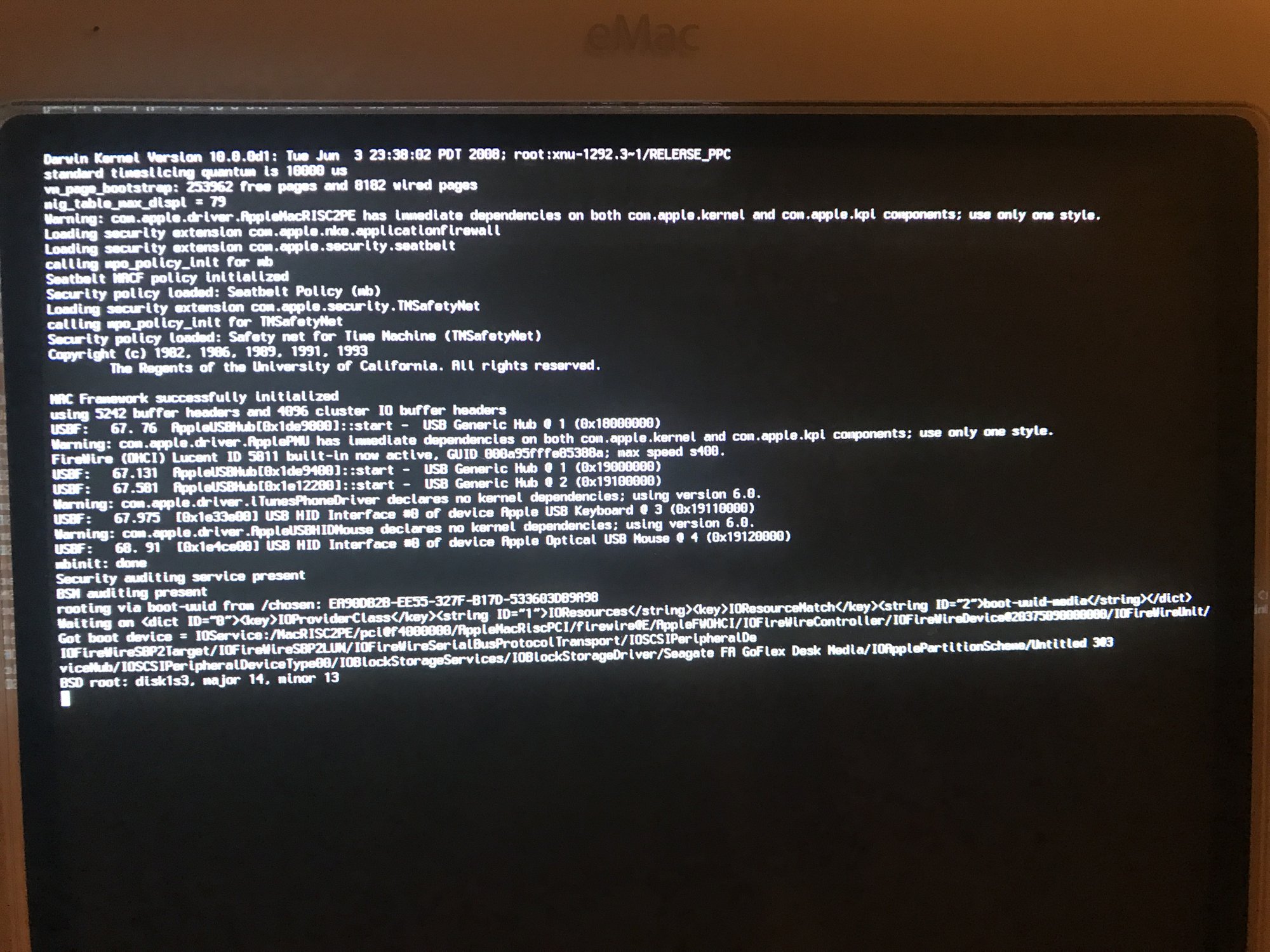

Looks like a different hang on my eMac. I’m not sure what I’m doing differently. When running the script it gives no such file or directory for the last two lines, removing Extensions.mkext and wwanConfig.bundle
But since it was going to remove those files anyway I didn’t see this as a problem.

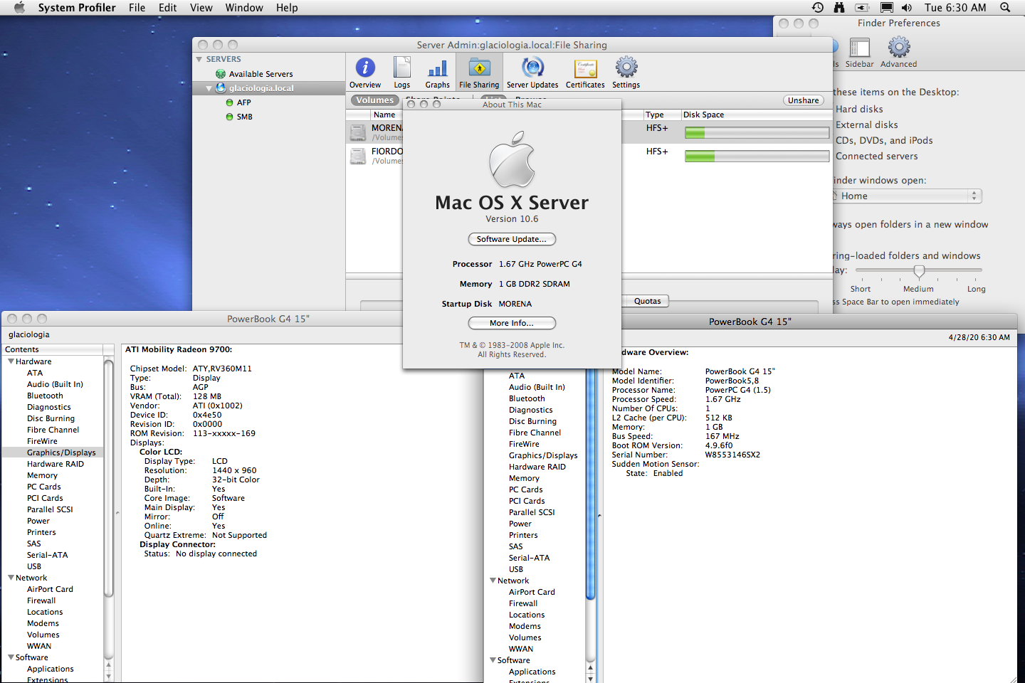

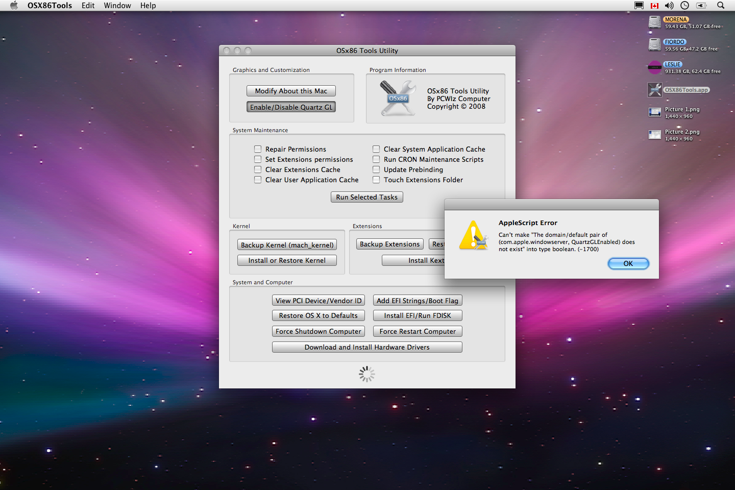

I installed using @vddrnnr’s step-by-step in post #26. This went onto an A1138 DLSD PowerBook G4 1.67 with 1GB RAM.
The install and set-up took some reboots, but I finally reached a Finder window.
Some notes:
System Profiler shows no support for Quartz Extreme for the onboard Mobility Radeon 9700 video card. This could be a matter of finding a kext for that series, since I’m not unsure whether the Mobility 9700 was carried over to Intel (and if not, might not have the proper kext or any kext for it; I’ll look into it shortly and update this post).
It is running on half the laptop’s OEM RAM capability (1GB instead of 2, since I only have one DIMM in). I haven’t yet run anything other than Server Admin.
Following installation (onto a second partition on the A1138), an Opt select upon reboot showed selections for both partitions with boot volumes, but on the first display, the 10.6DP volume was unlabelled sans partition name. On that first boot attempt (verbose), it didn’t halt (there were several errors), but it did hang at a grey screen.
Following unsuccessful first boot and hard-reset (holding power button), I booted by accident into the Leopard partition. From there, I directed System Pref pane for Startup Volume toward the 10.6DP and rebooted. This second boot into 10.6DP reached the server setup steps. I filled in all setup info, but instead of starting the server and launching Finder, the system stayed on the blue screen for an extensive time. I decided to ssh into the A1138 from another box was was able to. From there, I sent a root command to reboot. That forced verbose display on the A1138 to show it was stuck on a couple of processes and, as with before, required another hard-reset.
On the second boot, the system successfully opened to the login screen and then opened Finder. For now, that’s where I am.
Edit with additional notes (ongoing):
  • One thing which is a bit sluggish is when opening the Applications window, as it drags responsiveness while it calculates the size of each application, but this is probably due to this being an early Finder version which didn’t reach golden master.
  • Another thing: “Verify/Repair Disk Permissions” in Disk Utility doesn’t really run. It starts and finishes with a couple of seconds. I tried opening the Leopard build of DiskUtil, which was not successful. Update: I ran Repair Disk Permissions on 10.6DP from Leopard boot without trouble.

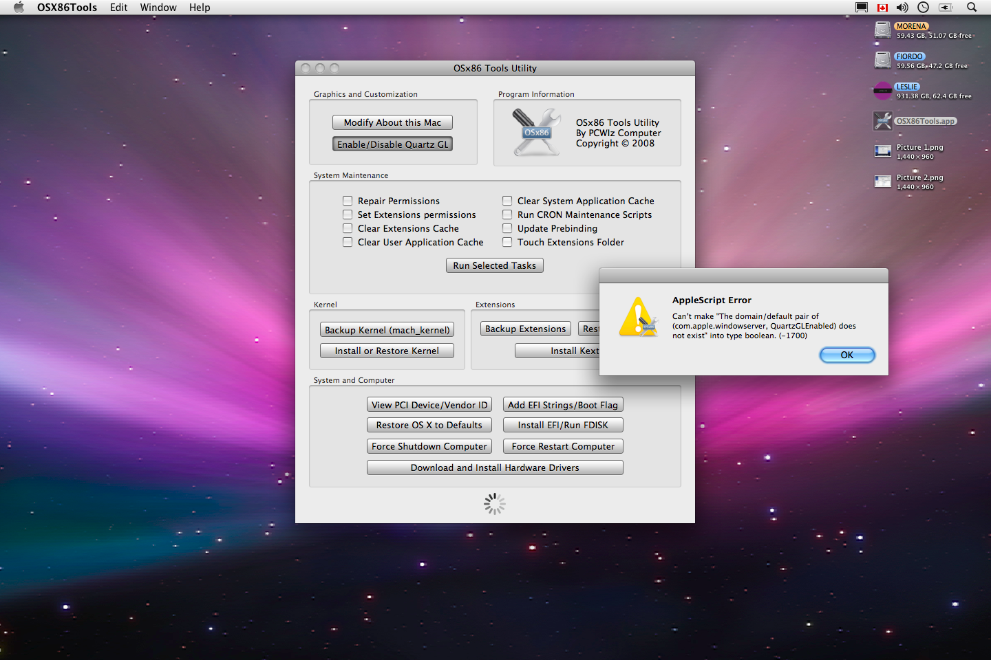

  • When using the OSX86Tools (see first page of this thread) utility and trying to activate Enable/Disable Quartz GL, this modal error pops up:
    This comports with the inability to get Radeon Mobility 9700 card; the Radeon 9xxx series kexts (and other ATI kexts) from Leopard; and the 10.6DP kexts (which lacked ATI Radeon 9xxx kexts) to work together. I did install ATIccelerator and set up the overclocking to match its usual settings in Leopard, but this has no impact on performance when the card can’t tap into QuartzExtreme/CoreImage.
  • There is possibly a hair less lag with TFF (FPR21) using @eyoungren’s last prefs.js file, but visible lag could also be from graphics re-drawing slowness relating to the previous bullet item.
  • Applications which run on my setup (and which haven’t been mentioned by others):
  • Application which launch on my setup but won’t do certain tasks: Software Update (even to check for Java updates); Disk Utility (won’t verify/repair permissions); iTunes 10.6.3 (launches, but then holds with one menubar item titled “iTunes”)
  • Applications which do not run on my setup: System Pref pane Printers
More later.

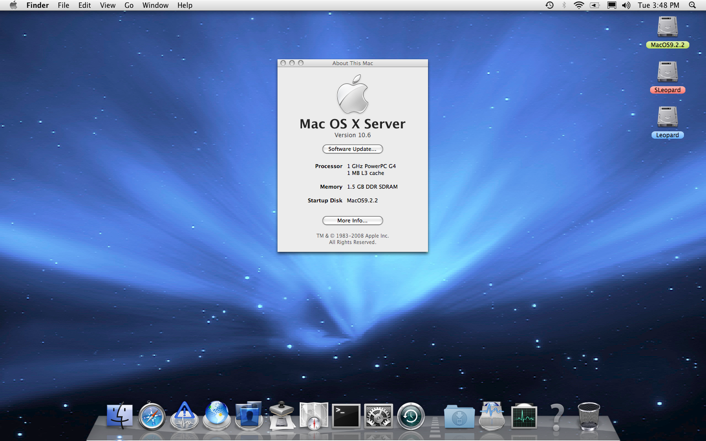

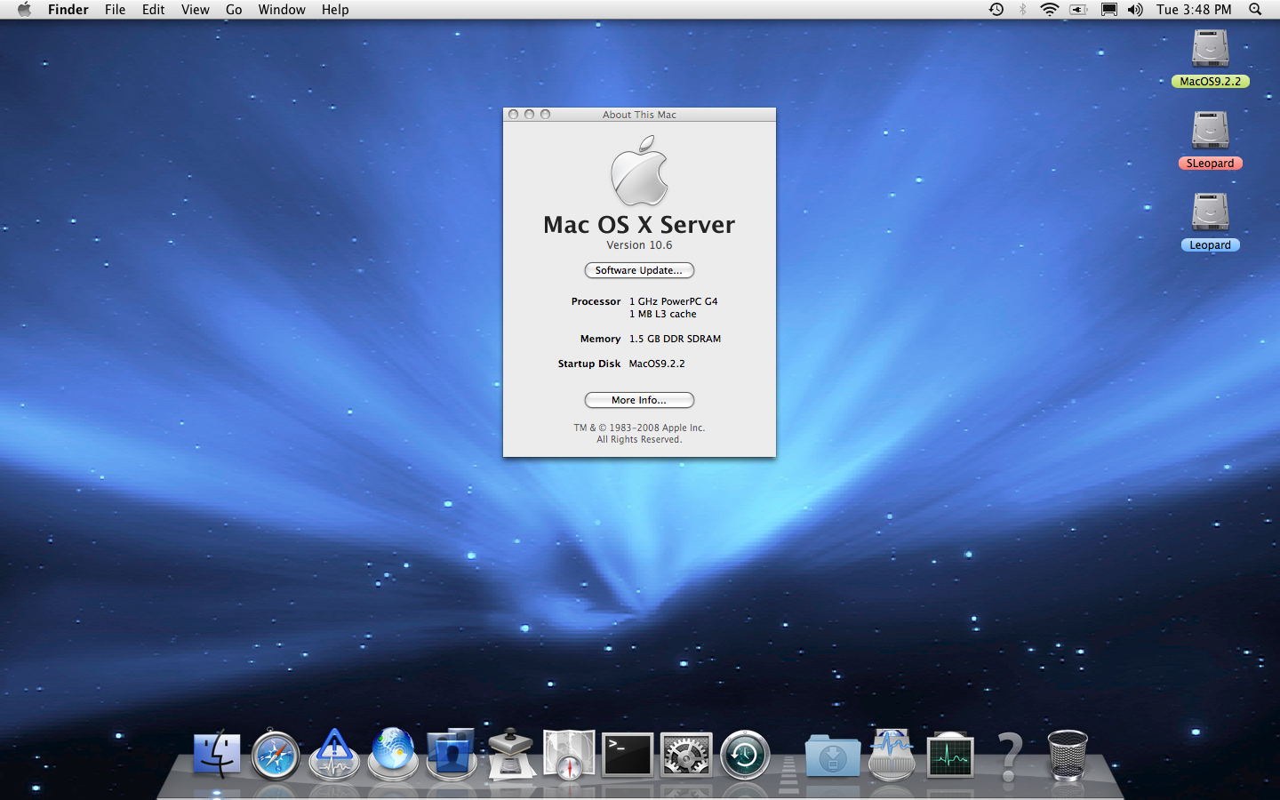

Hi B S M,
From my tests right now my findings are:
1. TenFourFox with MP4Enabler - OK
2. CCC - OK
3. G4FanControl from the command line ( no java working for the GUI ) - OK command line
4. ArcticFox PPC ( unfinished build but very usable and fast ) - OK
5. To have proper desktop background without weird banding use a tiled image from a custom folder
not the ones provided with the OS - OK
6. Textedit - Only works OK with txts not rtf
7. DVD Playback - OK with Tiger's DVD Player plus DVD Playback framework ( for now run the binary
in MacOS folder inside app as it complains about OS version )
8. Webkit- NOT OK fails to start with unsupported OS, linked apps try to start but end up failing
9. System Prefs - OK but title with "32 bit" text - Display Preference pane does not work on my G5 and Printers neve
work
10. Bluetooth - NOT OK on the PB system load at 100% with blued binary
11. Syslog - NOT OK on PB with system load at 100% with systemlogd binary
12. iStat Menus - OK
13. XMenu - OK
14. Safari is older than Leopard's haven't tried to copy Leopards version
15. Quicktime player - GUI says it is "expired" but if you copy the one leopard ( just the app ) it works
Best regards,
voidRunner

Yes to all the above. Clearly, I missed the issue with the stalling at the last hurdle. My fault. I saw the issue with the credentials when I shoved in a Leopard DVD to reset the passwords. I just went back in as root to sort it out locally. Too put out to do it methodically.
So, here we are:
