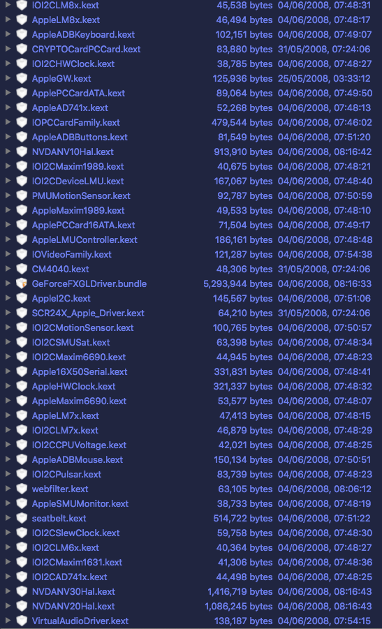

Ok here are all the kexts present in 10A96_Server but missing in 10a261_user.
As expected most of these are basically PPC platform expert related and or PPC hardware drivers.
I know the list on the first page in the wiki lists the ones present in 10a96 and looking for which versions are newer or different in in 10.5.8 - but this slicing of the information below shows what kexts have been removed on later SL builds.
This could help us determine if we can forward port anything to the later SL builds and or the GM - of if without the later Finder or other base components being PPC compiled etc that it is totally impossible.

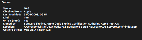

Out of interest, using the ASP option it's listing the 10A96 Finder Build as Intel - even though we know it's dual PPC/Intel.

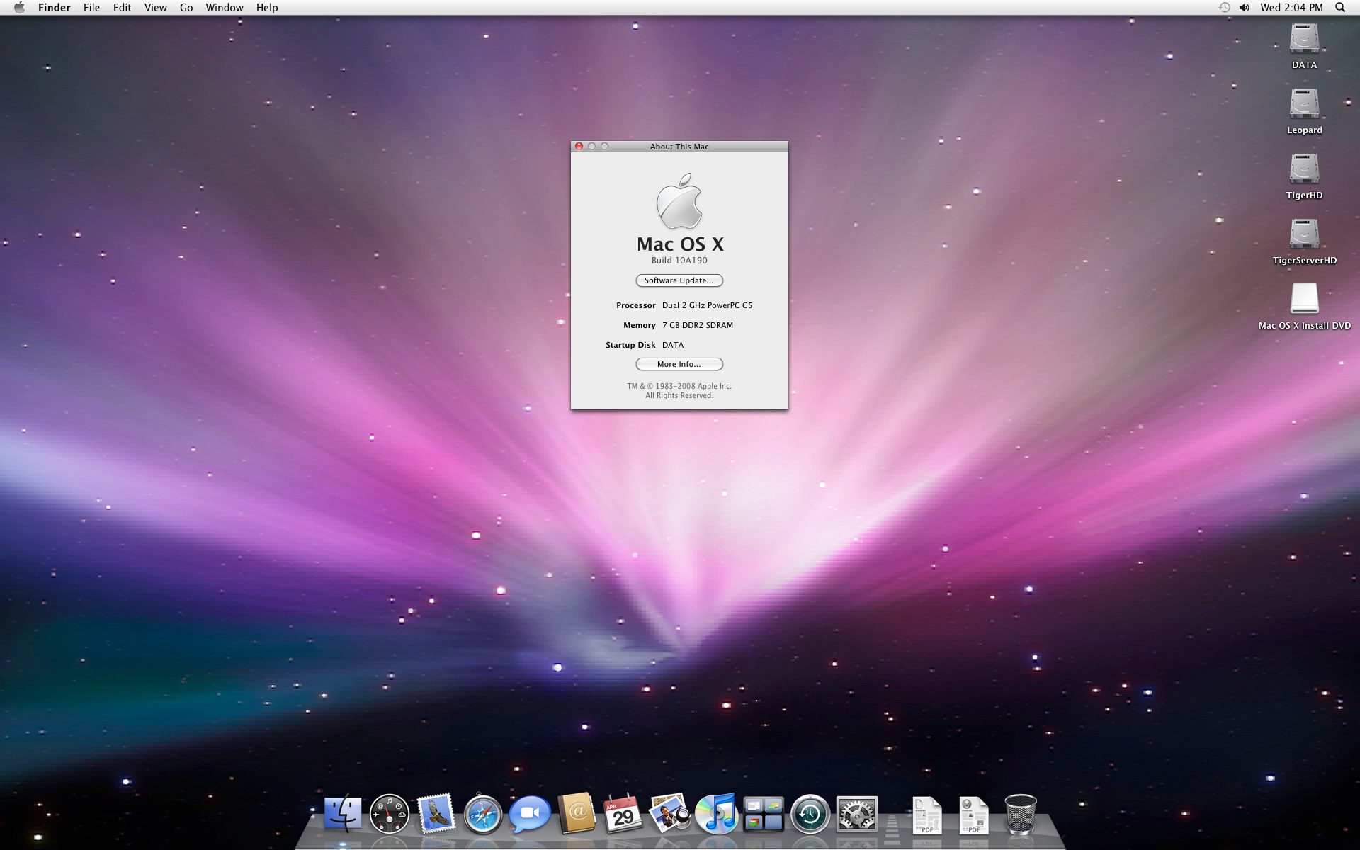

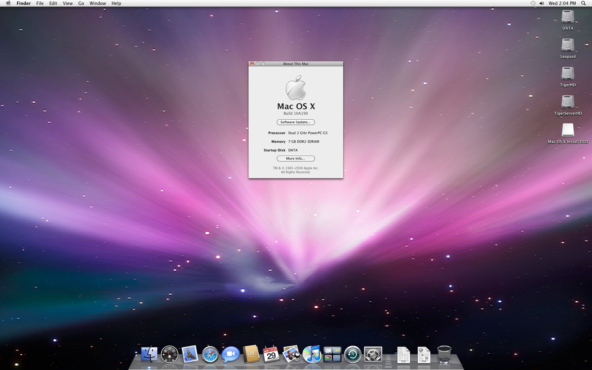

OK. 10A190 has just booted up on my G5. I will update the 1st post with my tweaked OSInstall.mpkg.
I just used the same kexts and BootX as per the attachments in the first post and amended the OSInstall.mpkg for 10A190 as the client version will not work with the tweaked OSInstall package uploaded for the Server version.
OK. A quick scoot around the system. My flashed 1900XT card works but QE is not enabled and CI is software only. AirPort isn't working and sleep hangs the system: the screen blanks but the fans still run etc.
