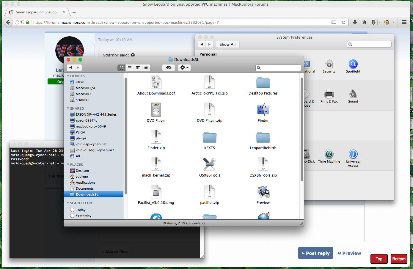

And we have liftoff on SnowLeopardRebirth courtesy of @SourceSunTom ;-)
I've not finished putting everything in place but it's looking like this.

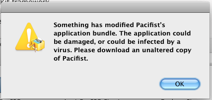

One snag I've found is that SArtfile.bin is not usable directly ( I think something
is missing as the sizes are very different ).
Putting in the rest right now :D
PS. @SouceSunTom this is your work so let me know if this is ok with you.
Best regards,
voidRunner

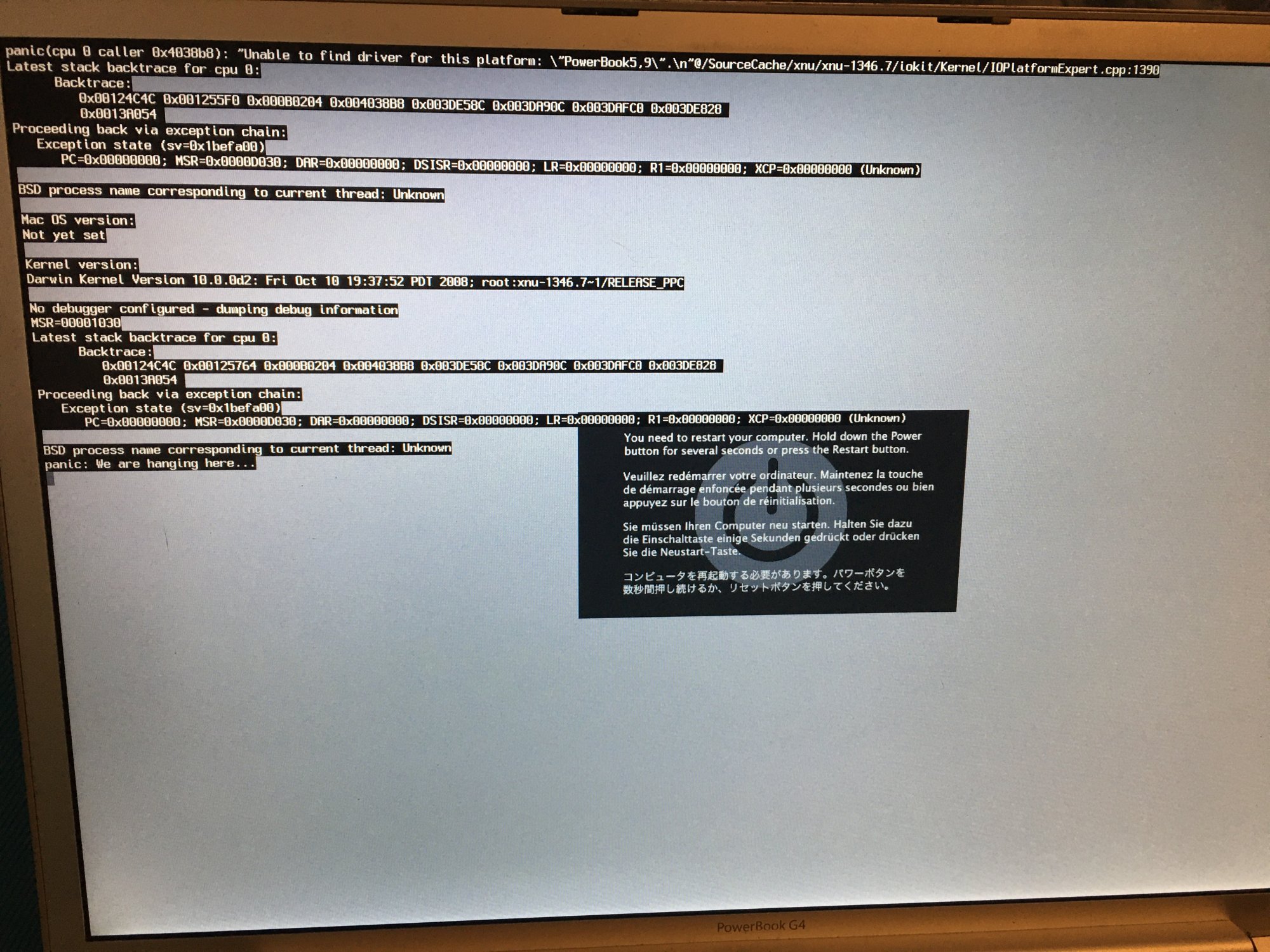

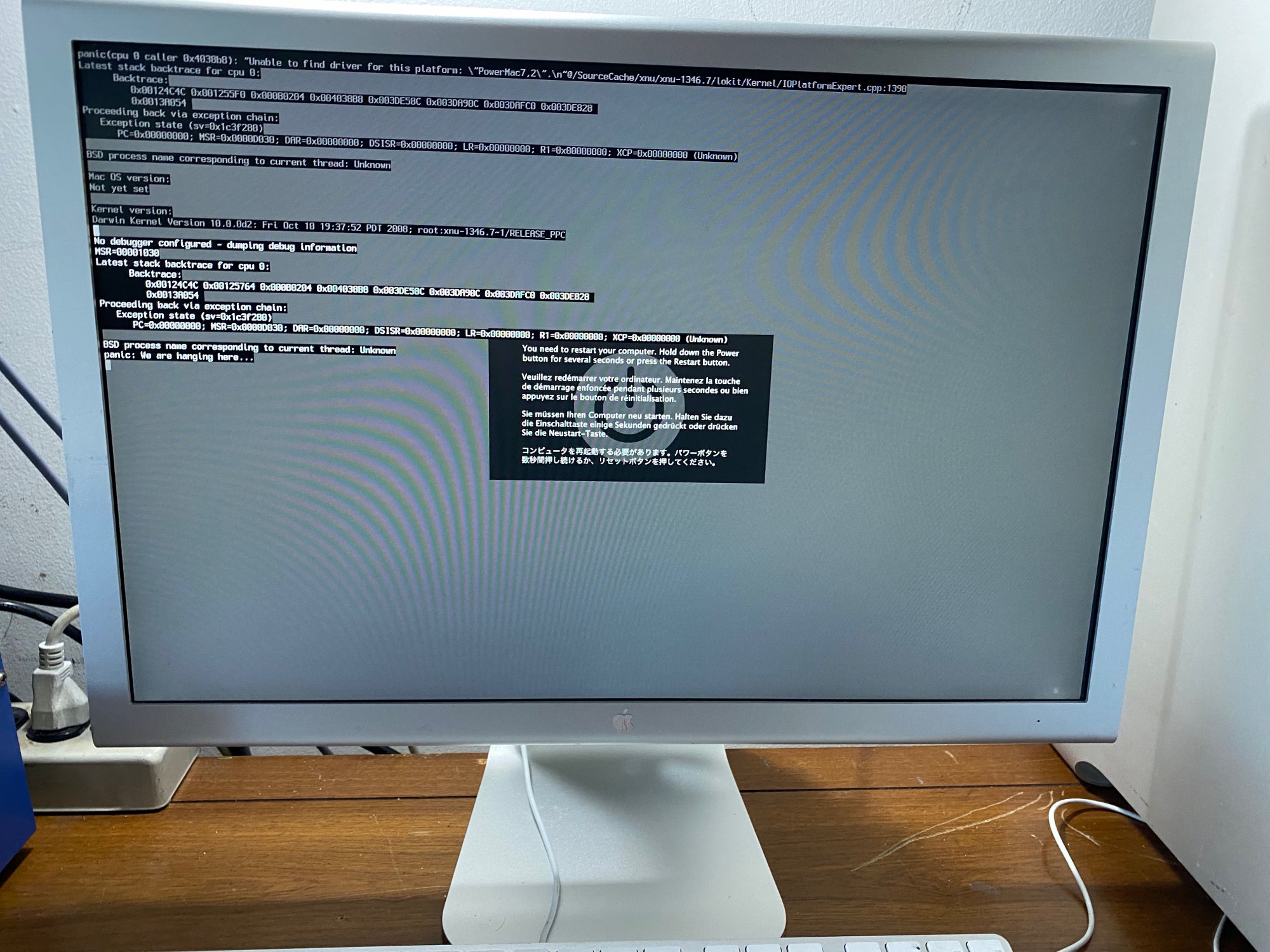

I am also having problems installing 10A190 on my 17" DLSD on an external FW drive. If I patch it manually, I can only get through the first stage of installation but it kernel panics on reboot. If I use Julian's script I get an unbootable volume. I have other bootable volumes on that FW drive, so I know that it is not the problem.

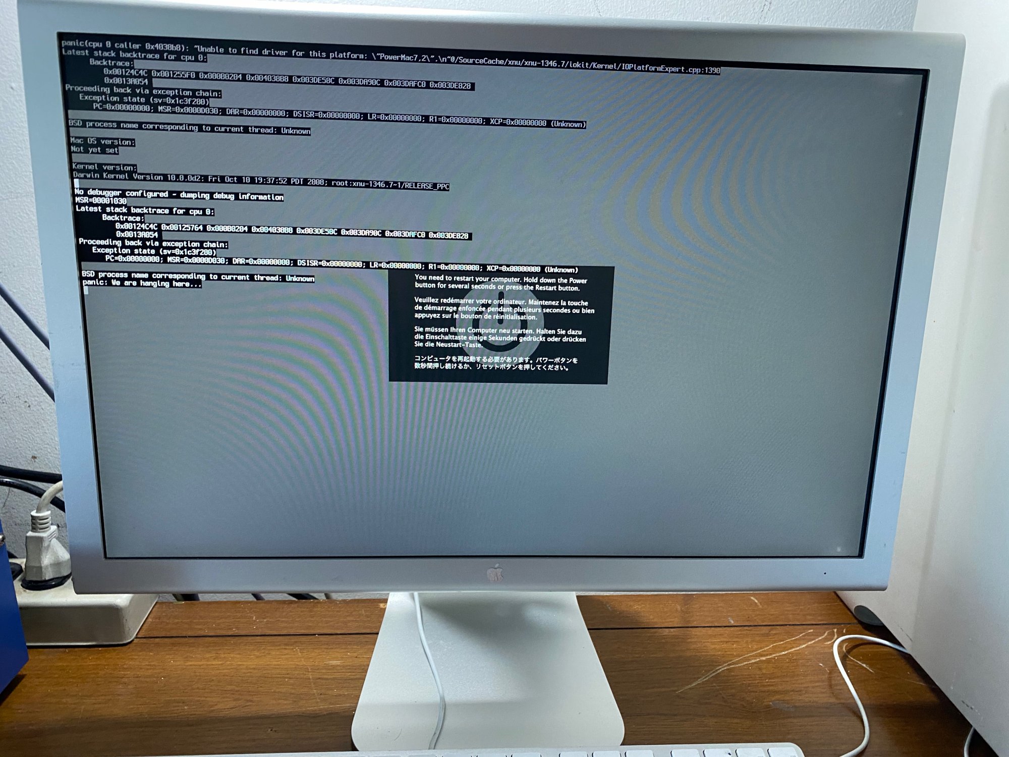

Hey I've been following this thread for a few days, am trying to cram in as much info as possible; excuse me if I repeat questions from earlier on in this thread. I'm Mark from LEM (fb group) by the way!
I'm getting an identical KP on my DP 2.0 03 G5, the SL boot volume is an external FW drive. Are you saying this KP is happening because it's attempting to boot off a FW target disk? Attached is the KP I had.
I've been able to follow instructions closely up until this point. Thanks for any help given.
