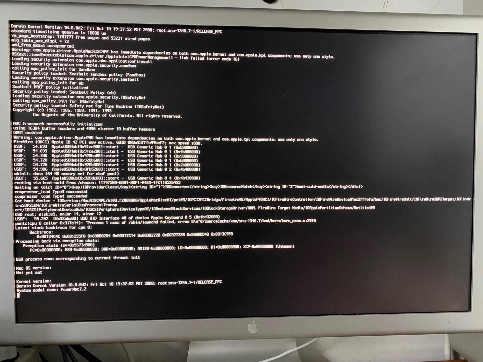

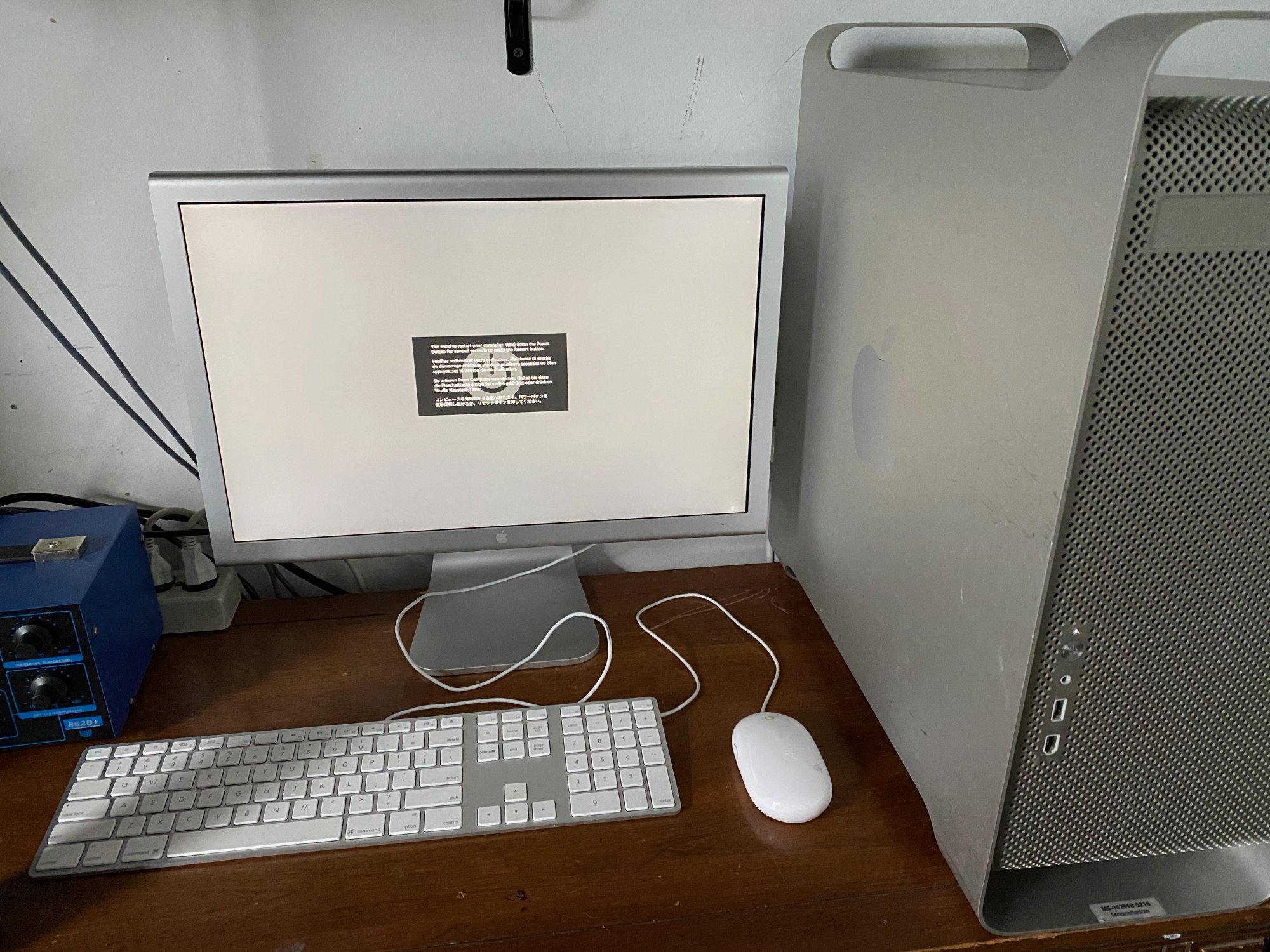

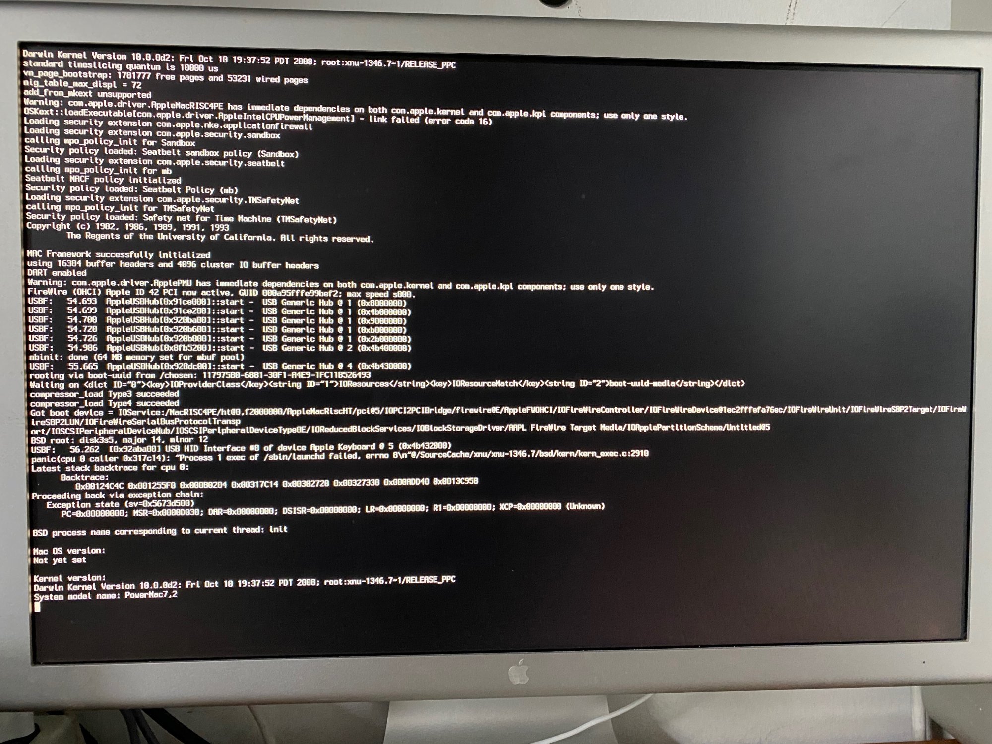

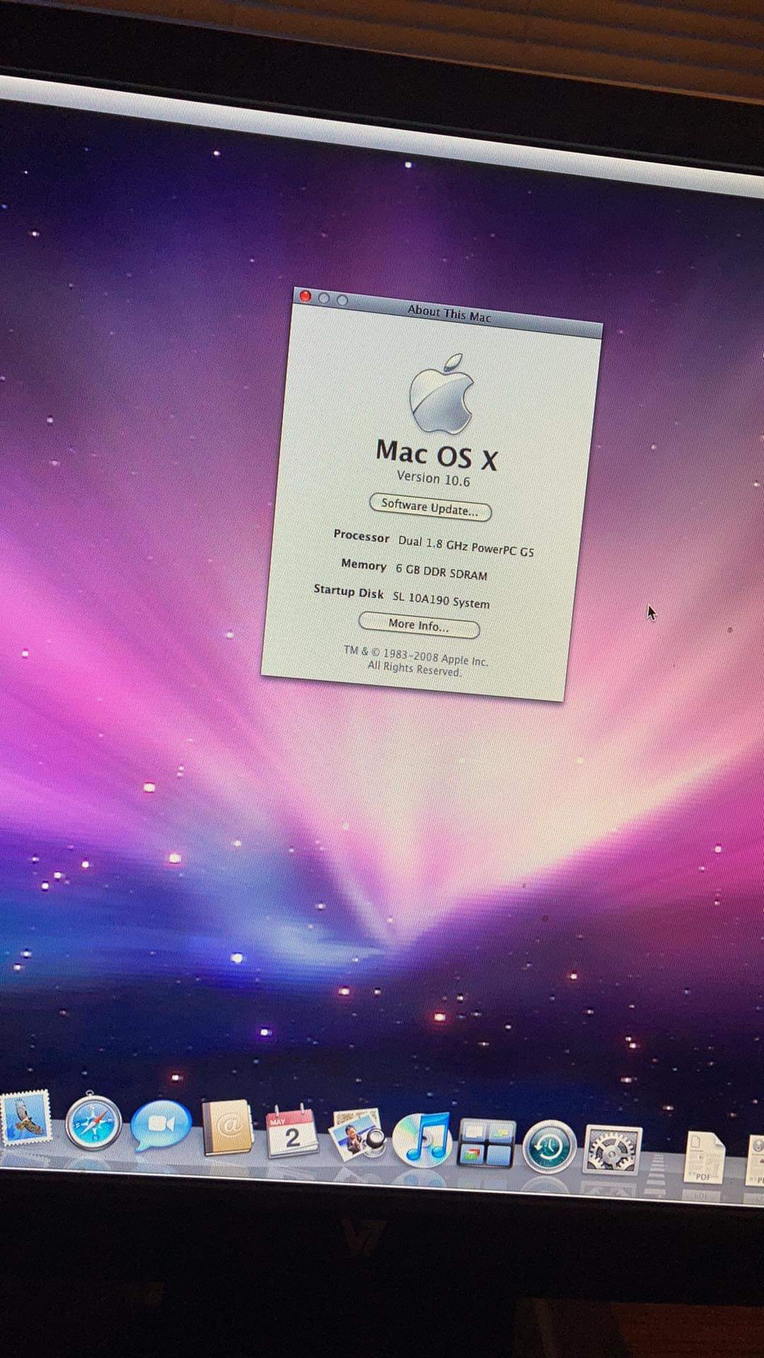

Hey guys,
- Despite instructions yesterday, all attempts ended up in KP's. Fortunately @Project Alice was able to send me an installed/bootable DMG which was proven working on his machines. When I cloned via CCC to my DP 2.0 G5, I still get KP's, though they look different this time. I'm starting to think maybe it's my Radeon 9800 Pro GPU causing this? I cloned to an eMac G4 and it gave the same KP, too.
Note: I'm booting this 10.6 disk clone off an external 500GB FW400 disk from a 3,1 in target disk mode
3 Attachments:
- Verboose boot picture on DP 2.0 G5 03 w/R9800P booting into Project Alice's 10A190 image
- Non-verbose KP on Project Alice's disk image - doesn't show error just "restart"
- 3rd image is the same disk image, but functioning, on a DP 2.0 G5 that he has.
What am I missing?
Hey guys,
3 Attachments:
What am I missing?
Oh hi Mark.
This appears to be 10A190. Have you also tested 10A96 on this?
I have not tested 10A96 on it. I actually erased 10A96 and installed 10A190 over it.

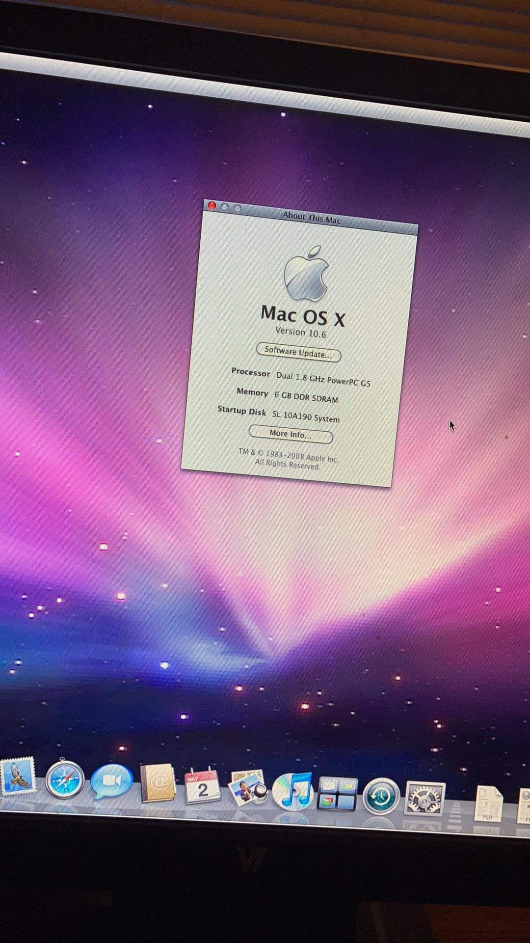

I have successfully installed 10A190 on a G5 11.2 with 6600, soon i will try the Fx-4500. From my point of view, it is a clear performance improvement over Leopard, but it needs a lot of refinement. Memory footprint was reduced in comparison to Leopard, so maybe that is the reason?

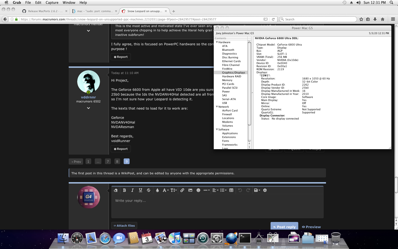

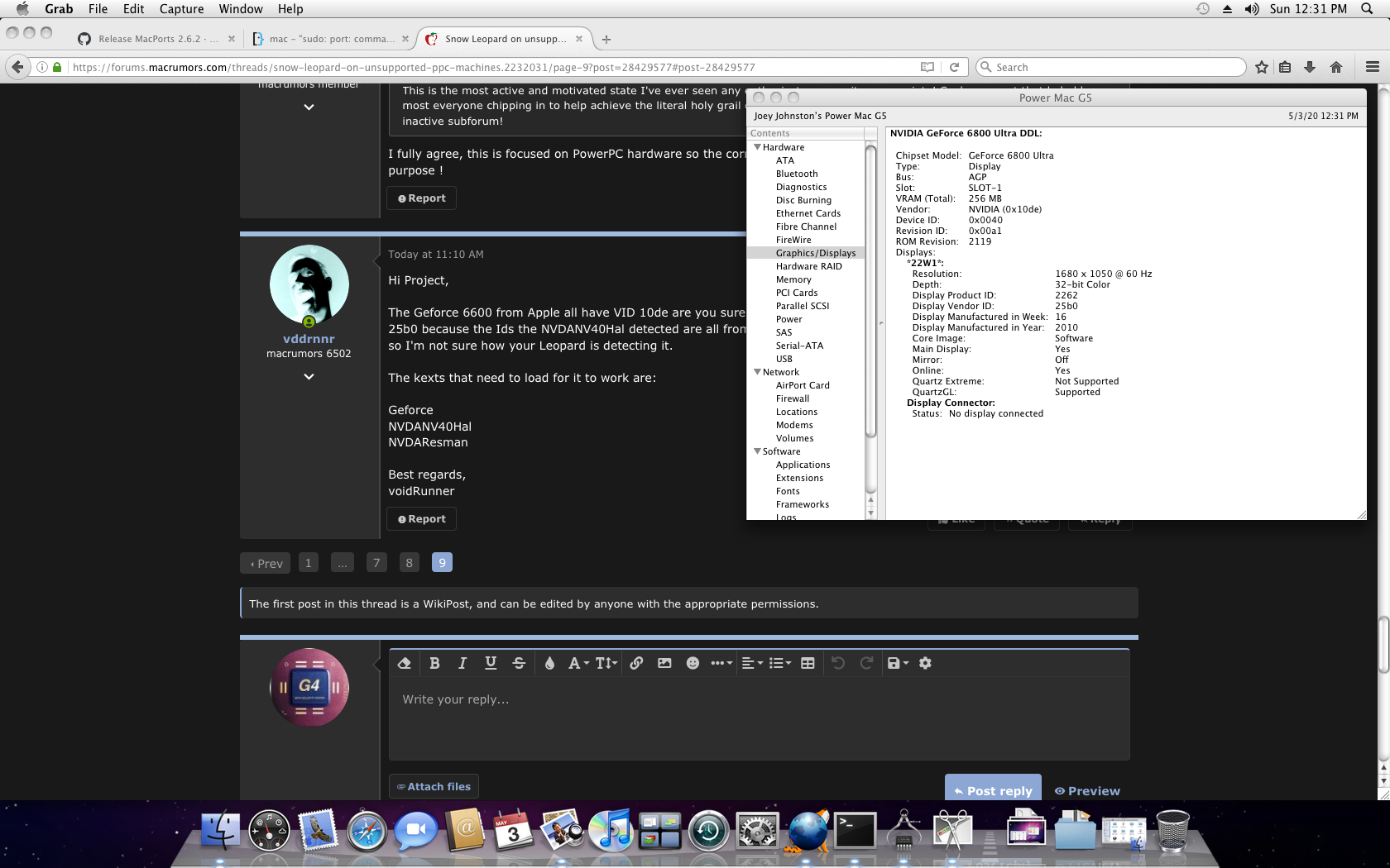

Hi Project,
The Geforce 6600 from Apple all have VID 10de are you sure about
25b0 because the Ids the NVDANV40Hal detected are all from VID 10de
so I'm not sure how your Leopard is detecting it.
The kexts that need to load for it to work are:
Geforce
NVDANV40Hal
NVDAResman
Best regards,
voidRunner

That's what it says.
I'll have to reboot into Leopard to see what it reads it as. My installation has all of the Leopard Geforce kexts installed.

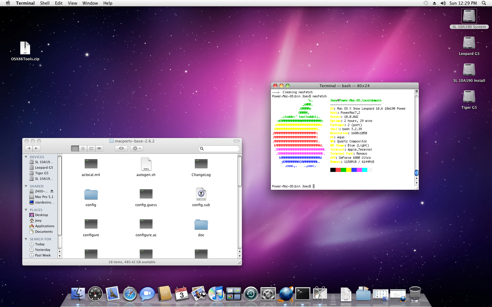

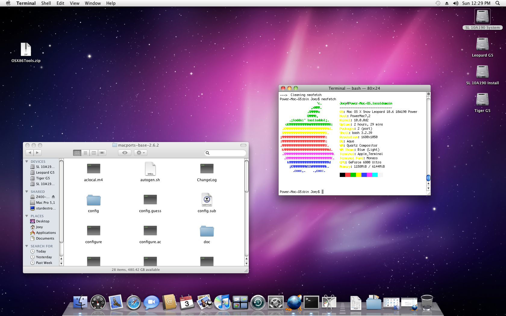

Also I've manage to install MacPorts 2.6.2. I had to compile it from the source as the SL version was erroring out in the installer, and the Leopard version complained that it can't be installed on 10.6.

Hi Project,
Those are from your LCD screen ;-)
Then Geforce ones are a few lines above 10de and 0040.
And yes you are right that is a supported model in the new kexts also.
That is indeed weird.
Can you check if the kexts are loaded ( In System Profiles under extensions )?
Best regards,
voidRunner
Reactions: Larsvonhier
Hi Project,
Best regards,
voidRunner
Omfg. I'm an idiot lol
Both NVDANV40Hal, and NVDAResman are loaded but Geforce is not.
I just reinstalled the Geforce.kext that was in 10A190 and it still isn't loading.

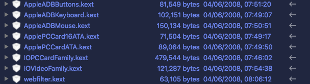

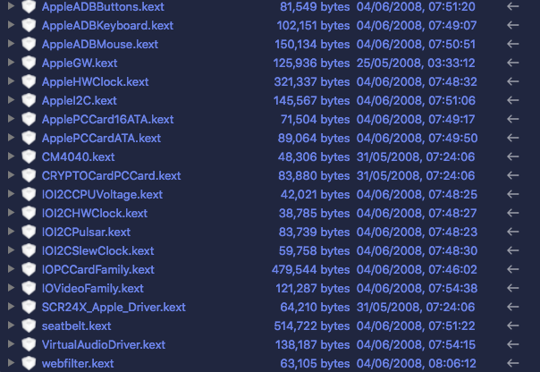

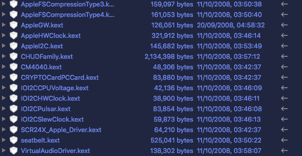

Hey peeps - just caught up on the last 3 pages of the threads.... great to see all the progress! Some updates from my digging, which hope are useful:
Managed to re-download 10a190 and 10a222 properly this time.
Kexts
Have managed to compared which kexts have been removed in each build since 10a96 - as working on the assumption that PPC stuff would be being stripped rather than actively patched or added up:
Between 10a96 and 10a190:
Between 10a96 and 10a222:
Between 10a190 and 10a222:
