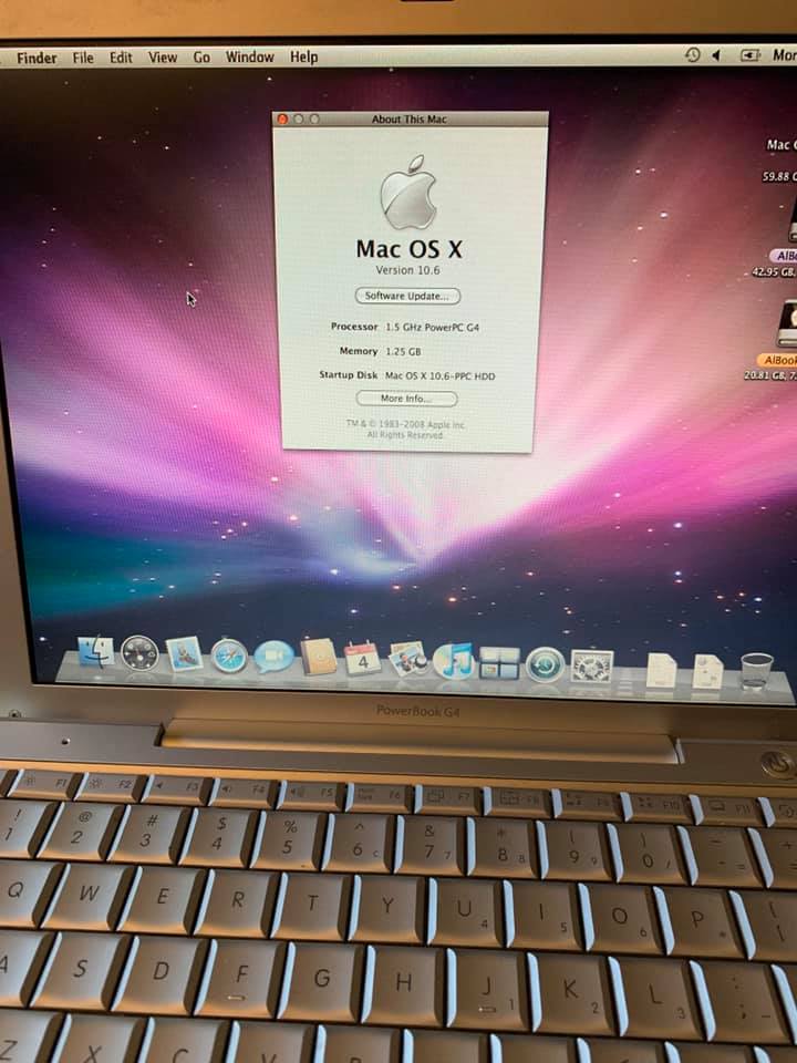

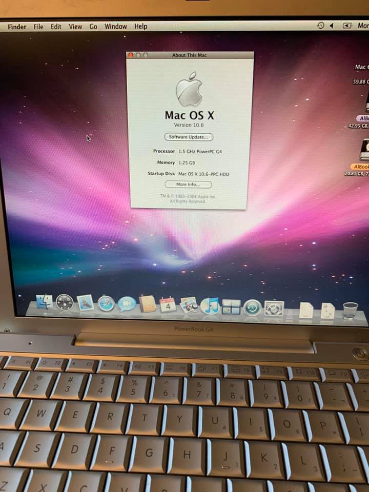

I got it booted on a 2005 PowerBook G4 (1.5-1.67 GHz) using the PPC_SL_10A190 image uploaded here (thanks!). It doesn't look like full graphs support is loaded, no wifi, and there's a lot of crashes. Nothing new there though, but one thing I didn't see mentioned is none of my USB drives are recognized. Also, sleep very much doesn't work, and it looks like I have to hard power down, then disconnect the power and the battery to fully shutdown (holding the power doesn't completely power off).
Thanks again! Very exciting. I'll have to test more after work.

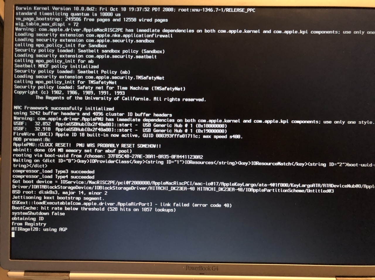

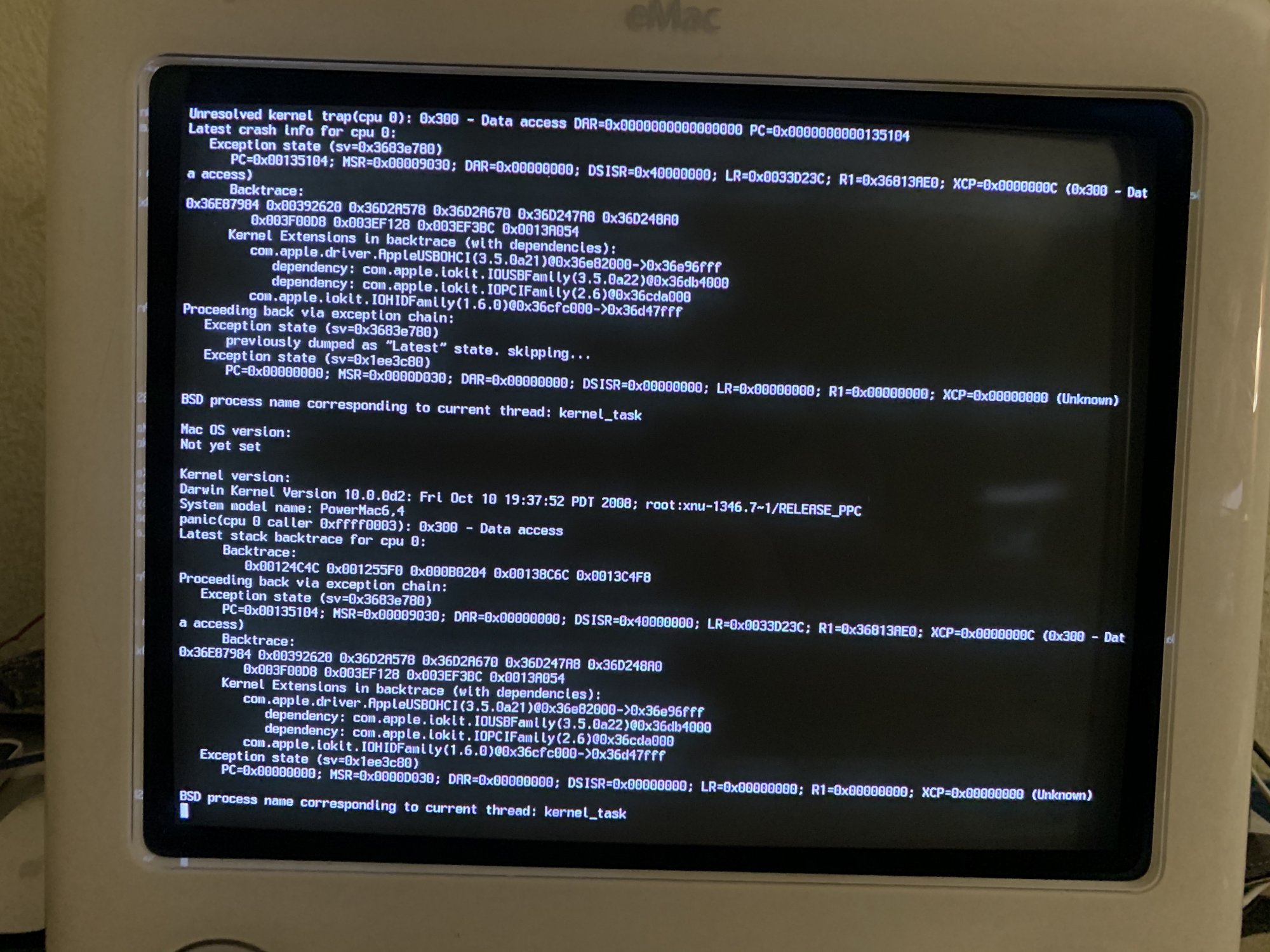

Hi @pepotrone,
Can you post a screenshot booting in verbose mode
when the KP happens?

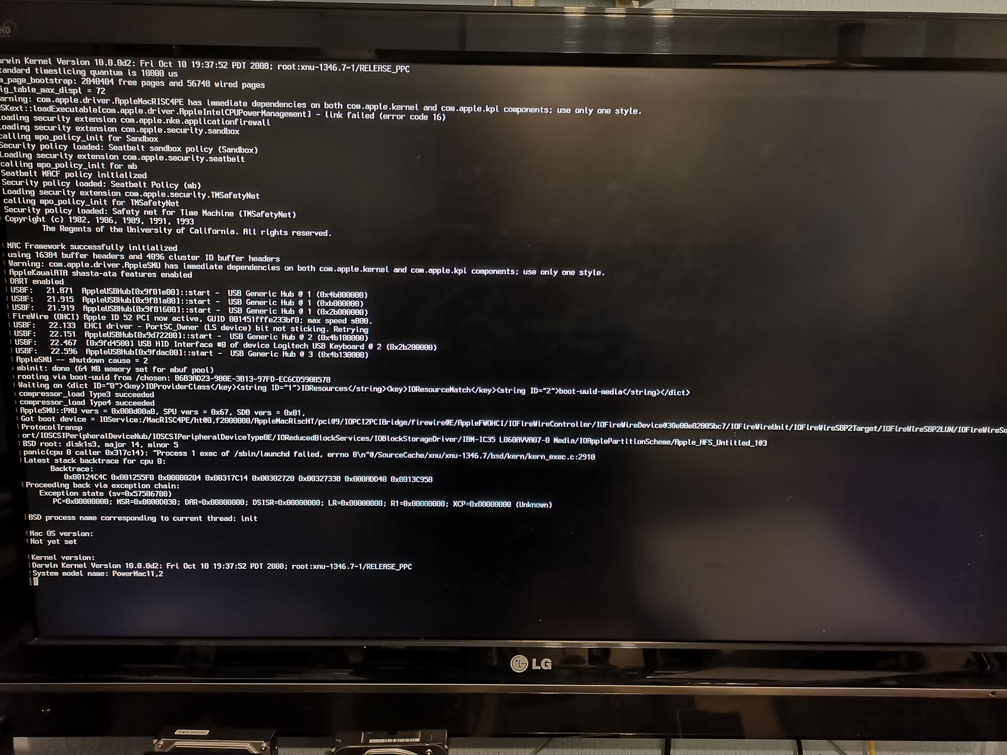

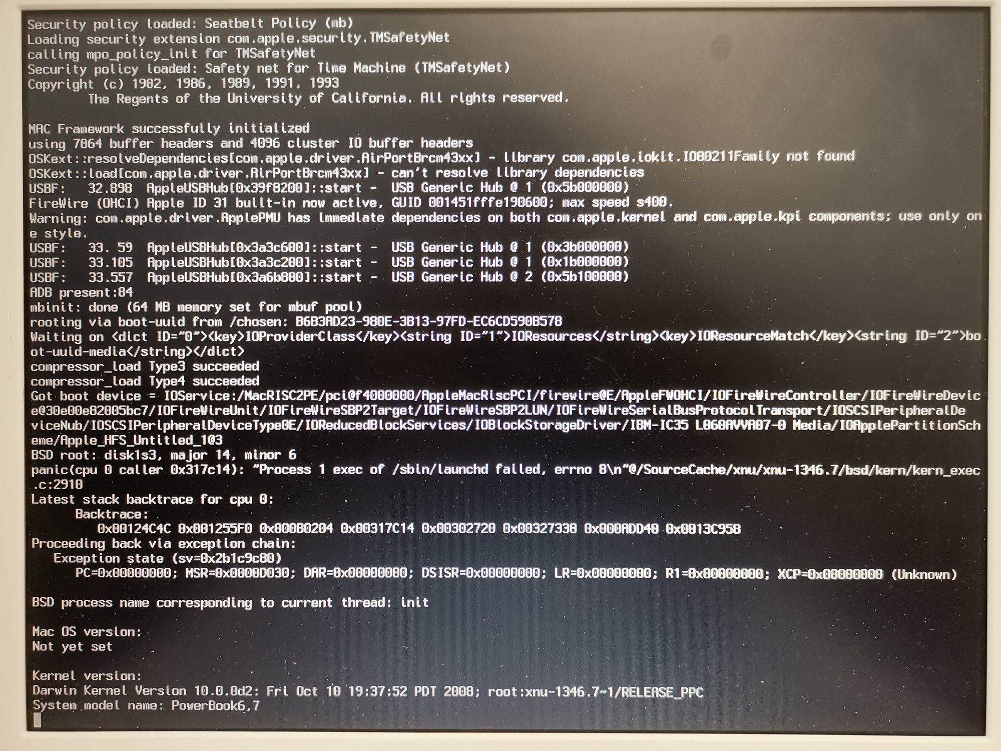

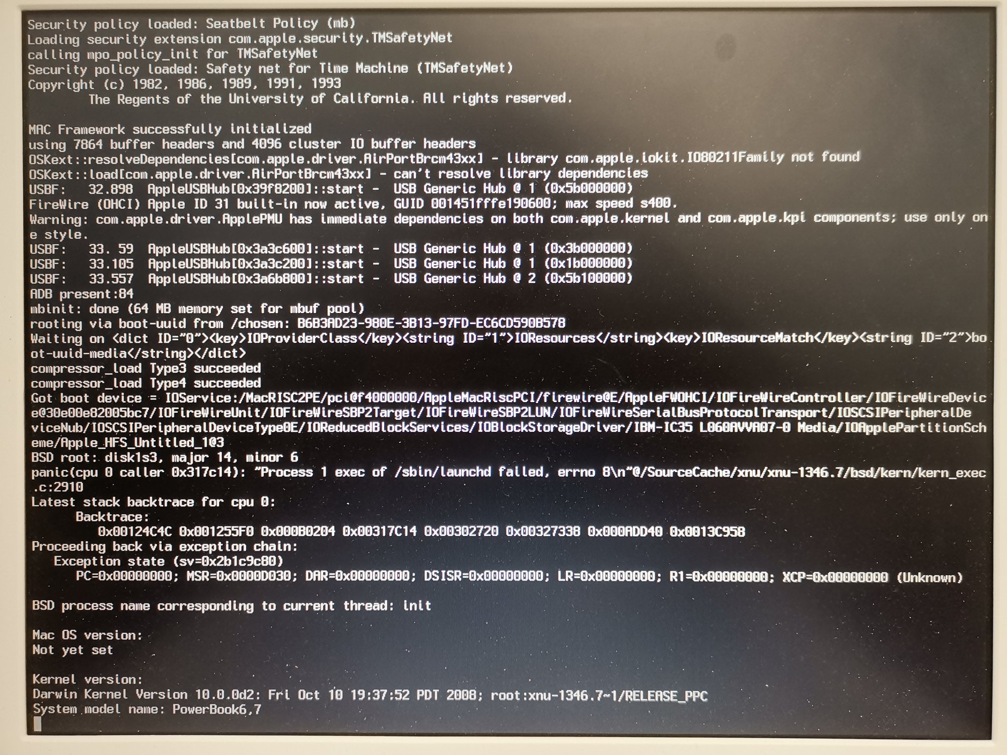

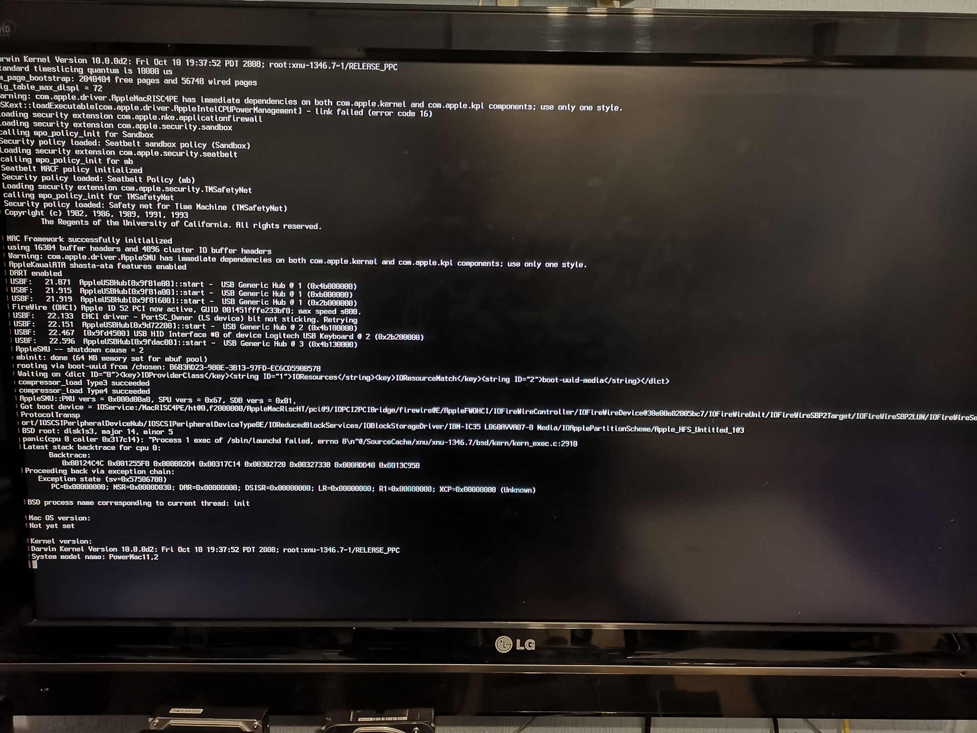

Hi vddrnnr, I give you the screenshots of the panic kernel in the ibook g4 1.42 and also the dual g5 2.3 (PPC_SL_10A190 image uploaded)
I have used the disk utility to restore and also the CCC, getting panic kernels with both.
Thank you.
Thank you.

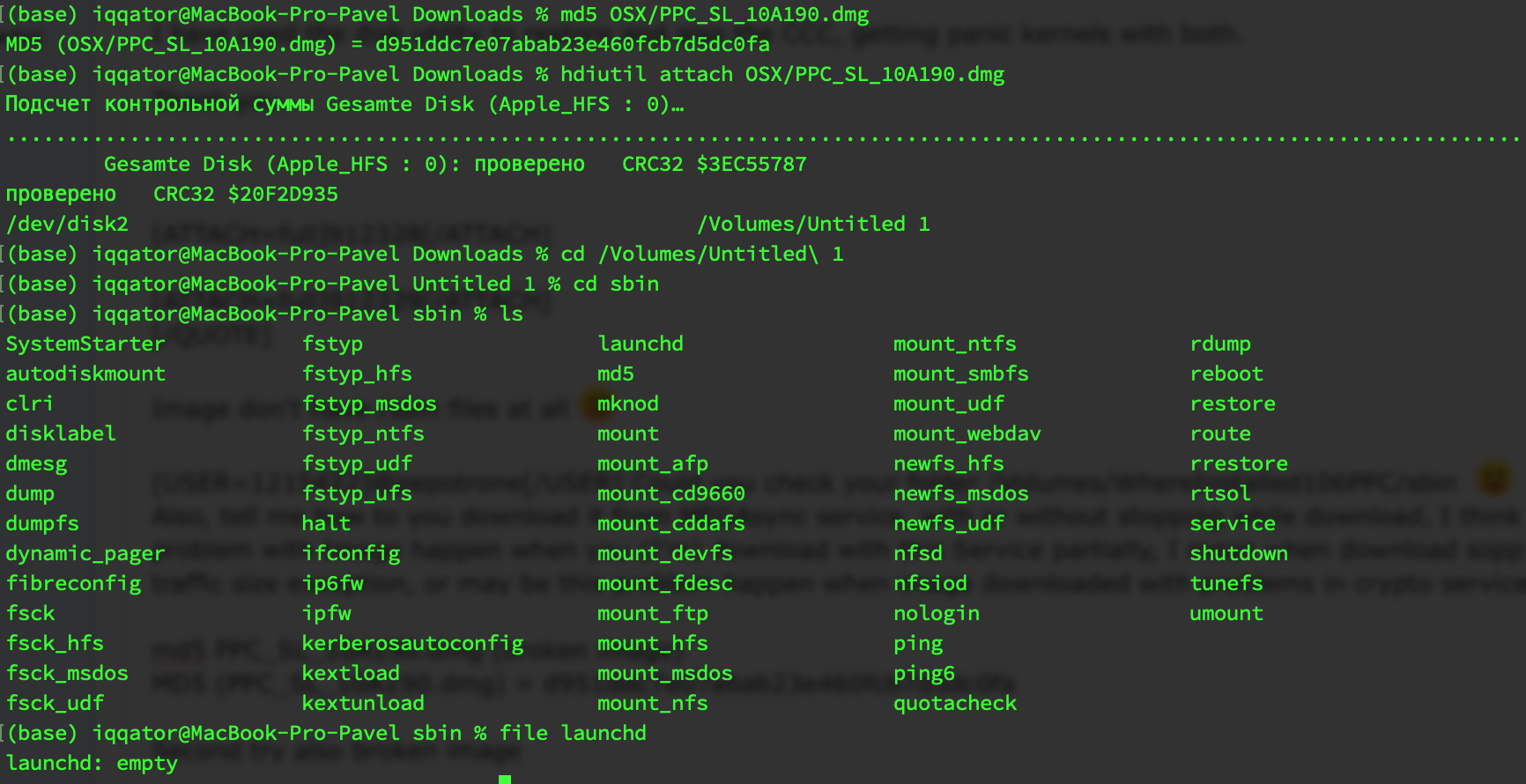

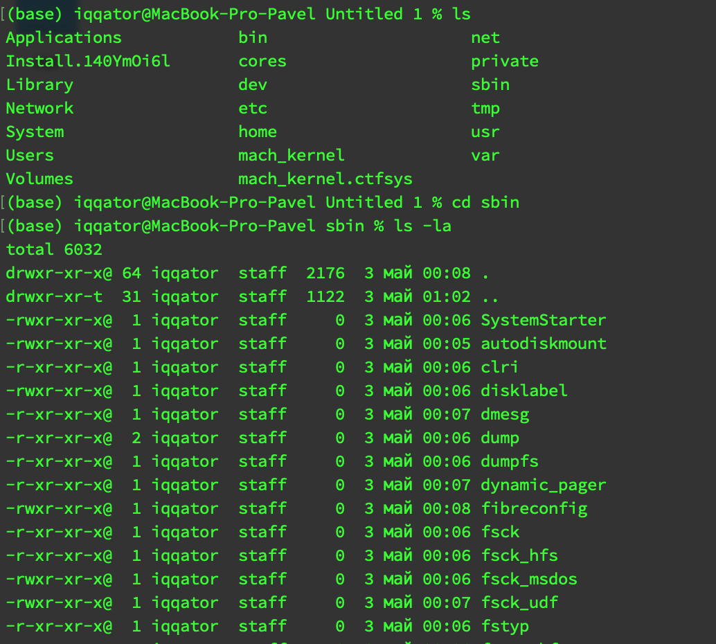

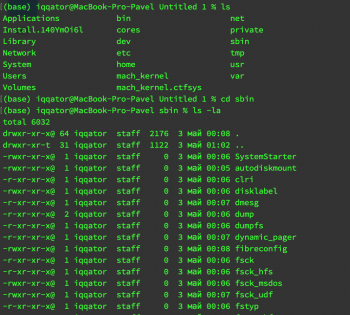

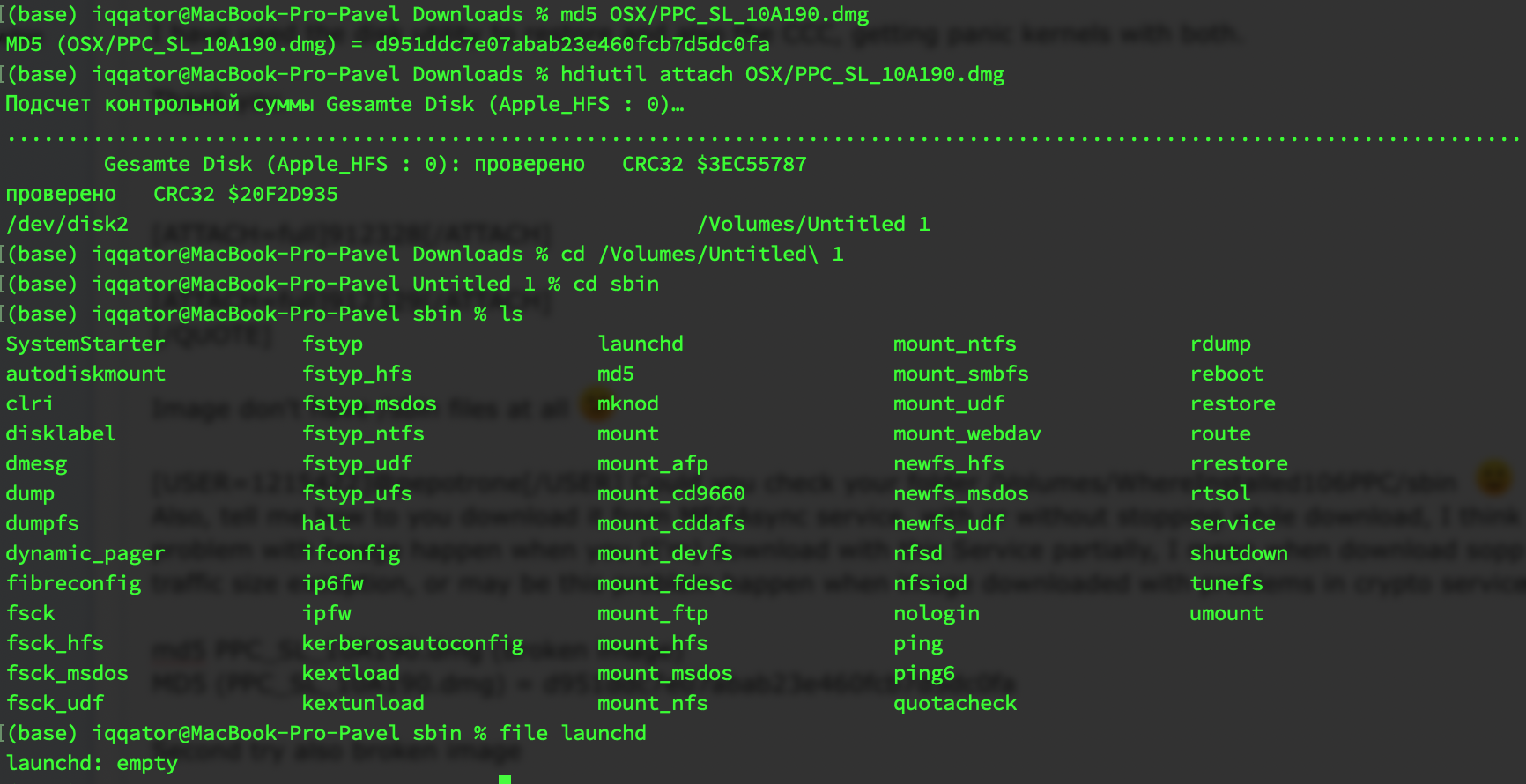

Image don't have /sbin files at all 🙁
@pepotrone Could you check your folder /Volumes/WhereInstalled106PPC/sbin 🙂
Also, tell me how to you download it from MEGAsync service, with or without stopping while download, I think that problem with Image happen when you (I'm) download with this Service partially, I mean when download sopped by traffic size exception, or may be this problem happen when image downloaded with problems in crypto service.
md5 PPC_SL_10A190.dmg (broken image)
MD5 (PPC_SL_10A190.dmg) = d951ddc7e07abab23e460fcb7d5dc0fa
With second try download also broken image: Empty launchd and zero size files 🙁

Anyone who use this image could you please check md5 or re-upload to another host if it no problem for you ?
Thank you for answering me 😉
The image I downloaded has the same MD5 number that you have written, that is, d951ddc7e07abab23e460fcb7d5dc0fa.
I downloaded it from mega, continuously without interruption with the browser (one with firefox and one with Opera), so I understand that it will be correct.
Inside the /Sbin folder I have 62 files each with a different size.
What can I try?
Thank you

Try restore this image with doing next steps:
1) Open DiskUtility
2) Format (Erase) partition for install (maybe unnecessary)
3) Try to restore image with set checkbox "Erase partition" true
4) DiskUtility show message "This image need check for restore" (or similar) Press Ok, wait 🙂
5) Wait while image will be restored. (On my eMac this take ~10 minutes)
6) Set boot device and reboot 🙂 (for verbosity you can run this:
Code:
sudo nvram boot-args="-v"
Reactions: Larsvonhier

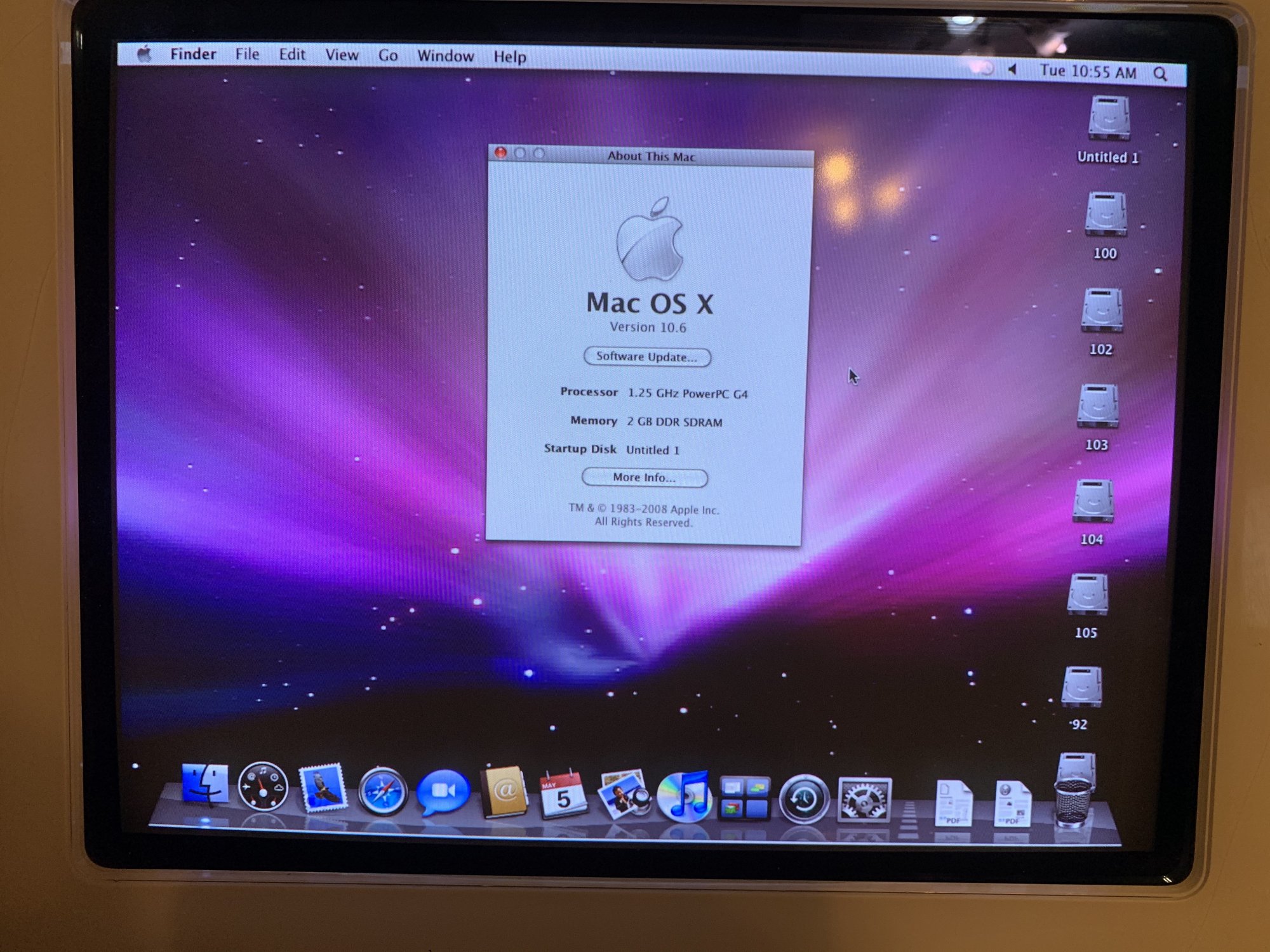

After minutes test I found issue with "Share" control panel, some items are hide when I tried to select file sharing, and panel was hang 🙁
Of course I have not QE, and CI is Software on my eMac 🙂)

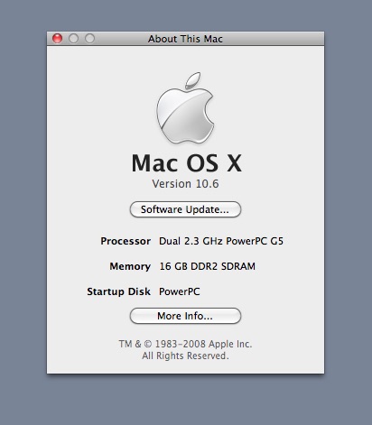

Hi! I restored the DMG shared on #200 post. Did that on Snow Leopard running on Mac Pro 1,1. All the hard disks were inside the Mac Pro. Moved the hard disk with the restored DMG to the G5 and booted just fine.

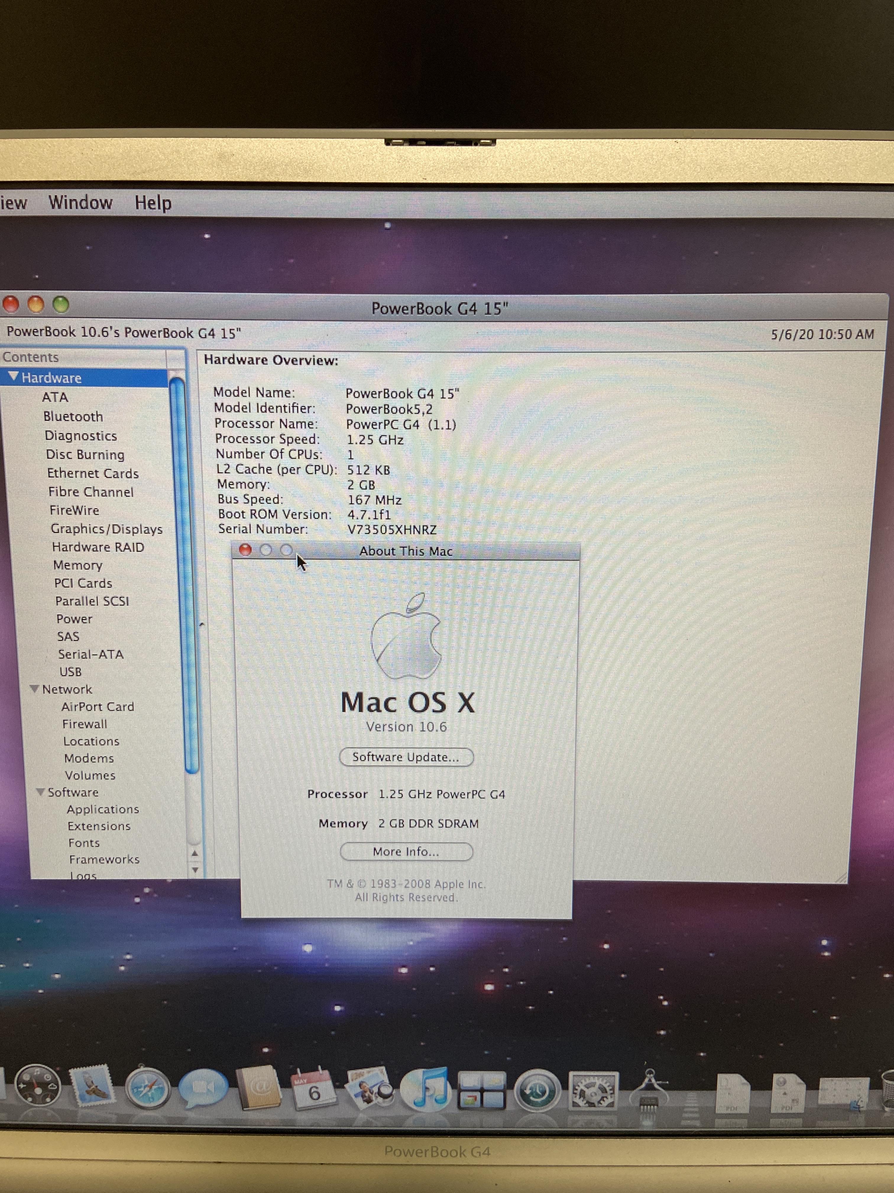

I restored the disk image in post #200 to a hard drive and installed it in a 15” PowerBook.
It boots after a long time, and I can hear the audio from the OS X “welcome” video but I can’t get past the first page of the setup screen. The cursor moves but I can’t click anything. Tried with an Apple USB mouse as well.
Update: a third reboot seems to have fixed that problem. It’s at the desktop now- WiFi not working and graphics are laggy.

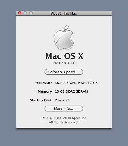

THX¡¡¡¡¡
It already works at last!!!!!! And it is also extremely fast! It is a pity that Apple killed it, because it is incredible how fast it is!
That if the client version 90 has many bugs.
The bugs that I have found are the following:
- Network preferences: Share: when activating it does not respond.
- USB: USB drives are not displayed on the desktop.
- Finder: View as large icons does not show the text. If it is put into list mode, they are already displayed.
- Dashboard: The widget is activated but sometimes it closes unexpectedly.

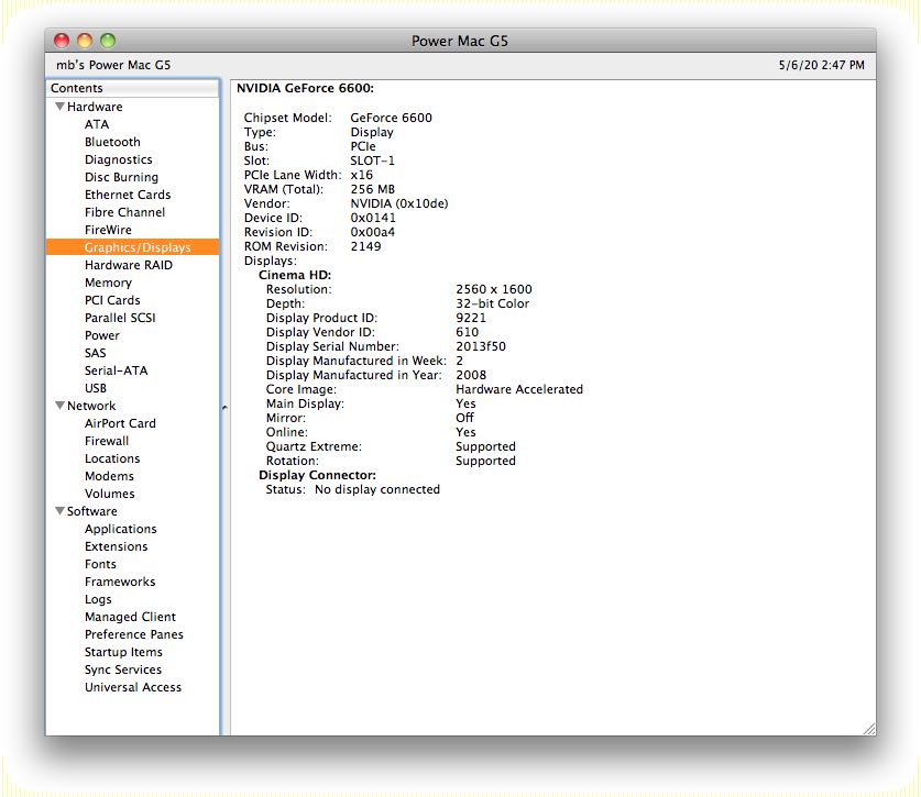

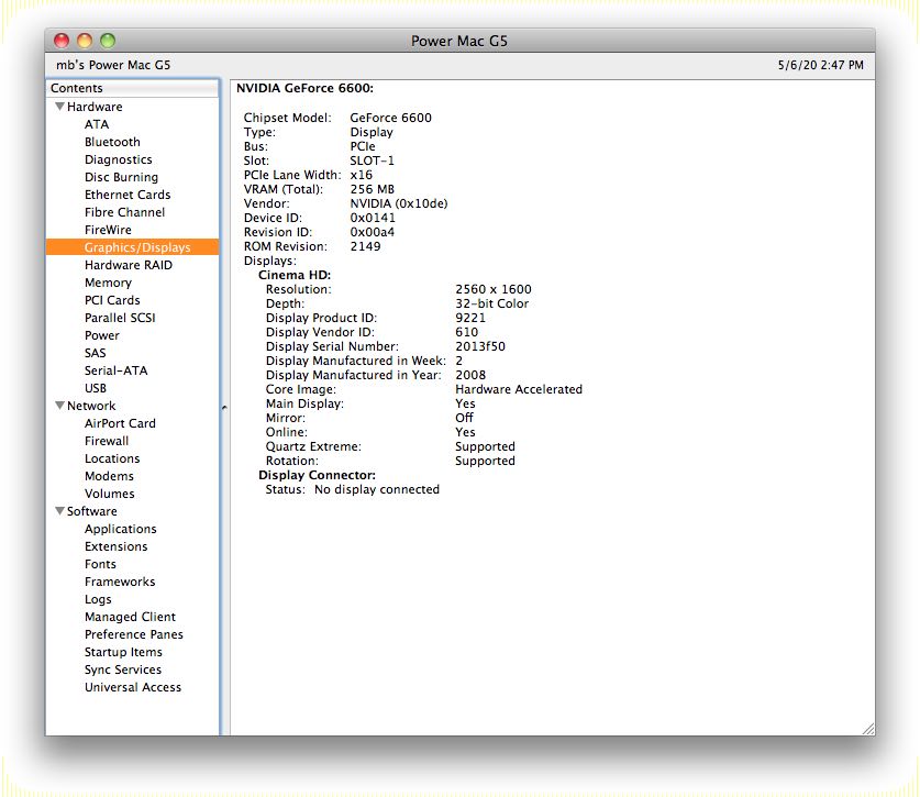

Anyway it is impressive to see it work (my configuration is a Dual 2.3 g5 ppc970mp) with 8gb of ram and HD sata 8mb buffer (very normal).
If I can help more I would love to do it.
