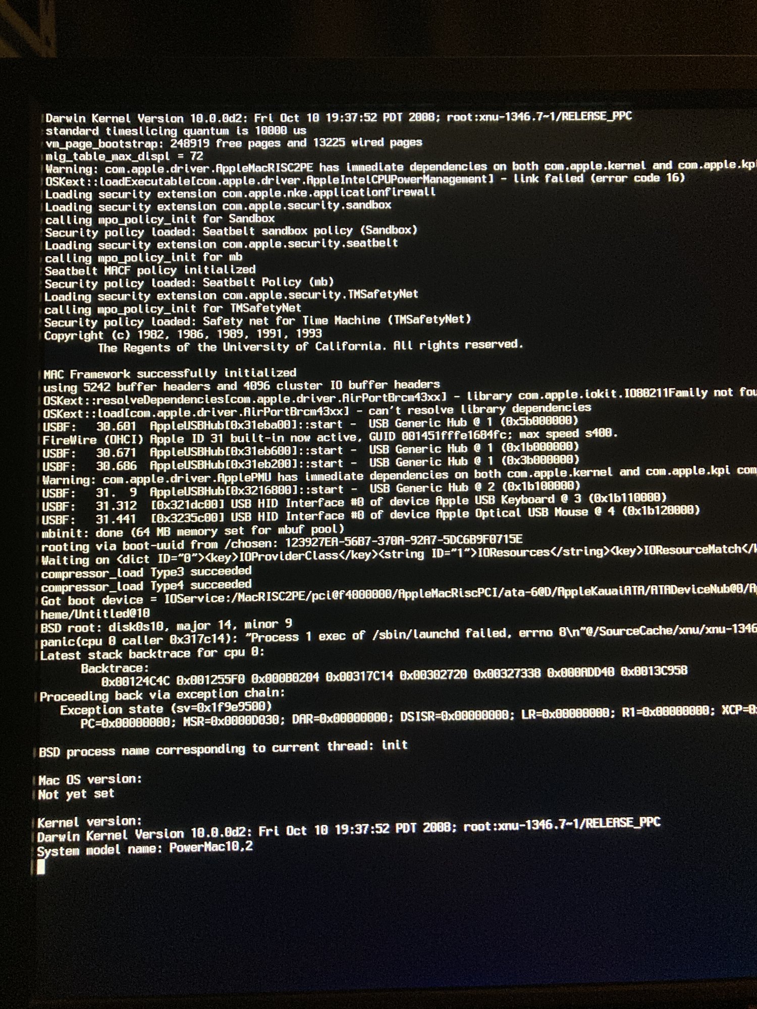

I would be very interested in this DMG image. I'm currently stumped by a Kernel Panic trying to get it to work.

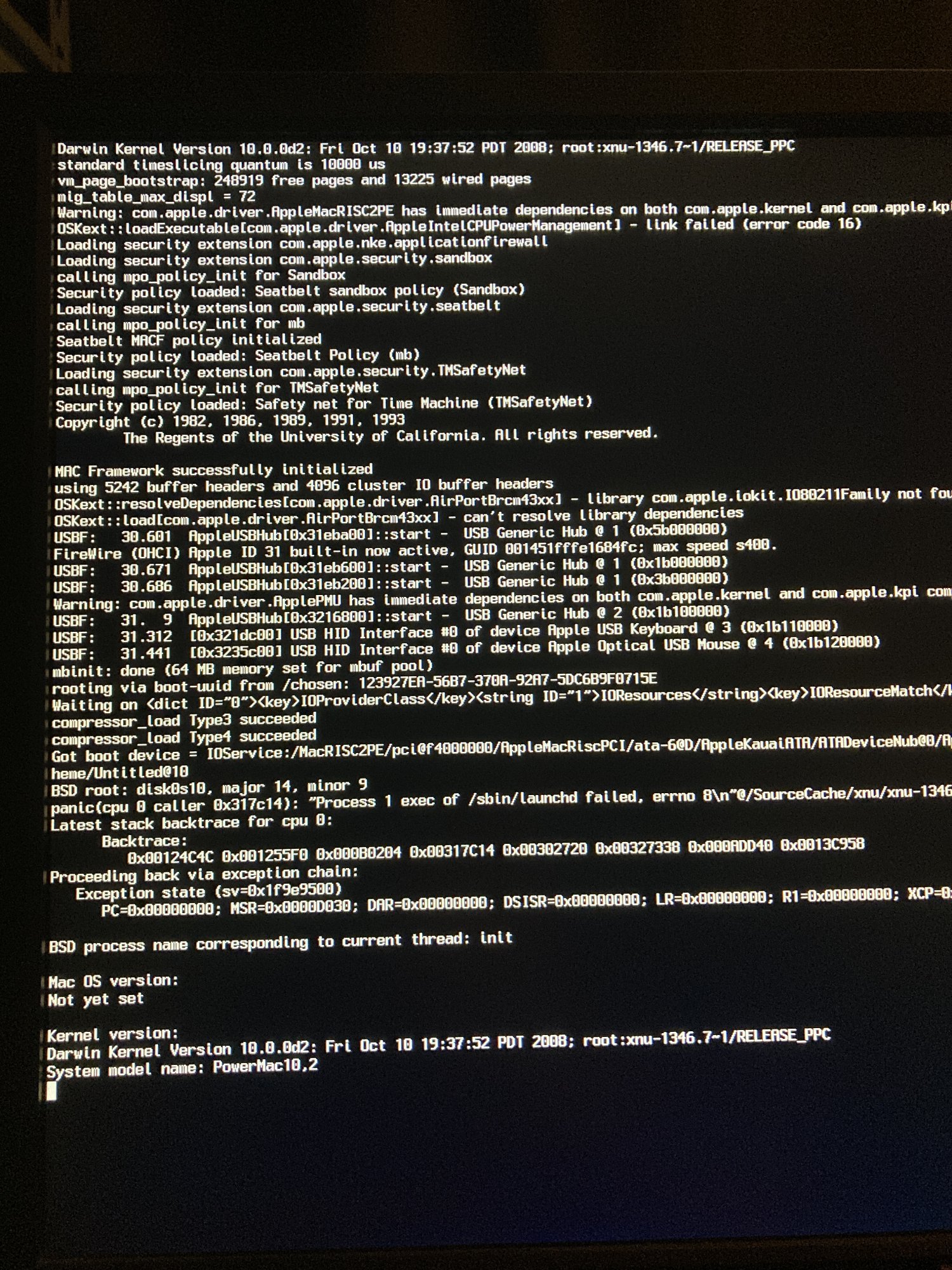

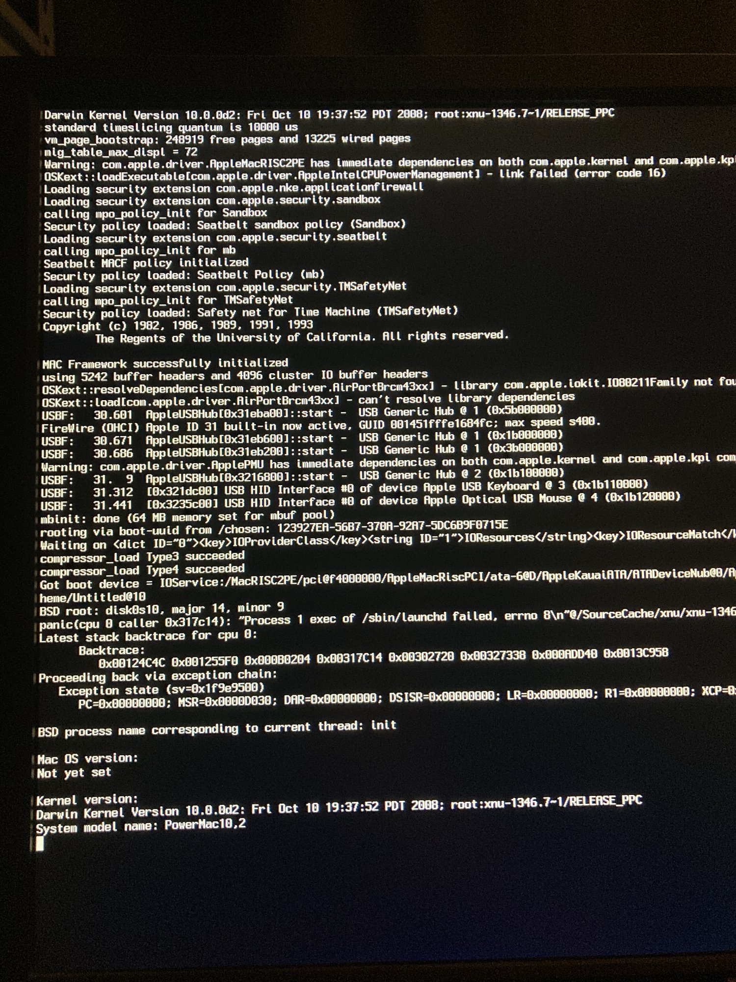

I'm at the part where SL finished installing inside Leopard, I attempted some sort of kext rebuild in terminal via "Sudo Chmod".
I modified the scripts only to match the file paths I'm using, and the scripts has no issues running with the exception of not finding the extensions cache.
Looks like this is what I don't know what to do:"and then (very important) set the permissions right to root-wheel xxx x-x x-x and delete the extensions cache"

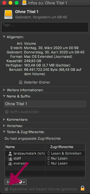

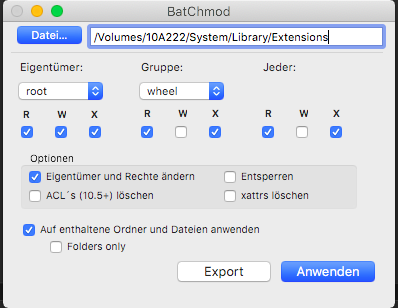

To set the right permissions, I´d suggest to use BatChmod.
And make sure that you you set "ignore ownership" on this volume (-> show info, then unlock and tick/de-tick the checkmark on the bottom of the window).
Otherwise the settings for the permissions won´t stick. Drag & drop works in a convenient way so you can take the whole extensions folder, drop it on BatChmod and then apply the (presumably still correct) permissions of the folder itself to all subsequent files in it.

I attempted to fix permissions by using Get Info >
I've just successfully installed 10A190 on my G5.
Has anyone gotten GPU acceleration working on anything but the 6600? I just installed all of the Geforce kexts from 10.5.8, but they aren't working.
Also, this is most likely a bug in this SL build, but I'm unable to access my file server. It's AFP, and it tells me that I "don't have permission" to access it even though the login is right. It was working fine in 10A96.
What have you done differently that I haven't?
1: I downloaded the 10A190 ISO and copied it to a partition on an external HDD - External HDD is a 500GB HDD via FW400 on a Mac Pro 3,1 (not the one I have running Mojave, a different one)
2: Used the script to replace kext files, only modifying script to match directory.
3: Ext. drive config/partitioning: 25GB for the Snow Leopard installation image, and the 475GB for the installation. Am booted into Mojave on my Mac Pro 3,1 using BatCHmod to fix permissions in extensions folder on install drive prior to installing on desktop on DP 2.0.
4: Once the install finishes I patch the extensions using the post install script, modifying only to change the directory
5: plug the 3,1 back into the Mojave 3,1 to use batchmod once again to fix permissions, this time on the installed drive.
6: Plug the 3,1 external HDD into the DP 2.0 G5, reboot into the installed drive, and this happens.
Note: The cache kext that's supposed to be removed at the very end is missing from the folder. There is nothing to delete.

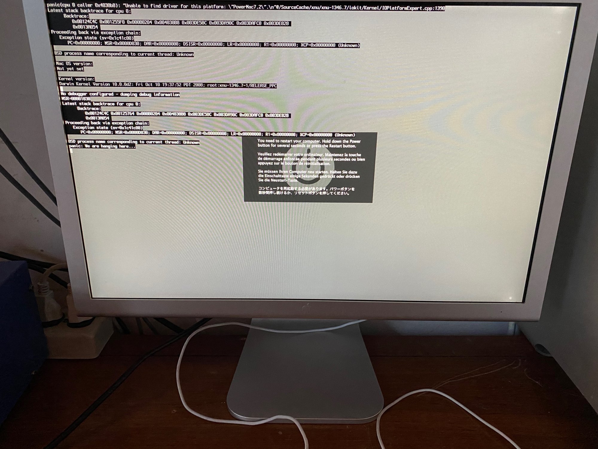

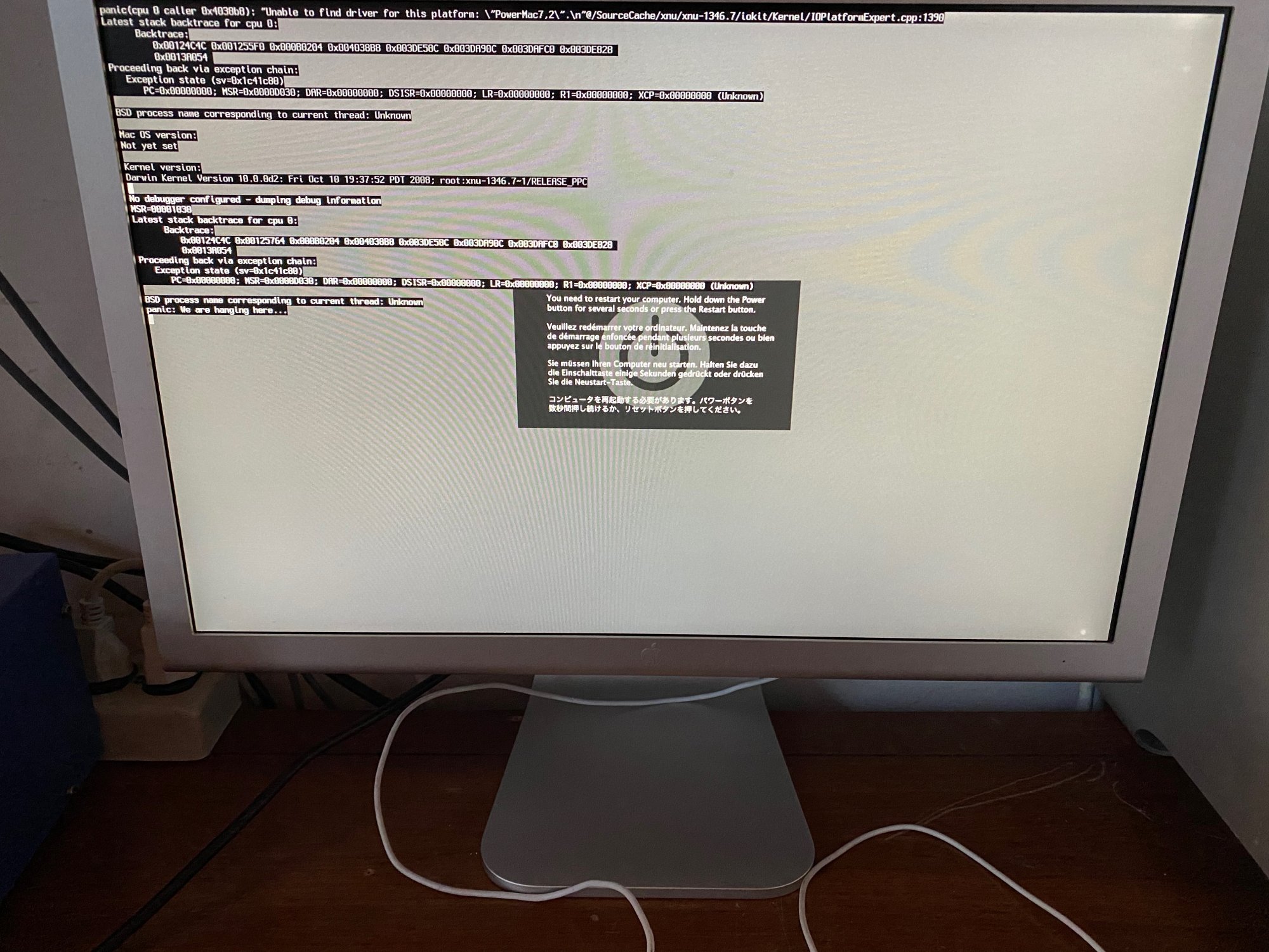

Doesn’t boot on a 1.5Ghz Mac Mini. It displays the “you need to restart” image before even showing the apple logo.
Verbose boots to here and hangs
This is the same working installation that I booted on two other systems.

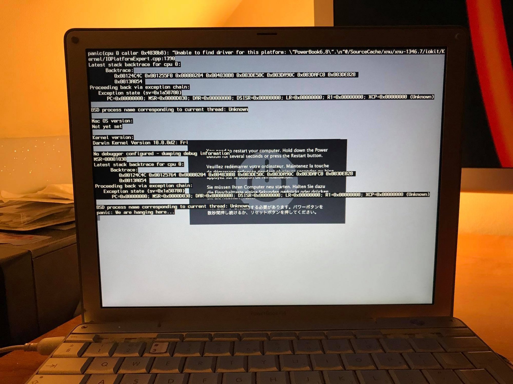

Retried on an external FW drive to my PB 5,9. Moved all kexts manually and set permissions accordingly. Checked for Extensions.mkext, which hadn't been generated and restarted with a Cmd+F to force a reload of all kexts. Still got the same KP. Might try 10A96 later.
