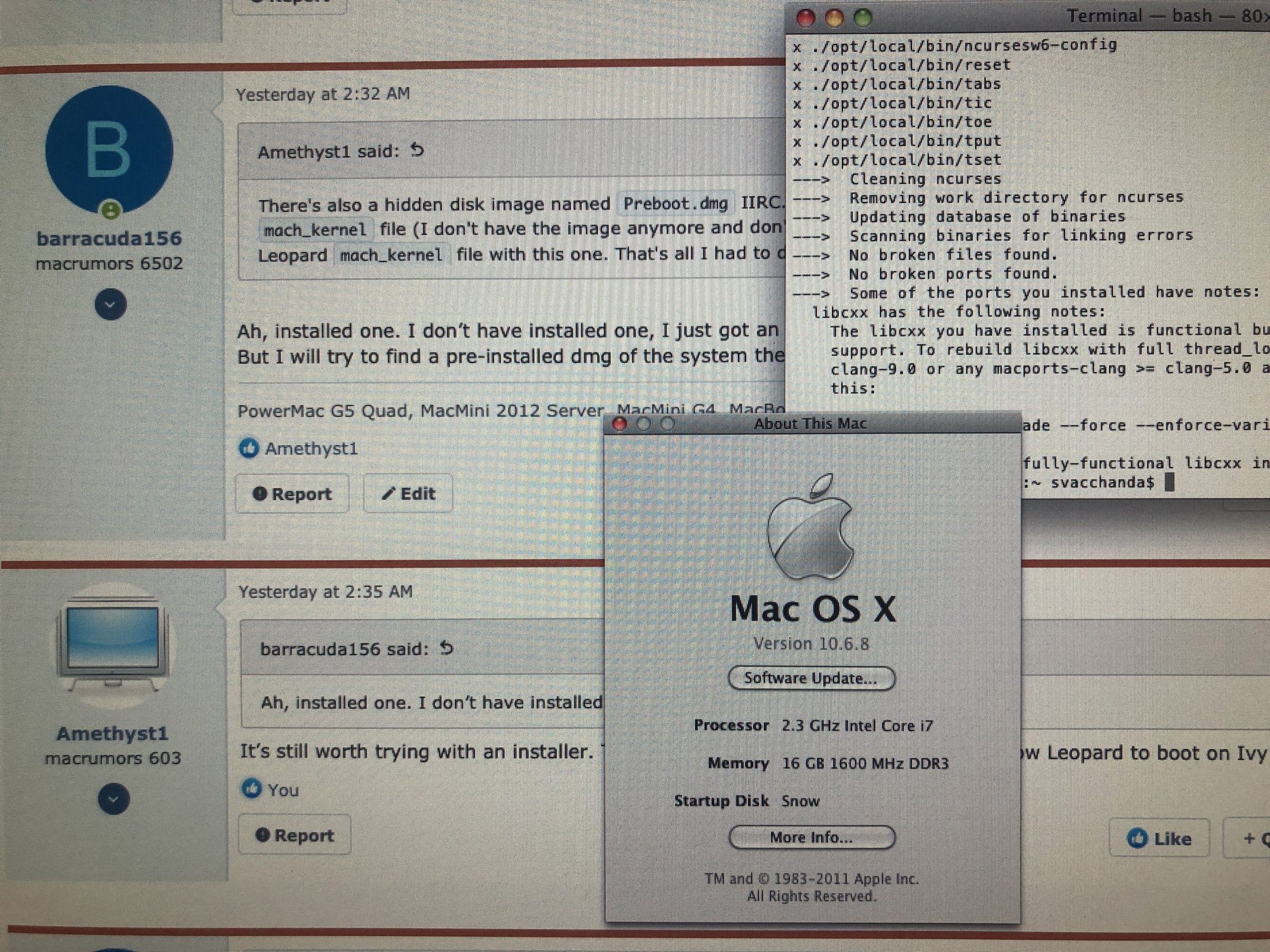

This is a complete thing, without any Intel parts removed, right? I am thinking to try installing it on my MacMini 2012. I have finally found out how to force 10.6 install and boot on it:
I am not overly confident the hacked Ivy Bridge 10.6.8 kernel will work with that early beta. Lots of kexts may not load, and if the versions of the kernel and System.kext don’t match you’ll have weird errors like disk images not mounting IIRC.
In any case, please report your experience :)
That’s pretty likely, but since I made 10.6.8 work on my MacMini, I discarded the idea to buy another one just for that purpose.
