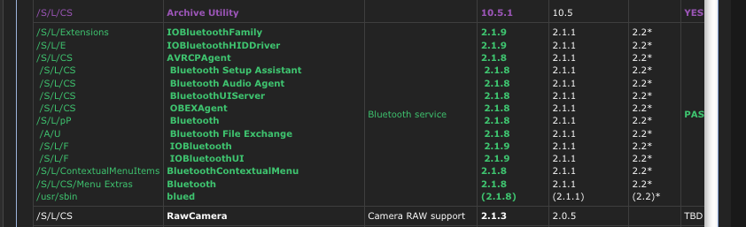

There were two 10.5.8 Bluetooth kexts — IOBluetoothFamily.kext and IOBluetoothHIDDriver.kext — I failed to include in Table 4 (along with /usr/sbin/blued and /System/Library/CoreServices/Menu Extras/Bluetooth.menu). Once I added these to my test Mac, using the third-party BT dongle, I got Bluetooth to work definitively:
I will need to do the same checking of my work with AirPort, even though I’m unable to test it. In the meantime, I’ll be updating the WikiPost tonight to account for the missing BT components omitted from Table 4. The above four components, along with 10.5.8 components already listed in Table 4 (see pic below from PackageMaker), should get you up and running.
I apologize for not figuring this out sooner!

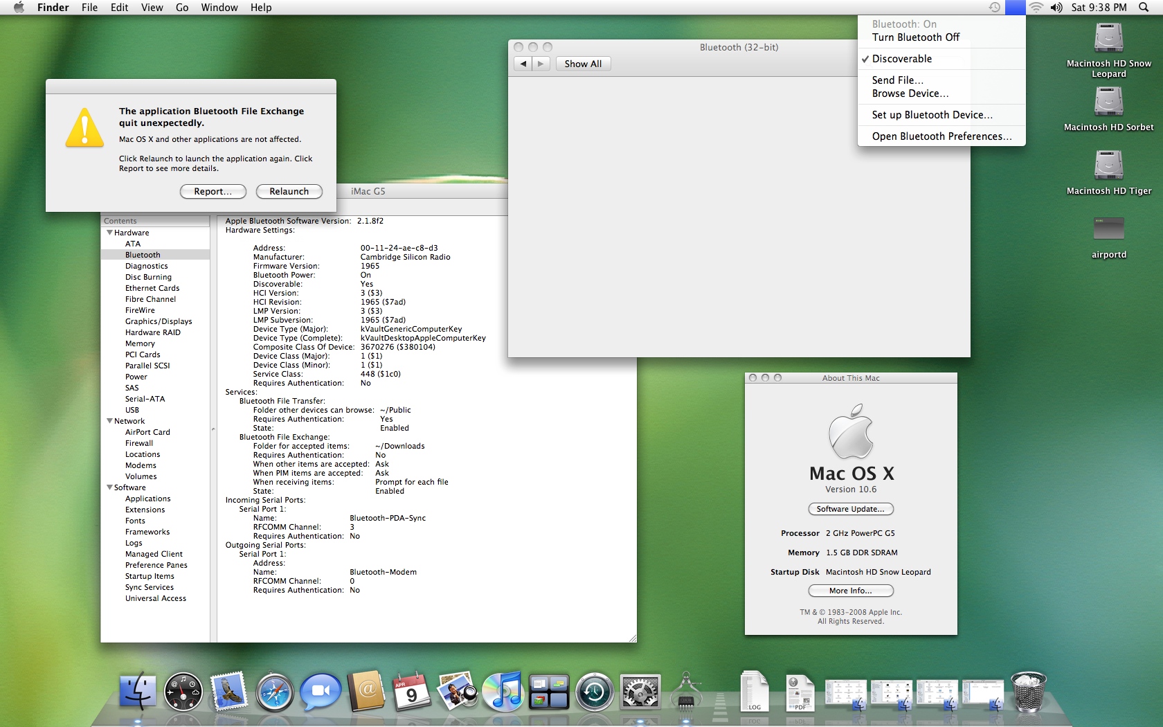

I tried it and it has brought me closer in many ways. (the iMac is actually discoverable!) However, I am still stuck with the pref pane issue and BT Setup Assistant and others fail to open. I wonder why. I have tried the pref panes from 10.5.8 as well as 10A096 and 10A190 with no luck...

I tried it and it has brought me closer in many ways. (the imac is actually discoverable!) However, I am still stuck with the pref pane issue and BT Setup Assistant and others fail to open. I wonder why. I have tried the pref panes from 10.5.8 as well as 10A096 and 10A190 with no luck...
I’d do a double-check that every last component here is in place:
…and then, check to make sure ownership/group and RWX permissions for them are all set correctly, before getting rid of/flushing Extensions.mkext and doing a reboot.

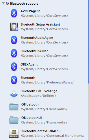

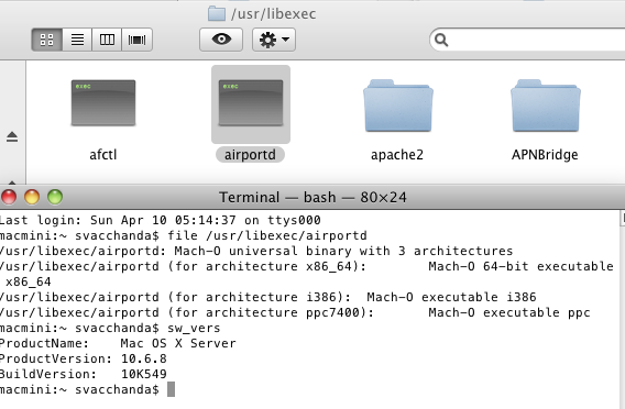

Also, some components retain ppc slices all through 10.6.8, for example, look:

Some PowerPC components were likely left for Rosetta compatibility. Doesn’t mean that they can be copied directly across from later builds in all cases, as they have dependencies that either don’t exist or do but require later versions to include the missing symbols. Things like IOKit and LibSystem for example need to be updated i many cases which is a TODO.

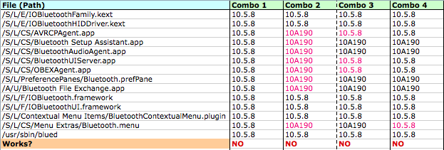

I am still struggling with the Bluetooth. Here's what I tried today:
The second combination (which I did after a clean install) brought things fairly close to working. I used BT Setup Assistant to try to connect to my 2007 MacBook, and it worked up to the point of "Gathering information...", where it got stuck. It showed on the MacBook and iMac that there was a connection in BT, but BT was frozen on the iMac. When I rebooted, I initiated it from the MacBook and it paired (with a code) but did not connect. The iMac froze. After that, anything to do with Bluetooth on the iMac is frozen, even after trying combo 2 and 3. The things I have left as 10A190 include the apps, which all seemed to crash when I pulled them from 10.5.8, and the preference pane which stopped working when I used the 10.5.8 or 10A096 one. I've used chown and chmod for all files. Does anyone have any thoughts?

You don’t owe anyone an apology and your testing is a valuable contribution to the project. It is just as important to know what doesn’t work, as what does and your detailed reporting of your exploration and investigations are exactly what this thread is for.

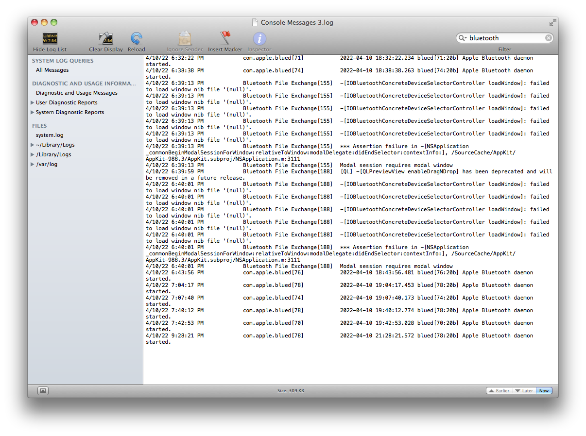

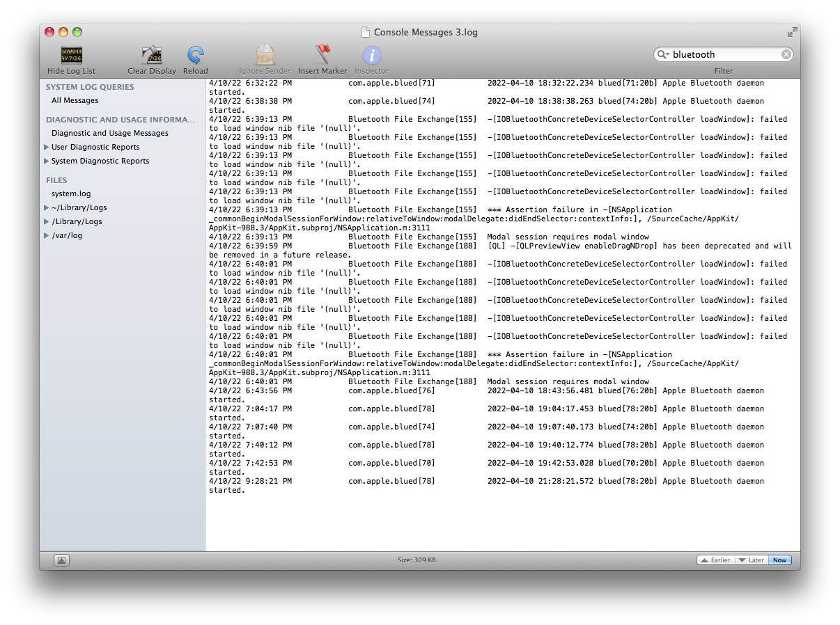

Can you pull up the console app and review the system logs and crash reporter logs? They are usually very illuminating.
This time it doesn't seem too illuminating unfortunately, for me at least. The main event is around 6:39 and 6:40 which is a my major crash event with Bluetooth File Exchange. If I remember correctly, this is my 2nd combination when I tried to connect to the MacBook with BT Setup Assistant and it got stuck. I force-quit it and then opened up BT File Exchange twice to see what would happen; both times it got stuck and crashed. Those are the only two crash reports I can find, and are attached. The crash error seems to relate to memory? but that can mean many things in this case I suppose.
