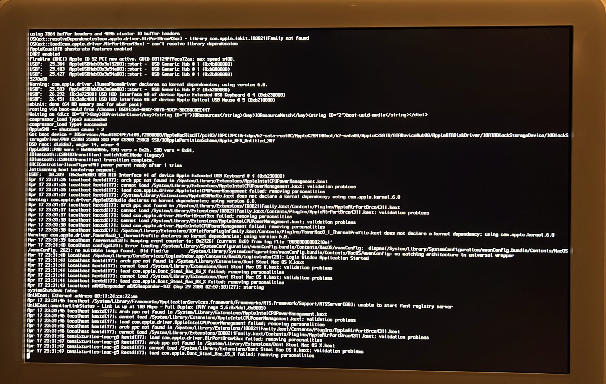

Did you correctly set permissions and ownership on the cupsd binary? Your system log is showing a ‘Bad cpu type’ error which should not be the case if you’re using the 10.5.8 executable.
Your log still shows Bluetooth errors related to Appkit - did you try replacing the framework with the Leopard version, or corresponding version to the Bluetooth components you’re attempting to use?
Reactions: tensixturtle
@ChrisCharman at the time of writing I had only gotten around to ntpd. But now I moved cupsd and Appkit, and was rebooting into SL to do permissions when I got a no boot. Once a KP. I did verbose boot and got this:
After that it seems to go in a "Login Window Application Started" loop. I must have really messed up this time :/
Do you have any thoughts possibly? I probably have to do a clean install.
Thanks

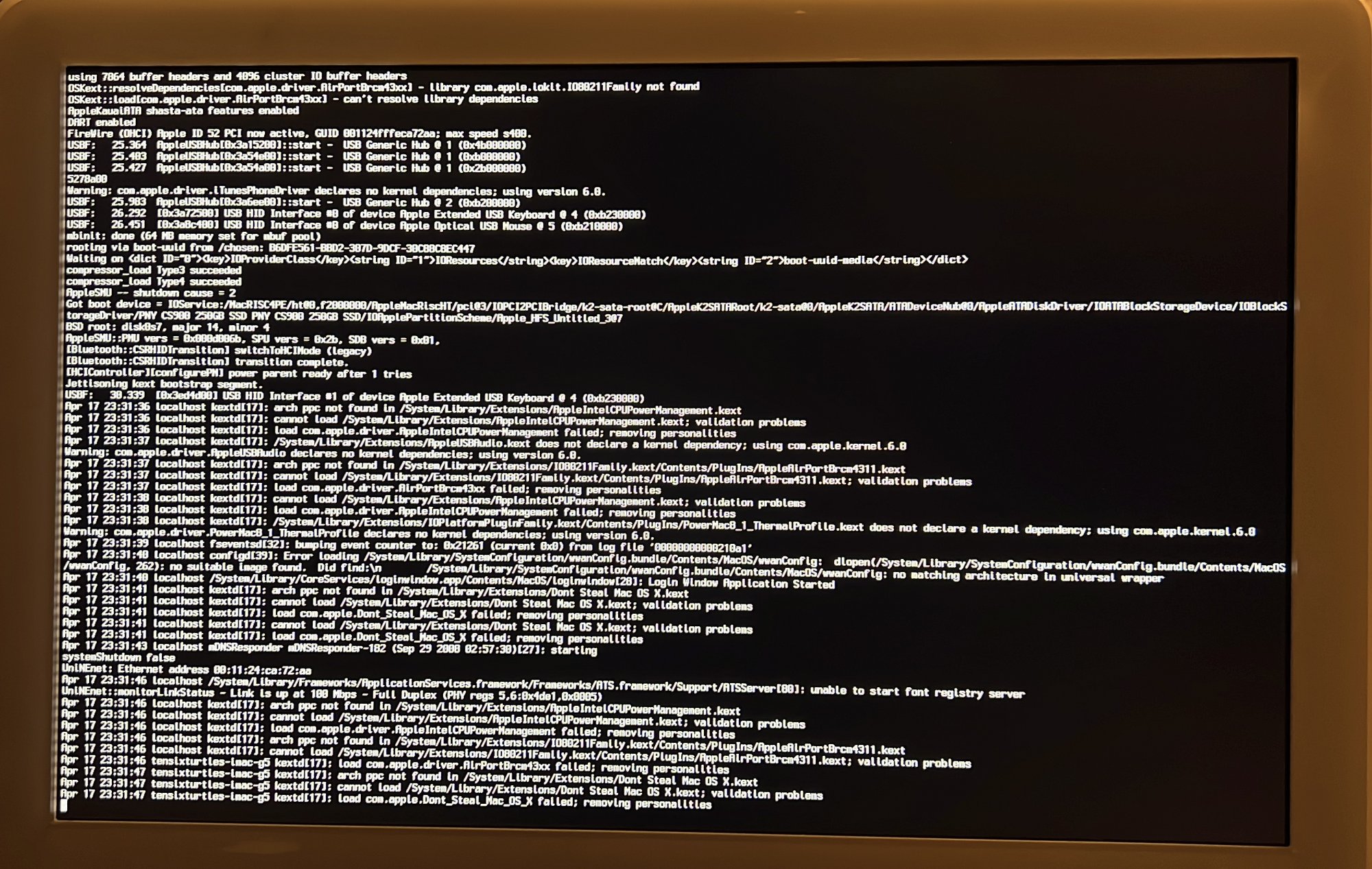

Your Bluetooth is recognised so you’re certainly part way there. Have you replaced the Bluetooth preference pane with the Leopard version?
I don’t see anything on your screenshot that explains the hang but based on what you’ve said and assuming you replaced the Appkit Framework correctly, it seems like it’s not compatible without additional work. Replace Appkit with the original version and you should be fine again. Don’t panic if your system fails to boot when messing with system components, it is to be expected i’m afraid. You should check the log files to see what went wrong.

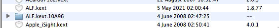

A general rule of thumb I use when testing, which might come in useful for anyone who’s beginning to get their hands dirty with the inner workings of SL-PPC:
For every single file and directory I bring in from another source, such as 10.5.8, or QuickTime 7.7.0, I never overwrite anything in the SL-PPC environment. What I do is I use, as root, a “mv” (“move”) command to rename the SL-PPC file/directory I’m going to replace first before copying in stuff from another source. That way, if I need to revert back to square one, it saves a lot of trouble along the way.
In short, mv-and-cp routine more or less looks like this, as root (here, dealing with the ALF.kext):
# cd /System/Library/Extensions/
# mv ALF.kext ALF.kext.10A96
(note: for mv/rename, I use “10A96” as suffix to help me mark the original file from my 10A96 install)
# cp -R /Volumes/[[Leopard\ Install\ Source]]/System/Library/Extensions/ALF.kext .
# chown -R 0:0 ALF.kext (sets correct ownership defaults)
# chmod -R xxx ALF.text (where “xxx” is set to whatever other contents in the same directory already have — often 755, sometimes 775, less so 644)
That’s basically it. Now I’ll have a ALF.kext.10A96 and an ALF.kext in place, and the system will ignore the 10A96-suffix item(s).
In short, I now have hundreds of items on my SL-PPC system with that .10A96 suffix (peppered with a couple of other suffixes from other sources).
Hope this helps.
For BT, I think you should consistently pull over all BT-related components from 10.5.8 (since on 10A96 it is broken), and make sure to set not only permissions, but ownership appropriately.
Yes, I will try to do that. I had originally done this but Bluetooth was only half-functional. The menu in the menu bar wouldn't work and the preference pane wouldn't open. The iMac was discoverable, however. I think I have been remembering my chown and my chmod commands for every file.
I have not replaced the preference pane with the one from 10.5.8. I had in the past but no way would it work for me. It wouldn't open and System Preferences ended up hanging. Then, I couldn't get the 10A190 one back, the only one that opened. I had to re-install, although there would have been a better way to do it probably.
Hope this helps.

@tensixturtle To be clear, you shouldn’t be replacing system files within the running OS, you need to be doing this from the command line while booted into your Leopard installation. Attempting to rename and then replace system components, while the system is running, may be the cause of some of the errors you have experienced.
@ChrisCharman Sorry, I was unclear; I replaced files from Leopard and was doing permissions from SL. Perhaps I should be doing both from Leopard then.
Thanks
Reactions: ChrisCharman
Thanks
You may find that some of the changes you made that wouldn’t work or prevented the OS from booting to the desktop, were because the ownership and permissions were incorrect. System components must have the correct values set in order for the operating system to recognise and use them before they will be loaded. There’s no harm in setting them again once you’ve reached the desktop, but replacing the files and then booting without first doing the above is almost always going to result in some form of crash or hang.

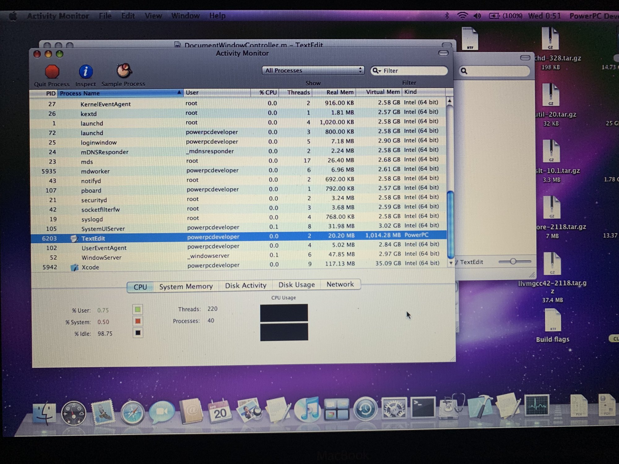

Yeah i’ve managed to build a number of projects as universal but haven’t tested them on a PowerPC machine yet - will update you soon.
I can finally confirm that PPC binaries build and run on 10A190 on Intel (as they should, anyway). Rosetta appears in 10A222.

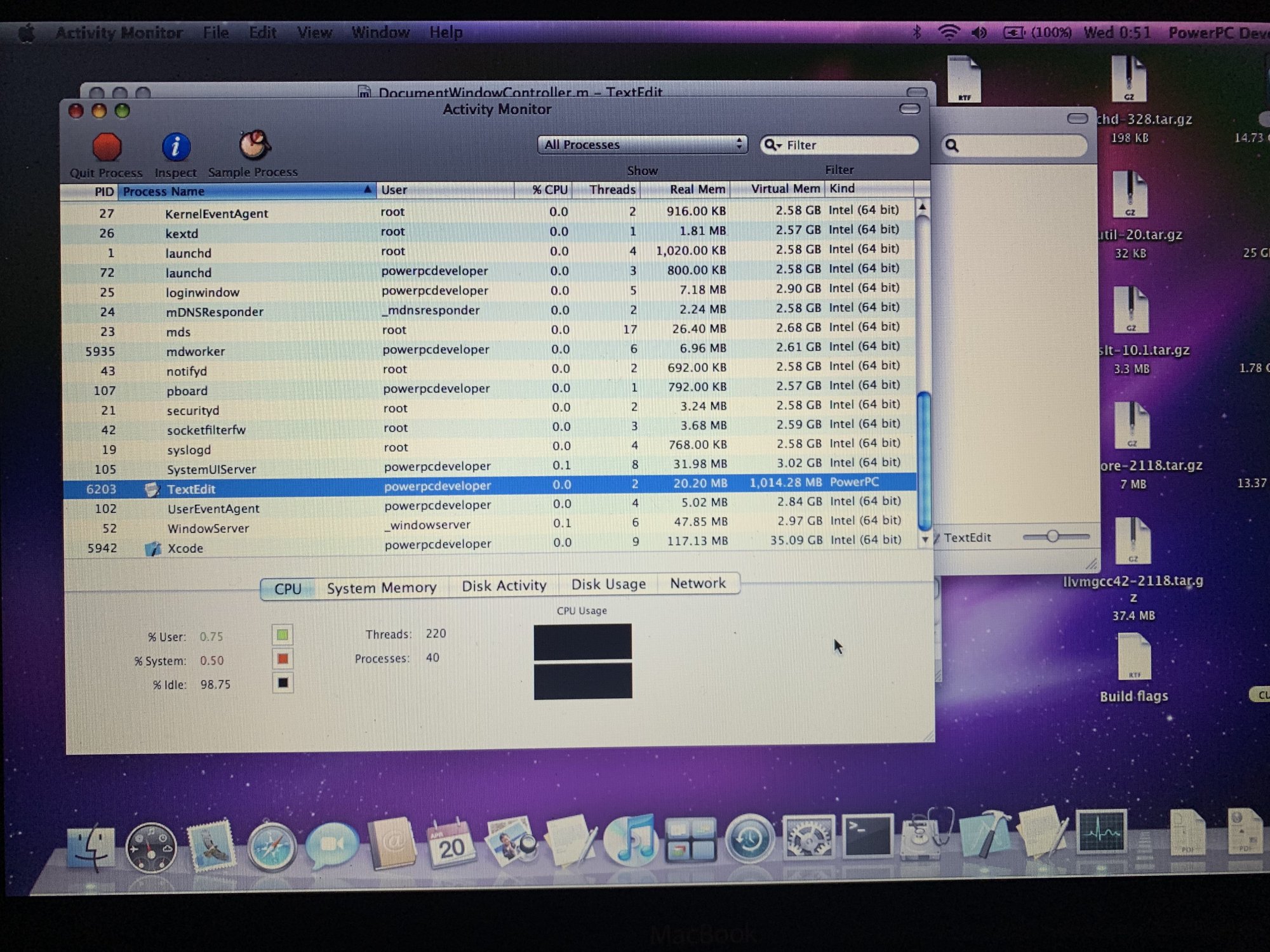

By the way, do you have an idea why Darwinbuild is failing on PPC? There is nothing arch-specific in the source code. The single file that sets arch for Darwinbuild itself is prefix.xcconfig and it’s plain text. It does not seem to use some advanced fancy stuff like atomic operations, no assembler, it should be completely trivial. But it does not work.
Yeah they work under Rosetta on my intel machine as well, i just haven’t tested if they work on an actual PowerPC machine yet.

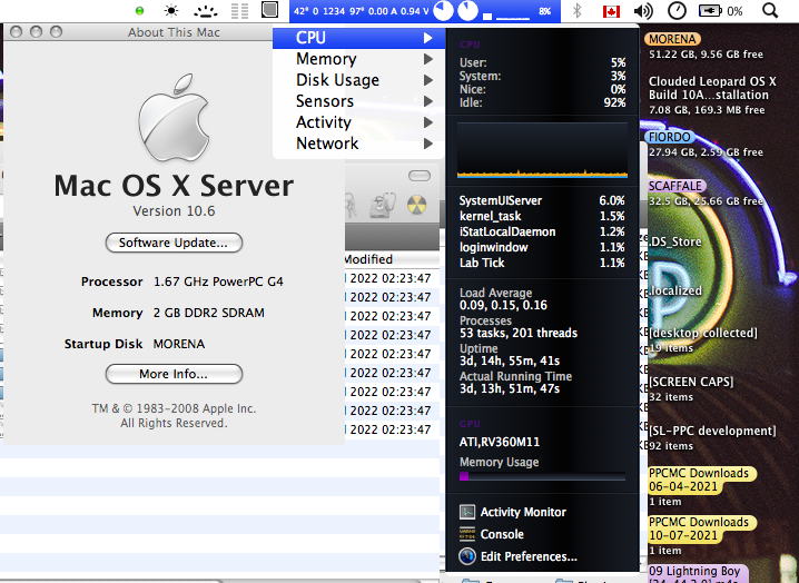

Bumping this thread a little after a quiet little spell.
I’ve been busy with other life things and haven’t been able to throw much time and focus on SL-PPC stuff since last month. One of those things, topically speaking, has included a rearrangement of my home network (not terribly exciting, but it is what it is).
But… I thought it might be fun to share how quiet and unexciting running 10A96 on a A1138/A1139 PowerBook G4 can be. I happened to look up to see this earlier and made a screen cap. It’s not the first time I’ve seen how uneventful this combination can be, but it’s the first time I’ve thought to screen-cap it and share.
Hopefully before too long things should settle down a bit and I can return to working on that Clouded Leopard 10A96 updater. :)
