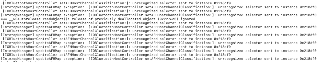

Just a brief update on my vain attempts of getting bluetooth going on my iMac G5: after replacing the IOBluetooth.framework to 10A096 as well as 10A190, no new bluetooth devices are recognized. However, I observed an odd behavior. I was able to select my pre-paired speaker as when I click "Use headset" it switches the audio output and says the speaker is connected. However, it actually isn't.
Looking in the log I see a lot of messages related to blued.
I am away from the iMac G5 for a few days, but should I try different versions of the bluetooth daemon? I will also replace the IOBluetooth framework to 10.5.8 and hopefully re-enable the pairing of new devices.
P.S. On the original wikipost's list of bluetooth files/paths Contextual Menu Items is written as ContextualMenuItems and BluetoothAudioAgent is written as Bluetooth Audio Agent. Would it cause a problem to change this? It's not very important but confused me in the past. If it is not a problem I am happy to change that but I don't want to mess things up.
