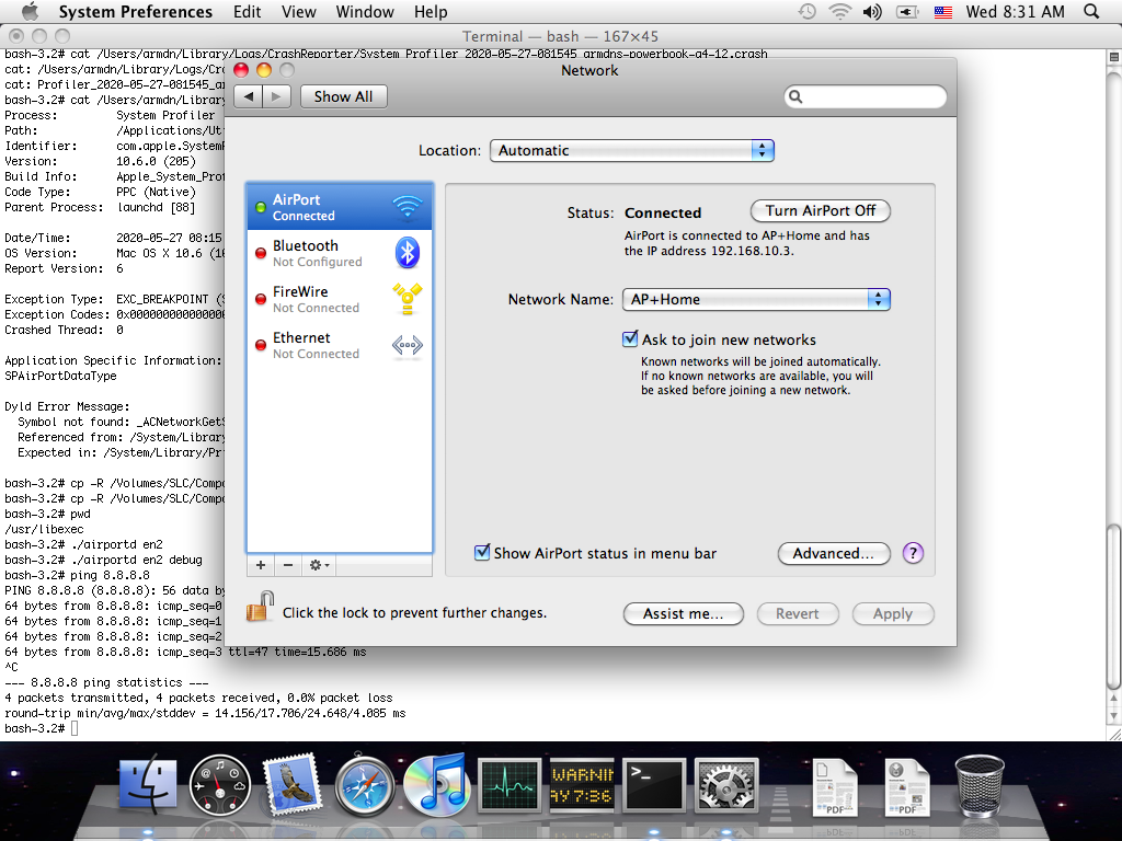

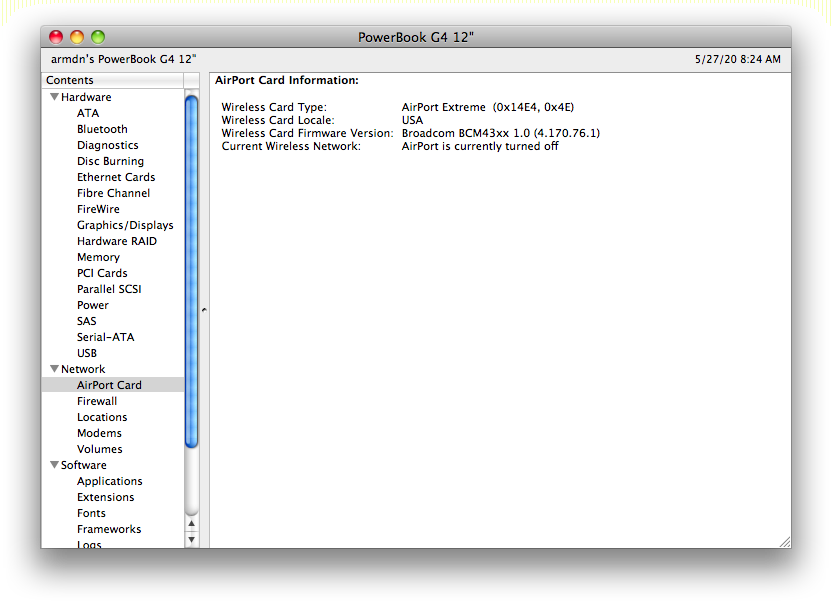

FIXED! Airport Extreme is now working!
And somewhat fixed AirPort section of System Profiler. But it is incorrect detect status of AirPort Extreme. Actually it is active...
What to do with that little bugs is still a question. And in logs many errors about CarbonLib or something...
To make AirPort Extreme working, we need to import these components from 10A96 above the same in 10A190:
/System/Library/CoreServices/Menu Extras/AirPort.menu
/System/Library/CoreServices/Apple80211Agent.app
/System/Library/Frameworks/AirPort.framework
/System/Library/PrivateFrameworks/Apple80211.framework
/System/Library/Extensions/IO80211Family.kext
/usr/libexec/airportd

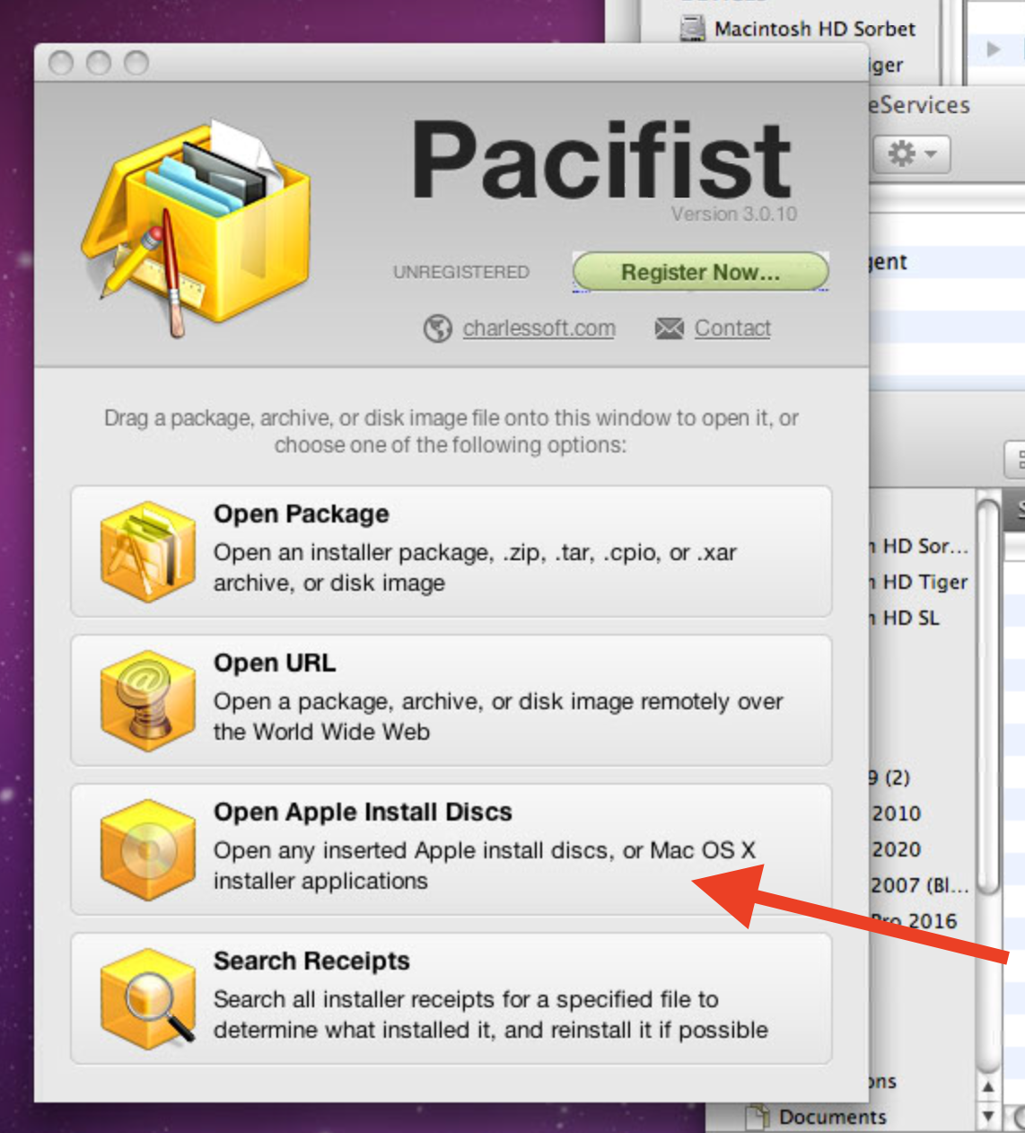

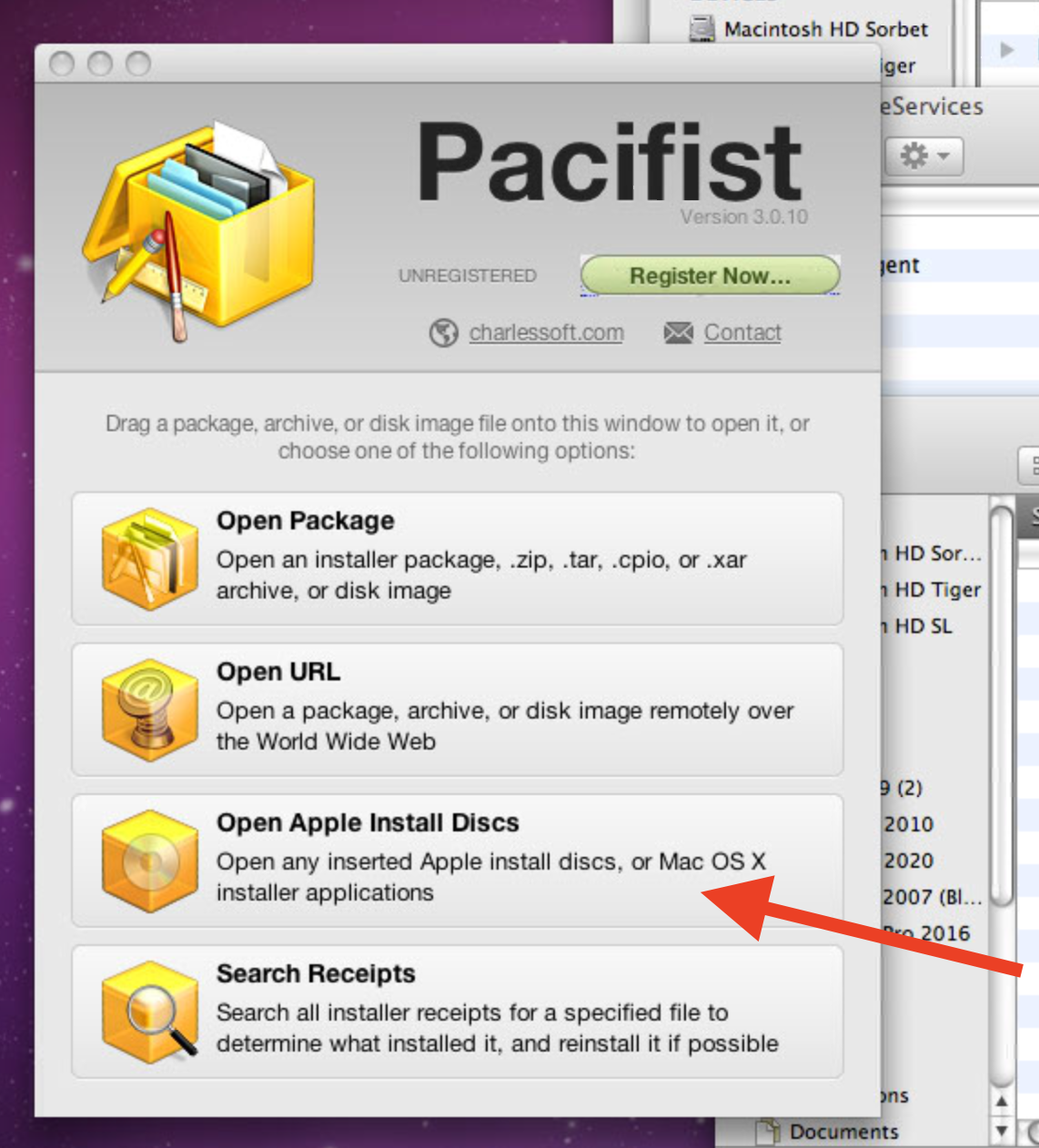

In the future, if you have another Mac you can use Pacifist to extract files you need from an ISO install disc. First mount the ISO then
You may have to do a little digging around in the folders but the files should be there.
