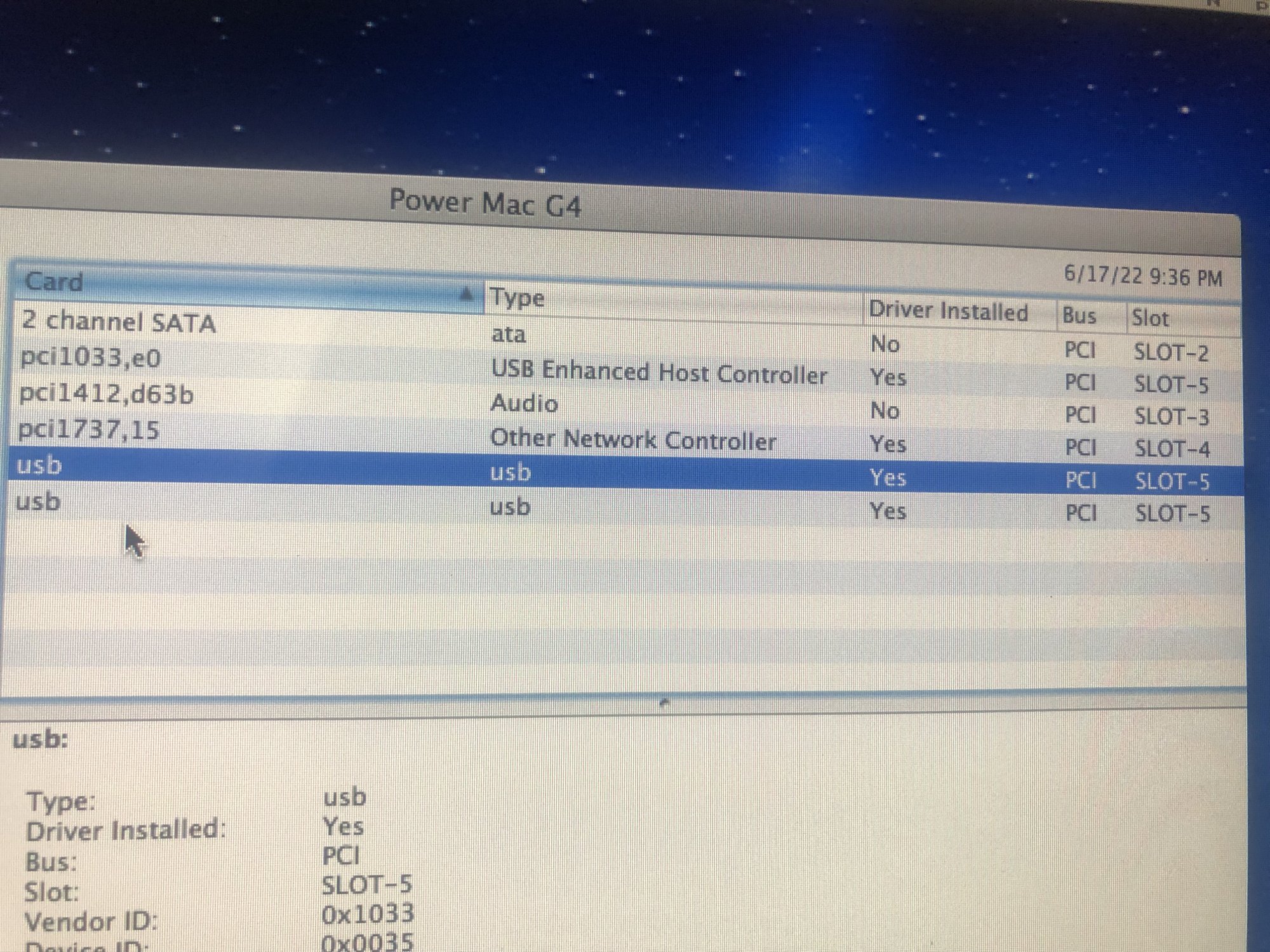

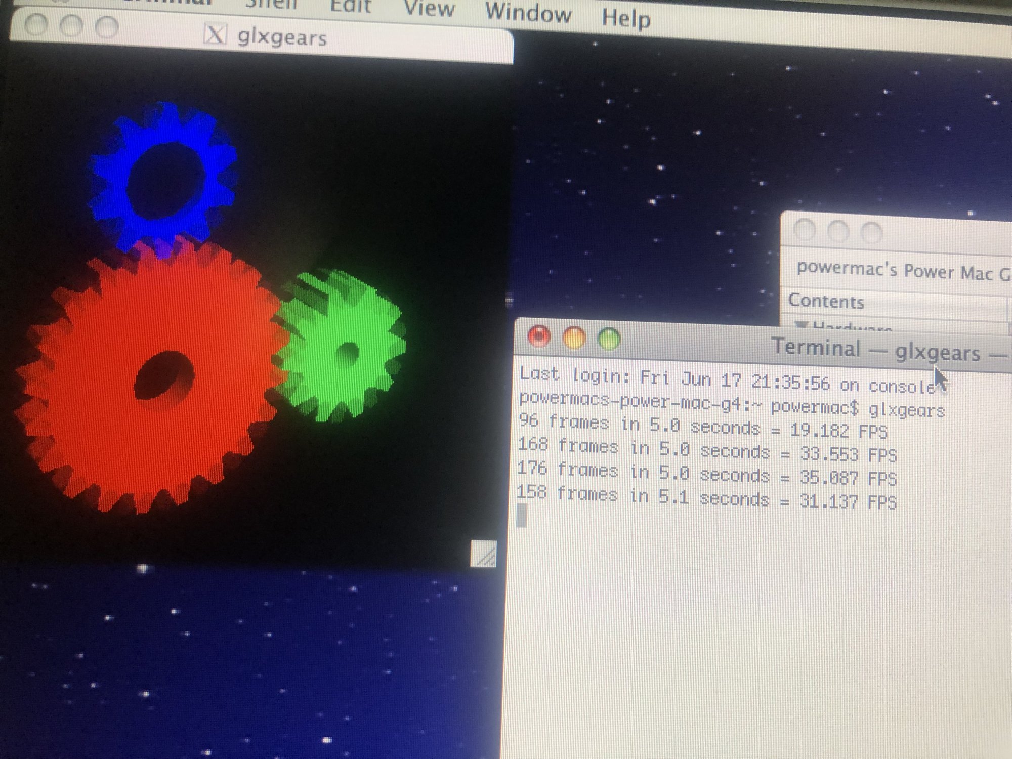

So… Decided to give 10A96 a try.
USB NEC PCI card works OOTB, suprisingly even Linksys b/g Wifi(BCM43xx) .Bluetooth recognised(CSR BT 2.0 USB dongle) but not working due to issues mentioned here. M-Audio Delta 1010LT installs, but kext is not loaded. (Prefpanel works, but does not see card) SII 3112 card also not working as on 10A190.
Overall performance is like Monterey on Ivy Bridge without GPU patch.(100% CPU, laggy interface)
Anyone has scripts to hack QE support on Radeon 9000 PRO?(want to relieve CPU a bit)
Glxgears do work, but on 30 FPS instead of 60.

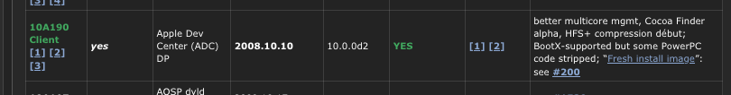

SHORTCUT: A pre-installed image of Build 10A190 is available (Table 1, “Fresh install image”). With thanks to Action Retro, we can present how to jump-start & skip manual patching steps. This image may only work on certain Macs.
Sean of Action Retro is the most helpful person ever. His videos are amazing! I flashed his image onto my g5 and it runs great without any issues!
