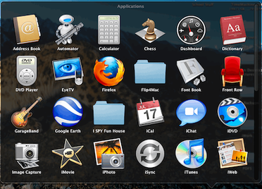

Sure, but it looks like they introduced e.g. the grid version of Applications with subfolders (which will simply open in Finder under Leopard) also viewed as grid in 10A286, among other things?
I’m not quite sure what you’re referring to here?
The stacks feature in grid view supporting subfolders, my bad
It looks like the 10A286 version is as funcitonal as in 10A432?
Ah ok. I see how you mean here.
Yeah. As, this isn’t a feature I use, I went ahead and tried it out with 10A96 and then compared it with 10.6.8.
For one, the options menu (right-clicking on the stack) in 10.6.8 is the dark, translucent style found with later Snow Leopard UI features, while the 10A96 version’s options menu is the more conventional light grey, opaque background (and lacking the ability to view sub-folders within Stacks). Both versions show basically the same Stacks options.
Both Stacks backgrounds use that dark, translucent grey we tend to associate with the more recent Snow Leopard builds, so at least that much made it into 10A96.
My guess is, as part of the full Cocoa re-write, the Stacks portion (I’ll have to check if there’s a Stacks framework somewhere) was re-written in parallel, along with Dock.
