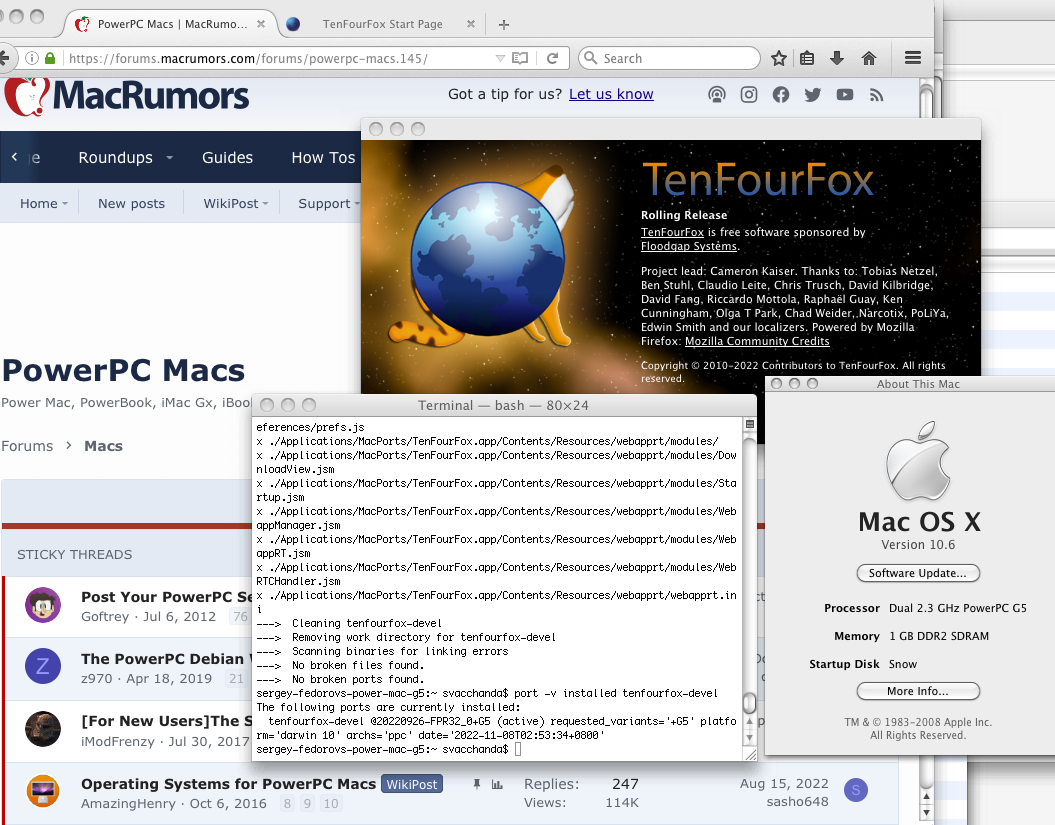

Just built TFF from the latest commit on 10A190:
