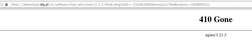

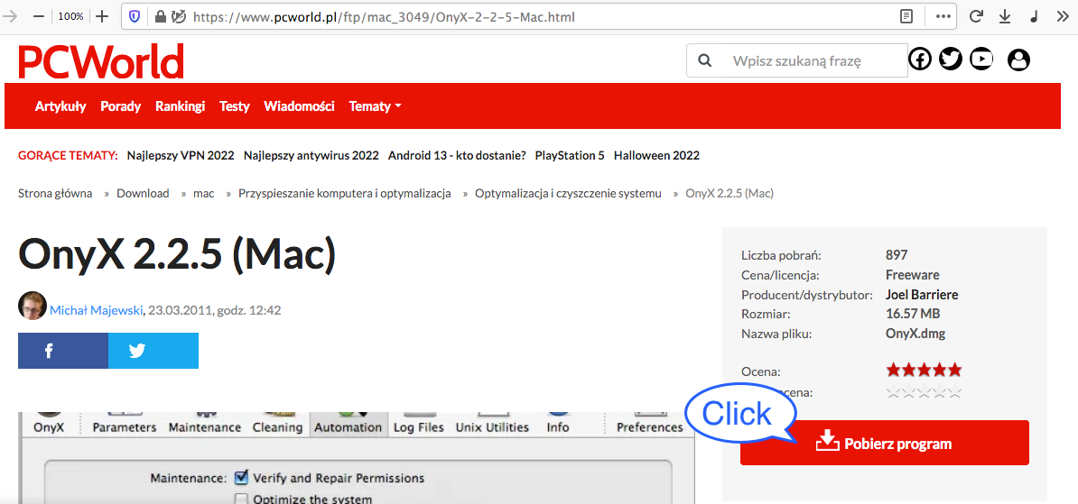

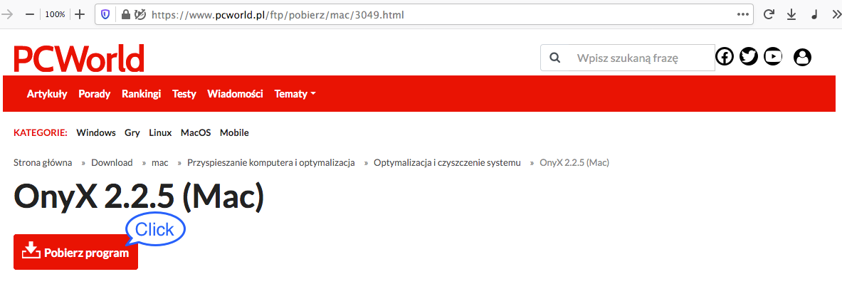

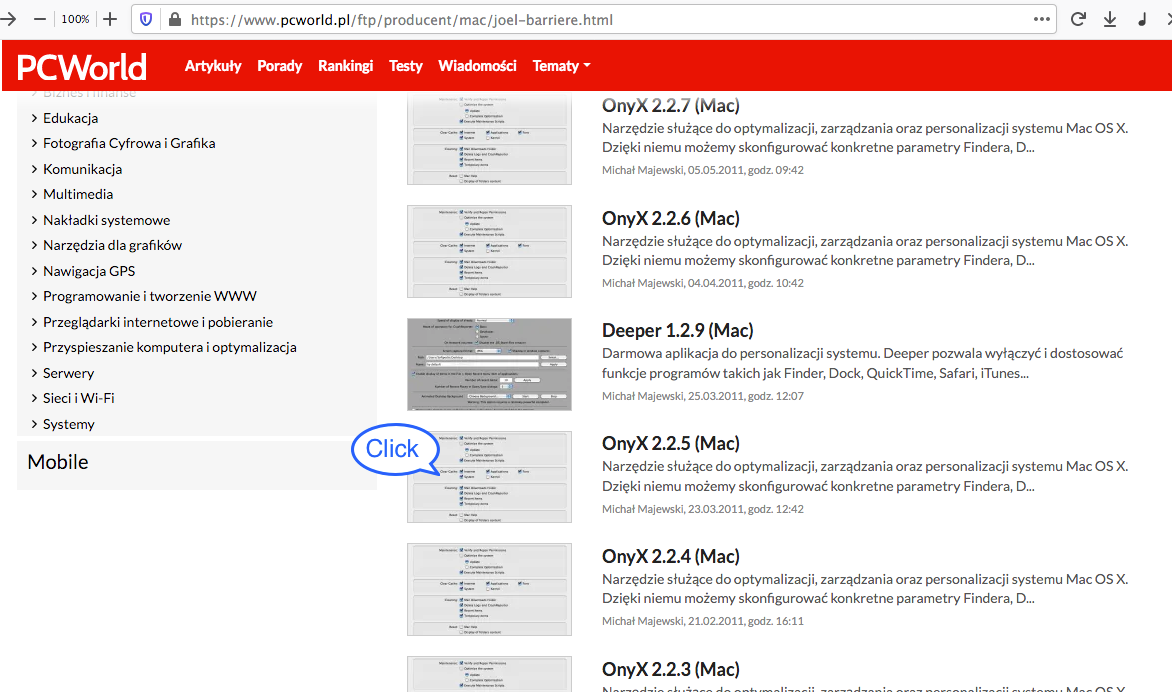

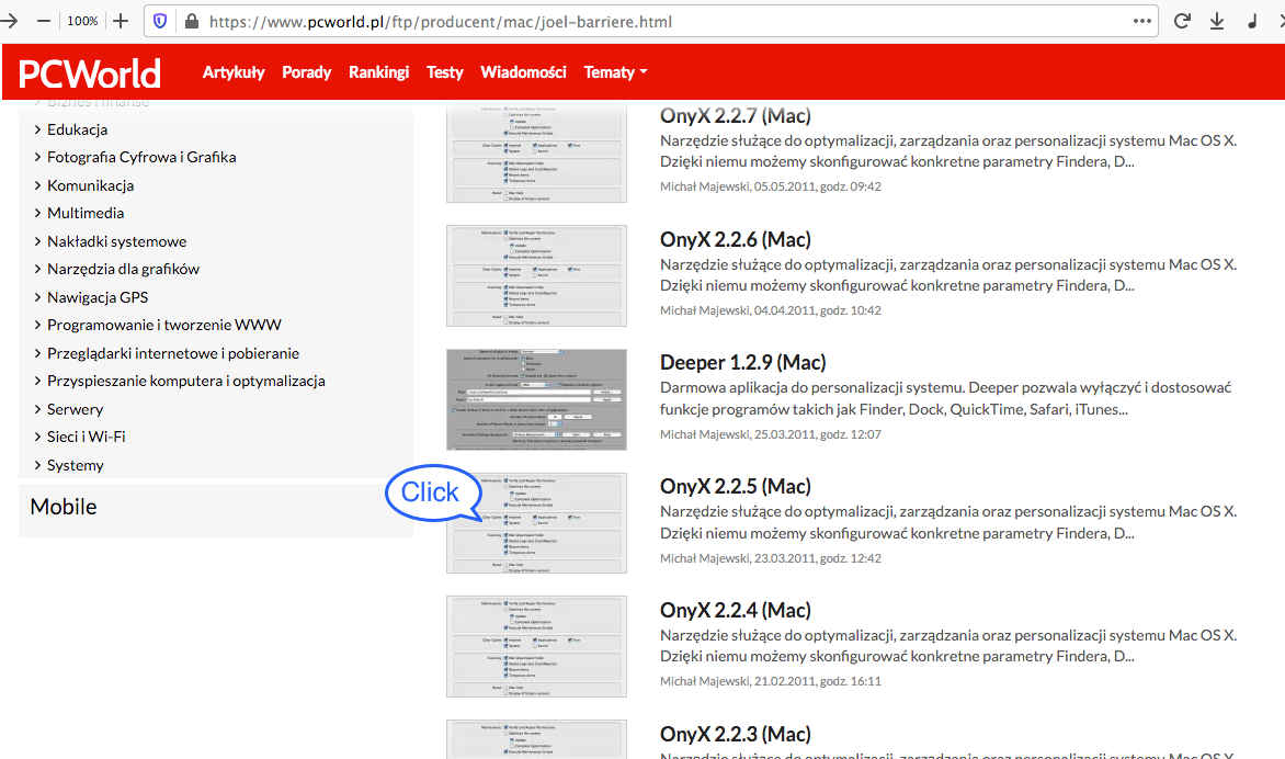

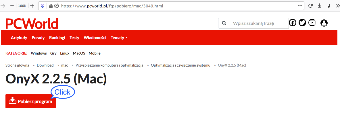

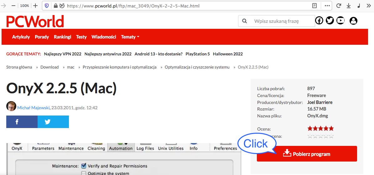

Not dead at all. I just checked. Downloaded like a charm.
I have obviously tried, but:
Checked again and it still works using Firefox 78.15.0esr on Yosemite.
Try different browser. Also note that final download link has md5 checksum that expires at some point.
UPD: I've tried downloading with latest InterWeb, SpiderWeb and Firefox Legacy (Nightly) on Snow Leopard MBP2011 and got the same 410 error.
UPD 2: In last step (in my instructions), instead of clicking on download button, try 'Save link as'. Worked for me this time on SL/MBP2011 with Firefox Legacy.
Note to others!
Download from that PC mag site as much as you care ASAP. All that stuff will be gone sooner or later.
Note to others!
Thanks, it worked on a new Mac with 11.7. It did not on a PowerMac with TFF. Not sure if the browser is at fault or network connection.

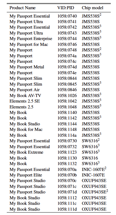

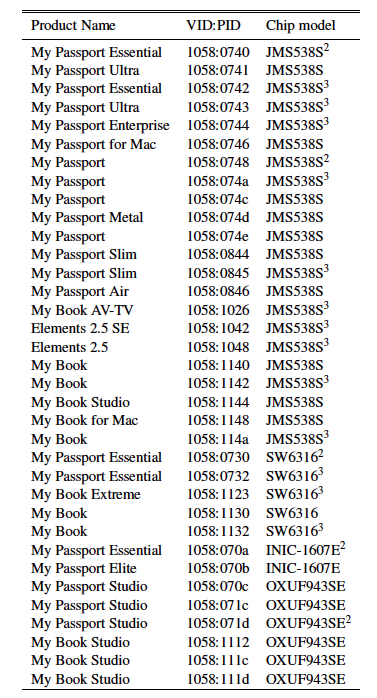

Had a few hurdles to get it running as I found out the hard way that my Firewire WD My Passport Studio is not a drive this G5 can boot into. Mostly stable with the little I have done so far, minus my copy of TFF compiled in Tiger crashing when I wanted to browse to attach the photo below. Drag-n-drop worked fine, as I am posting in a Tiger compiled TFF on this system.
Interesting.. Which model of WD My Passport Studio?
I suspect it is because of either drive being encrypted (by default, btw.) or drive spindown settings or both.
Or old firmware, although that's highly unlikely.
I learned after I did a fresh install of 10.5 to it, in order to have a live copy to build SL.
Found the following thread on Apple discussions.
The following external hard drives are not bootable on Power PC based Macintosh computers systems through USB/FireWire 1394(a/b):

Read through the discussion @840quadra linked to on Apple’s support discussions. All the information you need is grouped and itemized there.
Huh? I was asking which specific model from my list he have, as there are many. It has nothing to do with Apple’s support discussions from 2012.
But not the same firmware, smarty. ;)
OK, I'll stay out of this discussion, it's counterproductive.
Sounds good. Let us know when you find and can link to a reference on different WD firmware revisions and their confirmed ability to boot (or not boot) OS X, as firmware wasn’t something you asked @840quadra specifically. 🤷‍♀️
(I own a My Book Studio Edition II, and your remark is the first I’ve heard a firmware revision will somehow make it a bootable FW drive for Power Mac G5s — especially interesting because the drive is RAID 1-configured.)
Model is wdbk8a0010bbk-00 which is a My Passport Studio which was originally formatted for Mac.
No idea what firmware it has, and honestly have moved onto using a different Firewire drive that helped me get a test bootable SL OS onto this G5.
The WD drive is back in use as external storage for my B&W G3 tower.

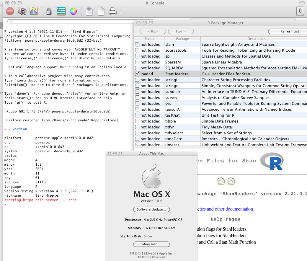

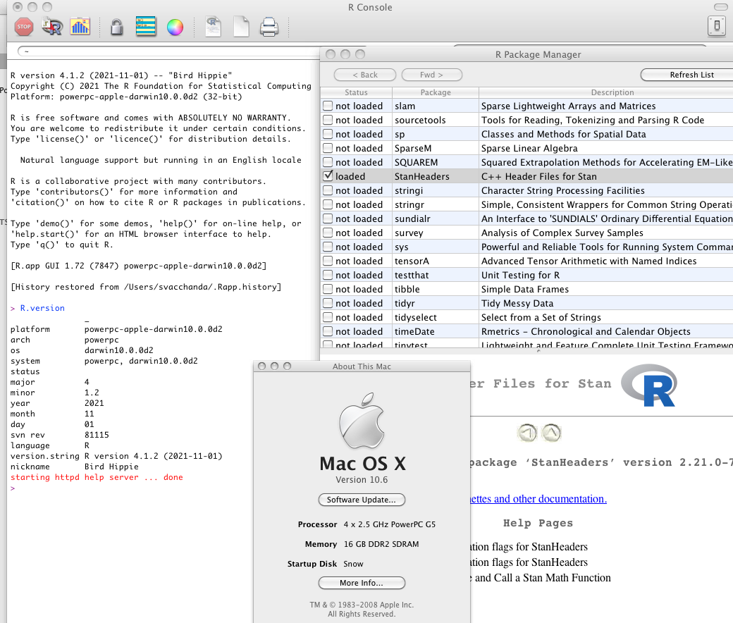

Another update on R, and I will make a break from it. I have built R GUI 1.72, which apparently works with minor bugs. R GUI 1.76 compiled but crashes on start. Both suffer from incompatible XIB files, so I had to replace those from 1.70. Perhaps benefits of using a newer app after such modifications are questionable.
To anyone who may consider making the latest R work on PowerPC with GUI, I guess it is safe and good enough to stay on either 1.67-68 or 1.70.
Here is the list what I managed to install, most of these easily built from source, some required tweaks.

We can safely add to Wiki that R 4.1.2 is functional with R GUI 1.67 / 1.70.
Number of packages fail to build, however what does build is enough for most of people perhaps. Then best Bayesian framework (Stan) fails, but several alternative ones have built. Some of devtools and some of tidyverse parts do not build. Nevertheless this is a usable set-up.
Awesome work! Did you have any issues compiling the 1.67 / 1.70 RGUI app? You had to compile gcc7 and obviously R 4.1.2, right? How long did it take? (I had compiled R 4.1 for Ubuntu ppc and it had taken a couple of hours, similar ballpark I guess, but gcc10 before was much longer if memory serves)
I have added support for old systems here, and it sorta automates the process: https://ports.macports.org/port/R-app/details/
Unfortunately, on 10.6 PPC for an unclear reason it fails to compile 1 xib file when done this way, so it won’t work now. Given that it does build outside of Macports, it is fixable. I will try to get back to fixing that soon.
As of now, anyone wishing to build R-app on 10.6 PPC may either do the whole thing manually or do sudo port patch R-app and then copy build directory somewhere – and just build with Xcode.
I do not really remember which version built without replacing xibs now. It was something of 1.6x.
R builds quite fast on G5. Definitely less an hour, I think about 30 min. Need to try. gcc takes around 3+ hrs for a single arch in Macports. If you hack stage 1 flags, can be built faster, like 2.5 hrs (this is on Quad).
