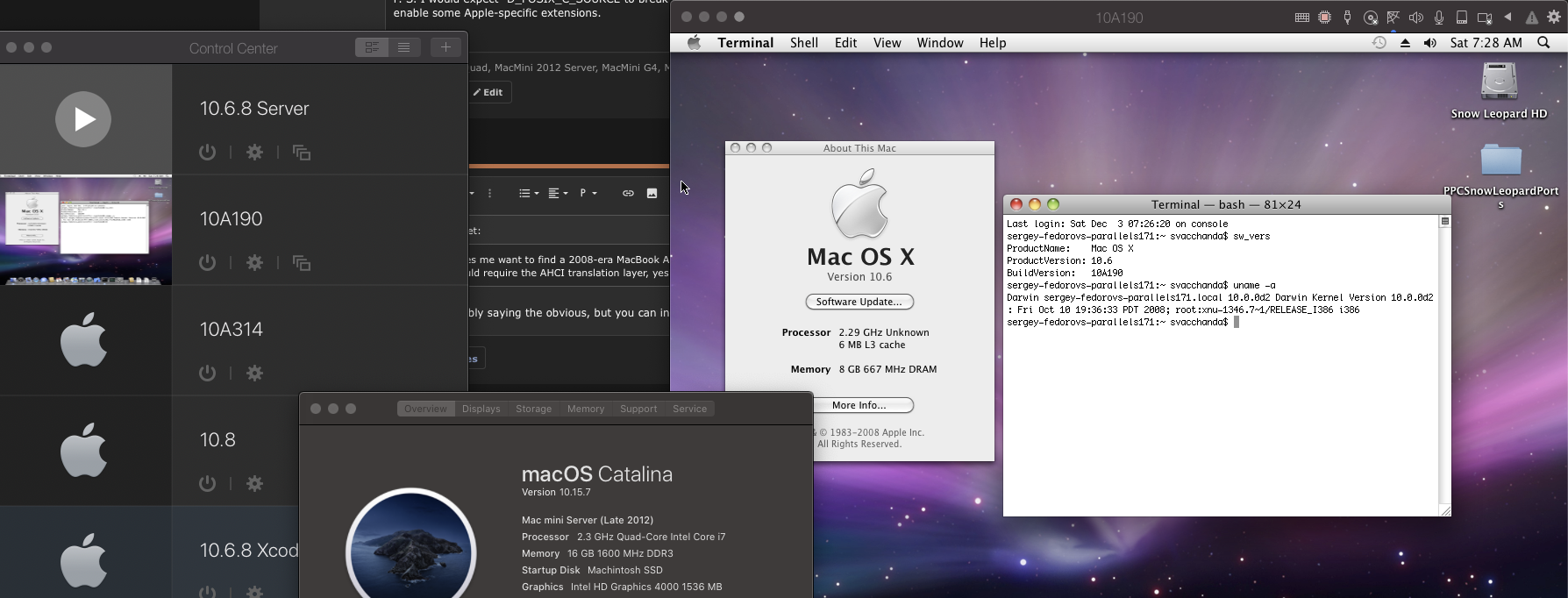

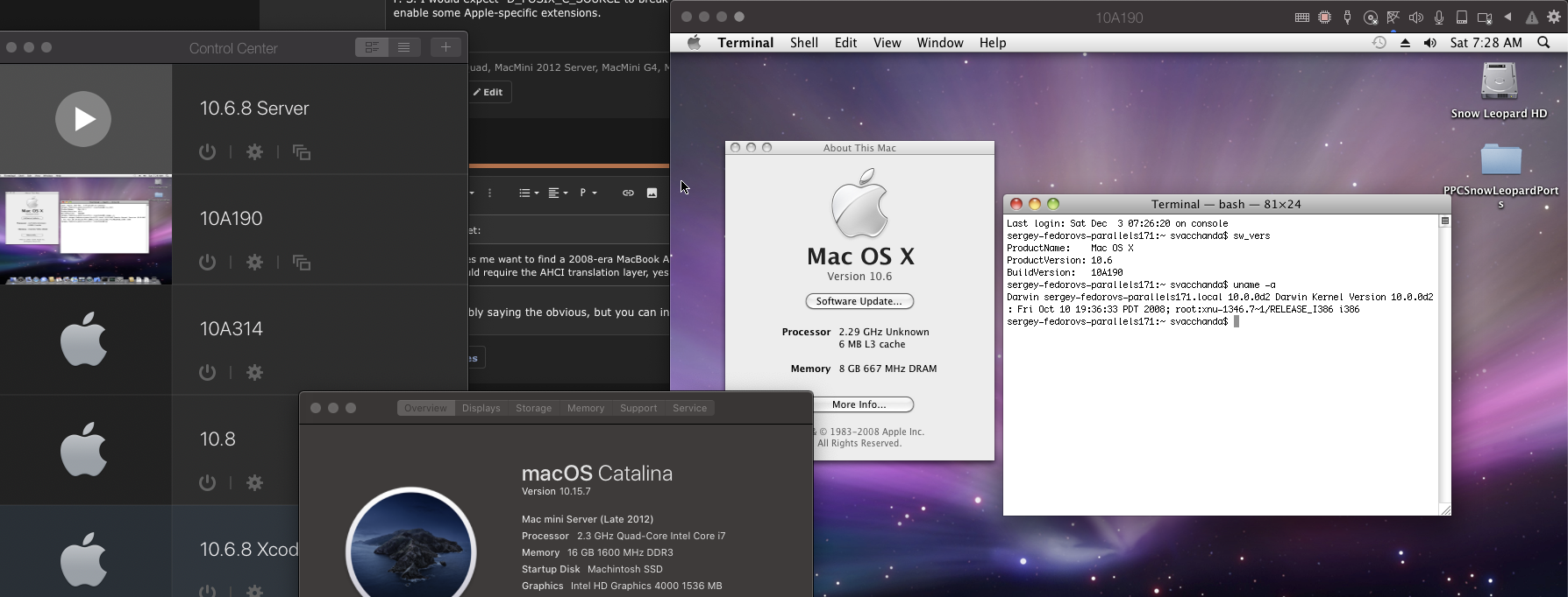

This makes me want to find a 2008-era MacBook Air and to try running one of the SL-PPC builds on it. As I understand it, these would require the AHCI translation layer, yes?
I am probably saying the obvious, but you can install SL-PPC in VM.
Yes, but could a VM replicate the hardware conditions of a late 2008 MBA? :)
I have no doubt there are possibly dozens of variables one could configure in a VM like VMware or Parallels in which SL-PPC would run fine. For the kind of testing I prefer to do, working with the actual gear is a priority, in that doing so it leaves little room for doubt when a component, bus, or hardware configuration works or fails.
A problem you may run into when testing on a late-2008 is that ‘96 is a few months older than the MBA while ‘190 was released at or around the same time.
That being said, what would a 2008 MBA offer as a SL-PPC test mule? :)
