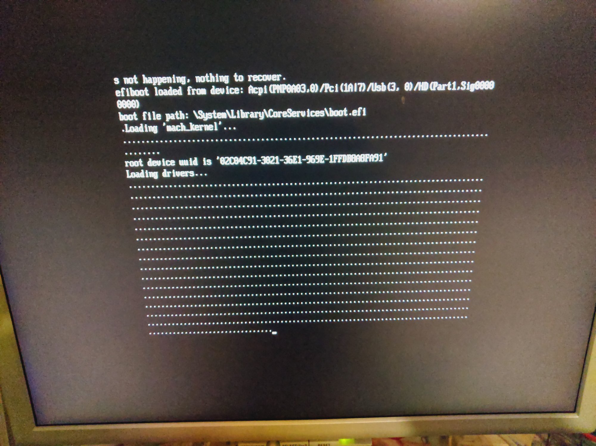

You need at least a pached mach_kernel to prevent panicking due to the Haswell CPU.
I'm 99.999999% sure it will panic on the MacPro5,1 due to the CPU(s) being way too new — and due to the AHCI blade, if you have one. 😉
You were spot on on that one 😉, 10A190 halts just past kextload on the 5,1, very likely needs a kernel patch to support Gulftown and Westmere (but potentially not Bloomfield and Gainsetown since they are both supported under 10.5.6 with the MP 4,1)

10A190 is older than 10.5.6 though.
Yes I wondered about that too, but not by much, 10A190 12/11/08, 10.5.6 15/12/08, so it might have it in as they were likely developed in parallel, but possibly independently, in which case 10A190 might not have Bloomfield/Gainestown support

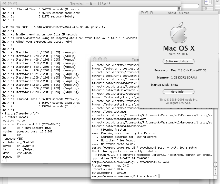

Thanks a lot for that; R GUI 1.72 seems to work, I did get 1.73 to compile and work on El Cap however indeed with minor bugs too (notably exiting with status 0 when either having a typo in the package name with library() or trying a missing one).
Most things seem to work but with R 4.X under old versions of Darwin such as under SL (and El Cap too) all calls to CLOCK_MONOTONIC will fail as this is unsupported <10.12. I had tried setting -D_POSIX_C_SOURCE=199309L as compile flags (also in .R/Makevars) but to no avail. However a workaround in the source of the R packages (and other sources that use it obviously) is as follows:

Still interested in R?
I have written an implementation to install R packages via Macports – and while it is not as easy as adding a PG line, once I figured out how to deal with typical errors in a alien R way, things get fixed.
You will likely get malloc errors on PPC, if you install packages directly. I suspect it is because some packages link to libgcc_s.1 in /usr/lib and not a native dylib of the compiler (since C++11 is needed, gcc-4.2 cannot be used).
otool -L shows libraries being linked.
So anyway, normally these are quite easy to fix in Macports with legacysupport.redirect_bins, but it does not work with R packages (or my implementation of install system); however, I found a manual way to achieve the same result.
Long story short, in about a day I wrote PG, about 120 ports, and finally have RStan built and provisionally working:
