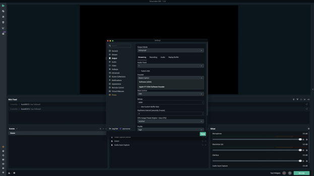

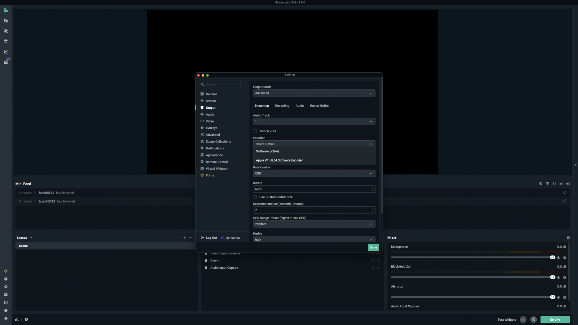

I've tried setting up both OBS and StreamLabs and run into problems.
1. Streamlabs will not recognize the M1s hardware video encoder. When I open up Settings and Output (and switch to Advanced to see all options), only the software encoders are in the dropdown menu. This has led to video recordings that are super-choppy.
2. OBS does show me the options for the M1 hardware video encoding - but it won't recognize my webcam at all, even though I have given the program full permissions for video and recording.
If anyone here has some insight on how to fix one or both -- or has come up with a way to record smoothly, please let me know. All help is greatly appreciated!
mine is really choppy. it says it's streaming at 60fps, it doesn't show skipped frames, but when i view the stream it looks horrible.
I think a big part of the problem is that neither OBS nor Streamlabs has really optimized yet for the M1. Their performance is most likely hampered by running through Rosetta.
