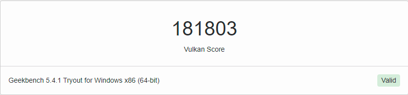

That 6900xt score didn't look right compared to 6800 so I ran it on a lowly reference 6900xt so non-AIB. Vulkan > OpenCL but proves the point that API doesn't make a huge difference and in this case ~12%.
6900xt Vulkan
https://browser.geekbench.com/v5/compute/3564577
6900xt OpenCL
https://browser.geekbench.com/v5/compute/3564587
