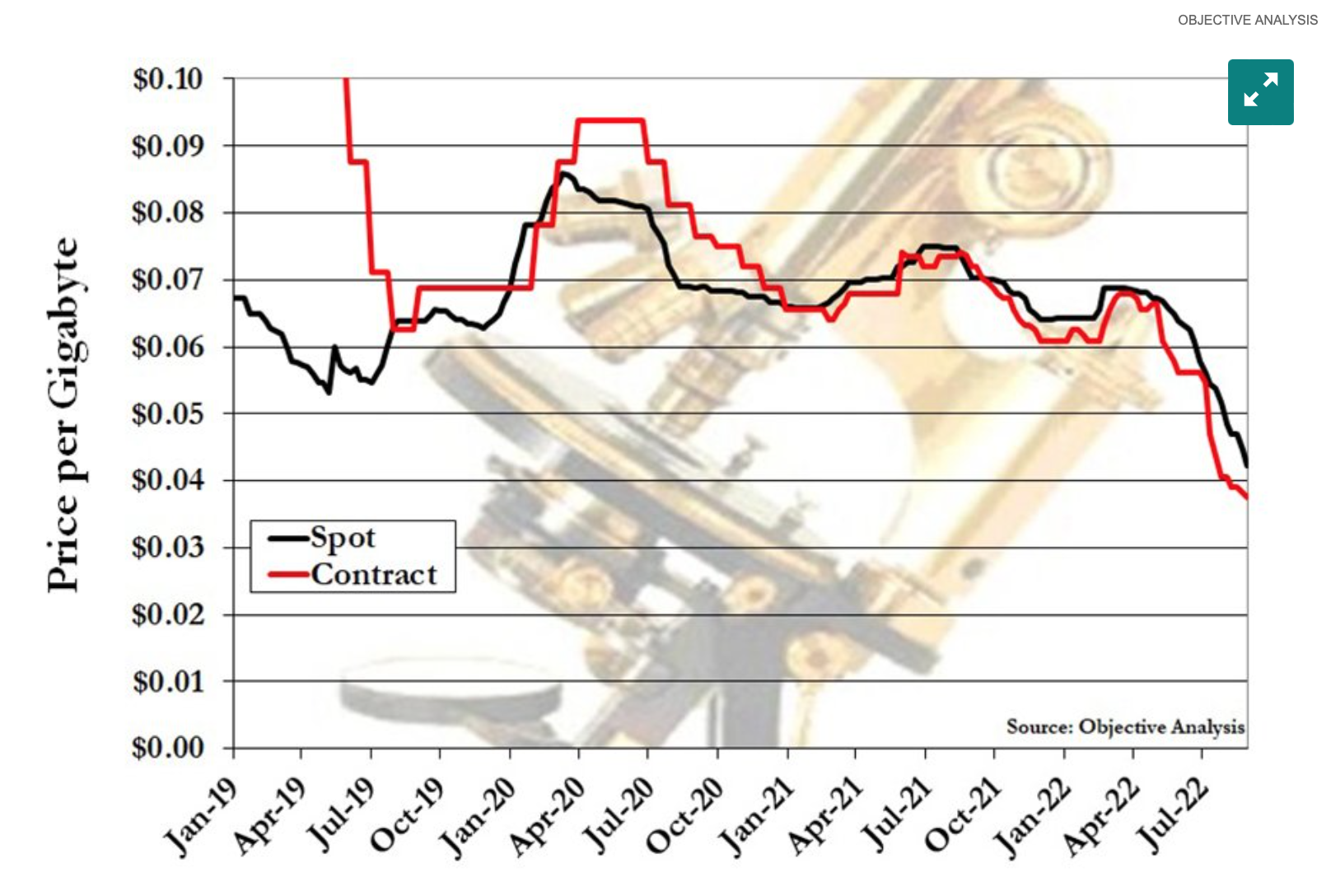

Probably not in the short term. We're current in a bust phase of the market's normal boom-bust cycle, but that's unlikely to affect prices in the near future. Over time, NAND prices will continue to go down (historically by about 30%/yr). Consumer storage needs will continue to go up, but not at 30%/year, so the net cost should continue to decrease.
Source:
