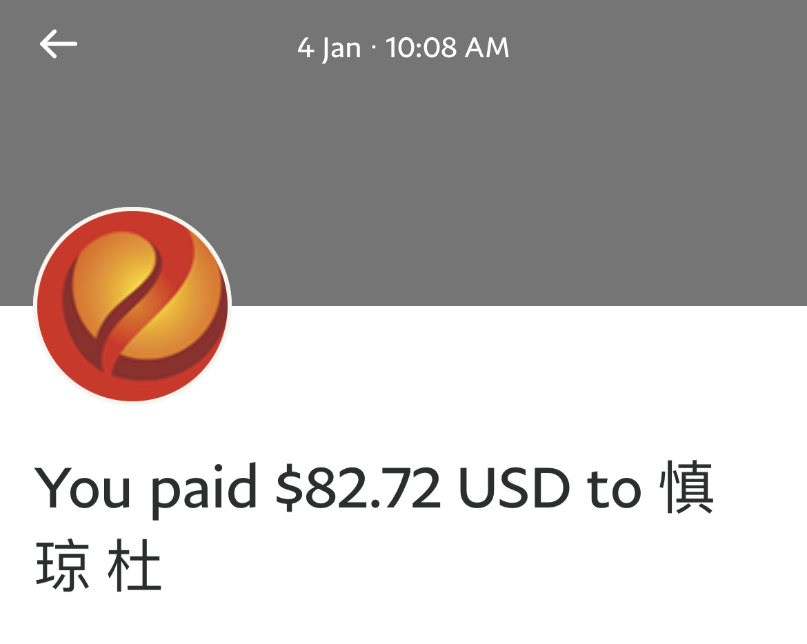

I’ll just re-post what I wrote on Reddit.
Disclaimer: I'm not affiliated with any tools mentioned under this comment. Proof of purchase: [
TLDR:
[https://www.mfcbox.com/blog/about-i...m/blog/about-itunes-1110-error-repair-by-mfc)
This paid software actually saved me from boot looping, despite it looks scammy.
Detailed steps:
1. Purchase "1 Year iMFC function Activation", follow the instruction from the product page to activate your account
2. Follow the instruction from here: [https://www.mfcbox.com//blog/about-.../blog/about-itunes-1110-error-repair-by-mfc/)
3. If the first flash resulted in an Apple logo with a \~1% progress bar under it that stucks for a long time, force reset and enter recovery mode and flash again. Mine work in the second flash
4. You should see the iOS being flashed and after it, your phone should boot with white background and prompting for data recovery. It's ok to unplug now. Things should be OK til this point, just wait for it recover all the data and the long-missed homescreen should appear after that.
TLDR:
Detailed steps:

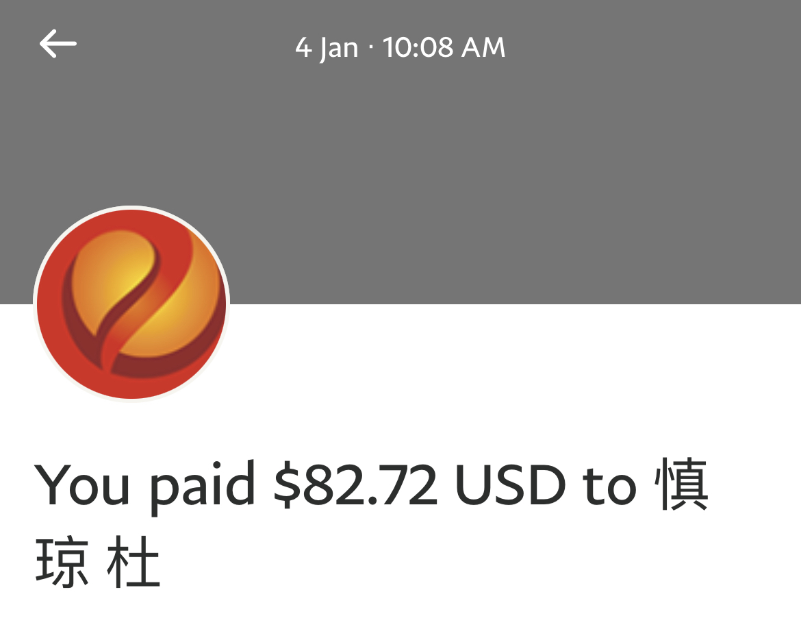

TLDR:
Detailed steps:
