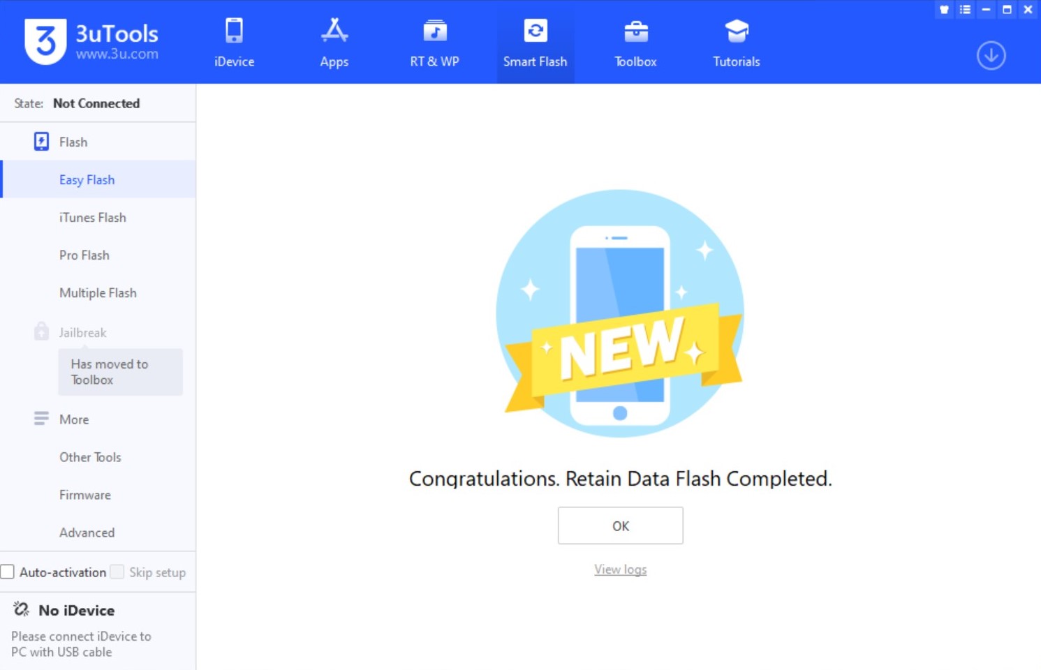

My iPhone 12 started glitching with apps crashing and eventually got stuck in the reboot loop after I maxed out my storage. Thankfully, tried easy flash with the newest update (15.something) with 3uTools after seeing this thread and it worked in less than an hour! I used a lightning cable from IKEA plugged into an external USB port into my laptop. The easy flash failed the first time at 20%, then went all the way to completion on the second try. Happened exactly like described by the other users. Went to the black reboot screen with white apple logo, then told me to swipe up to recover, it attempted tp recover my data for about 20mins, then went through the motions of a normal software update. Nothing was lost, as far as I can tell. Was panicking about losing 22k photos, but they have miraculously been saved. Thanks to everyone in this thread that posted their experience and tips!

For anyone who’s still facing this issue, I personally used 3utools and used 'Easy Flash' with 'Retain user data' option, with ios 16 beta firmware and it worked for me :)
PS: ios 15.x does not work, it gets stuck at 20% (checking Filesystem)

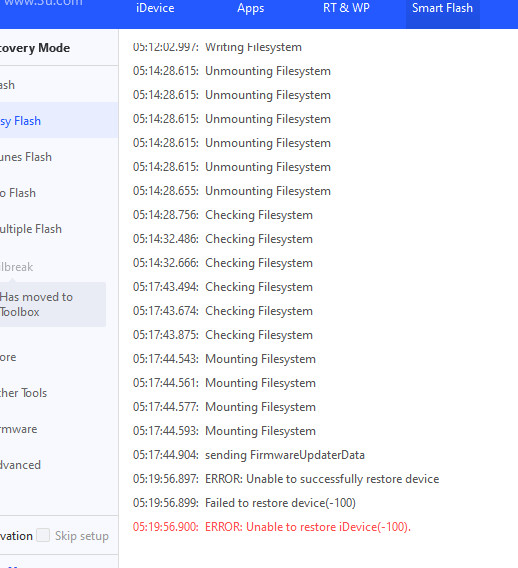

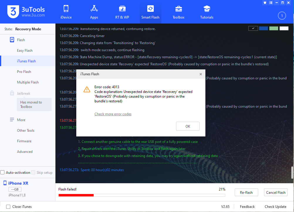

Hello everyone, hoping for some wisdom and guidance on this same topic some years later. My wife's iPhone XR seems to be stuck in restore mode and i can't get past EF 19% and IF 21%. The phone reboots multiple times and then goes back to a restore setting, and the flash fails. EF just shows a failure, but IF shows error code 4013 unexpected device state. Will MFC fix this issue? I have tried multiple ways to get out of restore mode with no luck, including the button combinations and so on.
Any help is most appreciated!

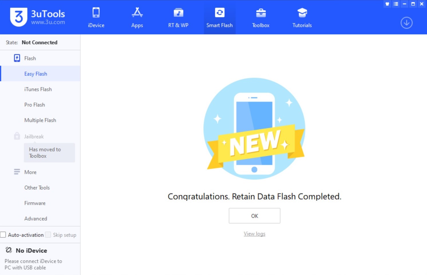

Was on ios14 didnt need to update everything was working fine then i got the new iphone tried the wifi transfer "just stuck on preparing for transfer" then my xs mas 256gb was acting sluggish. I figured a power down would get it going but i was wrong ended up with a 1110 error I was out of memory and the connection with the 15 max caused it to try and update it seems. Stuck on apple logo boot.
EF = 19% 17.0.2 IF = 24%
EF = 21% 17.0.3 IF = 100% Quick flash got through the process the rebooted and the apple logo with progress bar came up on its own. One thing i did notice it that before the flash it was saying my iphone xs max was 2tb but after the flash it said it had the right amount of 256gb. but looks to have updated and removed all my data. Big sad. Should not have tried the wifi transfer should have backed it up on my pc (it was reformatted so no back up there) Quick flash is not the answer it updated my xs max as new. Tried some online data recovery but they just pulled up some shared albums and tried to make it seem like they found some of my photos off the phone. I have photos from my old pc but the last few years is gone and all my messages are gone. I messed up but im not happy with apple on this one at all.
