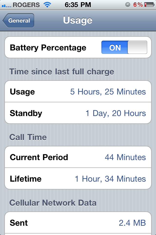

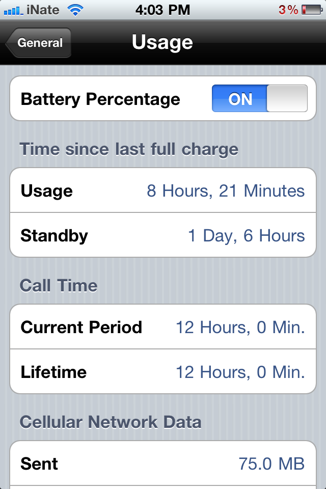

Here's my stats i think my batterys been draining faster after i jailbroke it. I've even been fully draining it and then charging it up every 2-3 weeks.
I might change back down to mobile substrate 3209.Noticed i charged my iphone last night to 100% took it off charge set my alarm had wifi switched on & bluetooth and when i woke up i'd lost 10%. Today ive mainly been texiting a little gaming and a 25 min phone call. I've got BiteSms installed,Sbsettings

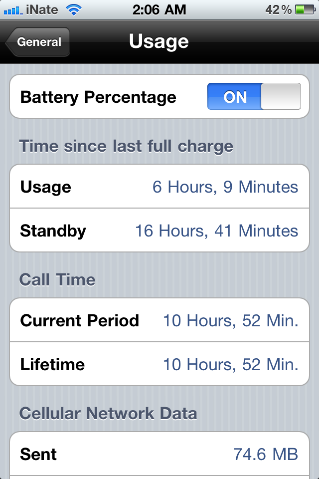

Here it is.. I think its pretty good.

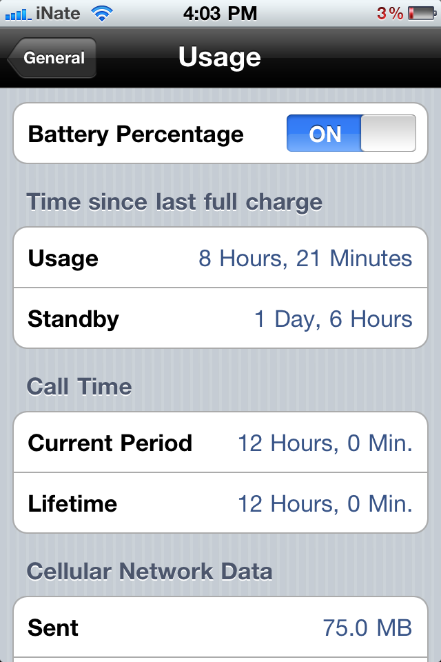

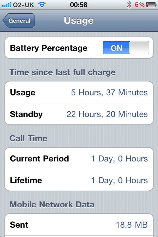

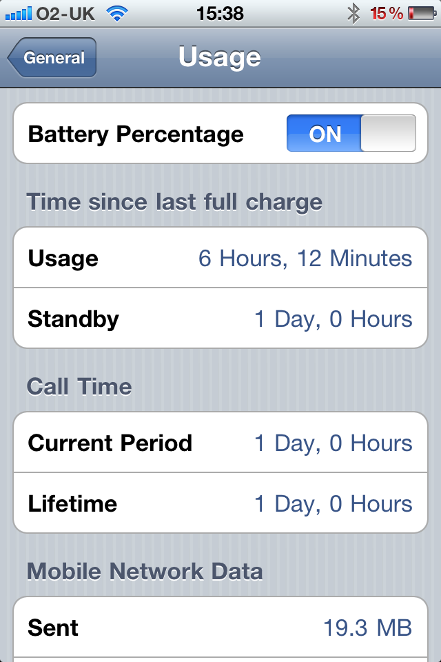

Finally got a full test period in without any resprings (love that Cydia). Here are my results using 3209:
MS 3228 set me around 6hrs20min. to 0% with similar usage patterns.
Related or not, 3209 works great for me (usage/application-wise) and I've got battery life that works for me. Ain't nothin' changing on this phone.

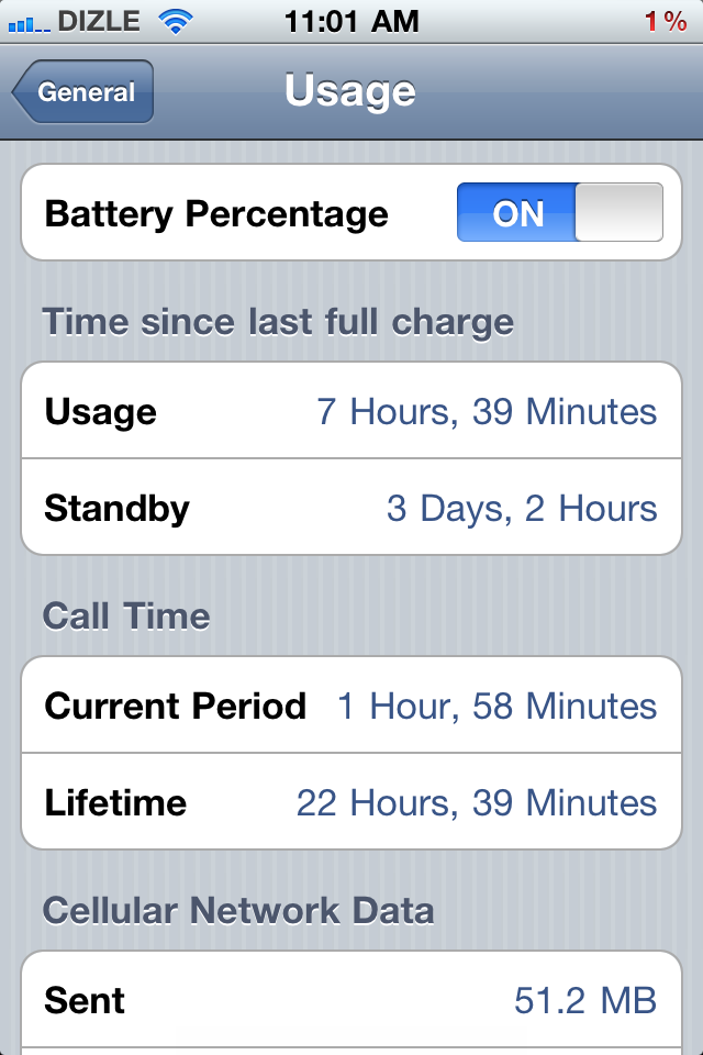

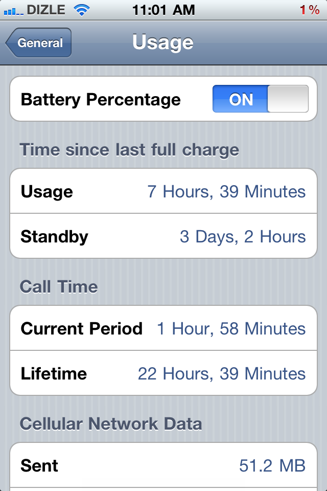

Update to my stats. I wanted to go to 5% but I need to go out so have to charge. Anyway, I think I would have got to almost 4 days standby, which is 4 times more capacity than before, so once again thanks for the heads up.
I can finally go out for a day without being paranoid about my battery running out.
