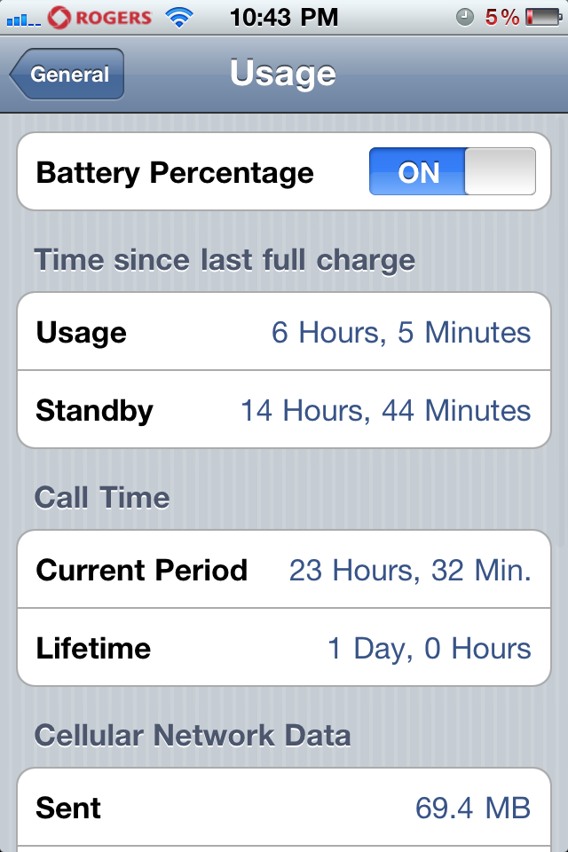

wifi on all day, 3G all day, location off, brightness 40% auto,
this usage was mostly texting and a lot of calls (2h calls and about 10minutes of facetime), PUSH on for 1gmail account
btw im using the newest mobile substrate again as it got updated with the activator update the other day..
