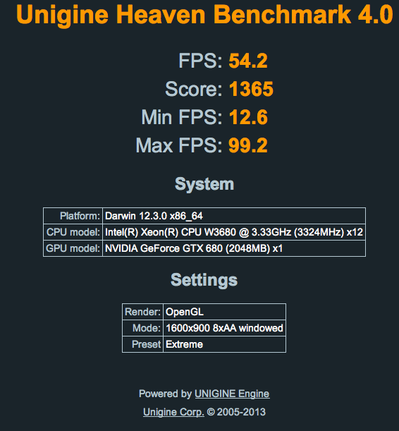

Here is the result of the extreme preset (1600 x 900, windowed, 8 x AA) under 10.8.3:

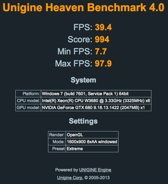

Under Windows 7 64-bit, using the same preset with the OpenGL renderer, I get this:

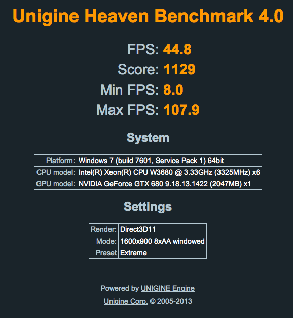

And with the DX11 renderer, here's the result:
I would guess that another reason for the drop in performance is that Windows 7 runs flashed cards at PCIe 1.1 speeds but it's apparent from the frame rates that the Windows version of the benchmark is giving the graphics card a much tougher job to do. If this is the case, then differences between the hardware that is feeding data to the cards should make less difference than the benchmarks under OS X.

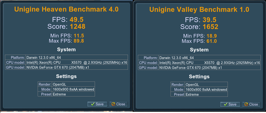

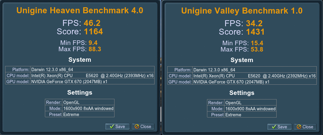

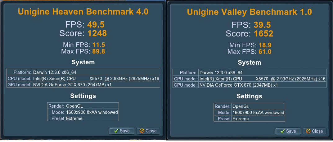

I just upgraded the CPUs in my Mac Pro 5,1 from 2.40GHz to 2.93GHz. Below are before and after benchmarks. Everything else in the system was unchanged.
