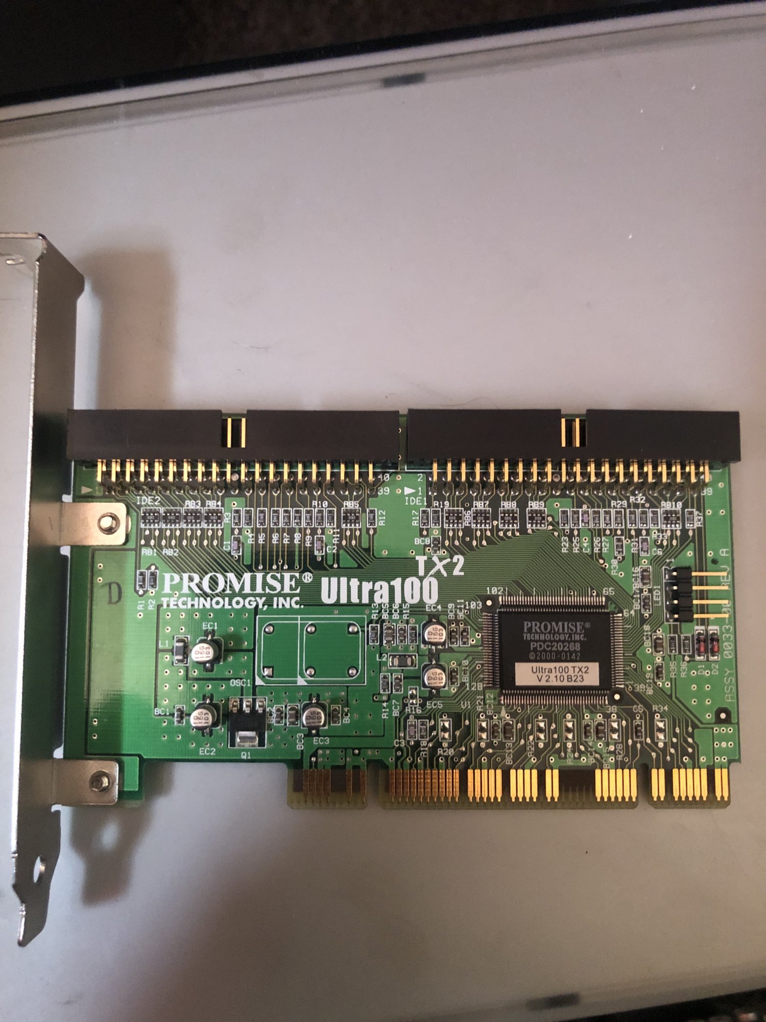

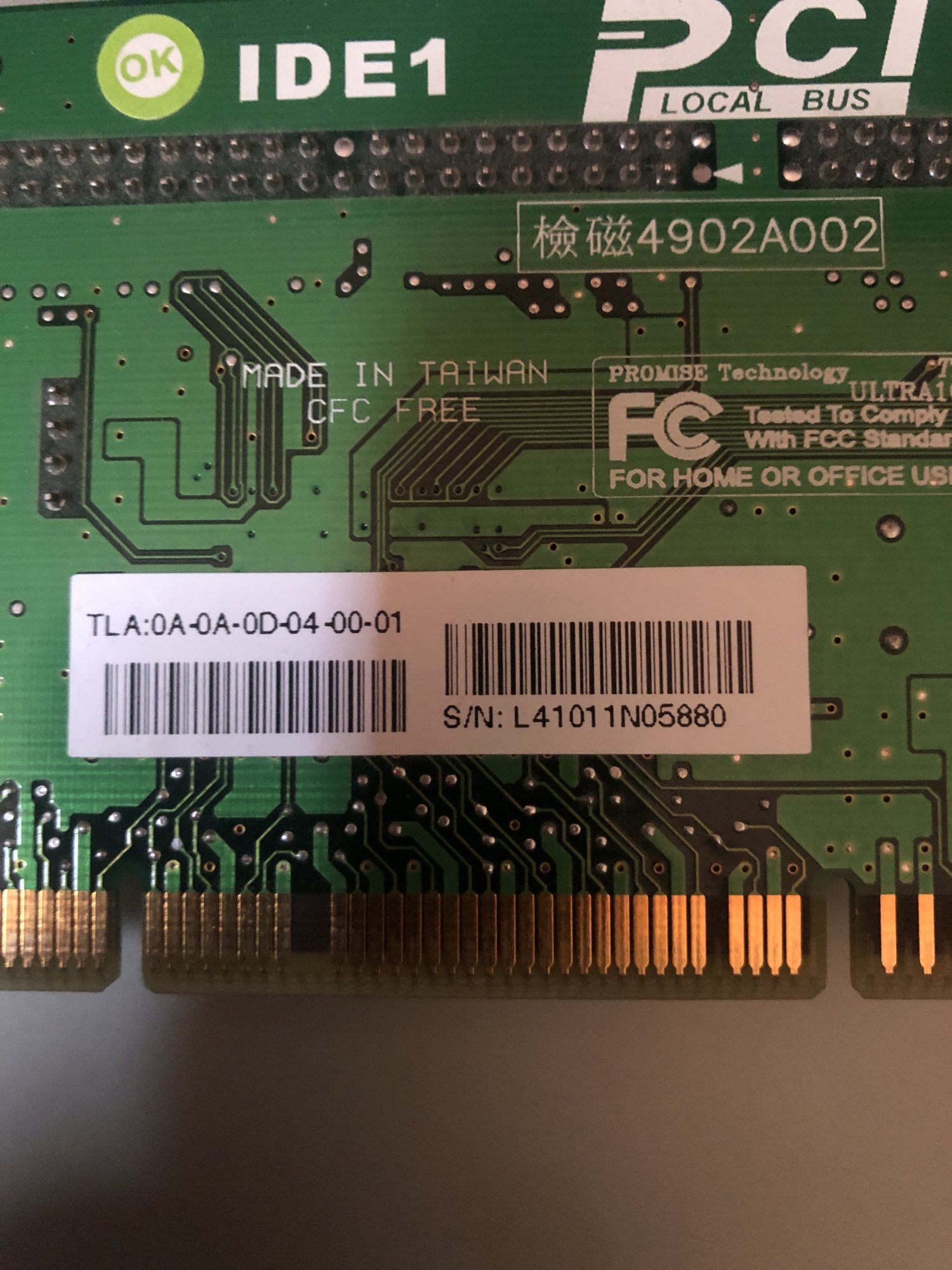

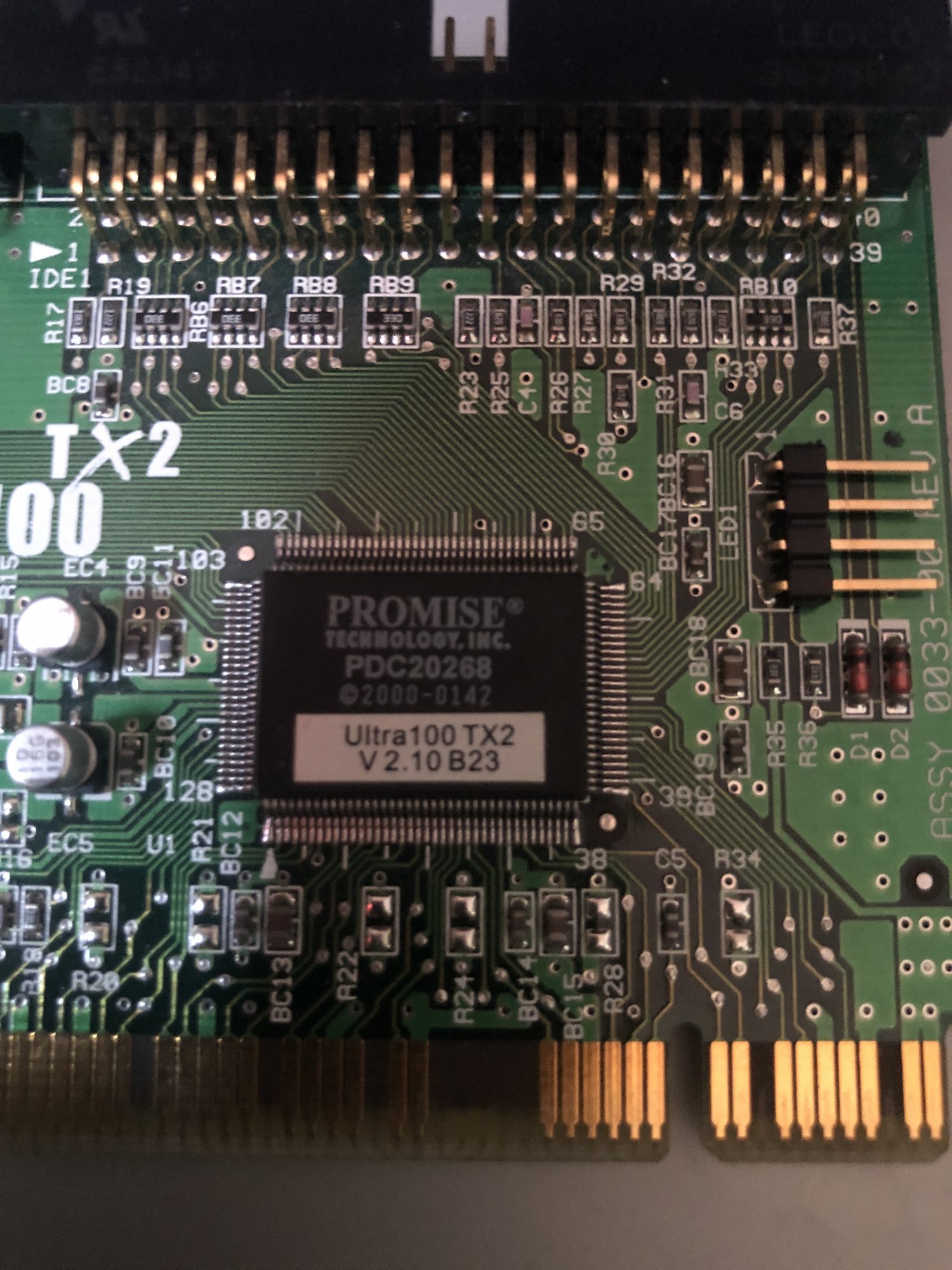

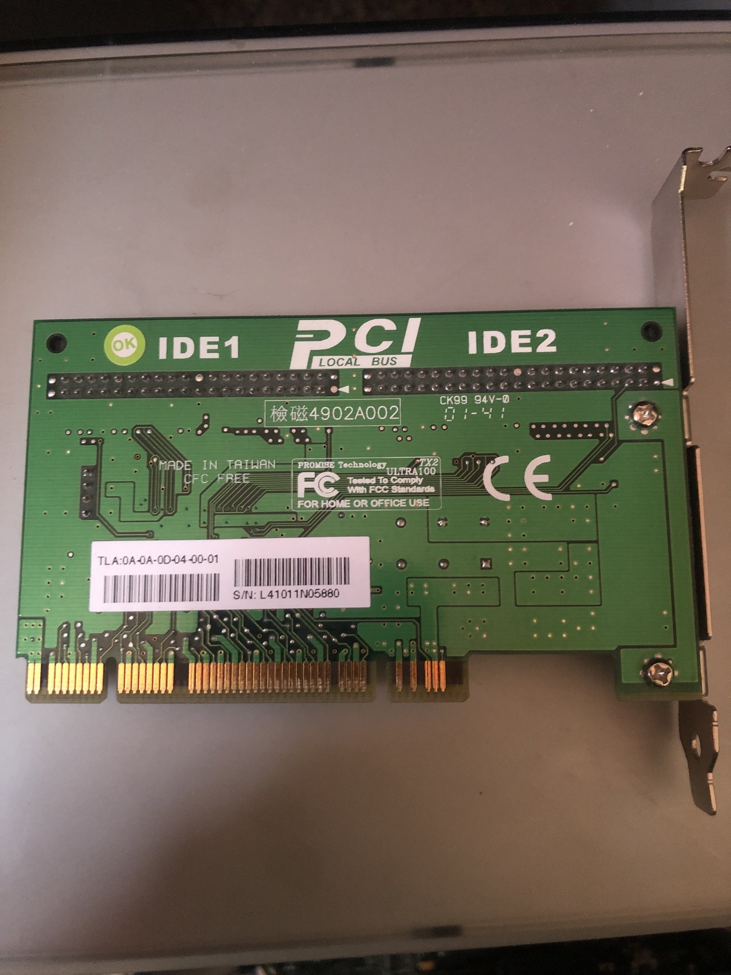

No, as i stated in earlier posts, its a ultra100 tx2

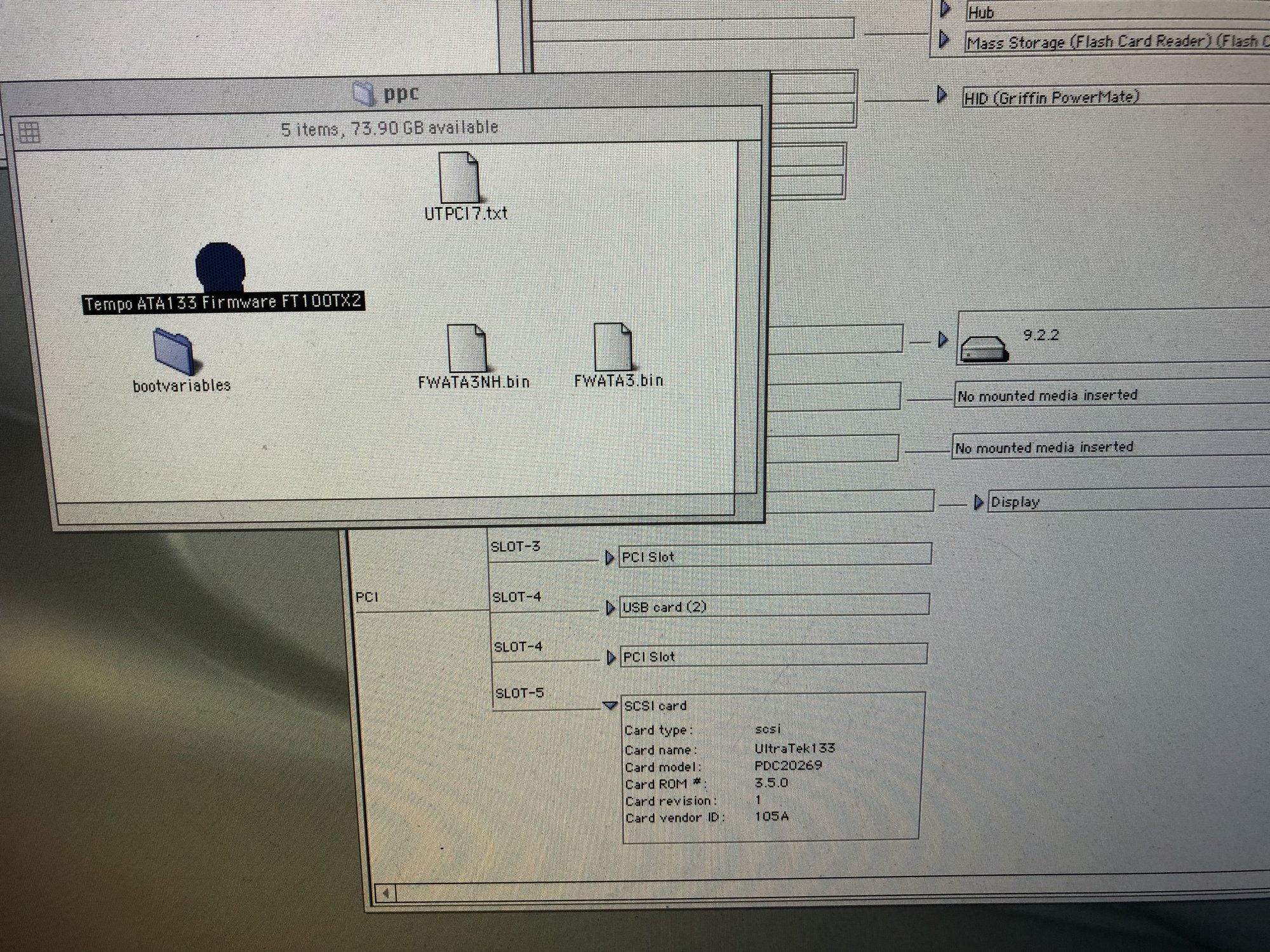

Ok, I misread what you said first and just assumed you had the Fasttrac 100 TX2 raid card like I do, but in that case the first flasher should have worked for you. I'm not sure what is going wrong, but let me try one more time to hack a fresh copy of the flasher and upload it.
hold......
Ok, last try here, if this one doesn't work I'm not sure what's going wrong.
Same instructions as before, boot OF run the UTPCI6.txt and boot OS 9, then run this flasher. It may( likely ) crash after it writes the firmware, but it should still work.
  • try3.zip

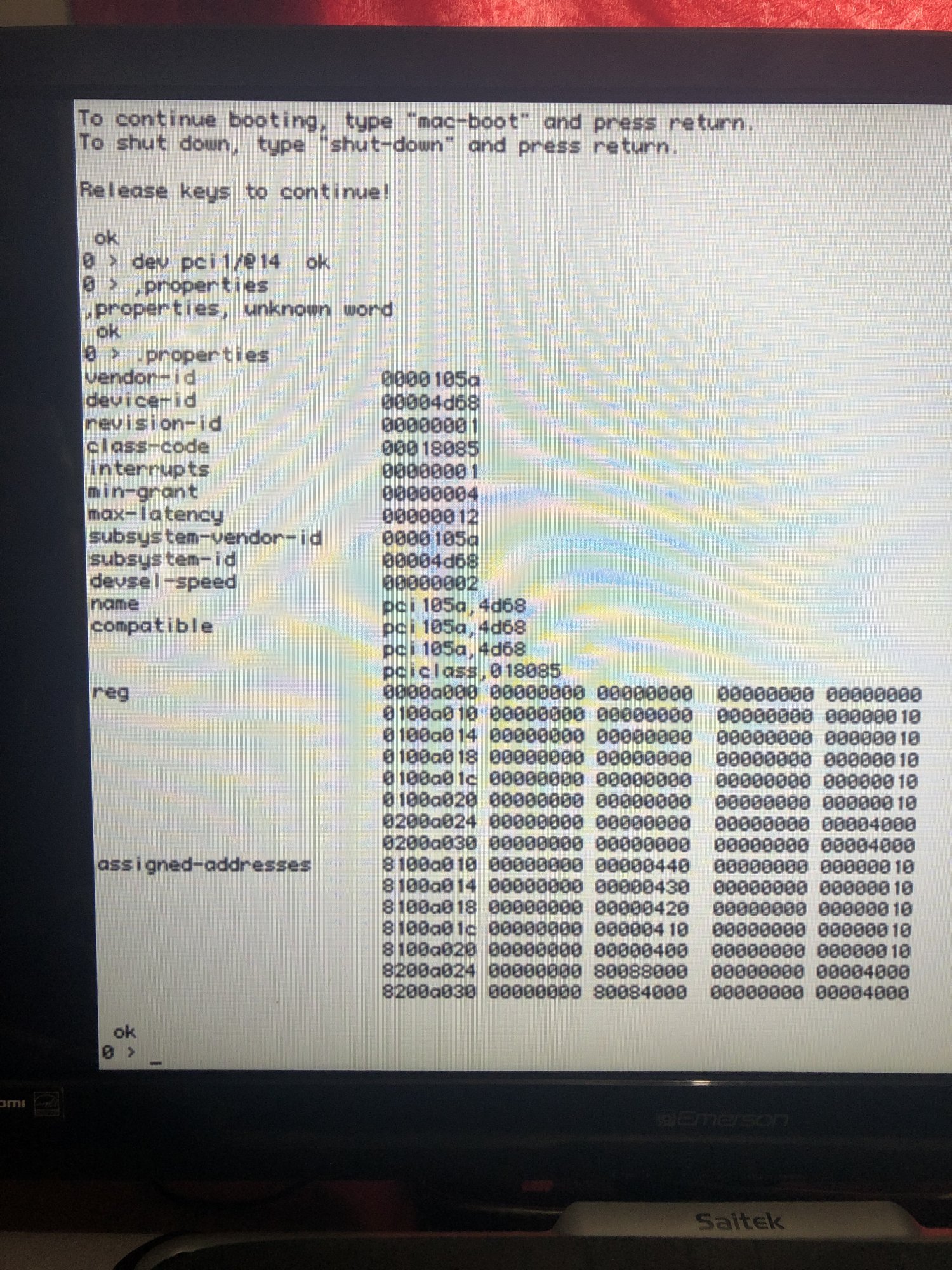

Those shots i sent previously are before i use the txt file, so when it says the 4d68 thats before the utpci file loads

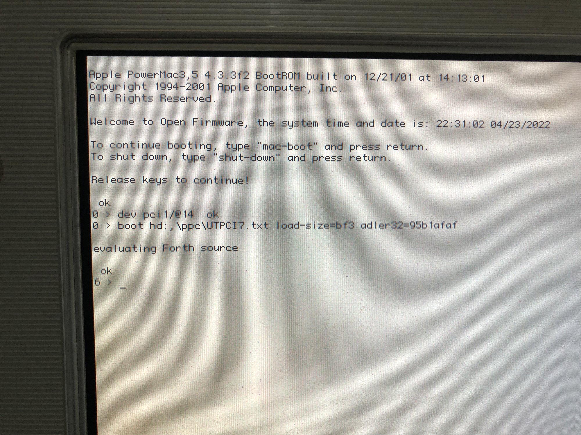

long time no hear from me, i tried opening that file you sent, i keep getting that it can't open the UTPCI7.txt in OF. i tried downloading and opening in 10.5.8 and it doesn't work on the 9 drive, i even used os9 to download the file in clasilla and opened in maczip. then copied that file to the ppc folder, and it still says it can't open it. what am i doing wrong?
this is what i am typing...
Release keys to continue!
ok
0 > dev pci1/@14 ok
0 > boot hd:,\ppc\UTPCI7.txt can't OPEN: hd:,\ppc\UTPCI7.txt
ok

Some reason OF can't read the default partition. You can specify the partition number:
Code:
dir hd:9,\
for partition 9 and so on.

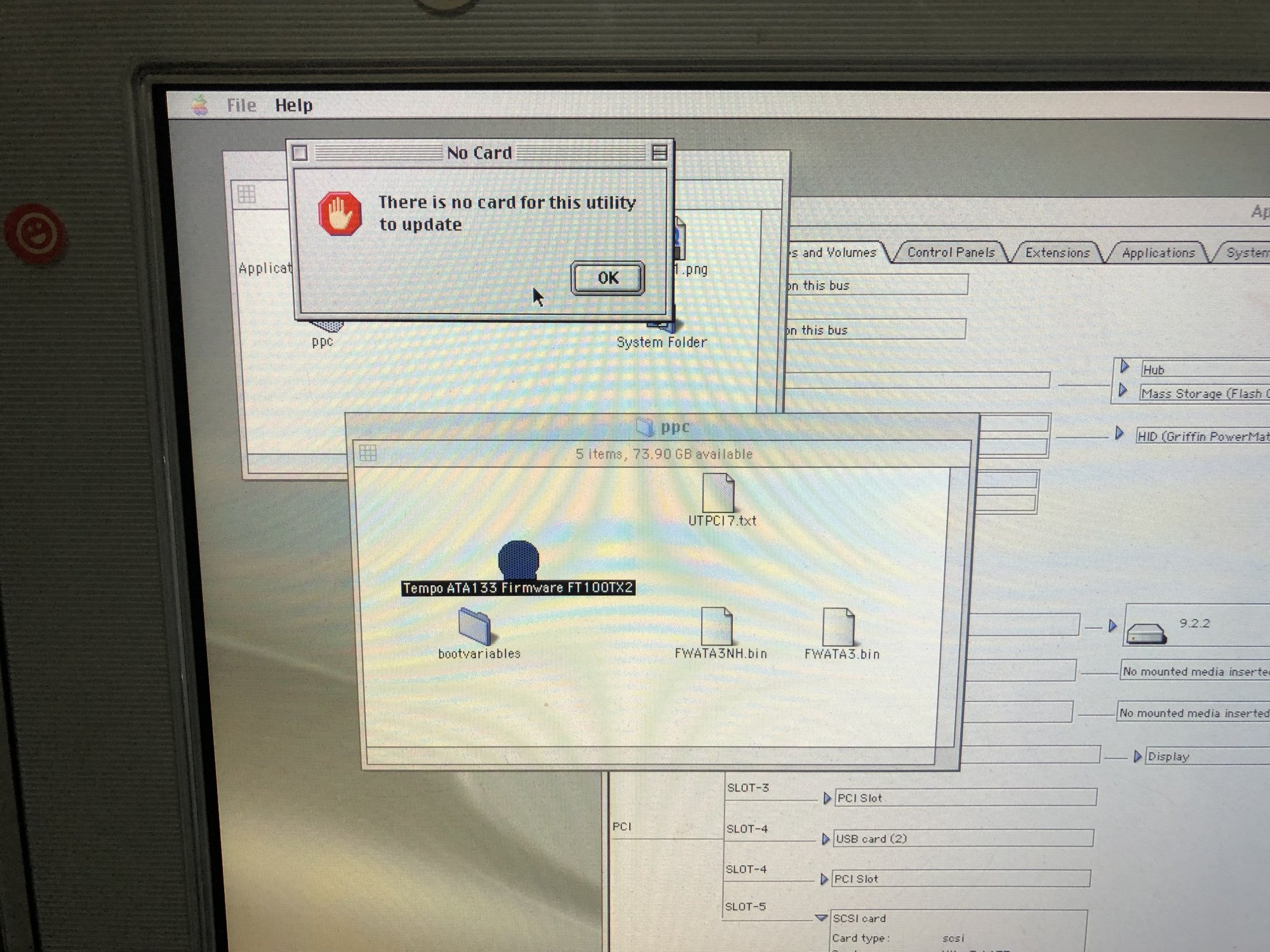

ok, set hd to master, it loaded the UTPCI7 file, booted into OS9, and when i try to flash the card, see attached pics
