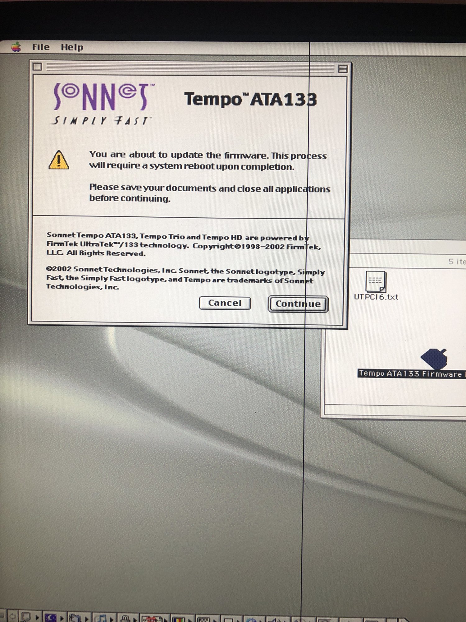

Run the Tempo ATA133 Firmware FT100TX2.app to flash your card.

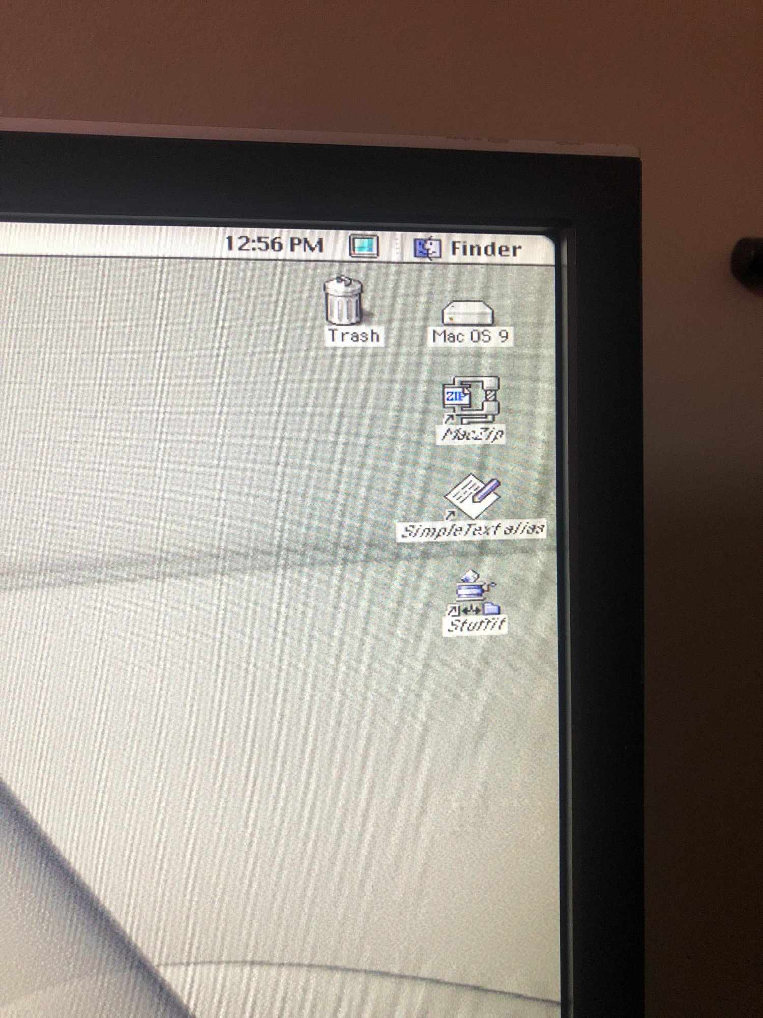

maczip is giving me a type 1 error all the time, and if i use stuffit, the FT100TX2 is a document, not an app.

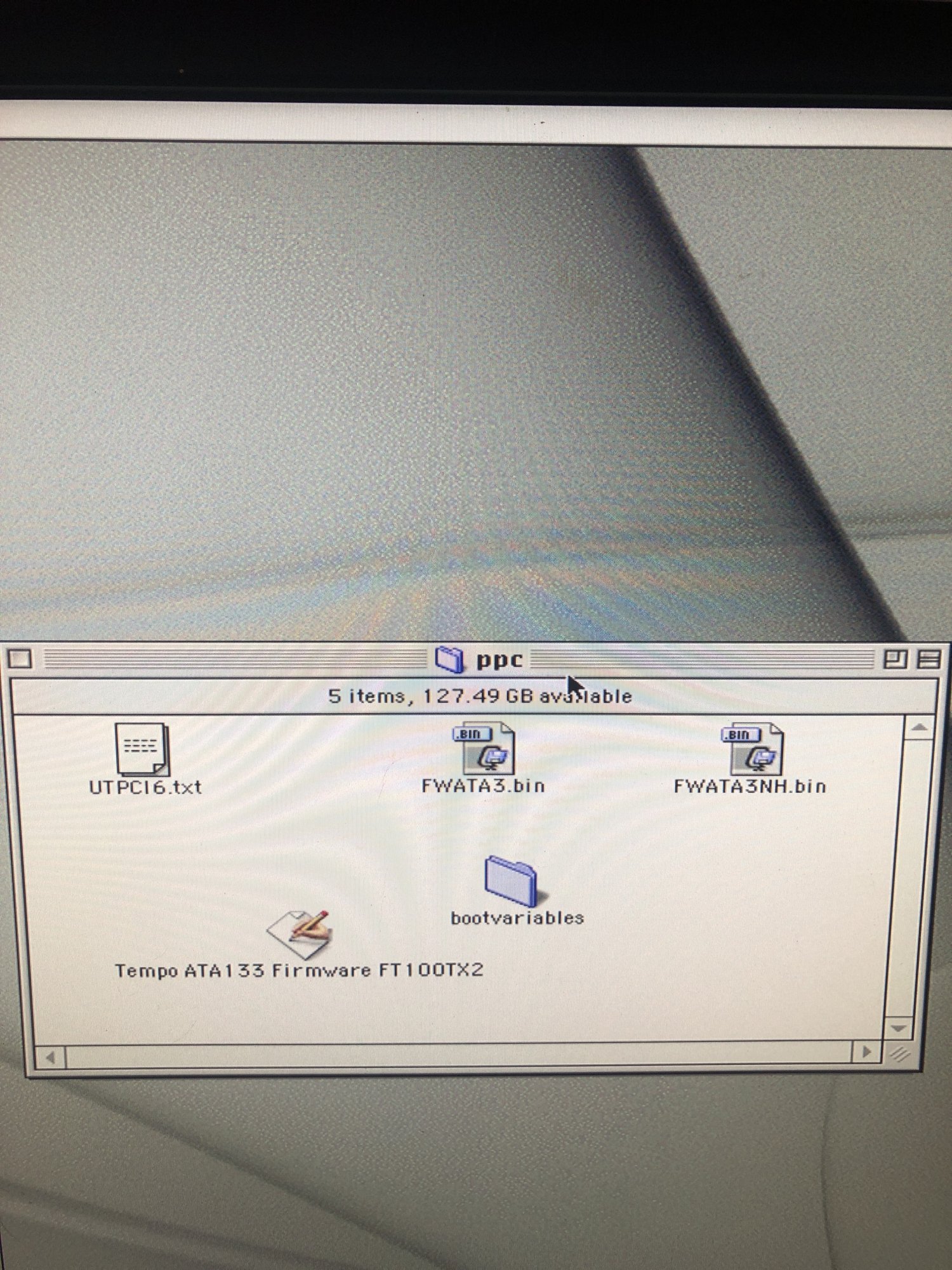

ok, so got around the document/app, unzip in leopard, then copy to flash drive. now it sees the app, but the UTPCI6.txt still can't be opened

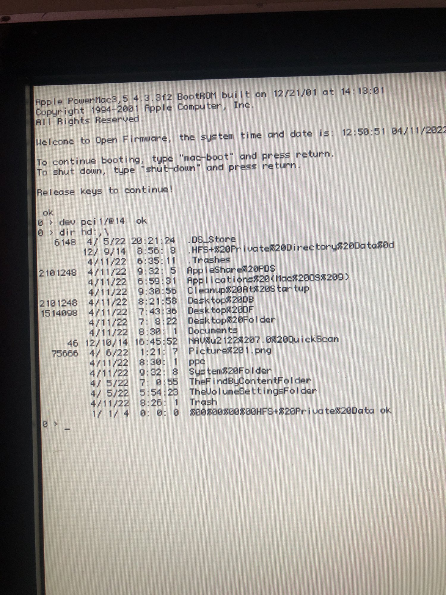

dir hd:,\
That should return a directory of the first HFS/+ partition of you hard drive. Likely you have your "ppc" folder on a partition other than the first partition Open Firmware is finding.
You can append the command to specify the partition or just copy the ppc folder to the correct partition.
dir hd:9,\ for a directory of portion #9 and so on. Common partitions are #4 #6 #9 and so on depending on the tool you used to partition the drive and how many partitions are on the drive.

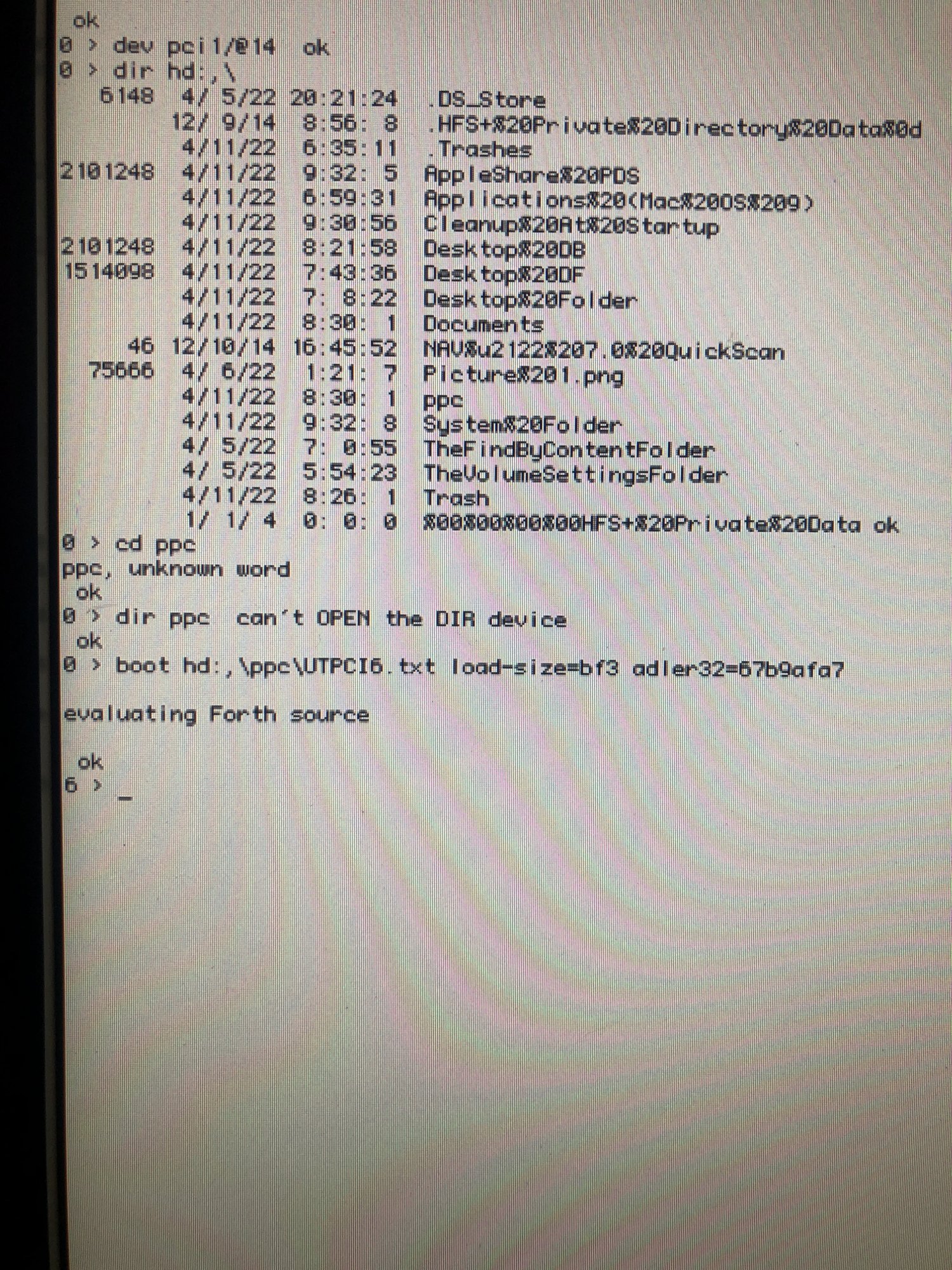

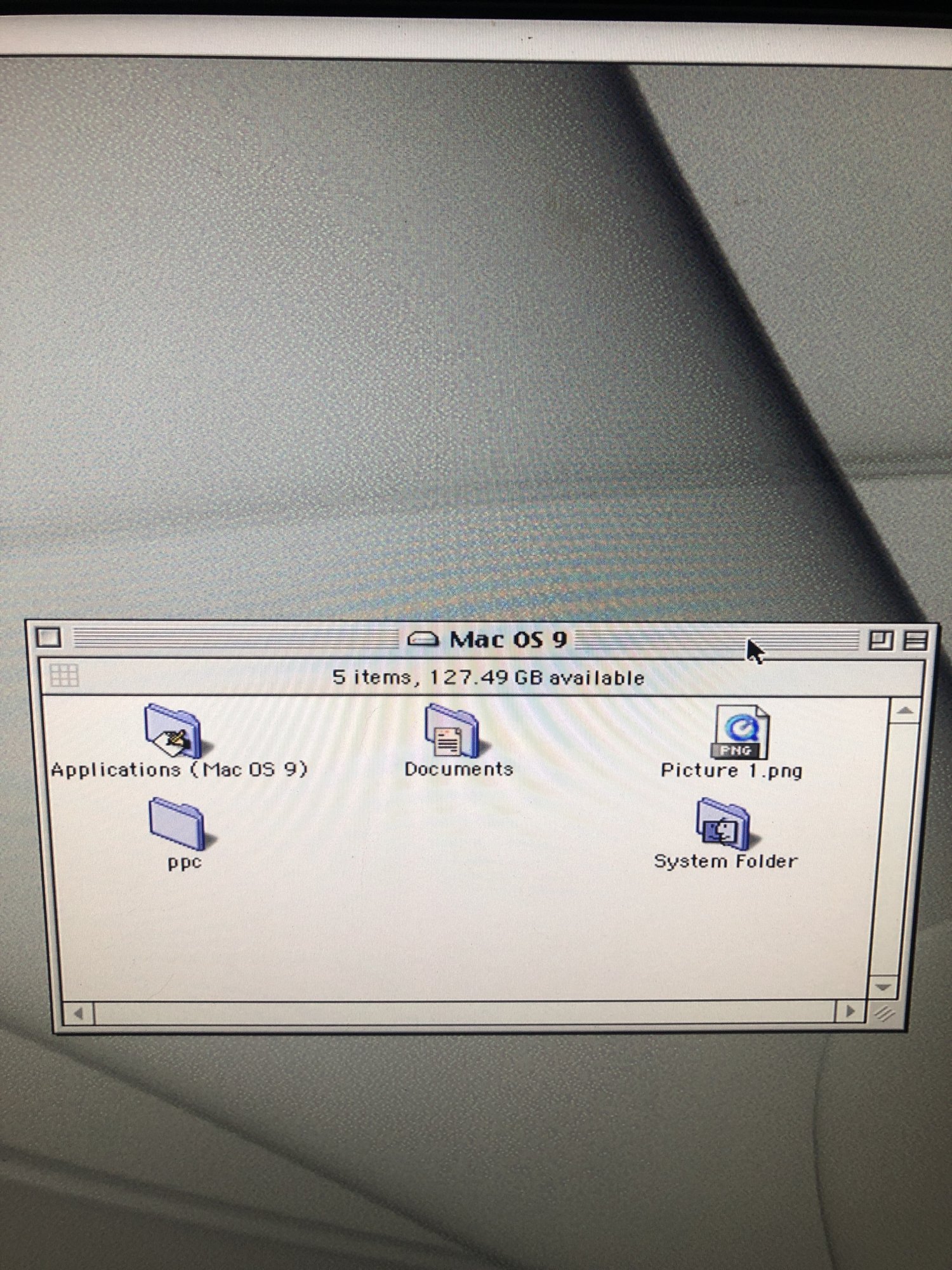

Ok, the drive is the only one in there with no partitions. Its strictly os 9. And the ppc folder is on the root of the drive, cant get more root that the surface
The are partition, the partition table for OS 9 Drivers. Likely your partition # is 9, but with only one HFS/+ partition Open Firmware should be finding it by default.
Append the dir command to point to the ppc folder so you can be sure it "sees" the file UTPIC6.txt and the other files in the PPC folder.
Code:
dir hd:,\ppc
You are doing this on a QuickSilver, no?

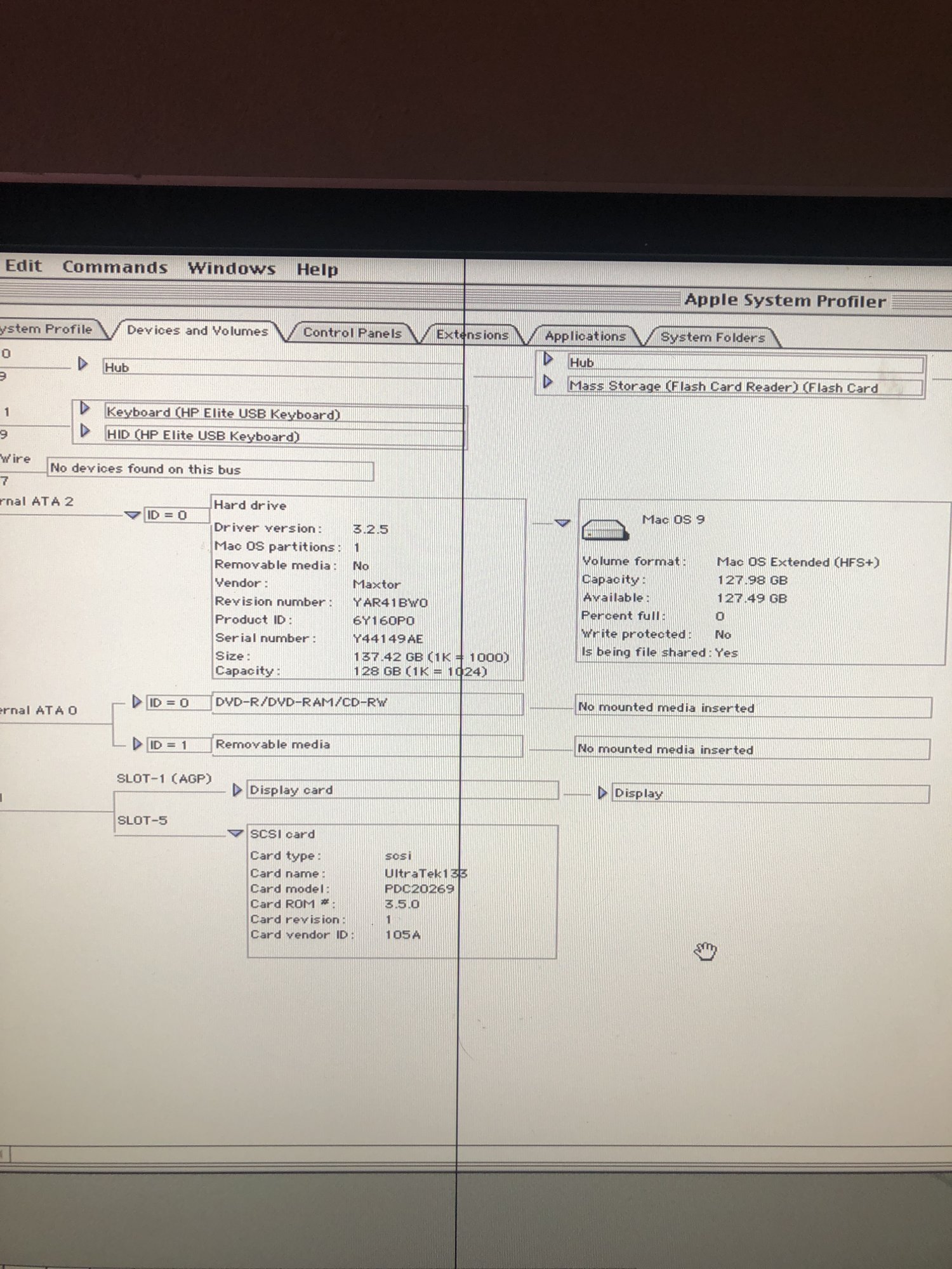

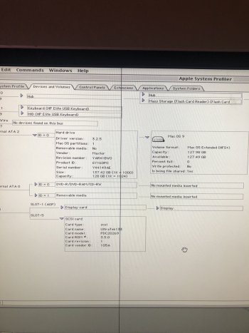

This is the root and the card and hd properties

Flasher info

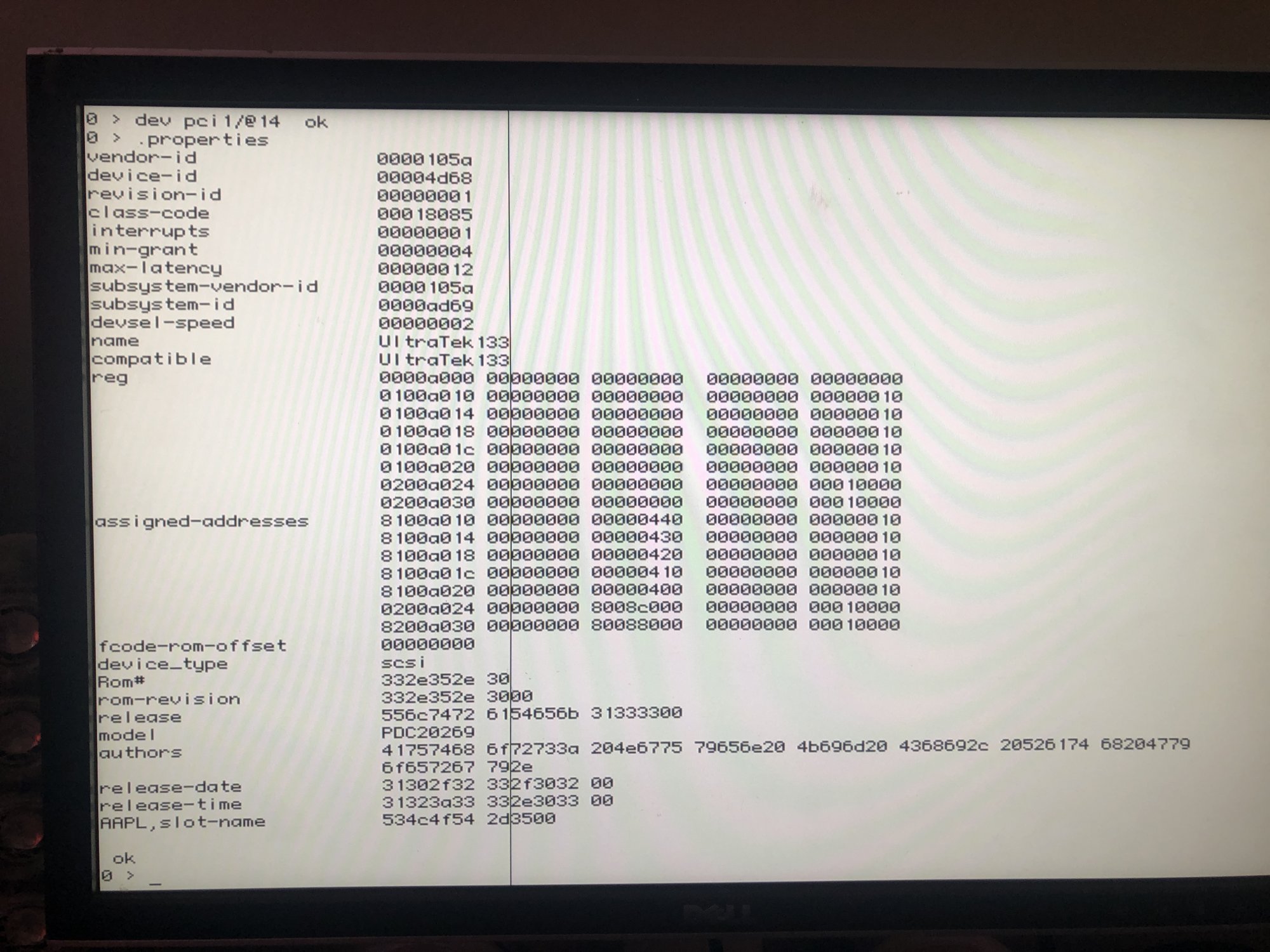

My bad, I sent you the wrong patched flasher. The patch is pretty simple, we only open the DATA Fork of the flasher in Super Resedit and change the hex string for the proper device ID of the TX2.
I forget the proper Device ID of the TX2, so boot into Open Firmware and do:
Code:
dev pci1/@14
.properties
Looking for the device ID.
Code:
dev pci1/@14
.properties
device-id 00004d68
device-id 00004d68

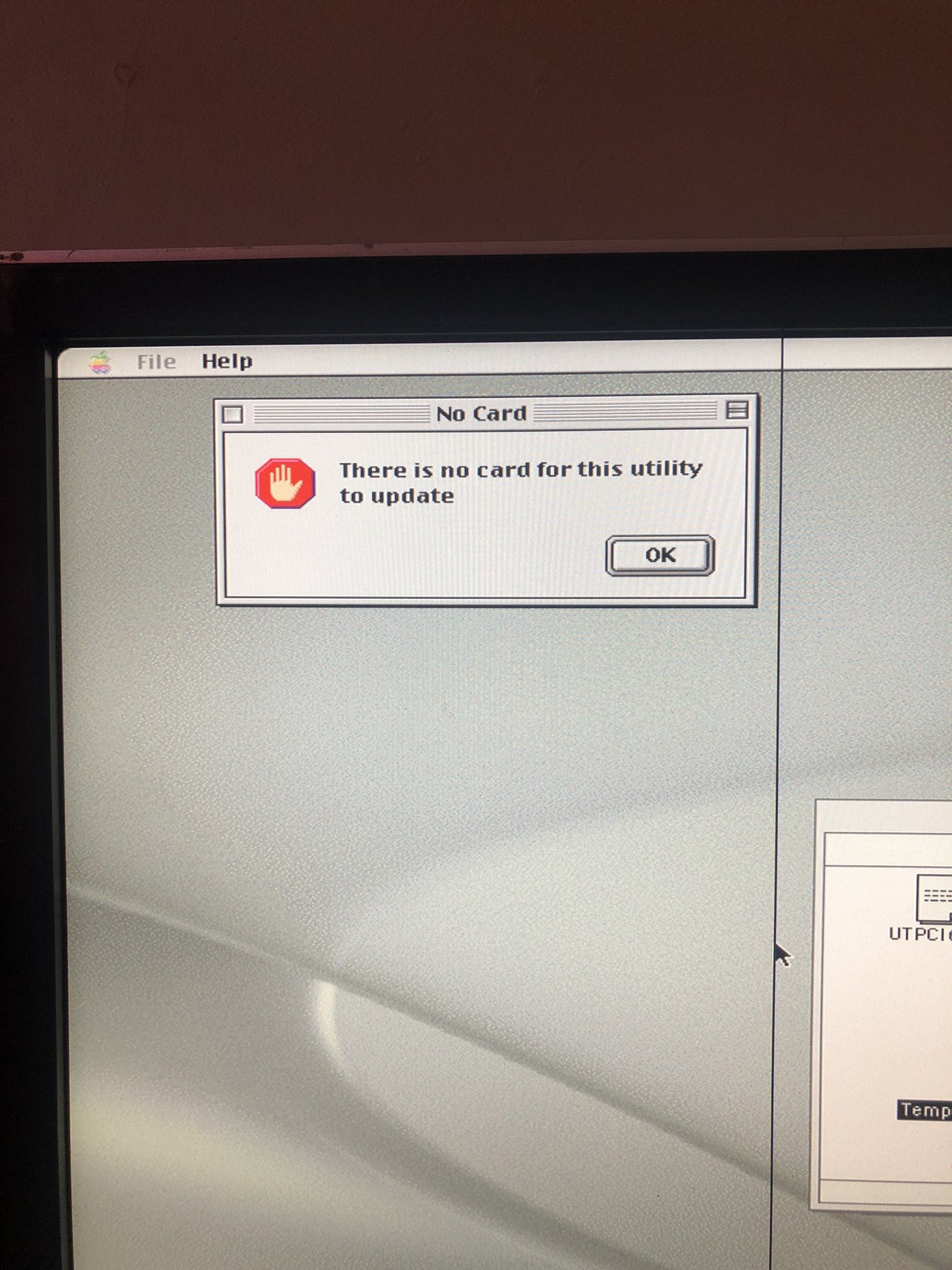

Sorry I was not clear, you need to run the .properties command before you run the UTPCI6.txt. Anyway pretty sure the device ID is 6268, just make sure.
Here try this flasher:
Same instructions as before only use this flasher rather than the first one I attached.
  • try 2.zip
