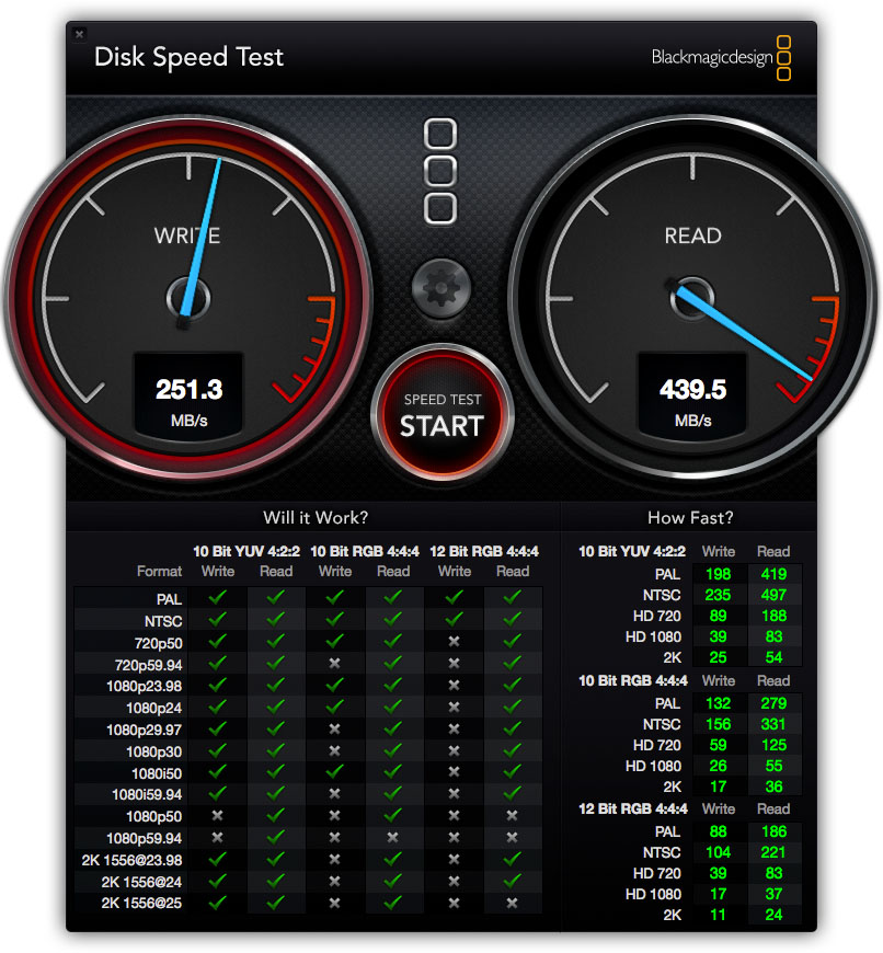

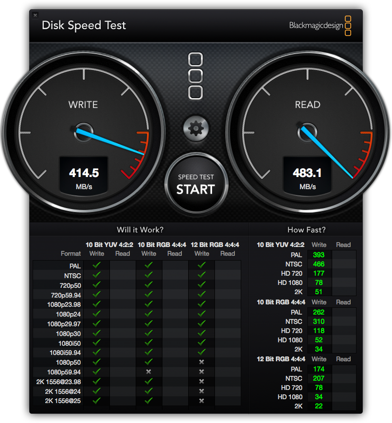

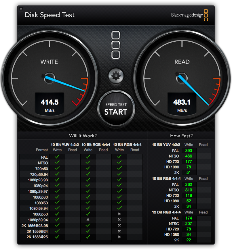

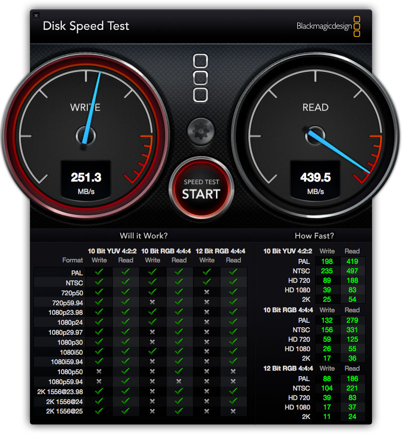

Here are some DiskTest results I am seeing with the Sonnet Tempo Pro. It does work great, other than the boot menu issue I am having with a 2012 Mac Pro: 🙂
Left is with a pair of Crucial M4 512GB SSD in RAID-0
Right is a single Samsung 840 Pro 512GB SSD
-howard

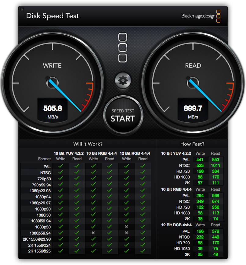

Pretty impressive Read speeds. I have the Accelsior PCIe card installed in my MP3,1, and though I am happy with the Write speeds, I wonder why the Read speeds are "low"???
Scott, thanks for all of this great info! Unfortunately, I read it a all bit too late. I just ordered a 960gb accelsior and a 480gb accelsior from OWC. They will likely be in here in the next day or two. Did you have to pay the 15% restocking fee to OWC?
Also, do you think that the Accelsior may have been slower than the Sonnet Tempo config because it was busy running your OS as well as a disk test?
I have the Accelsior and it is screaming wicked fast, sure these bench marks may show that this setup is a bit faster, but I seriously doubt that you would notice any real world difference. It's really just benchmark bragging rights once you get up into these speeds. If you have money to burn you can return them, but I think it's a waste of money. I honestly doubt you could tell the difference in day to day use.
