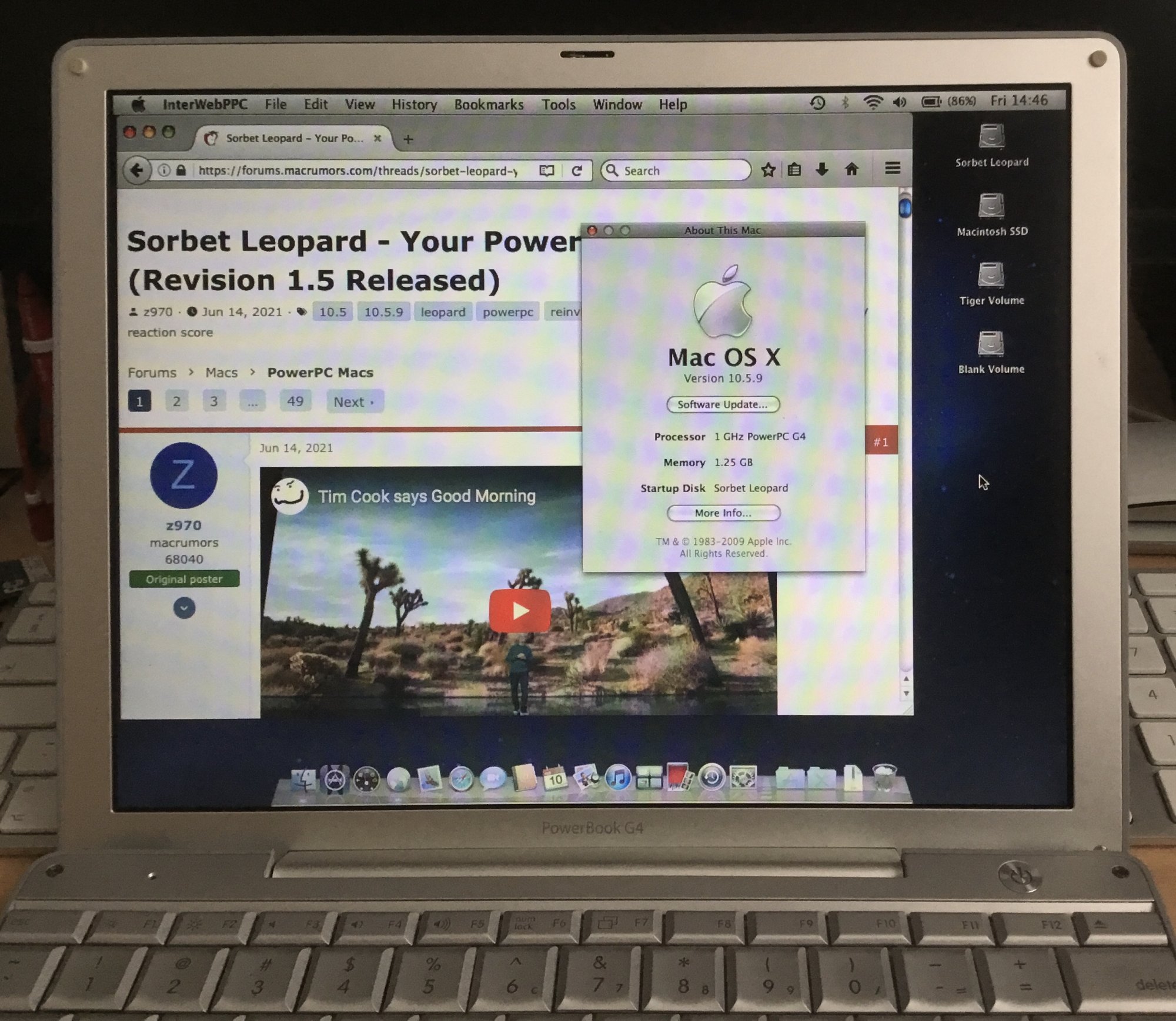

Got it installed without a hitch, thanks @Amethyst1.
I did a restore from Disk Utility, which worked fine.
InterWebPPC seems much faster than in Leopard....:p
