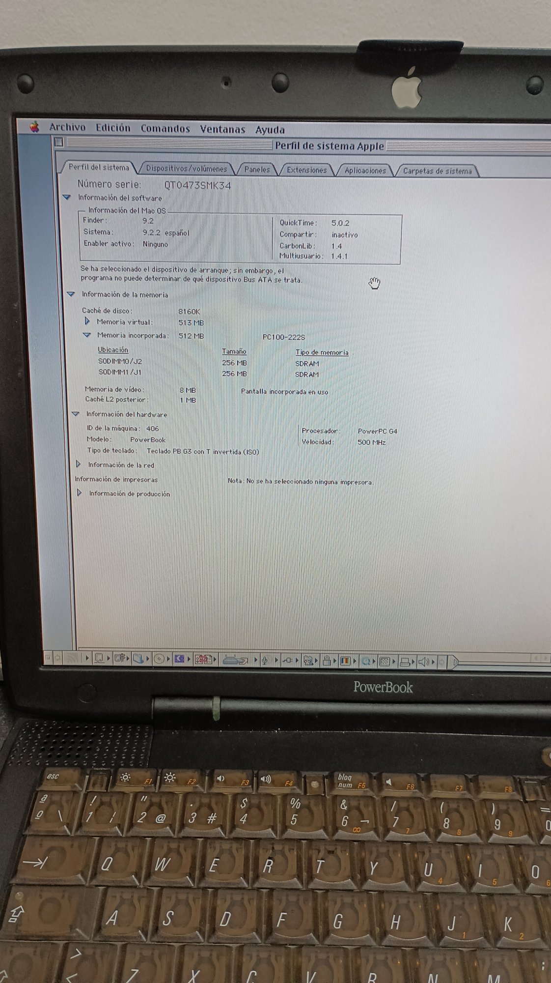

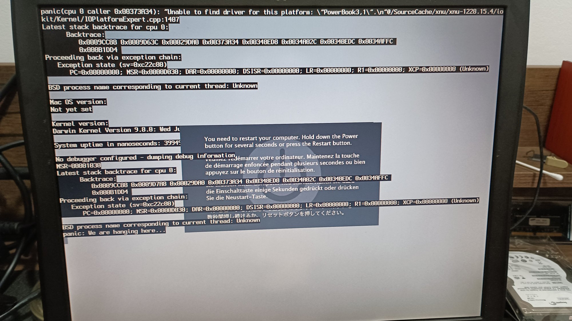

Hello, I recently upgraded my PowerBook Pismo to G4 500mhz, and with 512MB of RAM. I have installed Sorbet Leopard but it gives this error at boot.
Is there a solution or is it incompatible?

I think max OS officially for Pismos is Tiger ie. 10.4.x, the Sorbet is a Leopard-variation ie. 10.5. There are some rumors that Pismo could run Leopard but it needs some third party software (and the G4 update you have) to do it. I have no knowledge of what software is needed. But out of the box it might not work like you are finding out. You could find a solution though so keep on looking.
You could try Shuriken if you want readily tuned Tiger.

There is a firmware update for the Pismo that should solve it. I don’t remember what it is off hand but if you search you should be able to find it. I had the same issue. The update fixed it.
Also, you can add 1gb of ram to the Pismo despite Apple’s official specs.

Thanks!! I did a quick search for "Pismo firmware Sorbet Leopard" on Google and I didn't find anything. Where can I find that firmware? Does anyone have it available?
I'm going to download the Ati RAge drivers, thanks a lot for the detail.

Sorry, I explained myself badly in the "edit". I downloaded the firmware that I linked, installed it and now Sorbet Leopard works, it has installed the "f5".
Thanks for your help.
