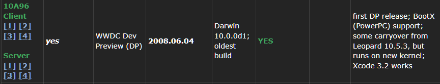

Not to interject, but I’m curious if you’ve seen any of these issues with the 10.6.8 A5 image present on the first 10A096 build, as 10A190 was overall more broken than either and likely isn't worth pursuing.
Of course I am mostly speaking as an observer (and from memory as it’s been 6+ years since the project began), but in practice since there is only so much manpower and volunteered time available that can be dumped into this, perhaps it would be a wiser choice to build from the platform with less inherent issues provided that it still offers the same basic advantages as A5, for example in software ports.
Regarding a GPU compatibility chart, one (and several others) was assembled in the original thread in “table 3”. A basic machine compatibility chart was likewise provided in “table 2”. I can't imagine how much more useful information must have been discovered over the years across all 114 pages but never added to the WikiPost due to lack of space.
Trying to take a closer look at this today. This build here is not the original 10A96 build, unfortunately. It has timestamps in 2021, .Trashes etc which indicate this has been modified.
This would ideally be the client you'd want to start patching things into - but we need a clean mirror first.
Not to interject, but I’m curious if you’ve seen any of these issues on the previous 10A096 build rather than the 10A190 build the A5 image was based on.
A5 is not based on 10a190. It is based on 10.6.8 release with some proprietary components taken from 10.5.8 (Finder, OpenGL, something in CoreGraphics, perhaps AirPort module, some GPU drivers).
A different image which was labelled as “Nvidia” here has OpenGL from 10a190.
I do not remember if anything at all was taken from 10a190 into A5. Perhaps something was, but it not even remotely “based on” 10a190.
There are a few things which work better in 10a190 than in A5: DHCP, previews in Finder, GL stack (at least it is newer). In general, however, A5 is substantially better.
From what I recall, B S Magnet reported that the stability difference between the two was substantial.
Of course I am mostly speaking as an observer (and from memory as it’s been 6+ years since the project began), but in practice since there is only so much manpower and volunteered time available that can be dumped into this, perhaps it would be a wiser choice to build from the platform with less inherent issues provided that it still offers the same basic advantages as 10A190, for example in software ports.
I don’t think 10a96 has any utility at all. 10a190 as such has little relevance either, only GL and some Xcode components can be useful, I guess.
Why on earth use 10a96? It was basically useless from the get-go and completely obsolete by now. It makes little to no sense to start from 10a190 either, since core components of the system are way below what 10.6.8 has (kernel to begin with, libSystem etc.).
Because going the route of starting with 10.6.8 and patching PPC binaries back into it clearly has its own set of problems. This is what the A5 build does.
By starting with 10a96 you’re starting with the most compatible PPC surface. I’m still just gathering information and collecting differences between versions.
