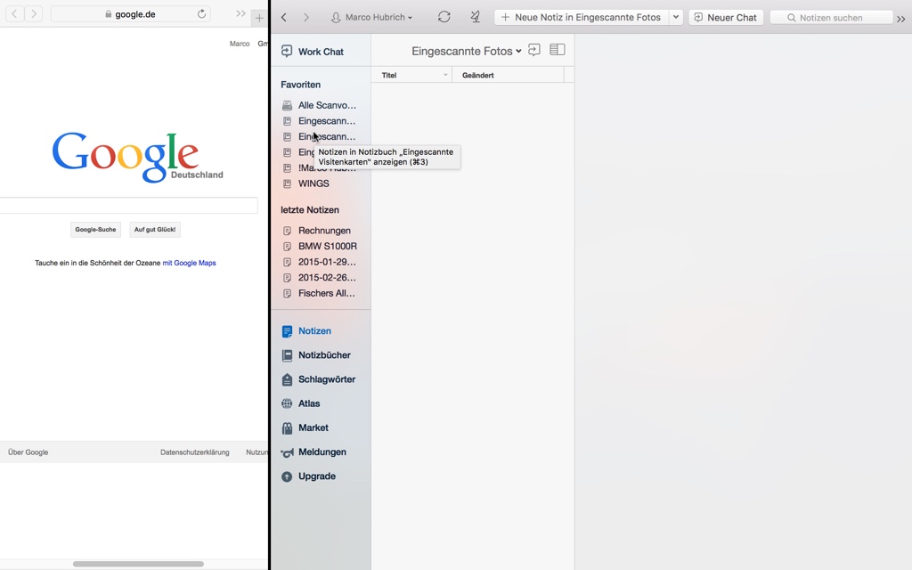

What is that? Photos? Some apps won't work in split screen. I think that is one of them. Try dropping messages or mail into split screen w/ Safari just to make sure it works for you.
This was Safari and Notes. Tried same thing with Messages and Safari - no luck for any configuration.

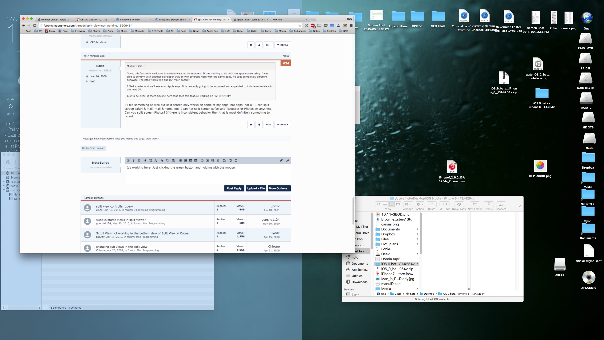

It's working here. Just clicking the green button and holding with the mouse.
@happyslayer Can you screen what your System Preferences > Trackpad settings are (in each of the three tabs)? Also, was this an upgrade install on your 12" rMB or a fresh install?
