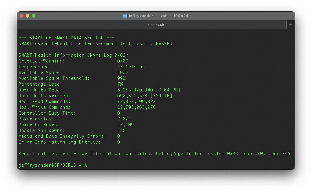

Here's the results from an M1 MBP (2TB/16GB) purchased New in November 2020-
I use this thing a LOT. I use it for work (Mostly Citrix and Web Stuff) and also to record our band in Logic Pro. I used iMazing for a few years with it (passes all that read/write data on thru to an External Drive). I've even wiped this MBP a few times and reinstalled macOS. I've got an Asahi Fedora linux partition setup.. I'd put Windows on here right away if it was possible lol
This thing is great.

I think "TB" in "Data Units Written" means terabits and not terabytes.
This (dividing by 8) leads to a more realistic usage profile and also to a comparable durability between Apple SSDs (maximum TBW) and other SSD manufacturers (maximum TBW according to their data sheets).

Does the problem with increased SSD wear actually exist with M3-based devices too?
It will technically exist on any SSD device, regardless of the CPU. If you do enough read/write on them, then they will eventually wear out. But that may take 50, 100, 300 years depending on your use. I know of only one case of this happening and it was the use of a base M1 mini running a Postgres server for a bank. They could have avoided the problem using an external boot drive and getting 16 GB of RAM.
Yes it is "bits" but how wide is the interface in the chips? And In any case worrying about thois is silly because no one is going to keep their Mac for even 20 years, let alone 60 or 80 years.
IN any case, Any competent electronics tecj can replace the chip. Yes, I kmnow Apple dfoes not hire such people and can't do the repair but there is many skilled techs who can do this. The problem will be that by the time you need the repair the needed chips wil be antiques and the technitians will have retired.

smartctl nvme "Data Units Written" is in units of 512kB, and total read/written is in units of metric TeraBYTES (not bits), i.e., powers of 10. The capacity is also reported in the same units.

There is no "problem" with SSD wear in any Apple Silicon chip family. Period.
Unless you are going to use your Mac daily for about 50+ years and no other component dies first.
Well it would certainly be possible to drive the SSD to death if that was your goal. It wouldn’t even take very long (maybe 6 months to a year). But you are correct for any normal workload. Even a workload with high number of disk writes.
