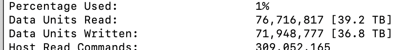

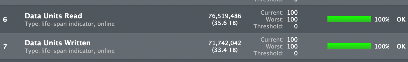

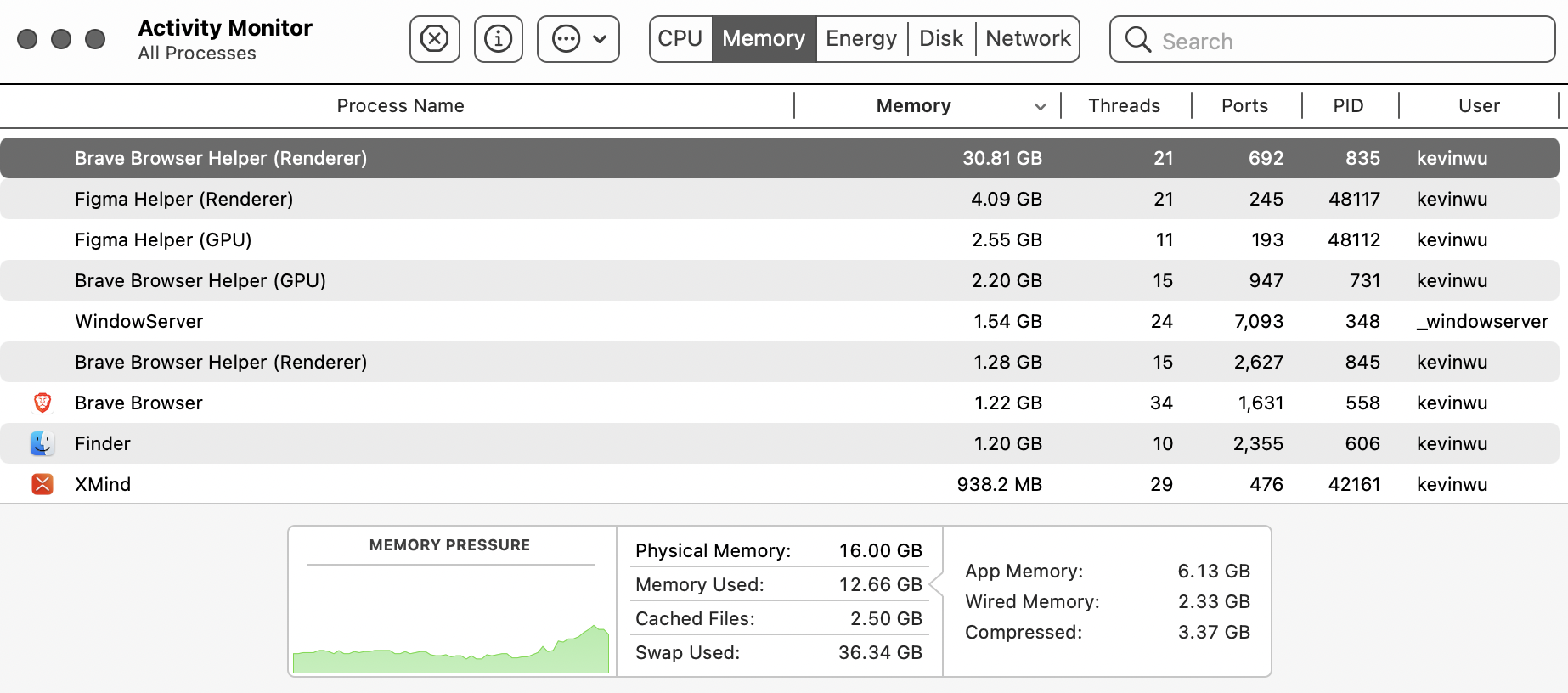

The browser might be the cause for the problem, no? also why it's a different result from the Terminal and the app?
I'm Macbook Pro M1, 1TB, 16GB, only daily office work, been using it for about 2months
