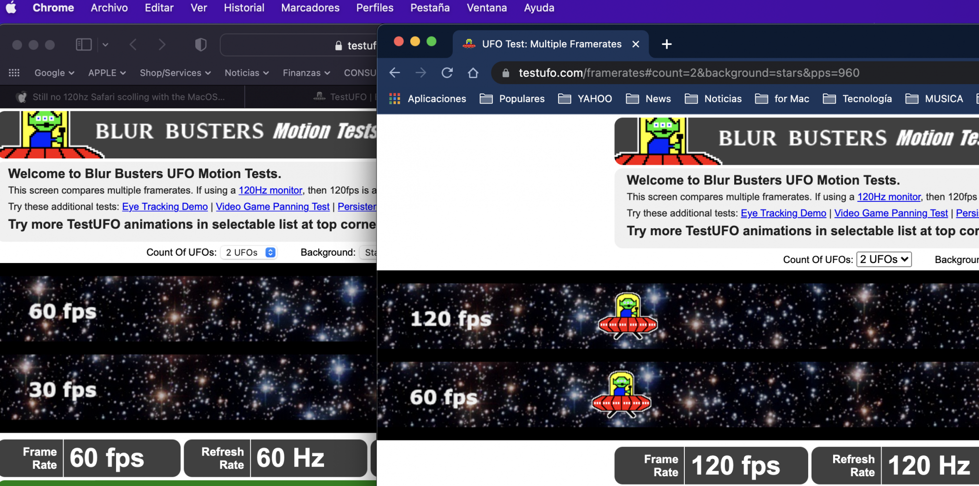

Safari and Chrome side by side :confused:
