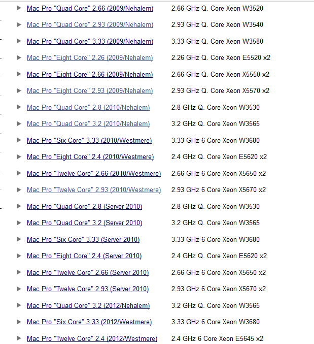

Due to the nature of the issue and trying to troubleshoot, let's be 100% clear when referring to CPUs in this thread. Let's not speculate about certain machines/users until those users can confirm which CPU model they are using in their machines.
AFAIK, there are 2.93 as both X5570 (Gainestown) and X5670 (Gulftown). For this particular troubleshoot, it makes a big difference.
W3520, W3540, W3580, E5520, X5550, and X5570 were stock configs for MP4,1 (Bloomfield & Gainestown)
W3530, W3565, W3680, E5620, X5650, and X5670 were stock configs for MP5,1 2010 (Bloomfield & Gulftown)
W3565, W3680, E5645, X5650, and X5675 were stock configs for MP5,1 2012 (Bloomfield, Gulftown, Westmere-EP)
E5520, X5550, and X5570 are Intel Xeon 5500 series (Gainestown) and only used in MP4,1.
W3520, W3540, and W3580 are Intel Xeon 3500 series (Bloomfield). This series was also used in MP5,1 2010 and 2012.

Good points: to be clear 2xE5520 CPUs here...audio issue present

That list above is original, OEM, STOCK CONFIG. Several users have upgraded/updated their CPUs from stock configs since original purchases in 2009/2010/2012. Just because the machine was originally an MP4,1 does not mean it is still using MP4,1 issued CPUs or MP4,1 generation/series. Many have upgraded to MP5,1 series CPUs via various methods.
There are posts from @MIKX on this forum showing previous CPU and/or tray issues, so it is best not to assume anything until it is confirmed. The user was reporting no audio issues on their machine in post #19.
