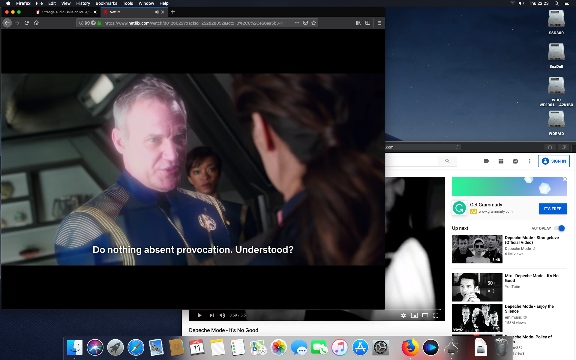

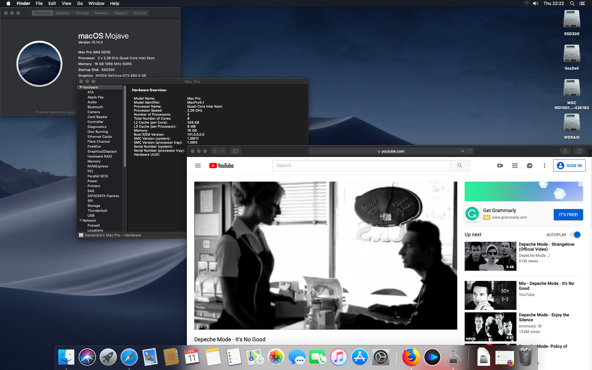

Downgraded to 141.0.0.0.0, still no audio problem.

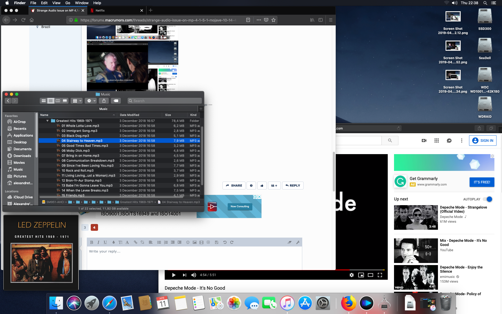

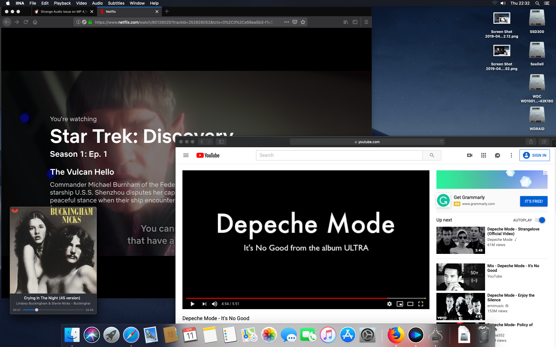

[doublepost=1555032842][/doublepost]No problem with IINA playing .flac:
[doublepost=1555033155][/doublepost]Or with iTunes playing MP3.
