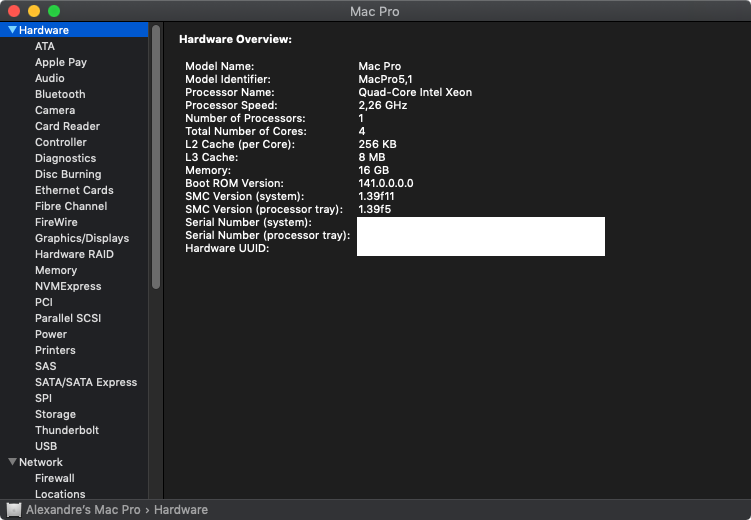

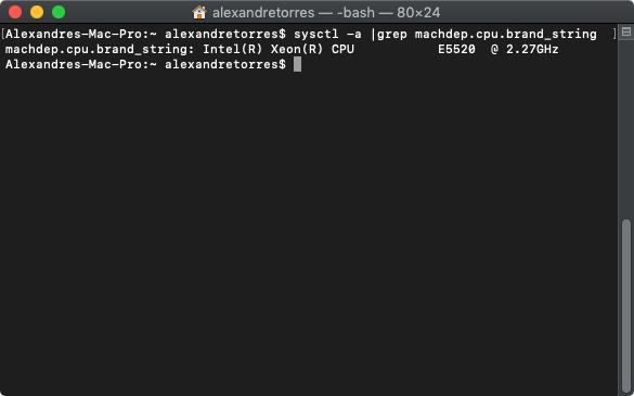

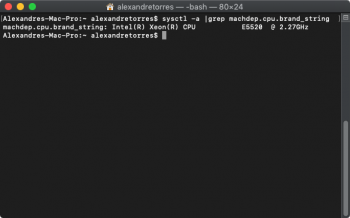

One thing of note: when you run a dual CPU tray with just CPU A, the fans will run 100% of the time. This is normal.

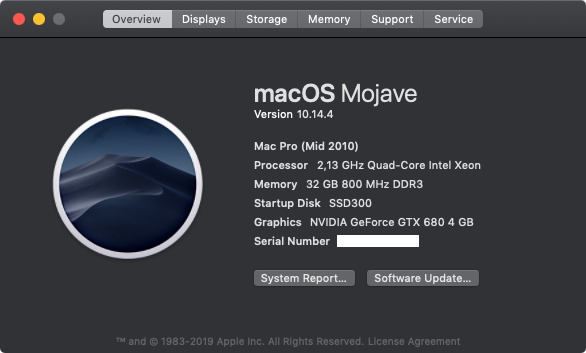

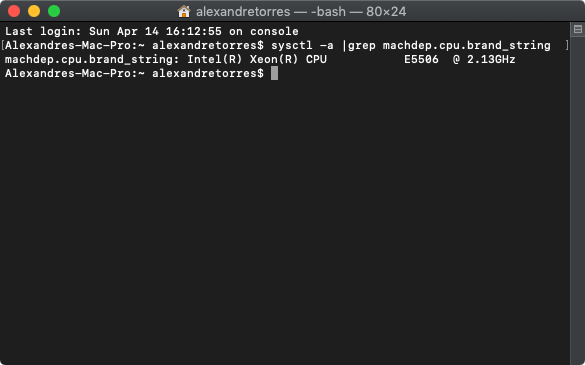

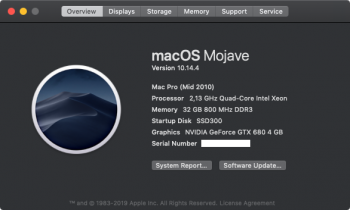

Another thing of note: with single CPU trays, even slower X55xx/E55xx/L55xx Xeons work without the stuttering.
