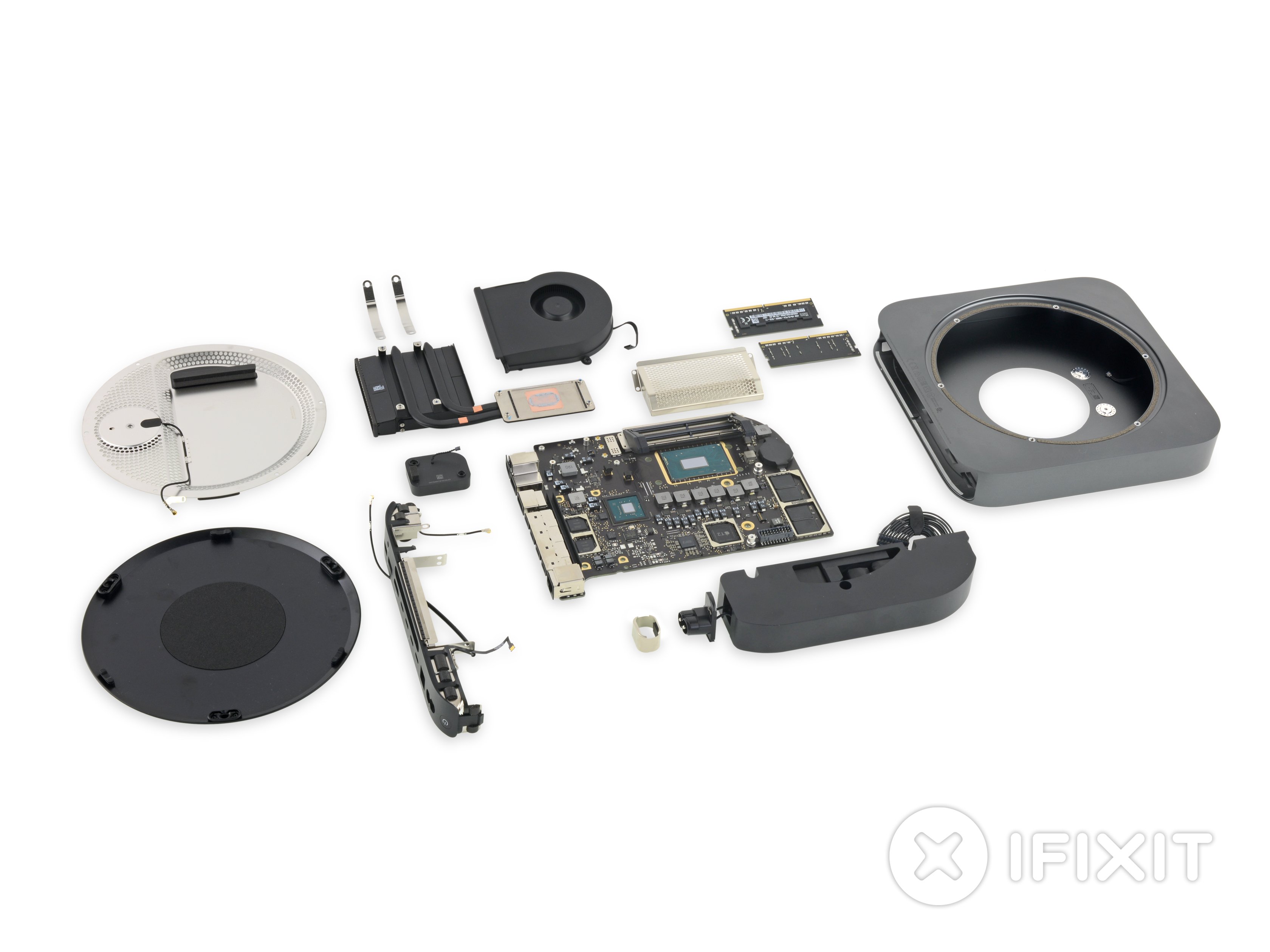

When is the last time you took it apart to remove dust? Is it just being thermally throttled because of poor ventilation?
I have a google calendar recurring reminder every 6 months to slide the logic board out and give it a good dusting. Surprising how much dust gets sucked in. I take apart and dust my OWC ThunderBay 4 external HDD enclosure at the same time.
If you don't want to take the board out, at least take off the bottom cover and blow out as much dust as you can. And blow out the dust in the fan assembly. The mac mini sucks in air through the bottom of the machine and out the back.
I use an XPOWER "A-2" Airrow Pro electric duster:
Teardown instructions:

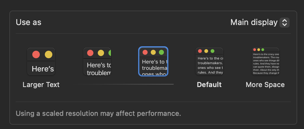

What about your YouTube test while booted in Safe Mode? Might help figure out if its software or hardware.
When I got a 4K display I noticed the integrated GPU was really struggling - especially if you do any scaling in the display settings to increase text size. If you go System Preferences -> Accessibility -> Display you can "Reduce Motion" to help with this. And "Reduce Transparency" also helps performance - I noticed the UI was much more fluid after that.
I wouldn't be too concerned about swap - modern memory management tries to cache everything in RAM so your RAM should often we full.
Scaling (if you are doing it) even says it will affect performance:

I am using scaling, because frankly I wouldn't be able to see much otherwise on a 4K display with the way everything becomes tiny. If this mini is really that gutless on the graphic side it's a bit of a lost cause. I've just enabled those two suggested options in accessibility and I'll see if that helps at all.

It was all over the forum - years ago :) I learned about those accessibility settings back then trying to speed up my mac mini once I got 4K display. Lots of people went external GPU route. I remember this thread in particular:
There is a comment that using 2x scaling is less taxing on the GPU. But then you have 1080p real estate. Maybe a good troubleshooting step. This is the "larger text" option - the biggest text. You'll see the performance warning message also disappears.

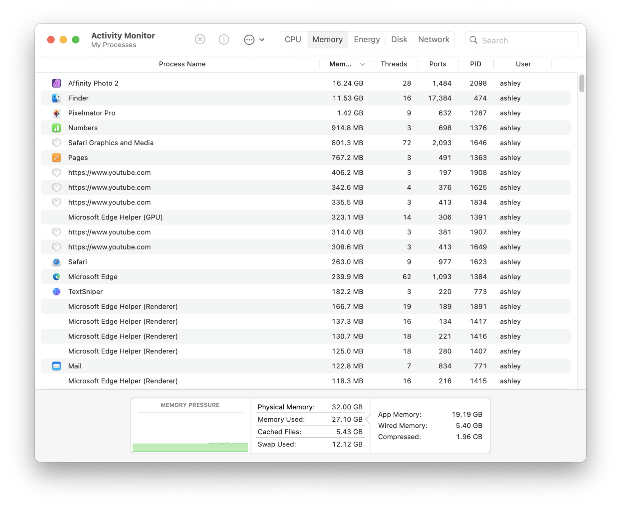

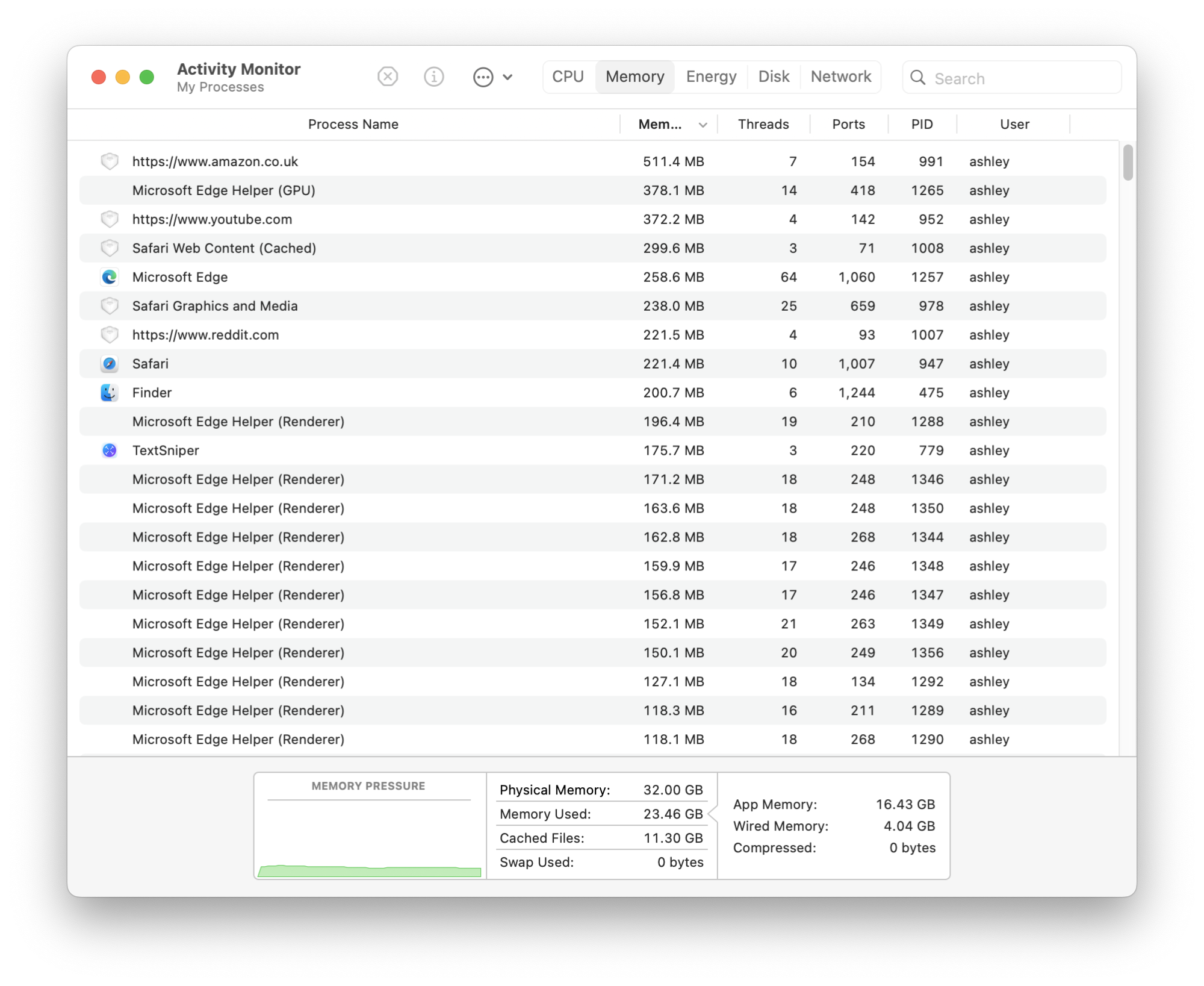

It's kind of late here and well passed midnight, so I'll test this more tomorrow, but so far it seems that reducing motion and transparency inside the display accessibility settings has helped significantly. Yes I'm still seeing a lot of swap and a little spinning ball, but so far the computer is running without immediately crawling to a halt just because I am running two basic tasks at the same time.
Most of the swap here appeared suddenly after opening a dozen files in Affinity Photo, however it's not hammering the performance like before. I'll test some more in the morning though.

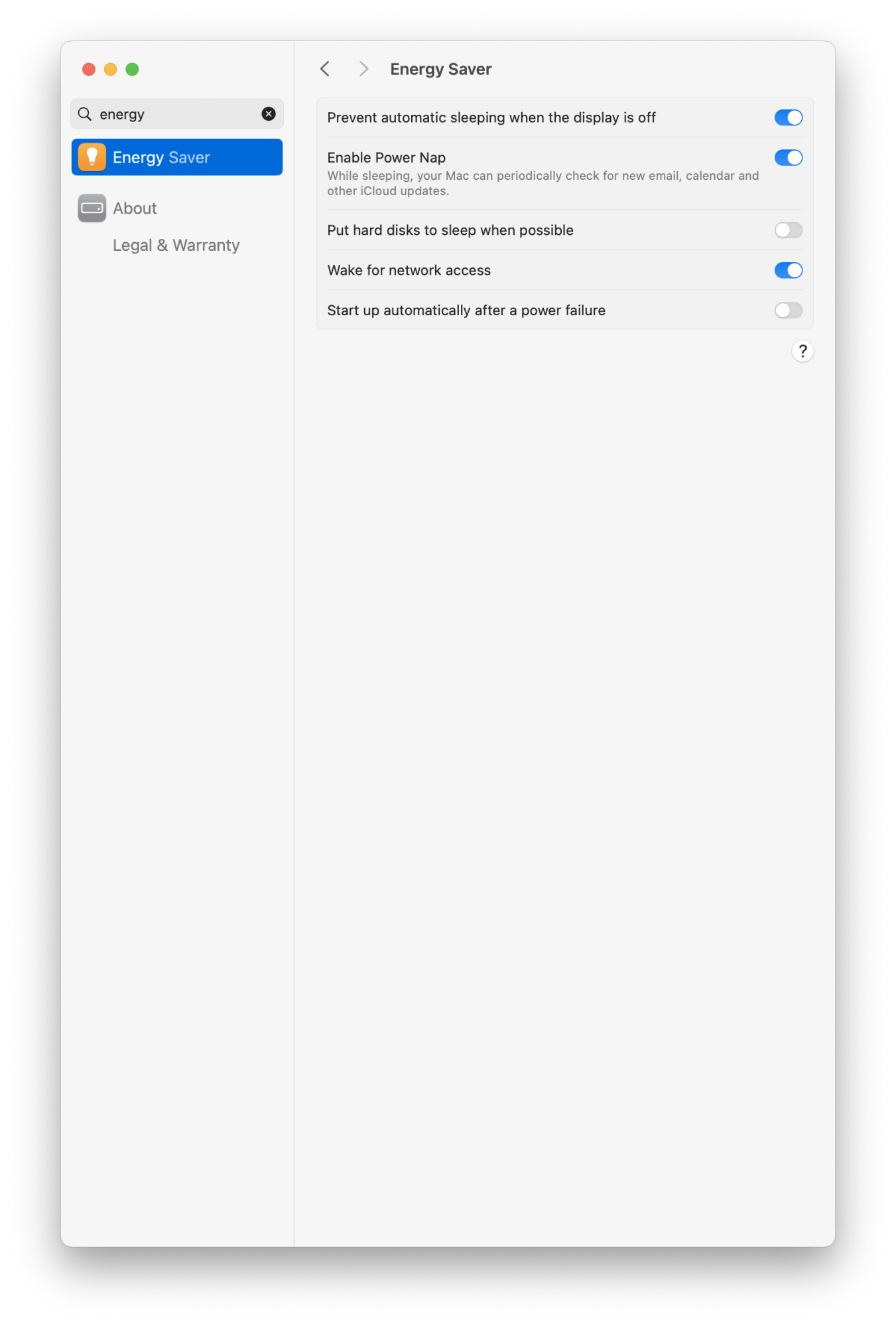

Make sure all your apps are updated. I had this same problem two years ago, and solved it by turning off all “Energy Saver” settings.
Prevent automatic sleeping when the display is off = Enabled
Enable Power Nap = Disabled
Put hard disks to sleep when possible = Disabled
I also found turning the Mac Mini on its side helped with cooling, for some strange reason.

Any idea why Finder is using 11.5GB?
Over here, it's like 3-400MB.
Absolutely none at all. It's still using the same amount even after putting the computer to sleep for 7 hours. Affinity Photo is using almost 6 gigs of ram without having a single image open.
I previously had it set like the screenshot below. I've now followed your suggestions, however wake for network access is still enabled, since you didn't mention that.

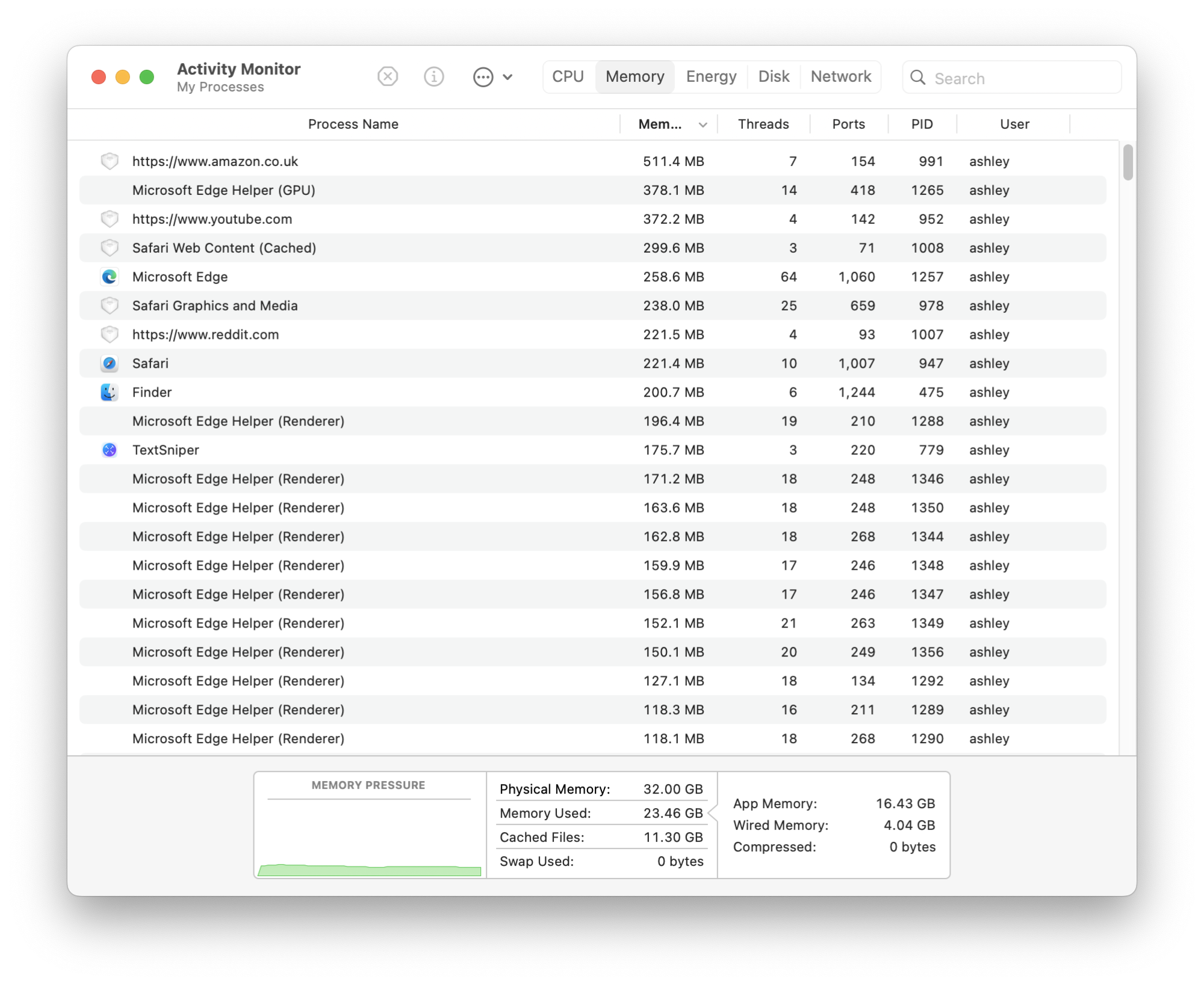

I've just restarted the computer and the finder is now using just 200mb of ram. I'll be curious to see what happens there and whether I can pinpoint a cause if it rises significantly.

I have it turned off as well now. That was the previous setting, which I figured was only enabled as an option to collect mail etc when the computer was asleep.
Well, there's your problem. While modern Macs with SSD are so fast that swapping isn't the killer it used to be, active swapping still typically reduces a system to a fraction of its best self. So if Finder+1 application are grabbing all your memory, the system is going to feel slow (regardless of the CPU, GPU, etc).
If your normal workflow with Affinity Photos needs 25+ GB of RAM, I'd say time to upgrade to 64GB (I'd estimate <$300 if you pay someone else to do it). However, given that it doesn't seem to be driven by actual need, I'd say you're better off addressing the software/etc issues. In my experience, runaway processes/applications just grab more hardware if you give them more hardware (and just put that much more pressure on the rest of the system -- use more disk space, etc).
For now the next time the system gets slow, check Activity Monitor and if you see Finder using more than 300 MB of RAM, you can Force Quit/Relaunch it. That should at least get you back to 200MB (which still seems bloated to me but...progress...)
However, that's very bandaid and depending on the root cause this problem could even follow you to your next Mac if you copy/migrate over your home folder. For this situation I'd focus on the Finder issue first as it is the more obviously broken of the two.
I'd also be curious what you're Memory Used/App Memory looks like right after you login before you start Edge and Safari or any other application. It should be close to 1-2 GB (Mojave was like 1GB while more recent OS are getting closer to 2...) which with the above implies that your Edge + Safari are grabbing 14GB of RAM. Which seems high given that I currently have Orion open with 19 windows and 53 tabs and it's using about 5-6GB of RAM.
Or do you have 'Reopen windows when logging back in' checked and/or have 'Ask to keep changes when closing documents' and/or 'Close windows when quiting an app' (System Preferences/Settings) unchecked?
