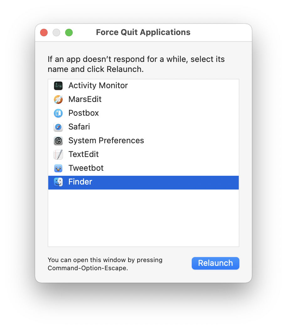

Regarding that absurdly high level of ram being used by the finder
Boyd01
Moderator
Staff member
Feb 21, 2012
7,954
4,894
New Jersey Pine Barrens
That memory leak info is interesting, however (according to the article) it only affects the "find" feature (which I use very rarely)...
"If you never ever use the Finder’s Find feature, then you can stop reading here, as you won’t encounter this bug."
