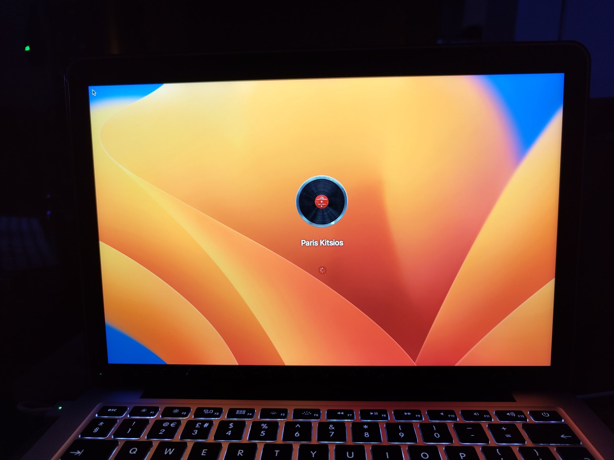

Hello everybody, yesterday I had an update on opencore and I did it normally, after the update and the restart of my MacBook pro (13inch 2014) I press my password and my MacBook stucks on logging screen (with the rolling thing) and I haven't access on my Mac and my files.
Now my problem is my files, I have precious files inside my MacBook and I don't know what to do, I have access on opencore boot screen and on log in screen until the password phase ( it's a simple 4 digit pin and it's correct)
Did anyone of you had tha same issue?
Do you know what to do?
Can I save my files?
Or can I save my Mac os without formatting my Mac again?
Thank you for your time and any help or idea will be very helpful..
P.S excuse me about my bad English, I'm a little bit rusty 😂
Here it's a photo with the log in stucked screen after pressing the right password.

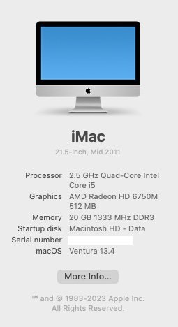

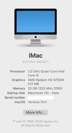

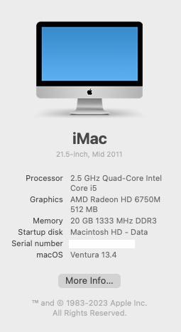

you need to know the version of the mac - for instance mine is a 12,1 - Mid 2011 Mac....
