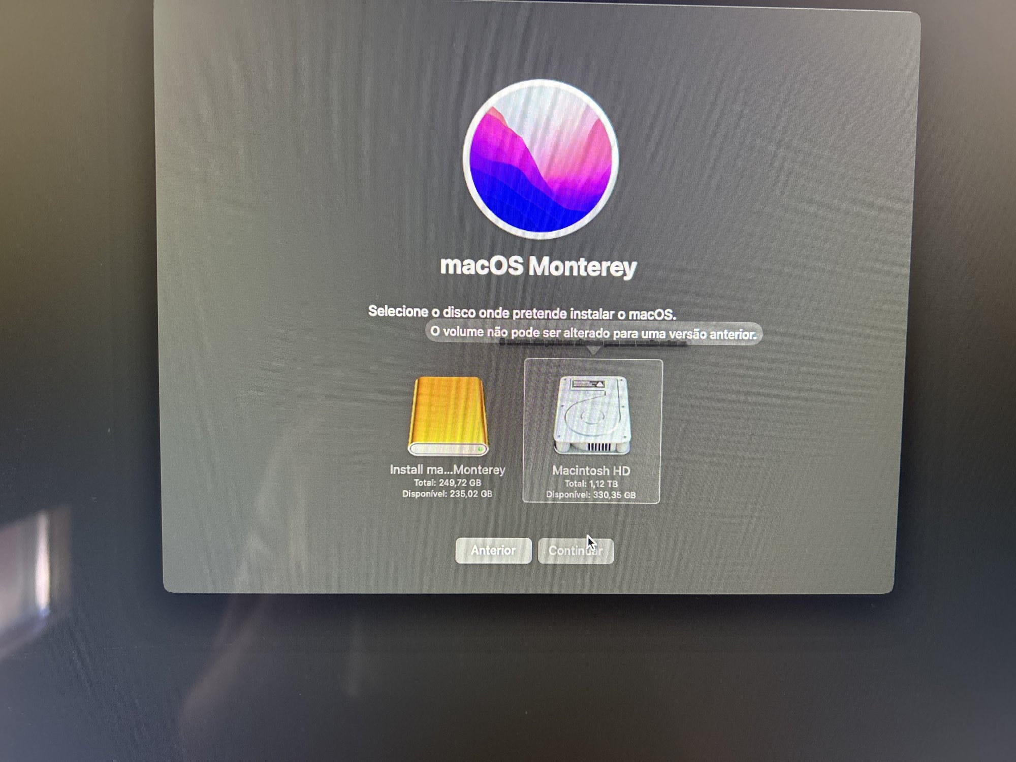

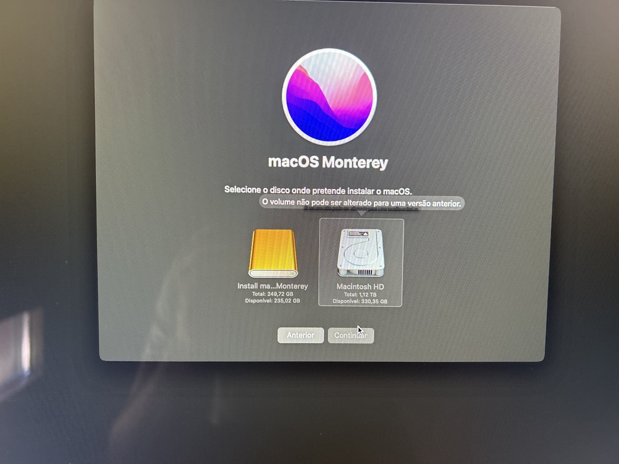

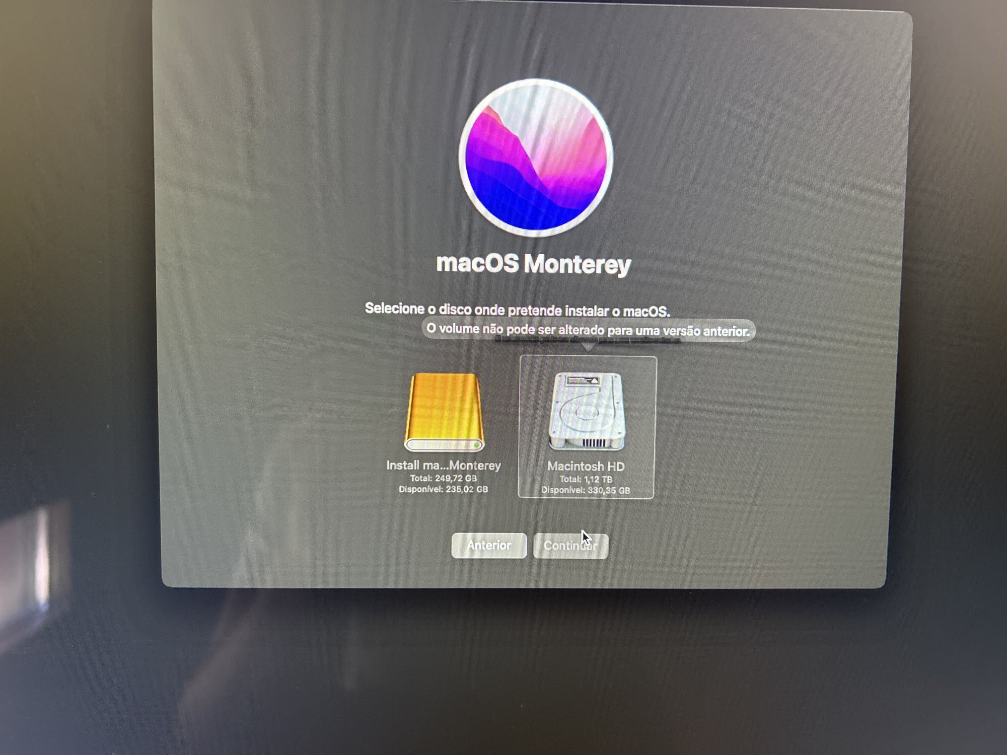

Maybe I’ve done something wrong…
I installed oclp on another Mac and created an usb Monterey installer for my iMac model.
The I came up to this (see picture):
It says the volume can not be altered no an earlier version…
Any ideas?
Thank you!!
Any ideas?
Thank you!!
I think as someone already mentioned, you can only install newer macOS versions than the one already installed on your device. Did you/oclp download the latest Monterey installer? I'm using oclp with Ventura, so I'm not sure what Montorey versions are installed/installable at the moment ...
Thank you for your answer.
Meanwhile I solved the problem. I installed Sonoma beta version, and it worked!
After that, because Sonoma came with WiFi and Bluetooth issues, there is a special patch that’s solves that problem as well. There is a step by step video on YouTube explaining what to do for people who installed Sonoma beta.
