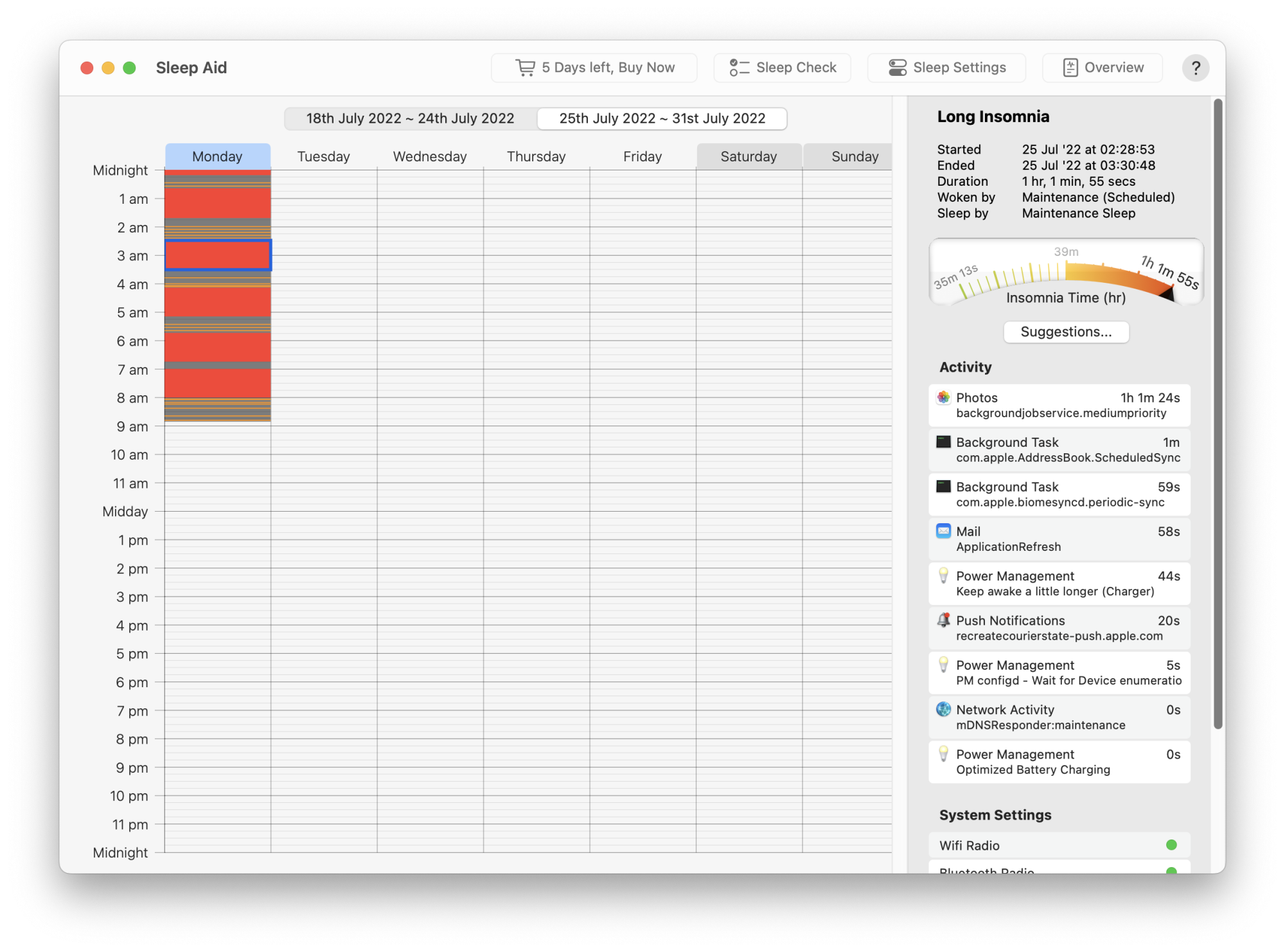

I've been trying to app 'Sleep Aid' to try and identify why my MacBook might be keeping the display powered up, and noticed Photos is pretty much doing something constantly... all of the red sections on image are the same.
Tried to Google this but nothing is coming up, is this 'normal' ? does anyone else have this?

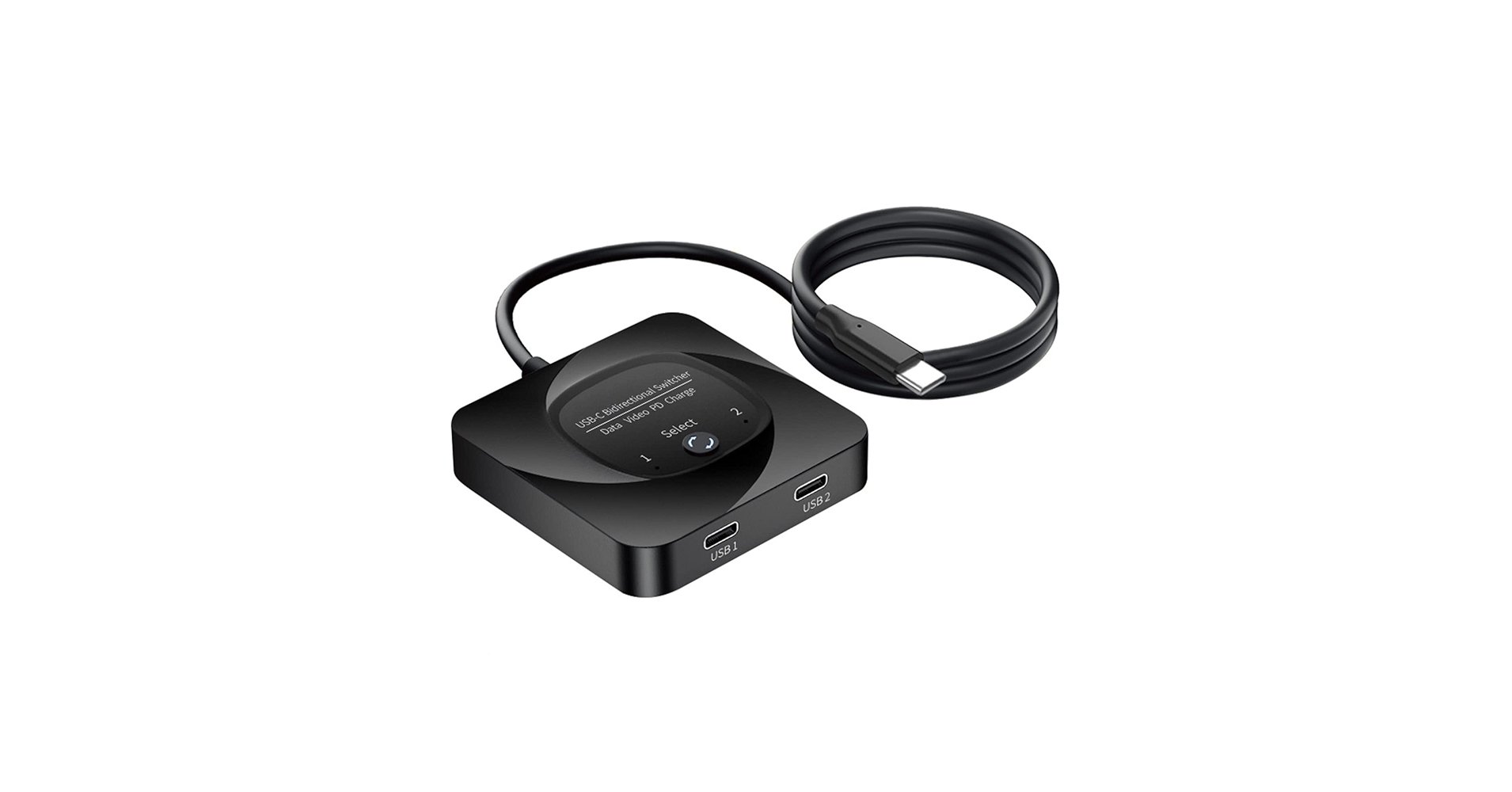

I got tired of my Studio Display remaining powered even when my Macbook was not connected, to I picked up one of these:
Luckily my ASD is plugged in under my desk to a mounted power strip. With a quick flick of the switch, it is unpowered. Why should I keep my entire USB device tree that's plugged into the ASD powered up when neither myself nor my Macbook are home?
Just recommending this if anyone is tired of the ASD sitting there consuming power when you're not there.

I had purchased a switch so I can use my Apple Studio display with my 2020 Retina iMac and also with my M1 Macbook Air without having to unplug the cable each time. As a side benefit, when I put my iMac to sleep, in order to turn off the fan/power to the Studio display, I push the button on the switch so it switches input to position #2. Since there is nothing connected to #2 most of the time, it allows the studio display to fully power off. One caveat is that it works with the two usb-c cables supplied with the switch, but not with a thunderbolt cable.
It isn't a fix for the issue, but it does allow me to power off the studio supply with the push of a button.

I've just got a notification by this thread I was watching as well. There's an utility app called Sleep Aid that I'm currently testing right now. Maybe this can help identify what exactly is waking the Mac and therefore the Display and if this app can actually keep the Mac in sleep.
I know that app. But the maintenance wakes of the iMac have nothing to do with the Studio Display not sleeping at all. When I shutdown my iMac the display sleeps instantly and never wakes (power consumption <1W). If I put my iMac in sleep the display continuously consumes 12-15W energy.

I see. I assumed this is because of the maintenance wakes of the Mac. That they interfere with the Studio Display's slumber although the Display should not be affected at all by this. And I thought that maybe by "forcing" the Mac to sleep via Sleep Aid it could also help with the constant wakes and power consumption of the Display.
