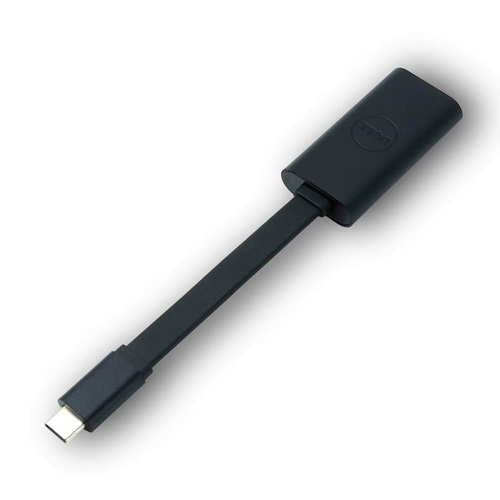

USB-C to HDMI adapter recommendation: Dell USB-C to HDMI 2.0 (part number 470-ABQL)
Its slim, looks good, has a flexible flat cable and is HDMI 2.0 compatible (4K@60Hz)
Other 3rd party adapters look cheap and get inconsistent reviews, and Apples adapter apparently only supports 4K@30Hz and is bigger due to the integrated USB-A and USB-C power pass through.
there are type-c to hdmi dongle supporting 4K60Hz. but yes, DisplayPort is always nicer since it can convert easily to any other outputs, vga, mdp, hdmi, dvi.
